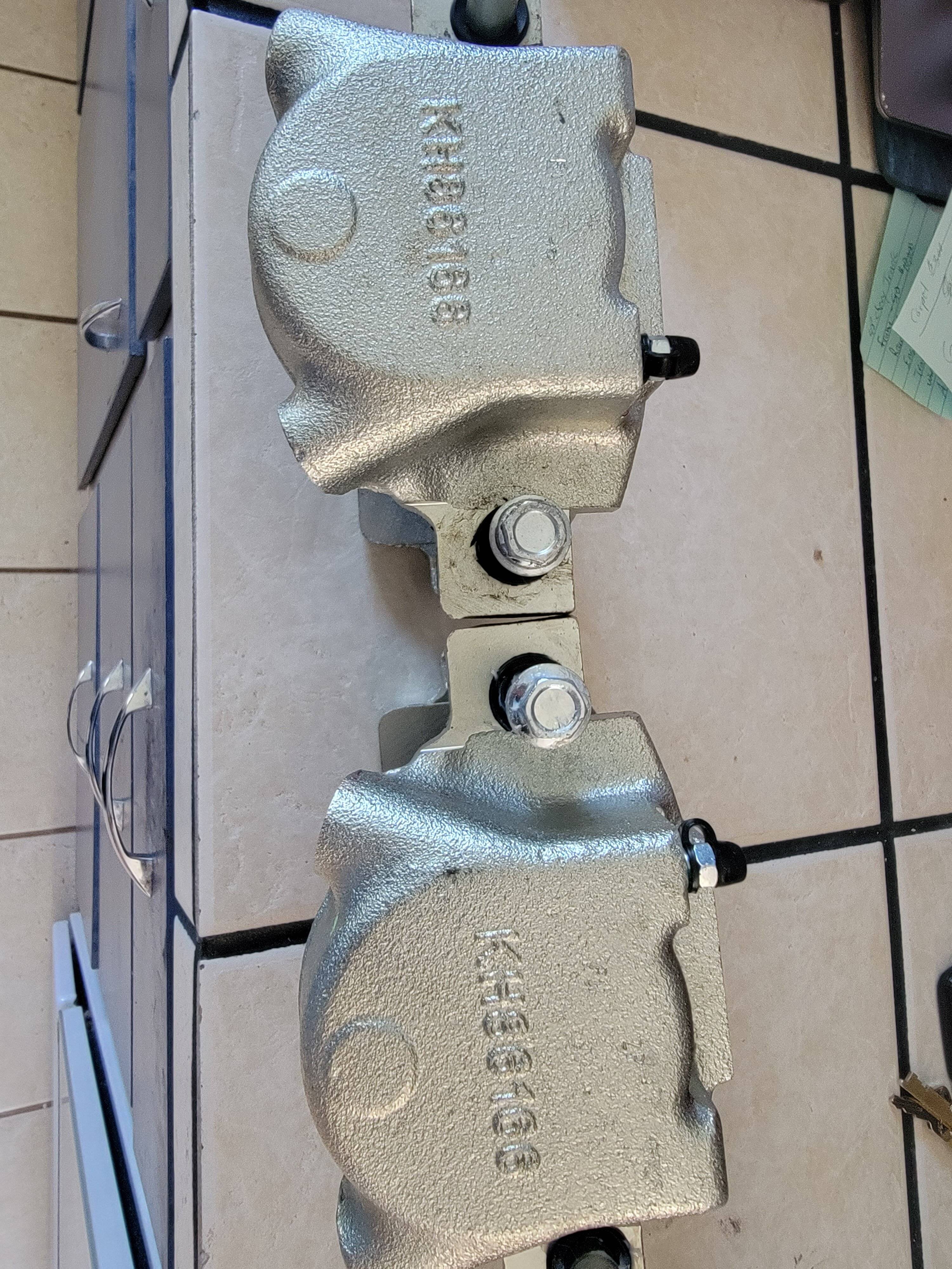

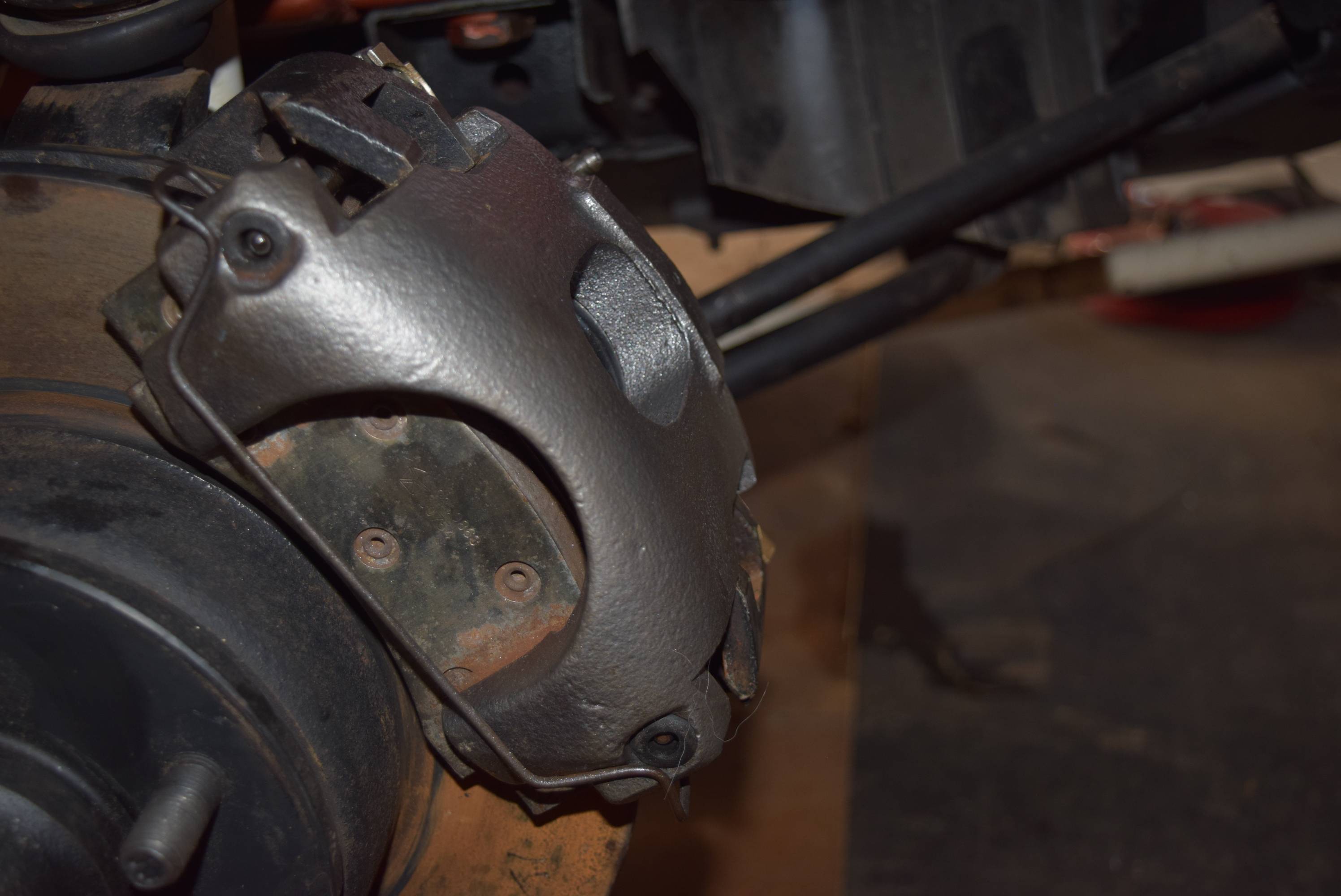

Here's an interesting twist. Turns out that the calipers I got off ebay are KH 86166, which means they are the calipers used after the wide mouth ones. So I guess all I need is a set of 71 caliper brackets and I can bolt these on.
Anyone got a set?

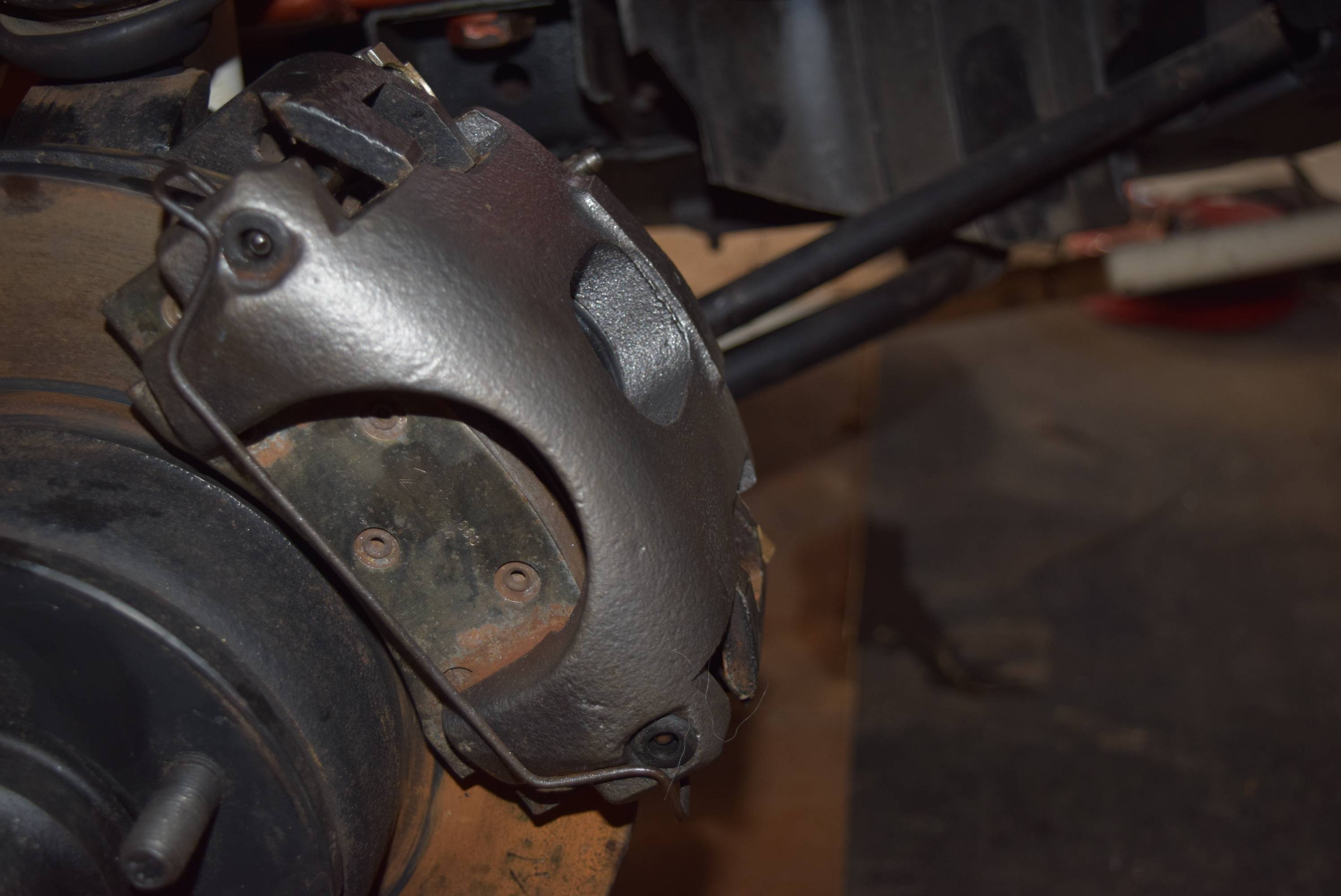

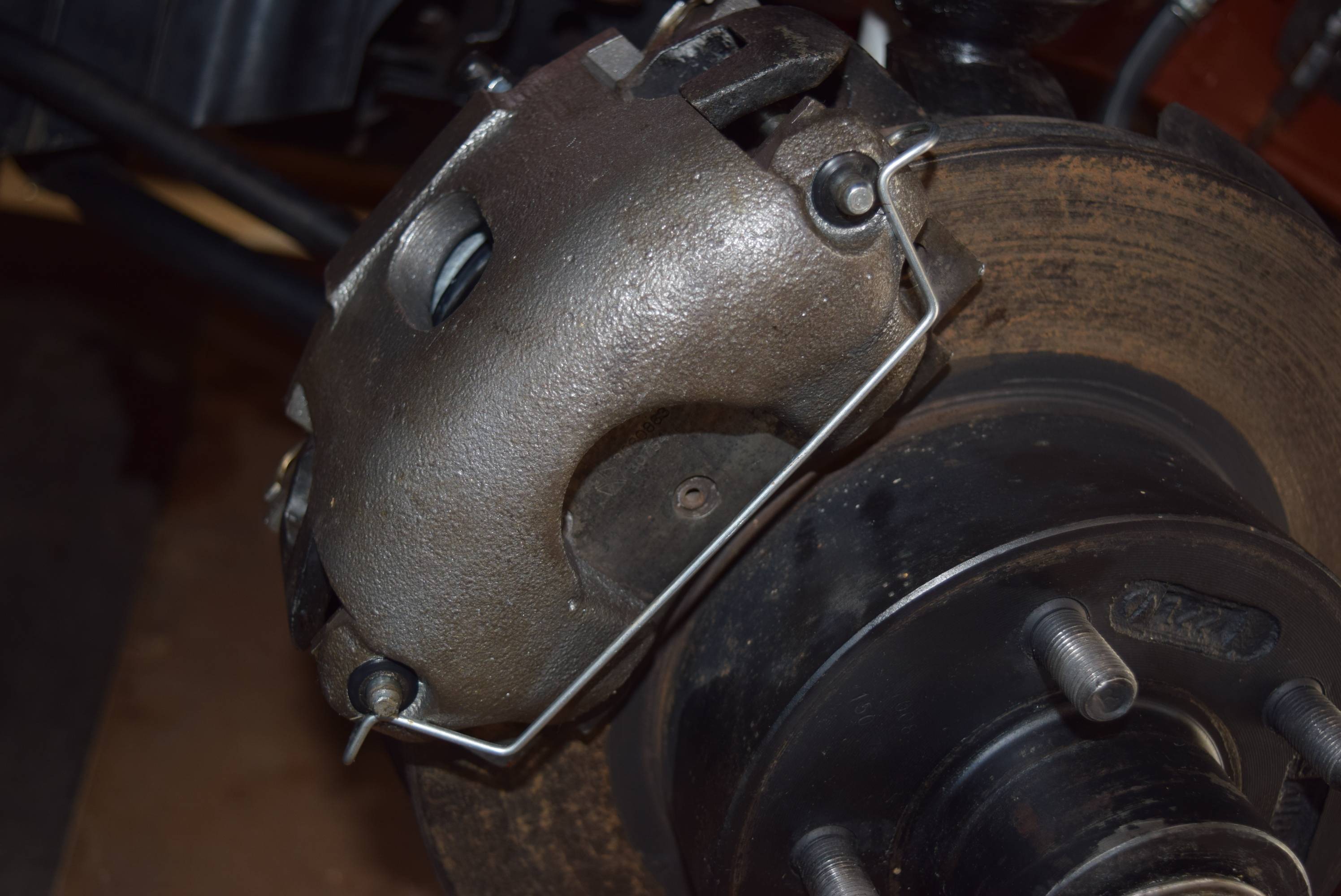

The 1970 only and 1971 onward calipers "should" all fit.
Here is a picture of the 1970 only "wide mouth" caliper on a 1970 'cuda (casting #KH80012) followed by a 1971+ caliper picture of the "narrow mouth" (casting #KH86166).
There are a variety of lengths of caliper pins too- both for overall length and the unthreaded bolt end.
Brake Warehouse outside of Minneapolis can rebuild the calipers- talk to Brad, he's "the guy" for master cylinder work too.
Ben
Ben
My 80012 calipers came off the brackets and the 86166 calipers won't go back on. Someone else here suggested that I modify them (grind them) to fit.
However, I'm thinking that if I can find a set of the correct brackets, I can swap them out and the 86166 calipers will work. That's why I'm asking about brackets. If the calipers are different, the brackets will be different as well.

I'm betting that the caliper brackets are different in those 2 pictures. Here's a picture of the part number on mine: KH83525. There's a set for sale on ebay that are KH90425. I bet those are the ones I need.
benguin
Jun 18, 2021
40
29
Central Illinois 61704
KH83525 was the original 70 right side, KH83526 on the left.. The 'new style' bracket looks like a KH600034 for the driver side, likely KH600035 for passenger.
