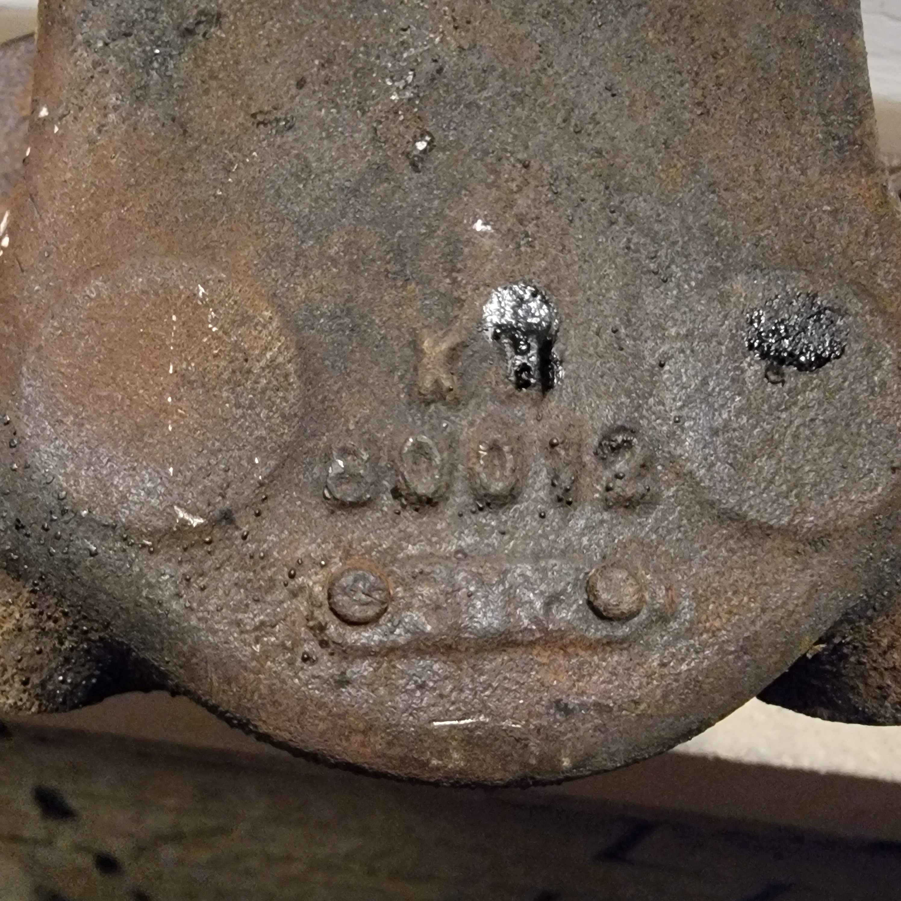

Take some photos of the complete caliper, bracket set up. What are the casting numbers on the original calipers ?

Here's the casting number. I'm getting remans from NAPA tomorrow. If they are actually remans, they should fit. If they do, I'll have to turn in the old ones for the core charge. I won't be able to work on it over the weekend, so I'll let you know next week what I figure out.

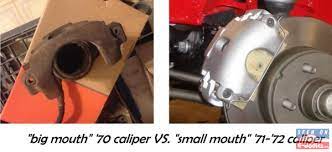

What you have are known as "WIDE MOUTH" Calipers.
They were a one year only design like that on the caliper body.
The 1971 up E body, and later years Kelsey Hayes, single piston caliper used somewhat of a different design body caliper.
Those Wide Mouth calipers are extremely hard to find in this modern day and age.

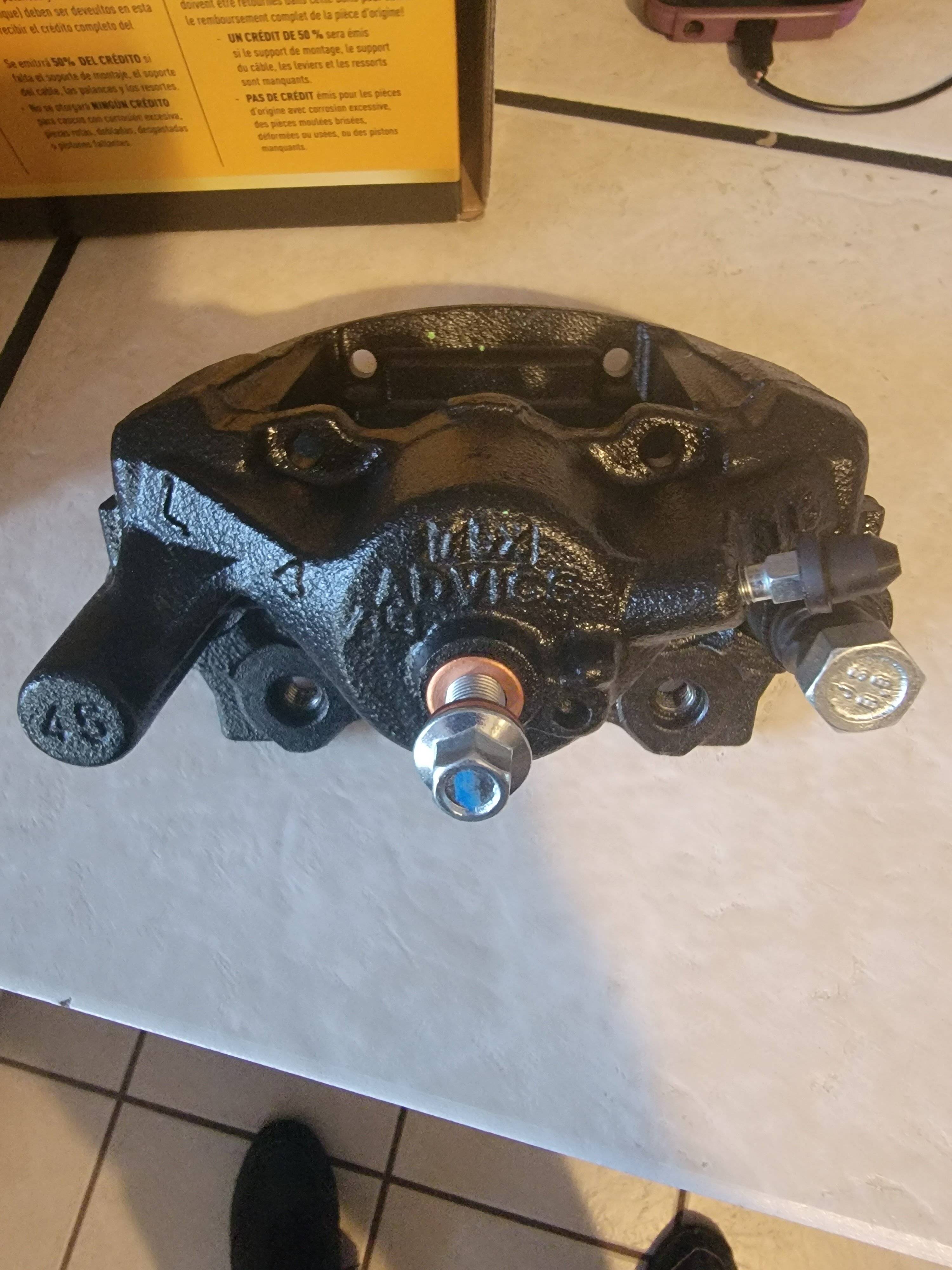

So, I received my "remanufactured" calipers. One is the same as all the others (won't fit) , the other one is some weird caliper not even close to mine, that's boxed wrong! 😳
Ok, so I have super rare "wide mouth" calipers. Apparently they don't exist, and when they do, they are hundreds of dollars.
1.Where can I find new pistons for them?
2.Do they take a special rebuild kit?
3.Where can I find bolt bushings for them?
Next question.... Can I change it over to the more common design? How complicated is that?

So you used a grinder to cut the replacement caliper down to fit? I thought about that, but didn't want to destroy brand new calipers.
You don't "destroy" them, but modify them to fit and work properly, around the caliper mounting area.
