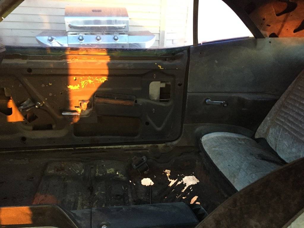

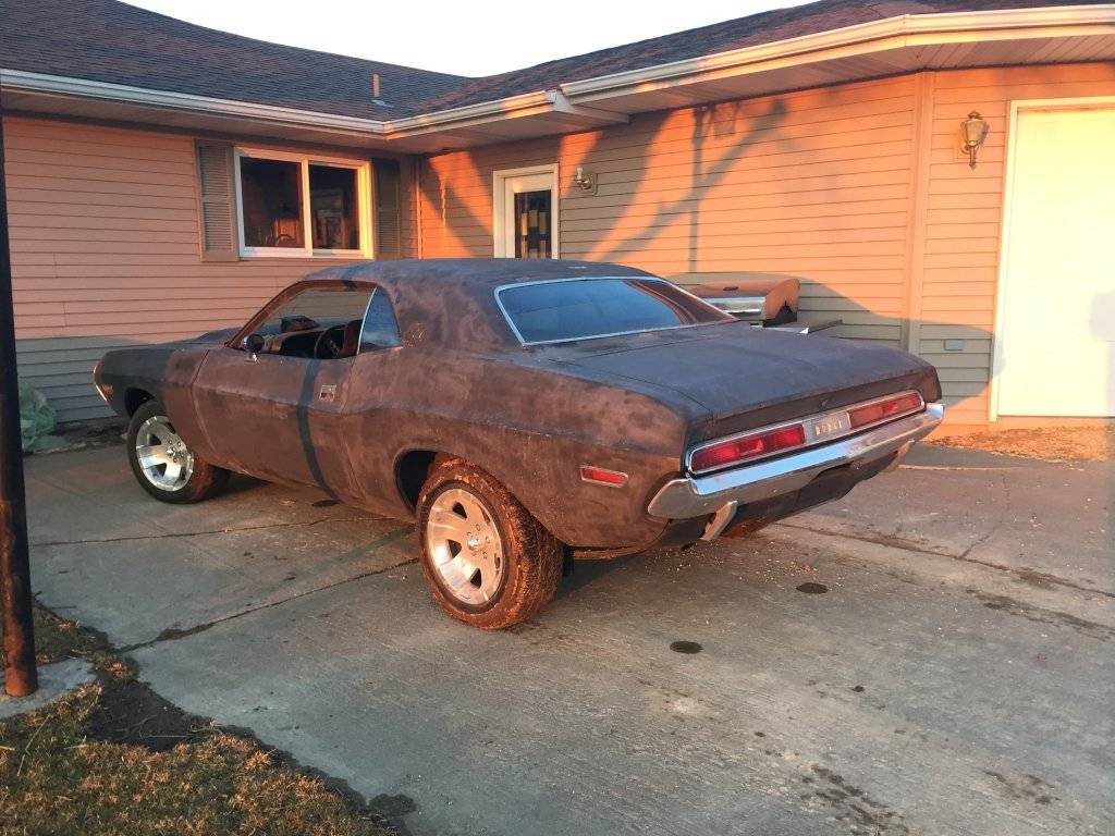

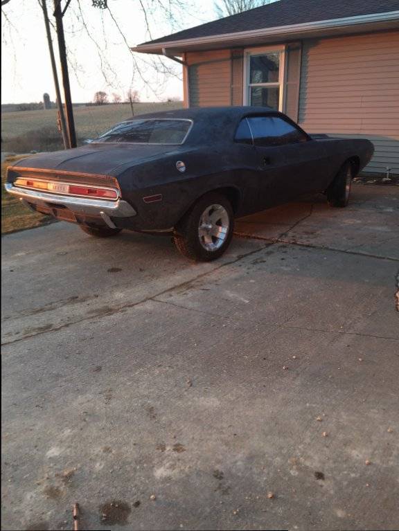

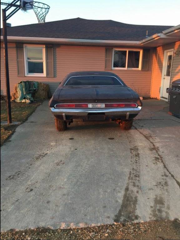

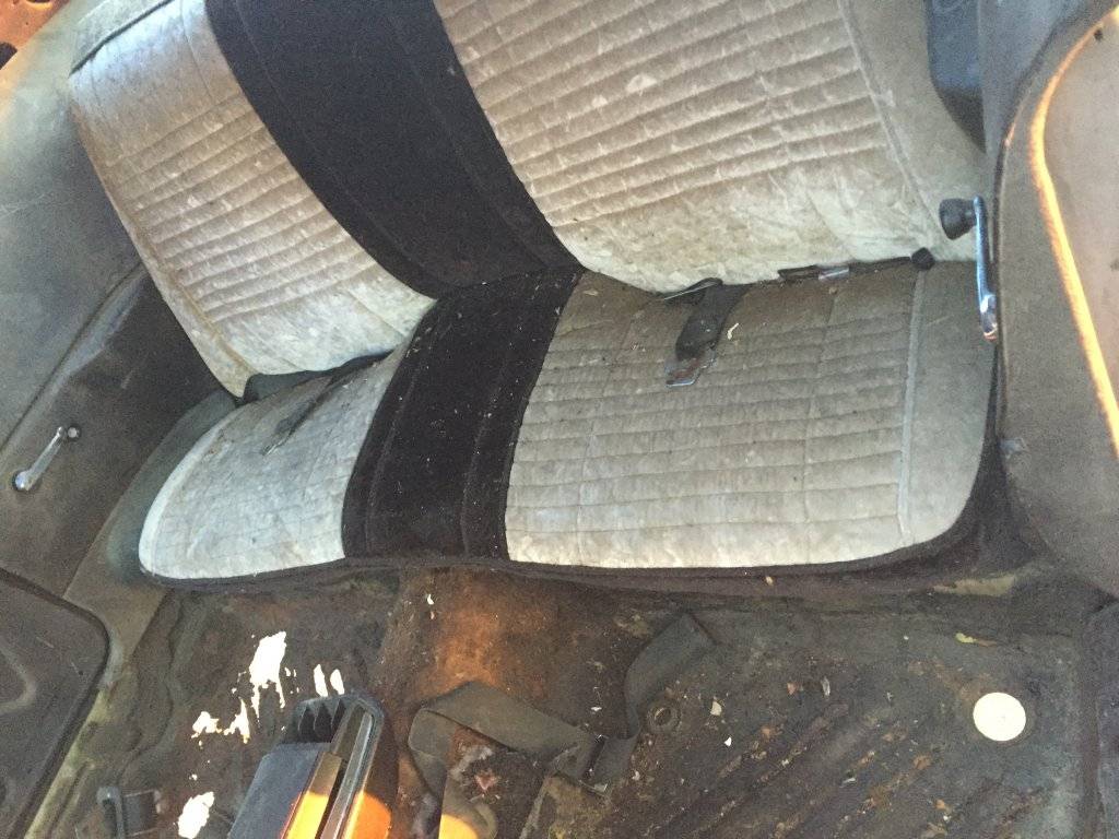

Hey all.
Making this form to post progress of my 70 challenger project as i go. Not doing a full resto. just enough to make it a driver, have some fun, make some memories and turn some heads! Some day would like to do a full restoration. Going to be needing lots of help and having lots of questions which is why i am creating this post. I bought a service manual. Car has a 340 with a 727, interior is in rough shape and was mostly disassembled. missing peices, rough dash, no wiring or gauges hooked up. needs front and rear floor pans, dutchmans panel and work around the rear glass. My first question is where is the best place to be shoppoing for parts? Year one? Ebay? Any sites or brands in particular? the Paddock? Am on a limited budget once again, wnat to make a nice driver not a perfect show car. Thanks!

Thanks for the replies! I agree I did not want to buy a bunch of parts or strip it down as I know how that turns out. stuff sits for years and things change. My first priority is to replace the front and rear floor pans as they need done before it is a driver. Also once I do that I can start to reassemble the interior. Which will get done a little at a time because of how costly it is going to be. That would be my starting point. That and also get the wiring hooked up, lights, turn signals, speedo, etc. I think this is a good way to go about it? What are your opinions?

JBlake, sounds like a pretty solid approach. Floor pans can be a bit consuming, so plan a bit of time. Not sure what the extent of your need to replace, but it looks like driver and passenger rear for sure. Wiring, well that too can be a bit of a projetc, so pick your battles. Keep us posted.

Yes I am going to be in there so I just decided to do the whole floor, passenger and driver, front and rear. Just do it all so its done and solid. That's going to be my first big battle. it needs some work behind the rear glass and dutchmans panel replaced but that isn't hurting anything for now. Biggest things to get it a driver is the floor pans, interior, wiring and a tune up I believe. Any other things I should check out or consider when making it road ready?
