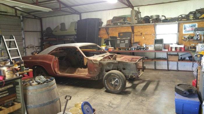

Hello, I am now retired and really need to start working again on this project. I began in the early 90s. I am now in the research phase to purchase a rotisserie. I am looking at the Derek Weaver Rotisserie. I look forward to everyone's support and comments on this forum.

The car is a JH23 with 318, 904 trans, and A/C. I plan to keep the motor/trans and everything original as much as possible. I will do some performance upgrades on the engine. Currently on jack stands dropping the rear end and K-frame to get it on a rotisserie. Need to repair trunk pan and driver side pan rust areas. Patching only.
