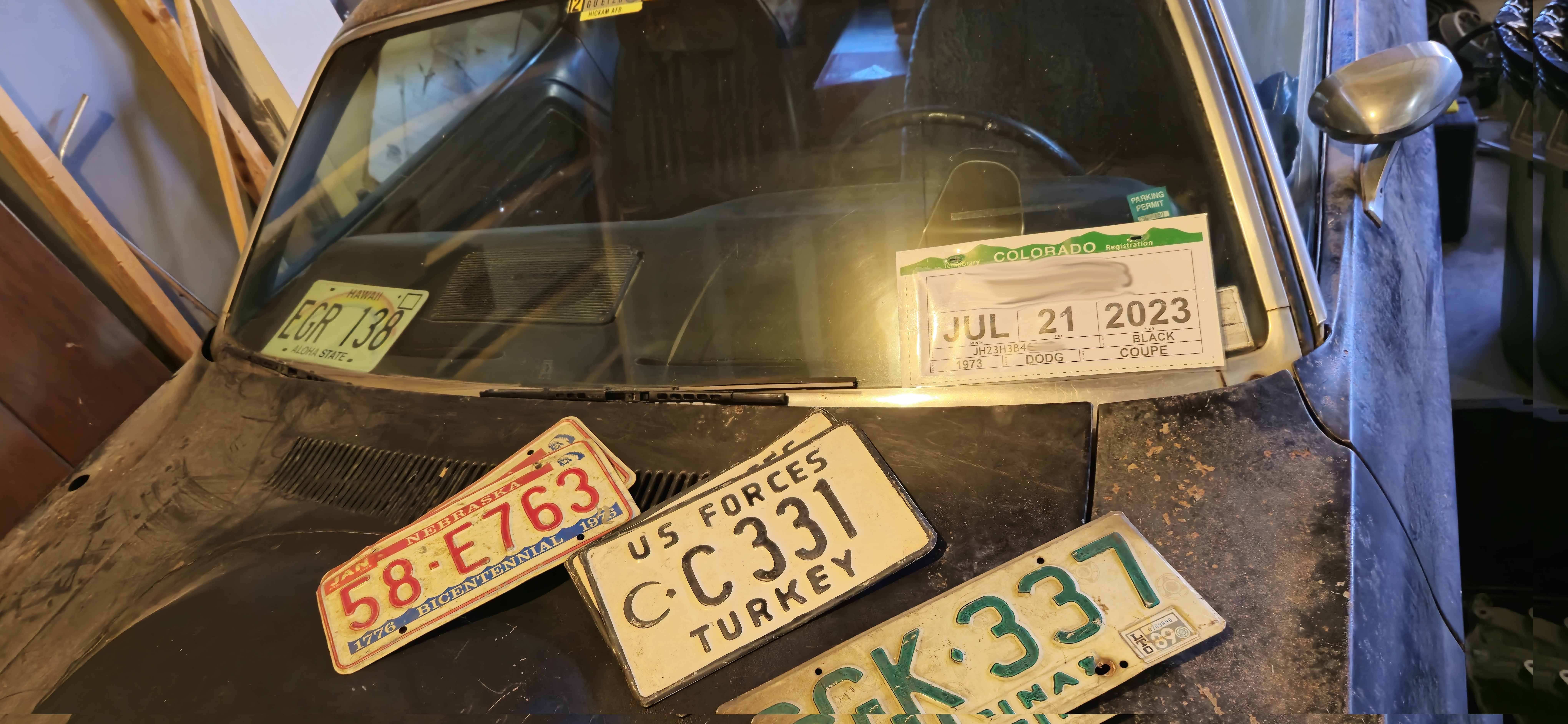

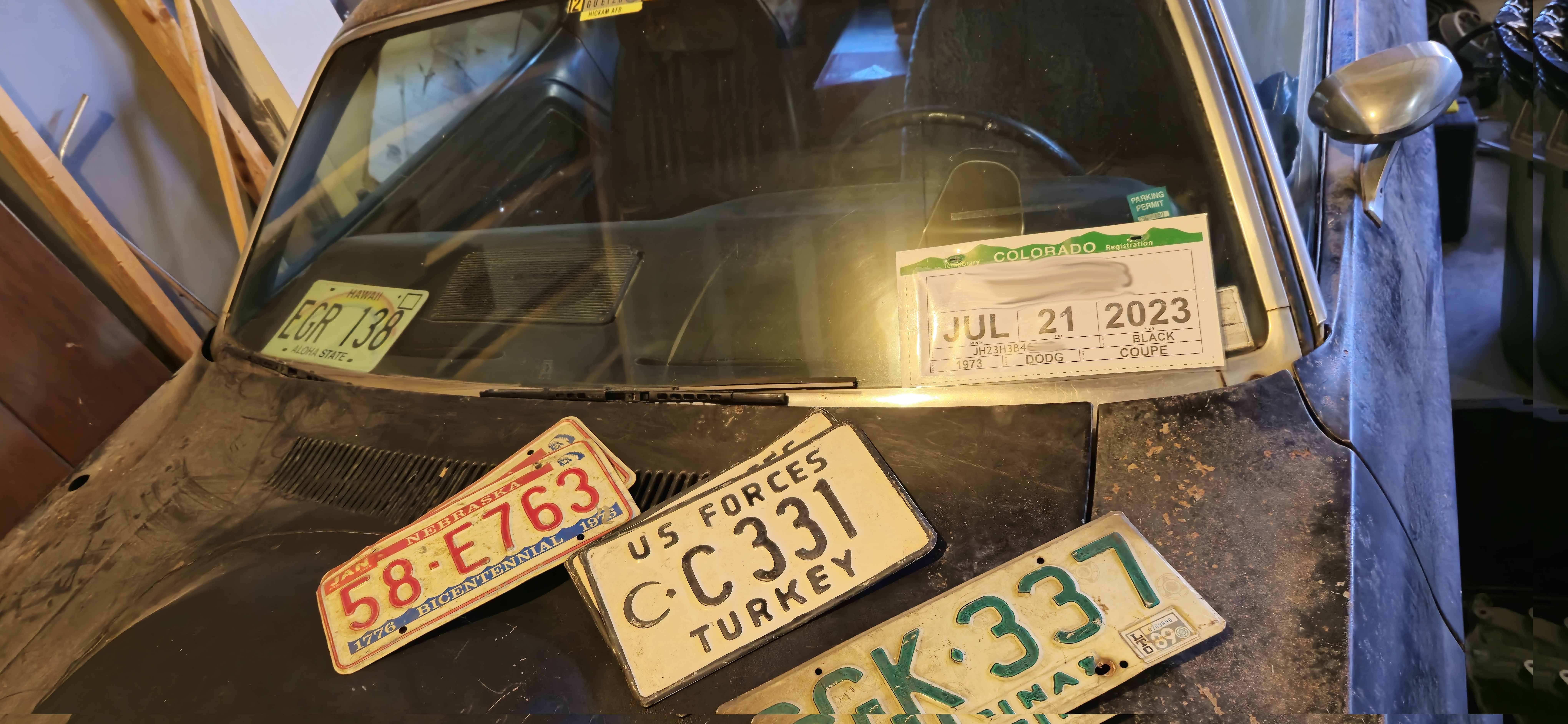

I still have that raw block wrapped in brown packing paper from 91, and for some reason, I kept all the license plates I've had for her during our travels.

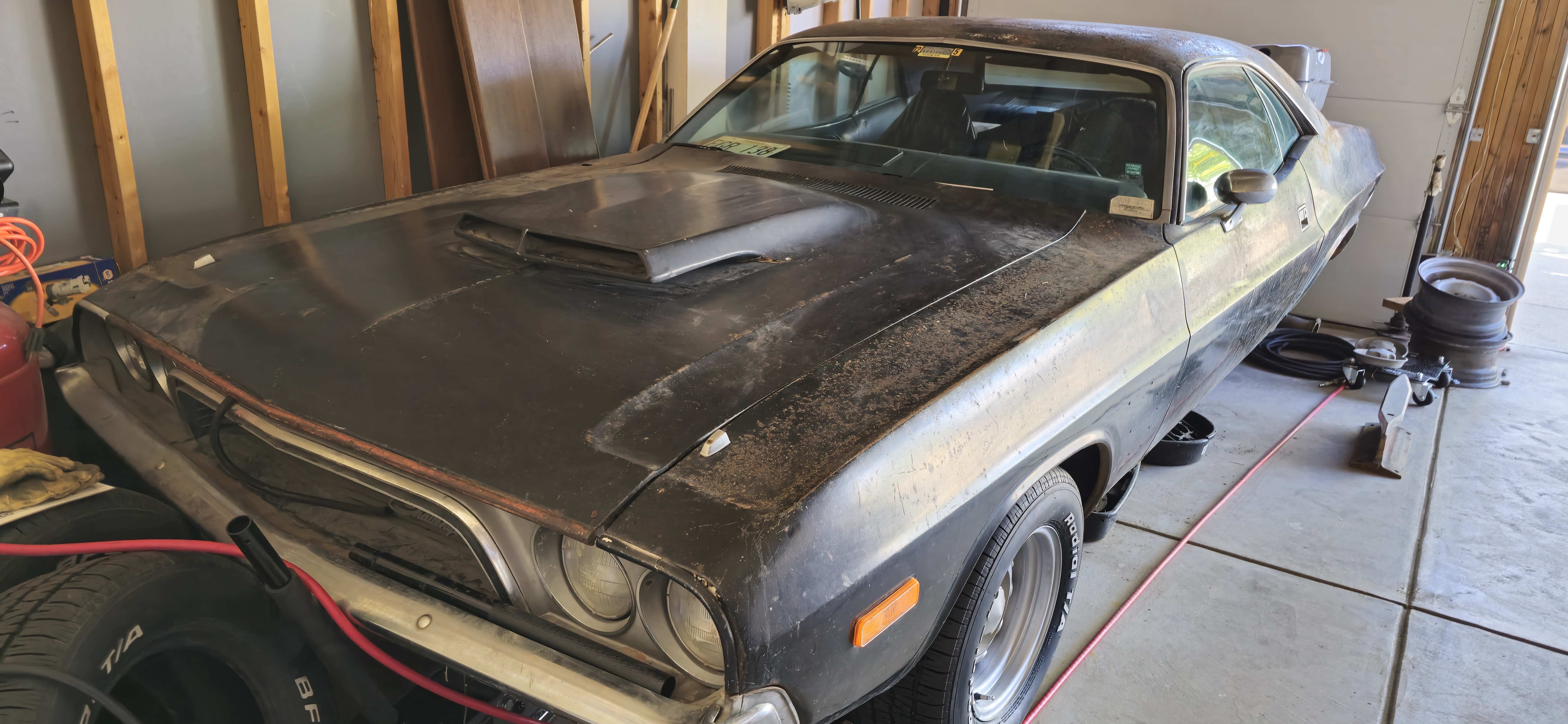

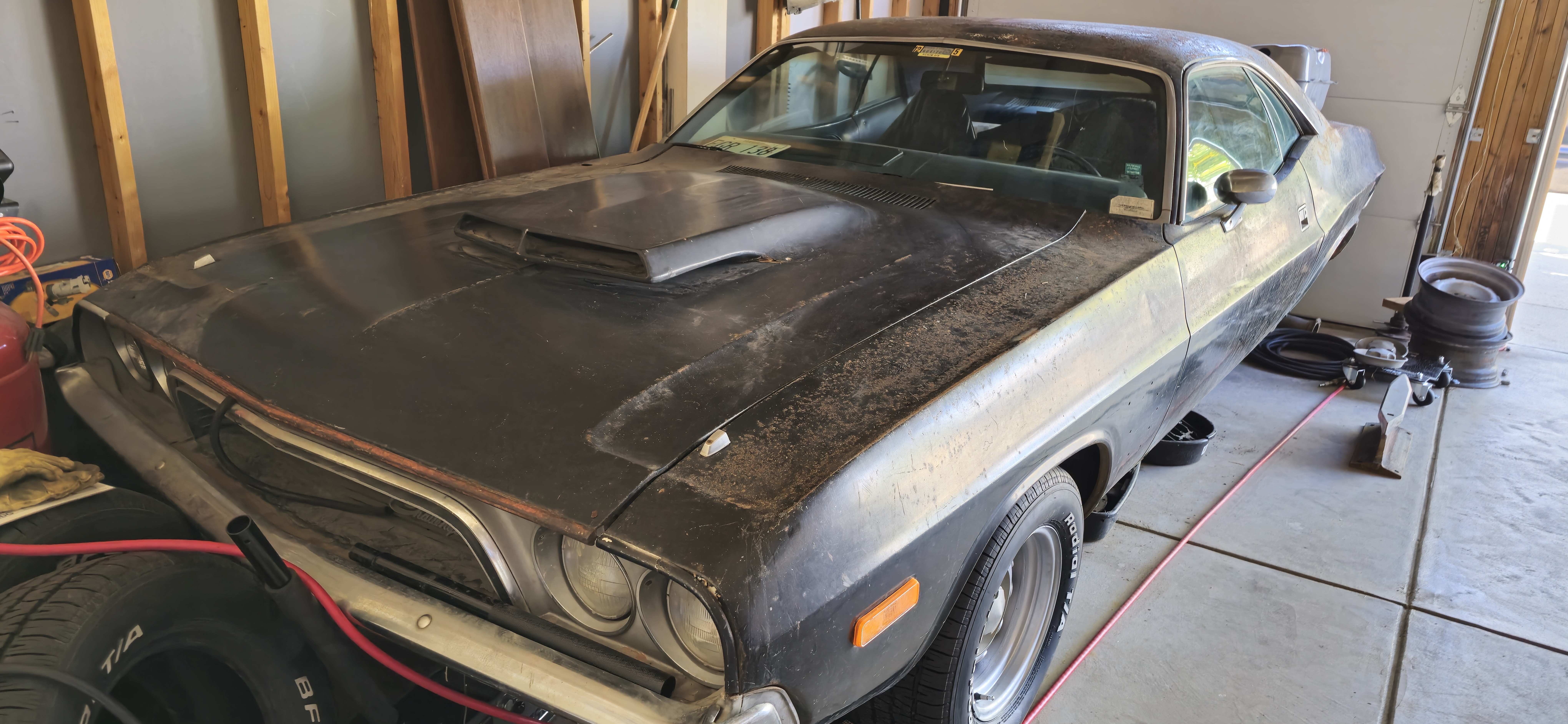

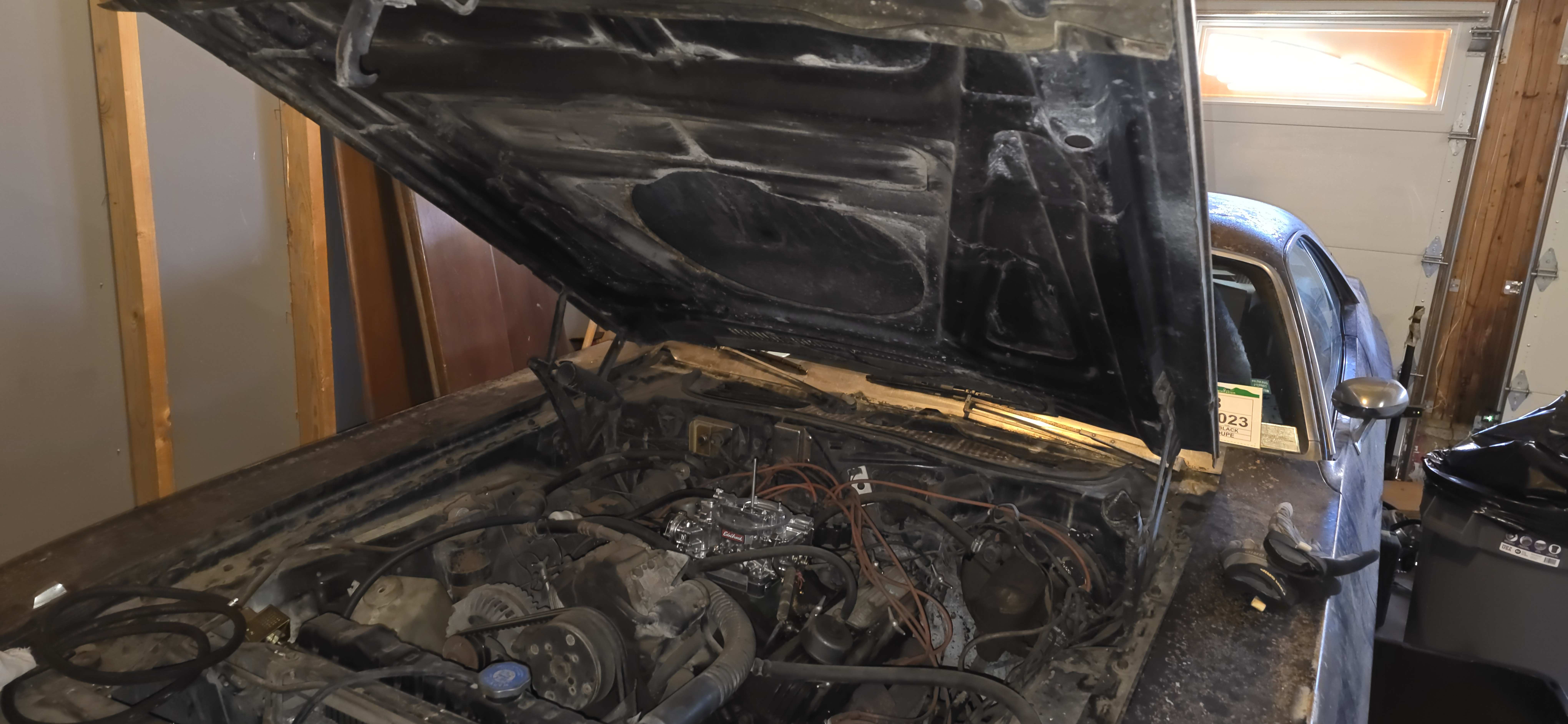

You'll notice that the hood is not a proper Rallye hood. In 88 or 89, I sold my Rallye hood to a buddy with a 71 for some cash and his flat hood. You could order a T/A fresh air intake from Year One. I grabbed one, cut a hole in the flat hood, and made my own T/A-style hood.
I found a big dual snorkel air cleaner off a 440 car at our auto hobby shop, cut the vertical band off the baseplate along with the snorkels, and fabricated a redneck 4bbl variant of a fresh air intake that sealed against the hood. Sadly, that work of art was lost in transit from the Philippines to Hawaii. Not sure of which port, it was not on the car when I picked it up at the port in Hawaii.

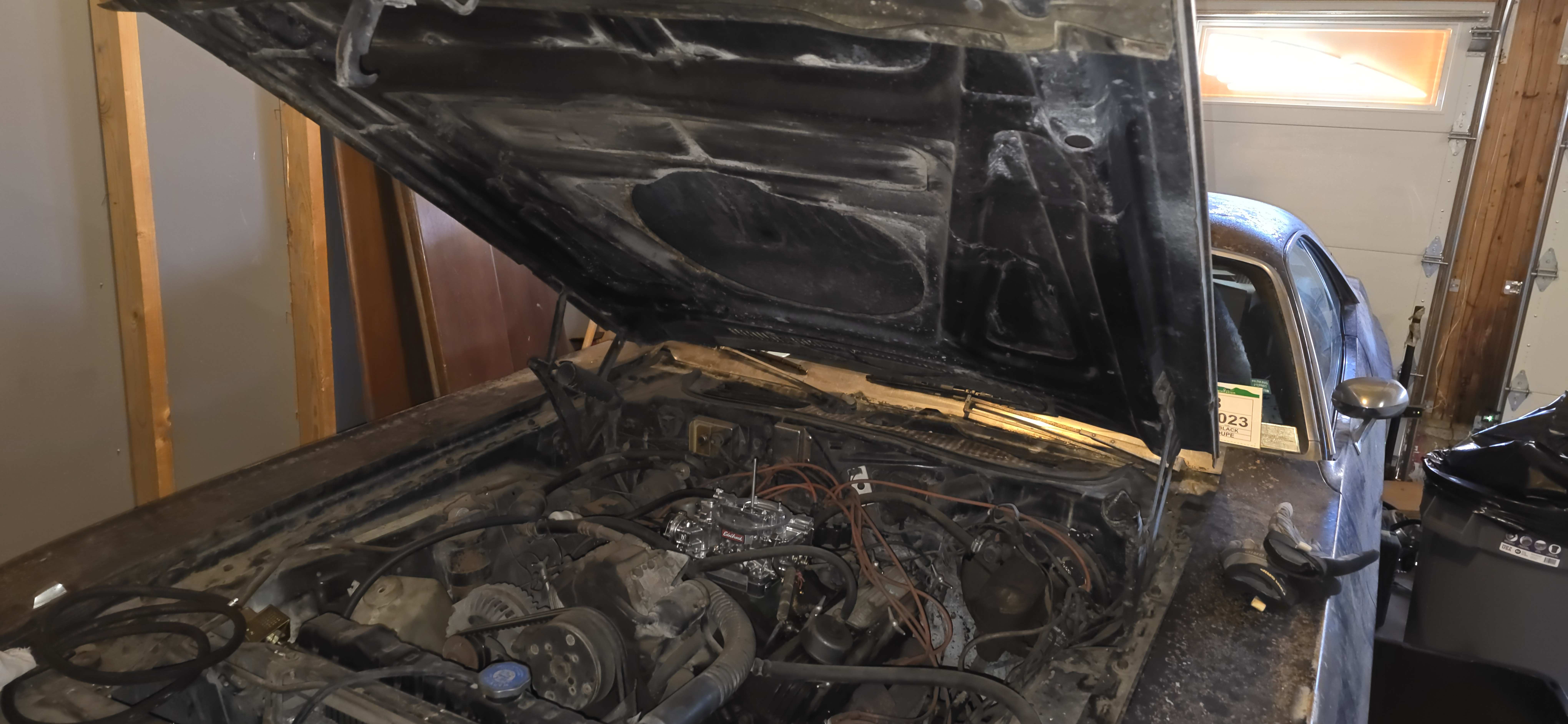

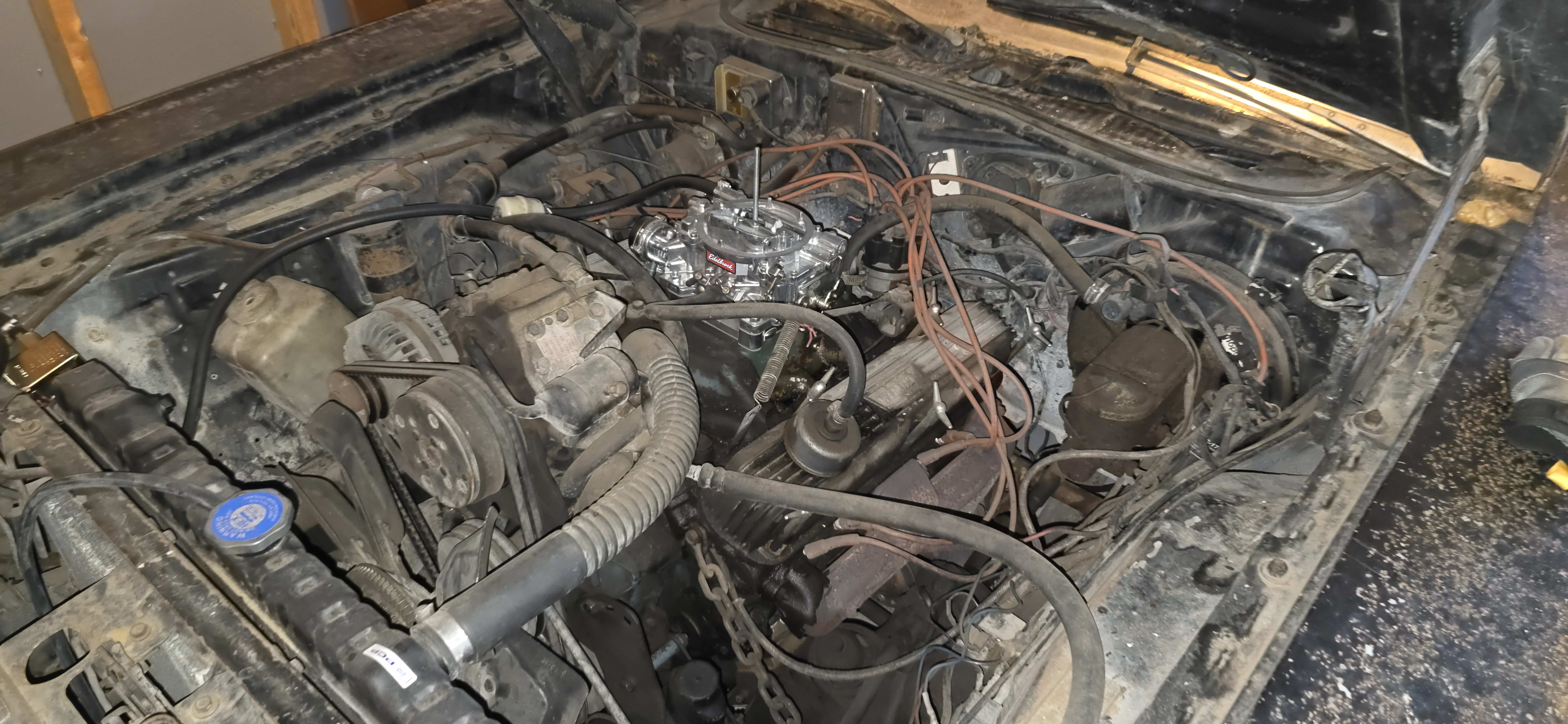

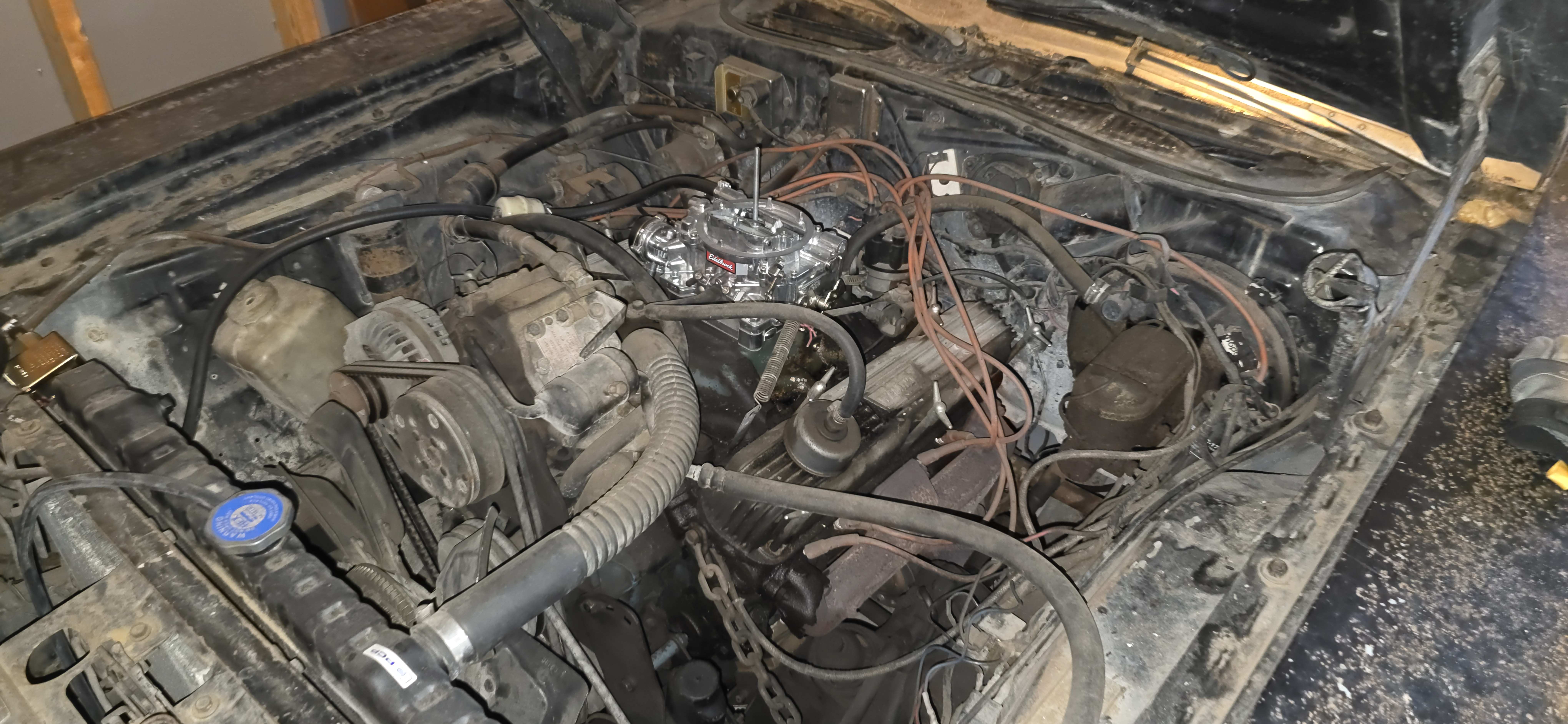

In one of the attached photos, you'll see the 318 I installed after I pulled the 340 so I could drive it. At the time, it was our only vehicle. That 318 came out of a donor 72 Challenger that had been wrecked, so I pulled the complete factory AC system and added that in when I did the swap. Why, well, there are basically two seasons in the Philippines: hot and wet and hot and dry. So yer sweating year round...

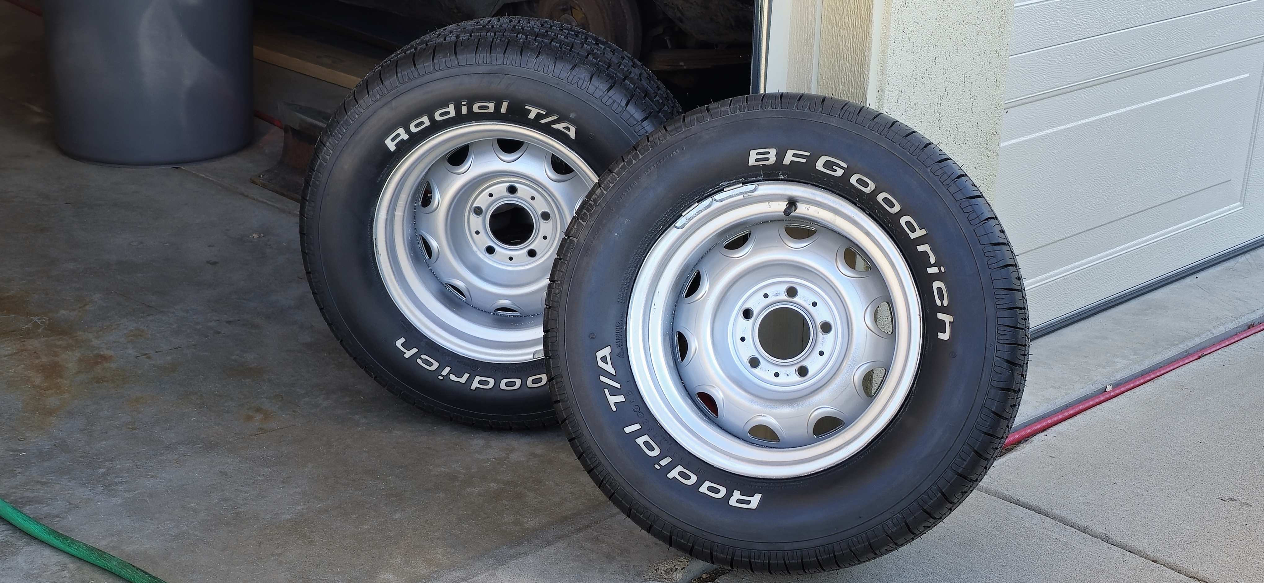

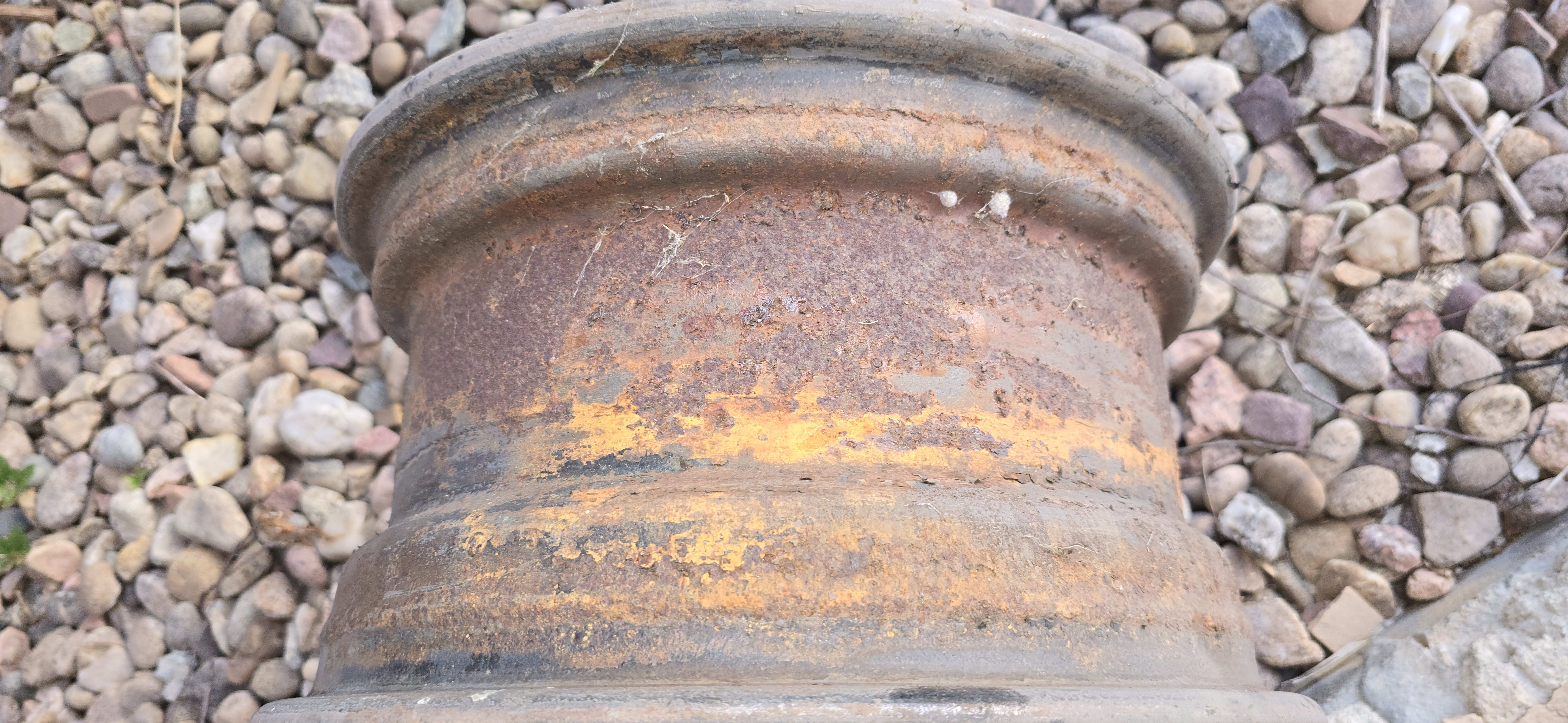

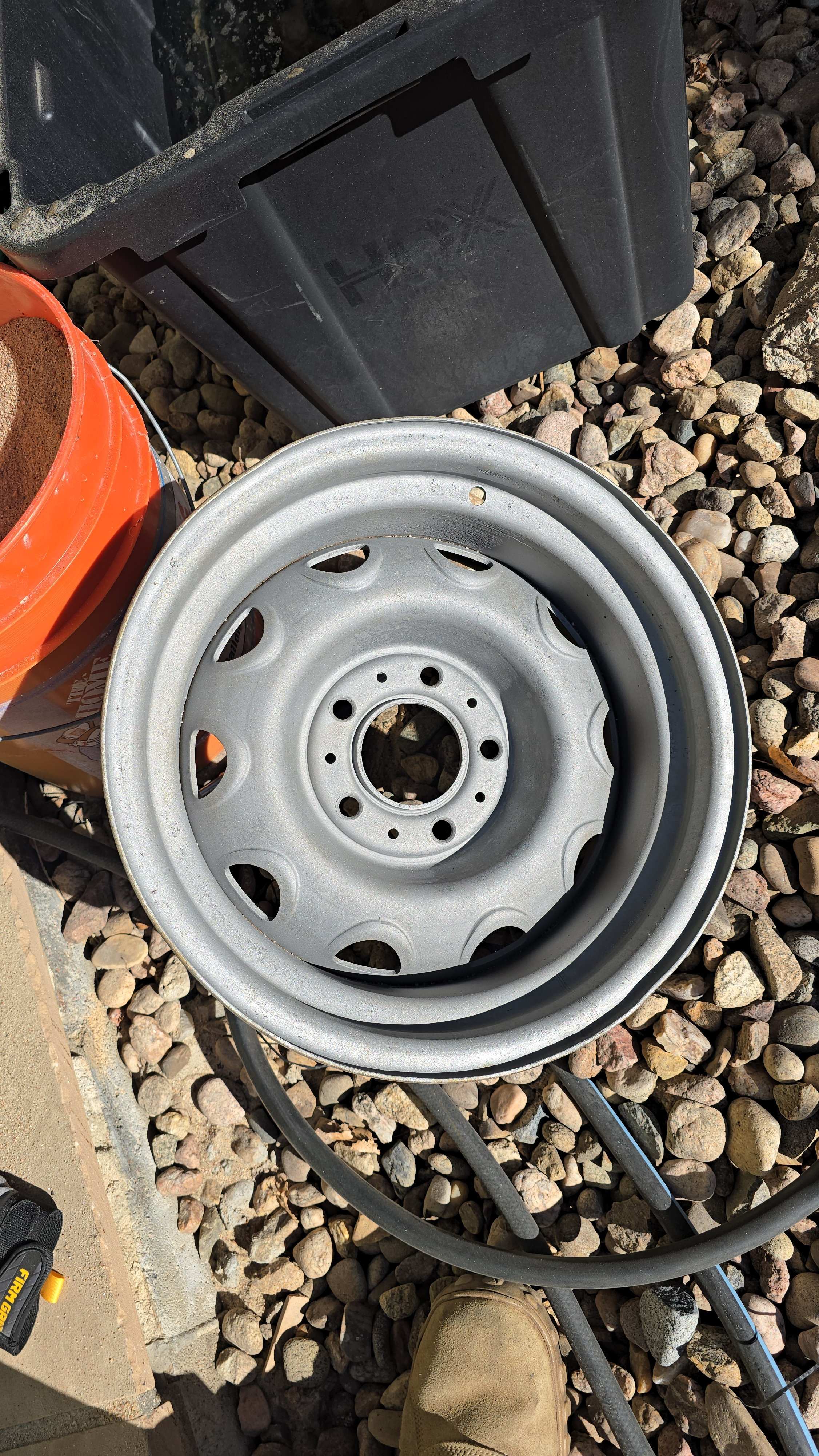

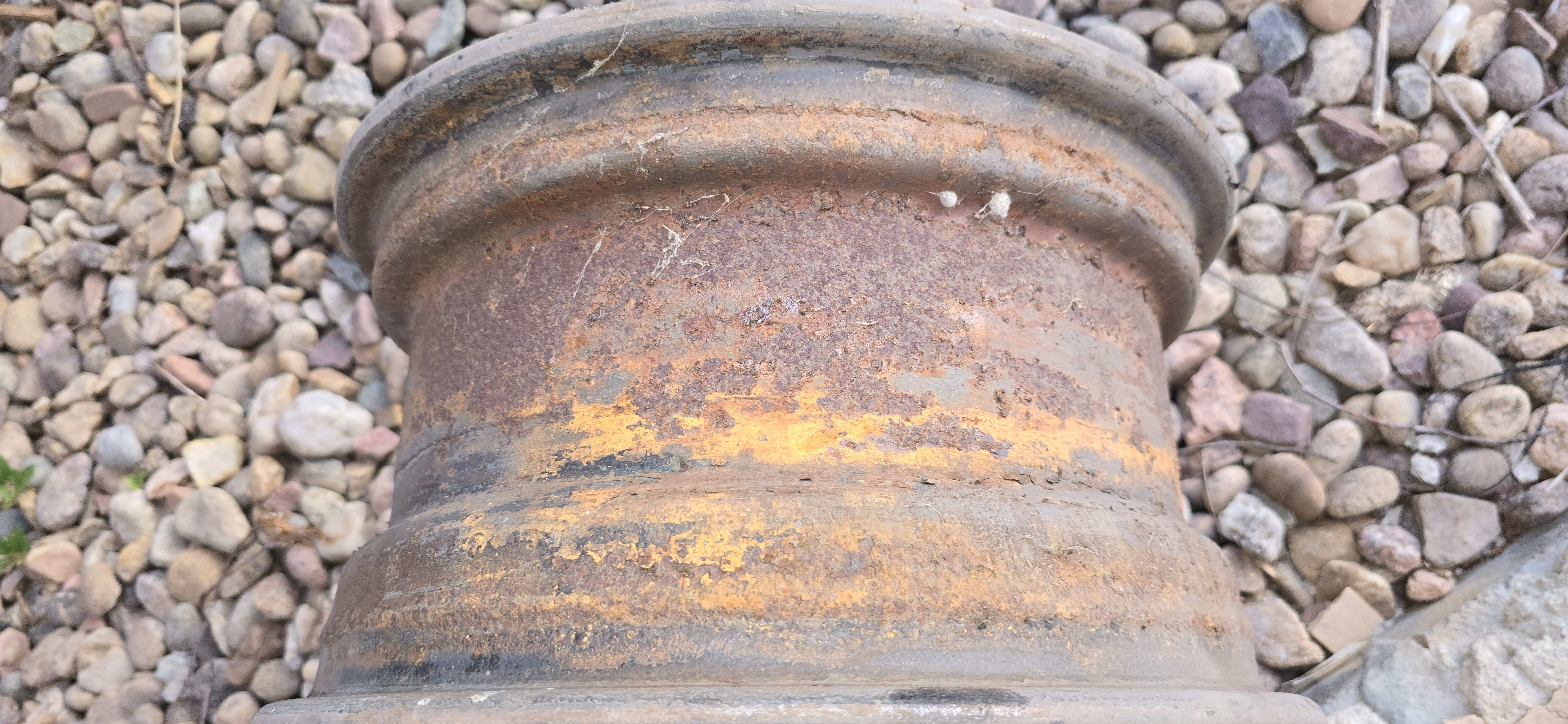

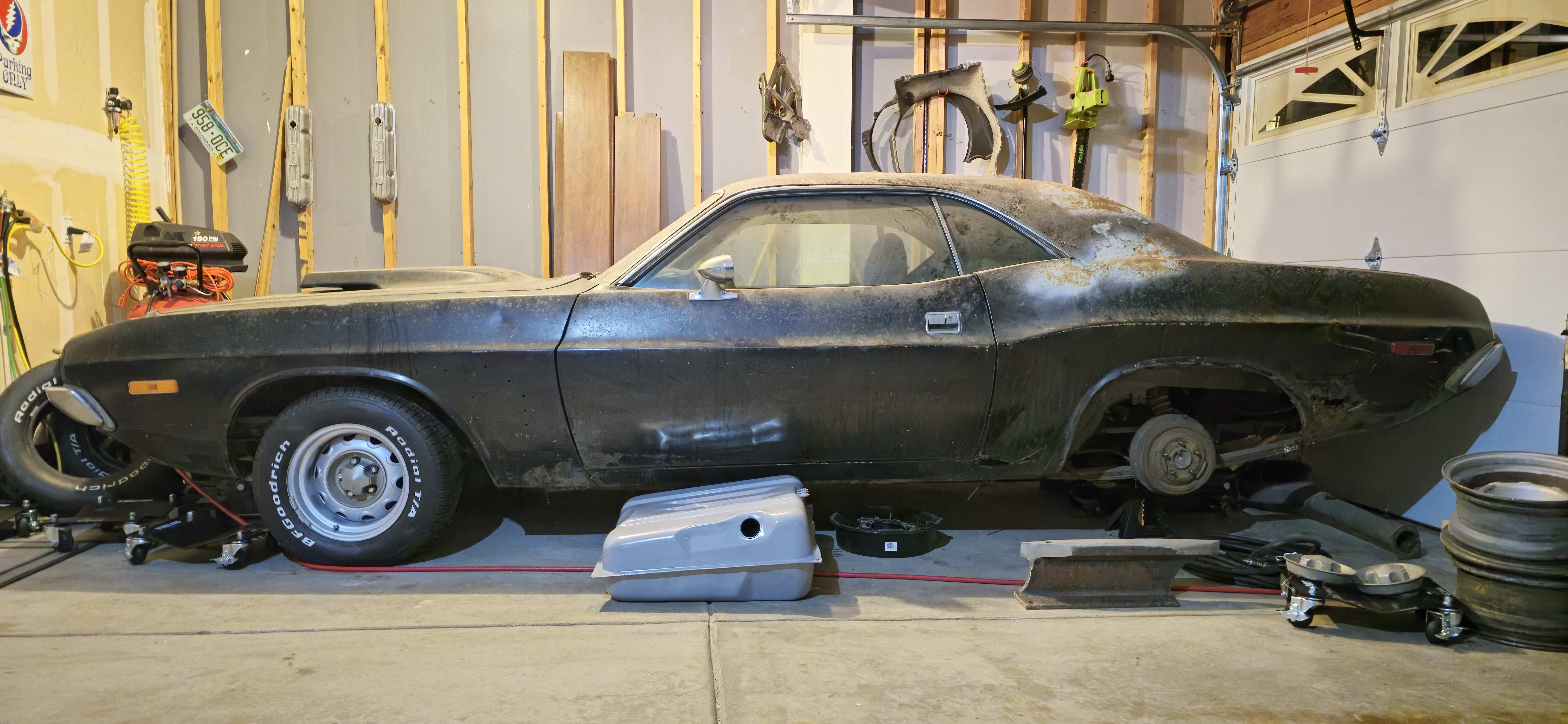

Over the last few weekends, I sandblasted 33 years of grime and rust off the 14x8 Rallye wheels. Yup, I widened the originals almost 40 years ago. They have a 4-inch (not 4.5) backspacing. I also put some rattle-can aluminum on them to hold back any rust temporarily until I can find someone to powder coat them in the right color.

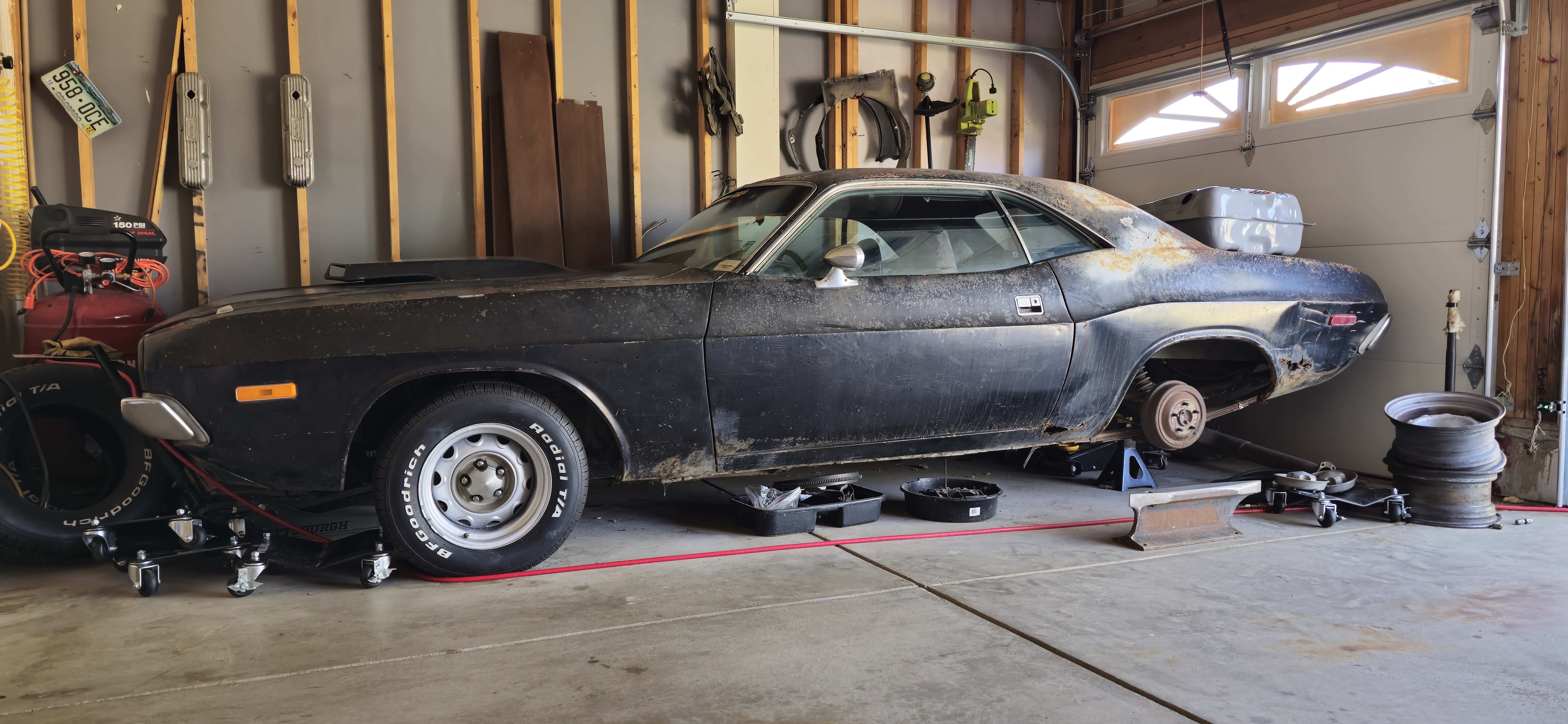

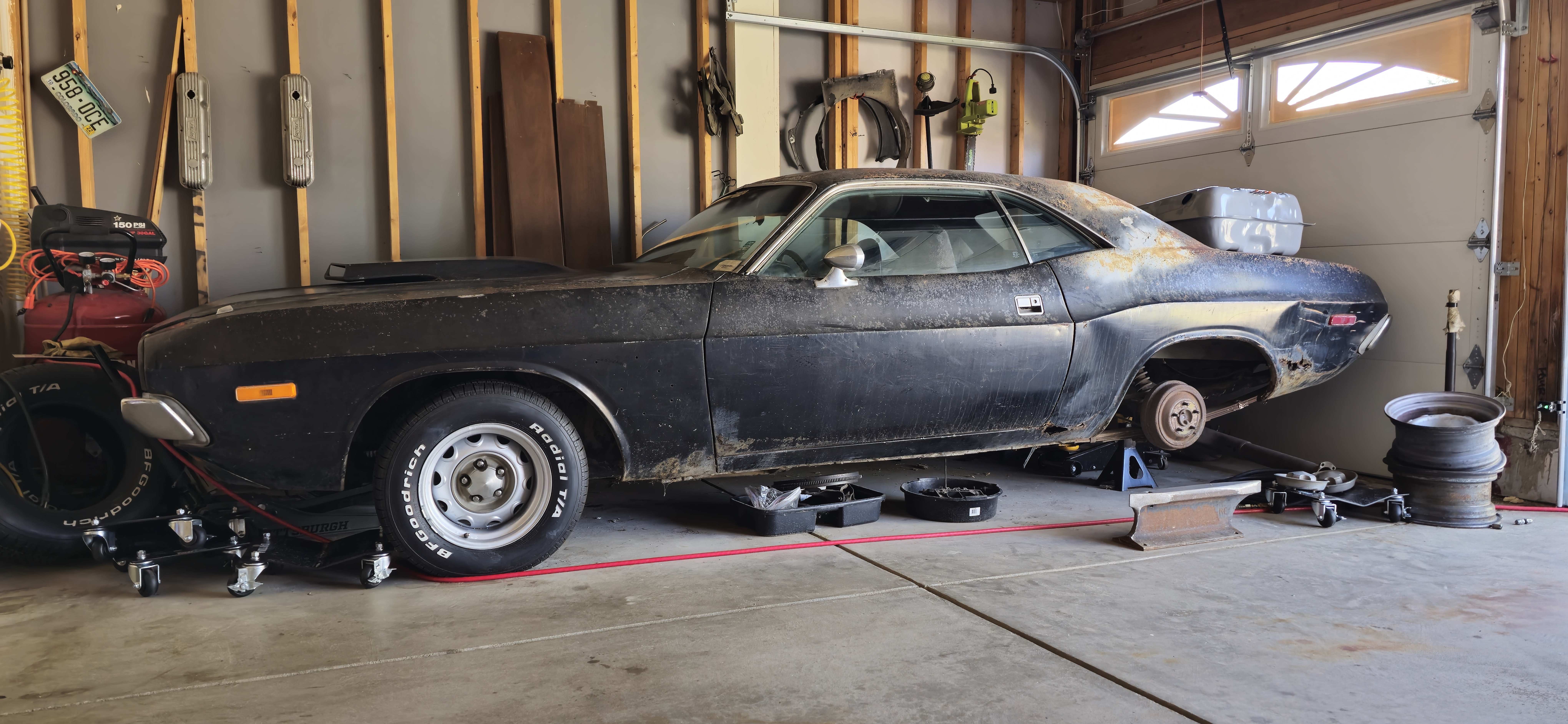

Grabbed new BFG TA P23560R14's (front) and P24560R14's (rear), ordered up a new fuel tank, sending unit, tank straps/hooks/insulators (still inbound), and found a superb condition Rallye hood locally.
I am working on draining the fluids and prepping the engine to fire up for the first time in well over a decade.
The sheet metal has lots of surface rust, all from the ash acting like sandpaper and acid on the thin black lacquer paint job done in 83. When I bought her, the undercarriage was heavily undercoated (factory); there is no immediate sign of rot in the floor, firewall, subframe connectors, spring perches, or trunk pan.
The truck lid is shot, the deck filler between the rear window and trunk needs to be replaced, and the area along the drip rails on both sides has rust pinholes. I'm pretty sure the roof, rear roof brace, side braces, and drip rails, along with the rear quarter panels, are all going to have to be replaced.
There is a lot to do. I will post here periodically as I start to take things apart and put them back together.

I love the torque strap (chain) on the driver's side. Once you find main caps (getting hard to find), they will need to save the caps and line bore and hone the mains. At that point, they can deck the block to square it up and then bore and hone the cylinders. Everything else can be gotten pretty easily or even used from your 318 (timing cover and oil pan).
