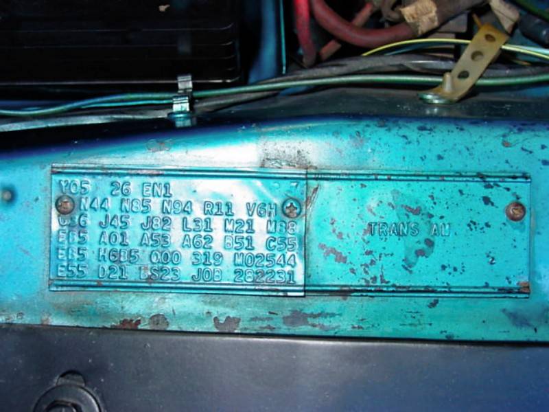

Only the later fender tags were stamped with the L34 code. Most '70 'Cudas that I have owned were missing the roadlamps. Here is the tag from my current cuda project. Later than your's and still no L34. Being that you cuda has the A62 ralley cluster, the switch would have been mounted under the dash frame.
