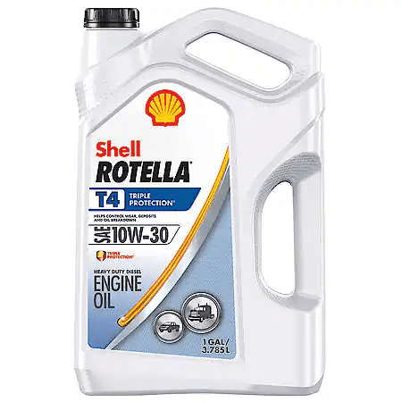

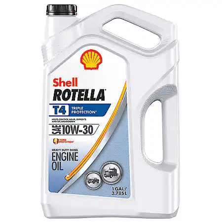

Rotella oil is ideal for older cars without catalytic converters and for which zinc was a requirement at the time for engine oil. It eliminates the need for adding a zinc additive to modern oils.

Rotella oil is ideal for older cars without catalytic converters and for which zinc was a requirement at the time for engine oil. It eliminates the need for adding a zinc additive to modern oils.View attachment 123102
Sadly, Rotella no longer has sufficient zinc and phosphorus additives for use with flat tappets. Also little packets or bottles of ZDDP additives don't work either. Driven brand oil is the best for flat tappet cams. Lucas and Brad Penn also make such an oil. There may be other brands. The new flat tappets are mostly defective due to having the faces ground incorrectly. If you can find NOS or NORS lifters it would be best or go with a roller cam.
