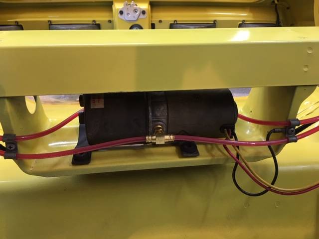

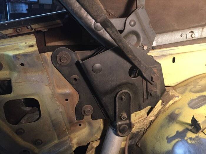

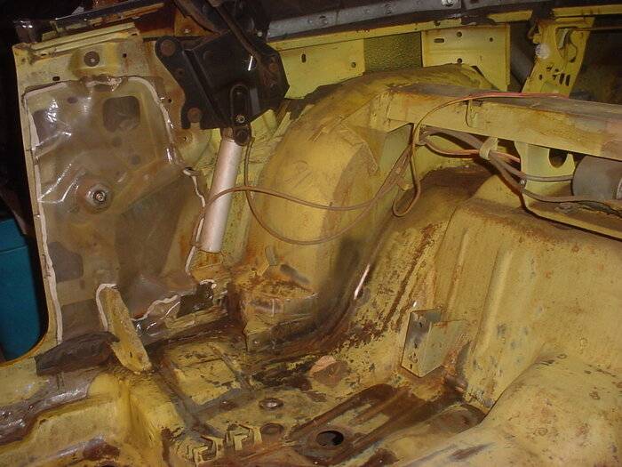

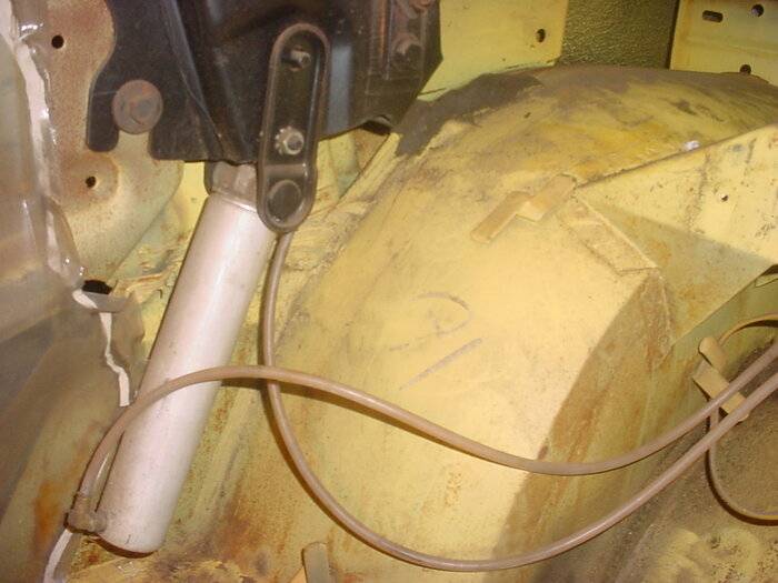

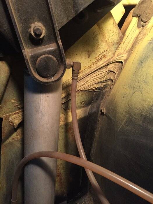

OK, Pump is here, Hose is here and Cylinders will be here tomorrow. Looks like I know what I am doing this weekend. I checked the switch and harness, all is good. I am removing nothing because as I said there is nothing there. Just want to make sure everything goes in correct. From all the pictures sent (Thank You again) the pump goes in with the harness towards the drivers side, which makes sense because the switch harness comes out there. The hose from the back (harness side, facing seat) goes to the bottom of the cylinder, and the hose from the trunk side goes to the top of the cylinder. I was hoping to use a clear fluid like jack oil or ISO-32 hydraulic oil (power pole) the shop I got the pump from said any ATF but recommended Dexron III, so Dexron it is.
Well everything is in, Top goes down OK, needs a little push for the front section to break center than it drops fine. I am sure gravity has a lot to do with that. UP is another story, top will only come out of the well about 4 inches, I can reach back and give it some help, once it gets about straight up gravity again takes over and closes it. Pump is full, no leaks and no air in the lines. I am really disappointed. Tomorrow I am going to lube all the pivot points. Just wanted to post an update and see if there was any advice.

I'd bet its air or maybe a weak pump.
Air compresses more than fluid so...
These two photos are from the Service Manual. Point is fill it down and then run it up and down a bunch. A whole bunch.
I had mine out on a frame rack I built from scrap wood and it takes forever to get the air out. Flicking the lines would cause the air bubbles to 'leak side ways' and climb up the tubes to the reservoir. Eventually they all got there and the ease of operation was much better and the noise was much lower. All this without cables or a top. I did it twice bc I decided to use my old pump and after the system sat for a week I noticed the pump spotting so I opened up the system and rebuilt the pump- basically a seal kit. The second time assembly and bleeding the air was easier bc I new I had to be patient chasing bubbles. Dips or low spots in the lines make it impossible for the bubbles to climb to the reservoir. Sometimes you just gotta walk away and they'll move up on their own.

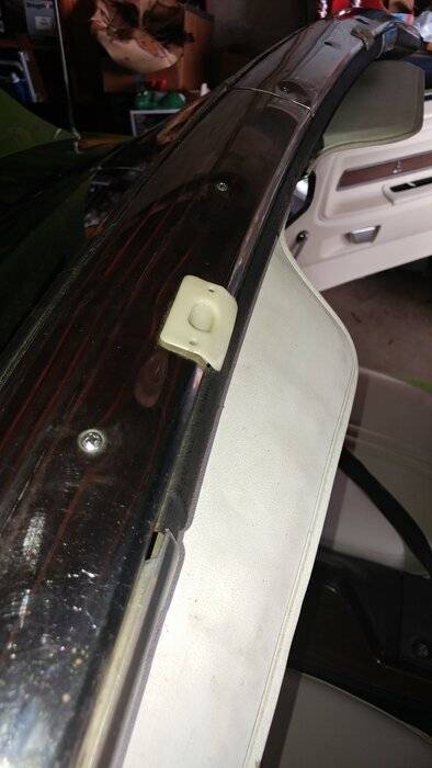

Another unrelated question - does the plastic anti-rattle piece go below or above the stainless header trim? Thanks
Convertible Top works. Air was the correct answer, Anyone who said Air gets a gold star (RJHJR). Thank you everyone for the fantastic pictures, manual information and advice. Now to put the rear interior back together.

Thanks Jeff on the anti-rattle, but wondering........ I've seen a couple e-bodies with the screws through the anti-rattle plastic, but the cast bracket the anti-rattle sits in does not have any threaded holes. Is this a 1971 Challenger change?
I have a 1970. The repro anti-rattle I bought years ago fit terrible. This is why I was wondering if they went under the stainless trim.
Someone please also verify. Thanks
