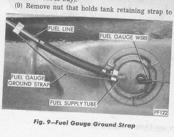

Remove drivers kick panel unplug rear body plug and test can be made from there. Also check ground strap on gas tank.
