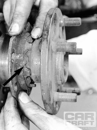

How does one adjust the rear axle bearings? I have the same issue as you did and have 3 degrees on both ends of my drive shaft as the tremec instructions for my tko600 that I installed. I was actually looking at getting new axles with new "green" bearings for when I put wilwood discs on the rear. Anyone have any insight?
It's a little hard to see in the photo, but behind the right hand axle flange is a large slotted adjusting nut. Adjust it per the factory service manual. One of the nuts on the backing plate has a flat type washer with a tang to lock the adjusting ring in place.
I will take a peek at my 73 chasis service manual sometime this next week. I have a vibration that resonates. As in it comes and goes for a second and then smooth and then back to vibrating again at 64 mph.
