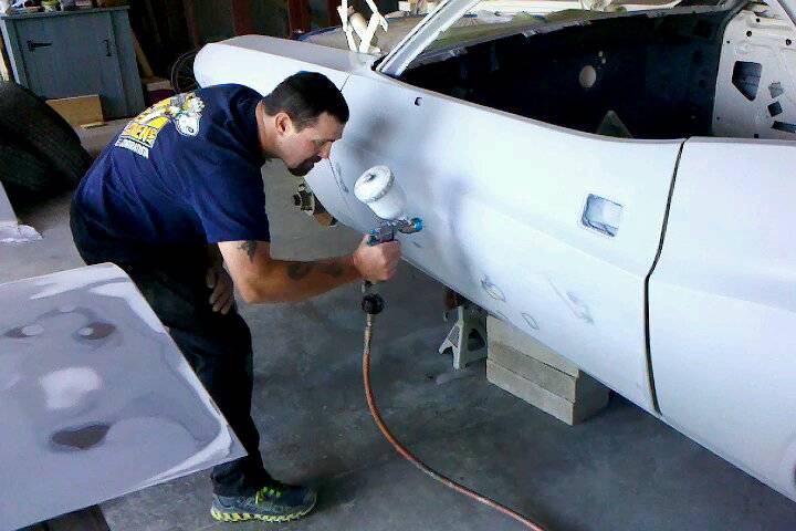

So far this year I have put about 11,000 miles on my Dodge Challenger project that took almost 4 years to restore. I love driving it. This project is by far one of the coolest things I have ever achieved in my life. Everyone that looks at it is amazed at the condition its in. By far the most noticeable part about the car is the paint job. The paint shines like glass. The car was painted in my garage by a good friend and coworker of mine by the name of JD Loring. He coached me on the process to creating a great paint job. His energy and enthusiasm was unmatched and priceless to me. We had a lot of fun with the paint process and the project as a whole. Today is a very sad day. Yesterday JD decided to end his life by committing suicide. JD was married and has a son who recently graduated from high school. He was a great man. I have known JD for many years and always loved his enthusiasm and energy at work and play. All of my customers loved the guy and thought he was the best at what he did working the counter for the F.W. Webb company in Lebanon, NH. This is a shock to many, many people who knew JD. He will be missed very much. I will think of him every time I take my car for a ride.

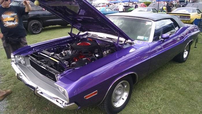

"Ding, ding, ding, ding"!!!!! You are the winner quapman!!! I am not a mechanic but I am learning new things about my car every day. I just needed to adjust the rear bearings. Once I learned how to do that, NO MORE VIBRATION!. Perhaps you heard me screaming in joy when I took it out for a test drive on the highway up here in Vermont after getting them adjusted. Drove it down to the Chrysler Nats. in Carlisle, PA a few weeks ago ab out 400+ miles away. I think I had a "sh1t eatin grin" on my face the whole way (lol). I threw in the 276 rear diff of off of my parts car for the highway drive. I actually love that gear but it can be a challenge no to smoke the clutch when I need to start out going uphill.
I was surprised that I did not get any better mileage with the 276 vs the 355 gear?? That being said, I think I will stick with the 355.
