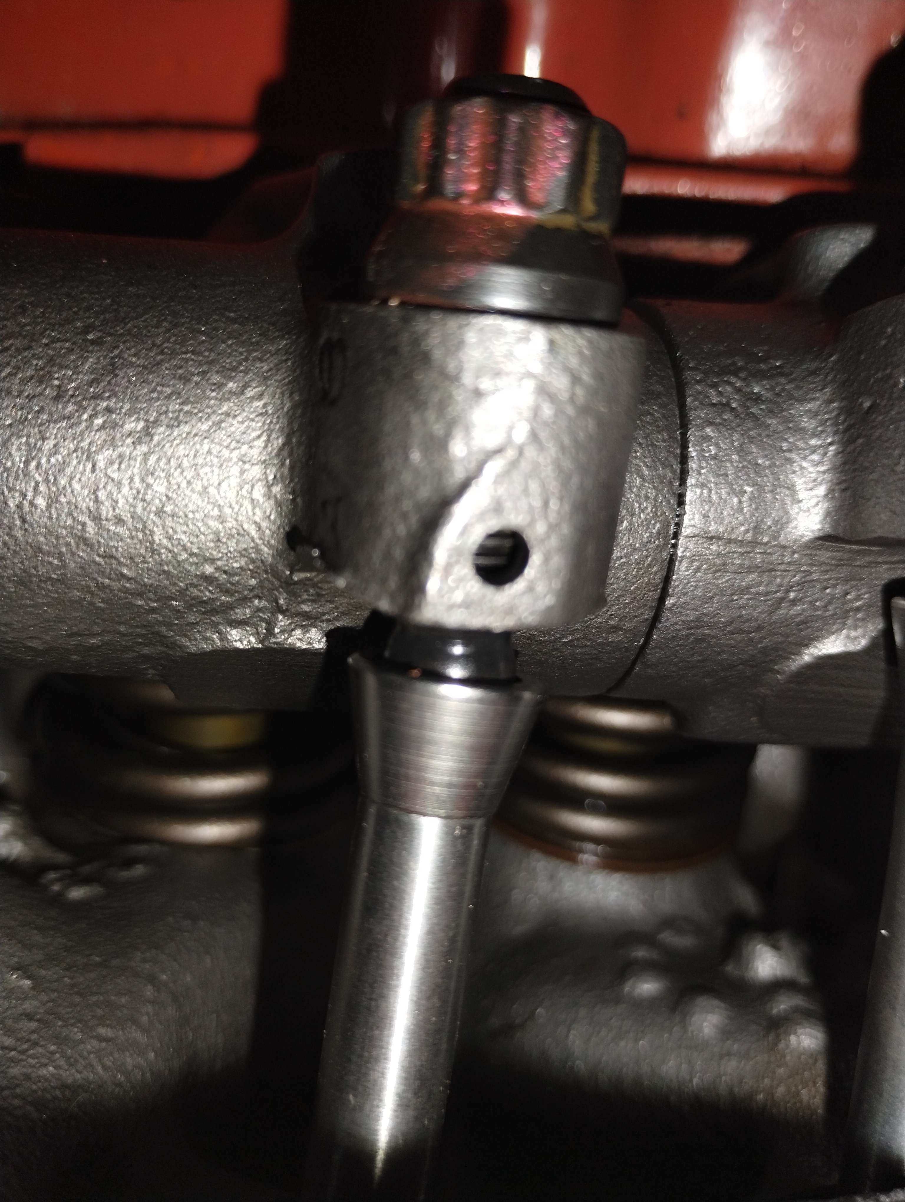

My only concern is the pushrod length. They're about 1/8" longer. The hydraulic lifters can safely adjust for about .080" running. You may have the plunger close to bottoming out now! You've run the engine with the longer pushrods for 100 miles?? What rpm??? How far are the rocker arm adjustment screws sticking out? you want 1 1/2 to 2 threads. Are you at just about no threads below the rocker with the longer push rods?? Pictures might help!

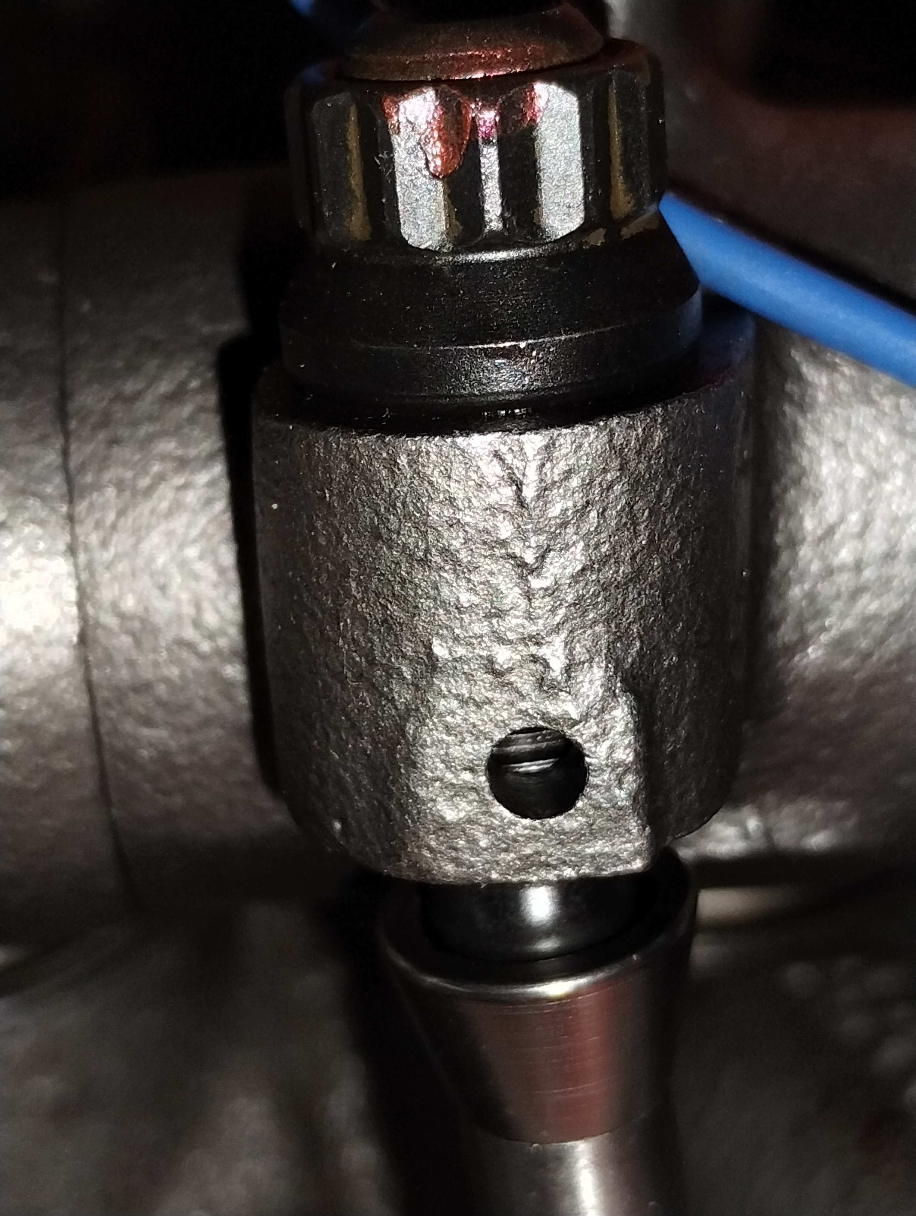

Figuring out what pushrod to use wasn't easy. Doing research I found a lot of conflicting info on what pushrod to use. The pushrods I used are the ones listed to use on multple websites including Mancini Racing Comp Cams Magnum Pushrods . One piece of info I could not verify is: is the 7.23 pushrod length for a TA engine overall length or effective length (tip to bottom of cup)? The ones I used is overall length.
100 miles is probably high. Onto a trailer, off trailer and cruising at Chryslers at Carlisle, back onto trailer, off trailer. Cruising speed.
When I had the rockers and shafts restored, I changed the adjusters as can be seen on the pics.
If you have a suggestion for another pushrod to use please let me know. I have no problem swapping them out.

"One piece of info I could not verify is: is the 7.23 pushrod length for a TA engine overall length or effective length (tip to bottom of cup)? The ones I used is overall length."
Great point! I'll go out on a limb and say the effective length is 7.23". So in that case, your 7.389" pushrods are in the ball park. You should be good to go! Pictures look good!
Thanks for your feedback and reviewing the pics.While I was researching the proper pushrod length, I did assume that 7.23 length was the effective lenght. I am going to check the preload of the lifters again before I start it to make sure the geometry still looks ok. It always helps to get feedback to verify what I did is OK. This stuff can be tricky

The best way to check the preload is to take one lifter out and make sure all the oil is out (they're easy to dissemble). then you can see how far you're pushing the cup of the lifter in. Best of luck and keep us posted. I'm guessing you'll be OK, but now is the time to check. Blue printing (checking all dimensions) is a very good thing.

pushrods are too long - there should be at least 1 thread showing below the rocker arm - look it up - it is in the mopar engine book! preload should be 0.040 to 0.060. One turn of the screw is 0.040.
