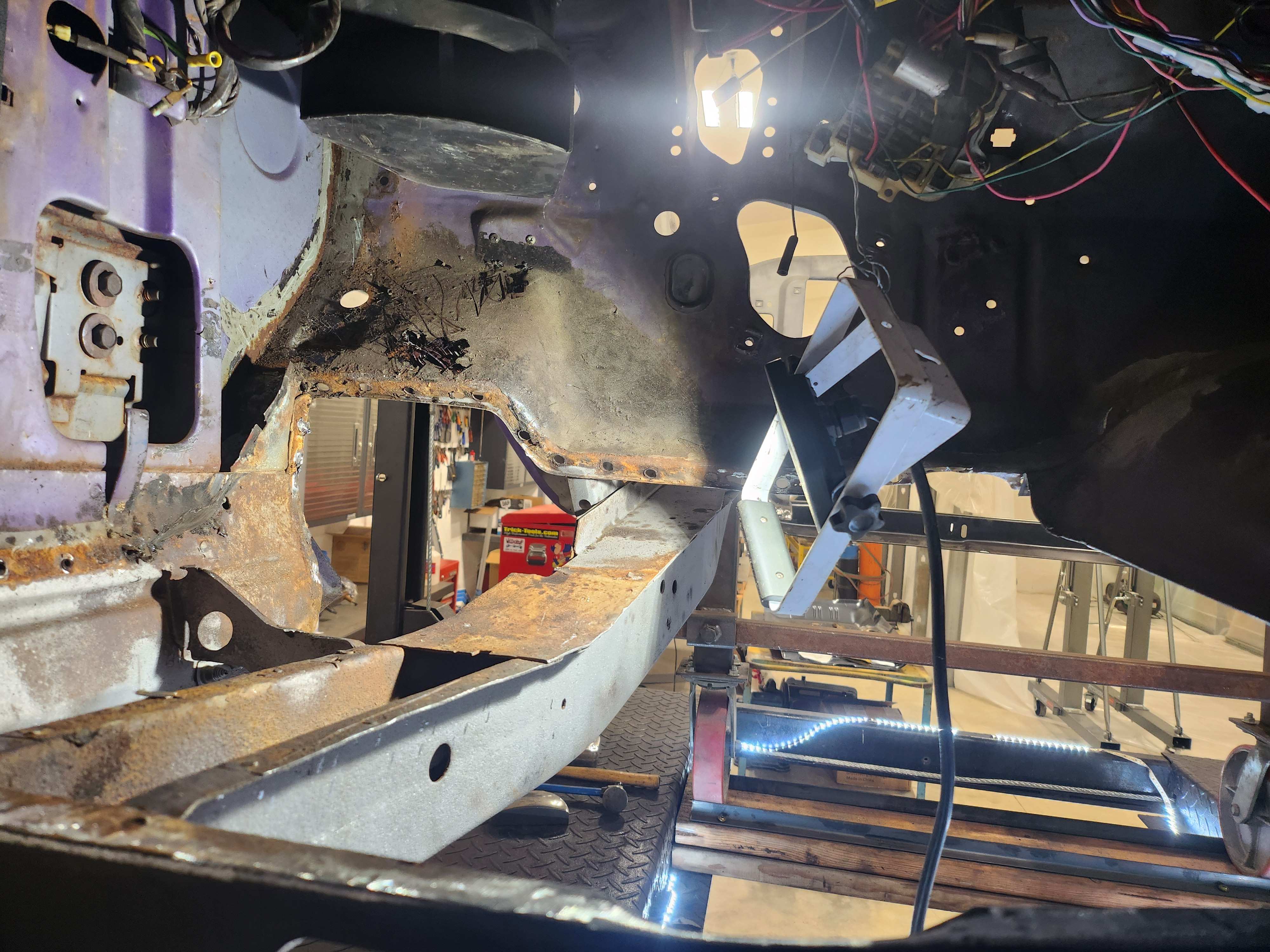

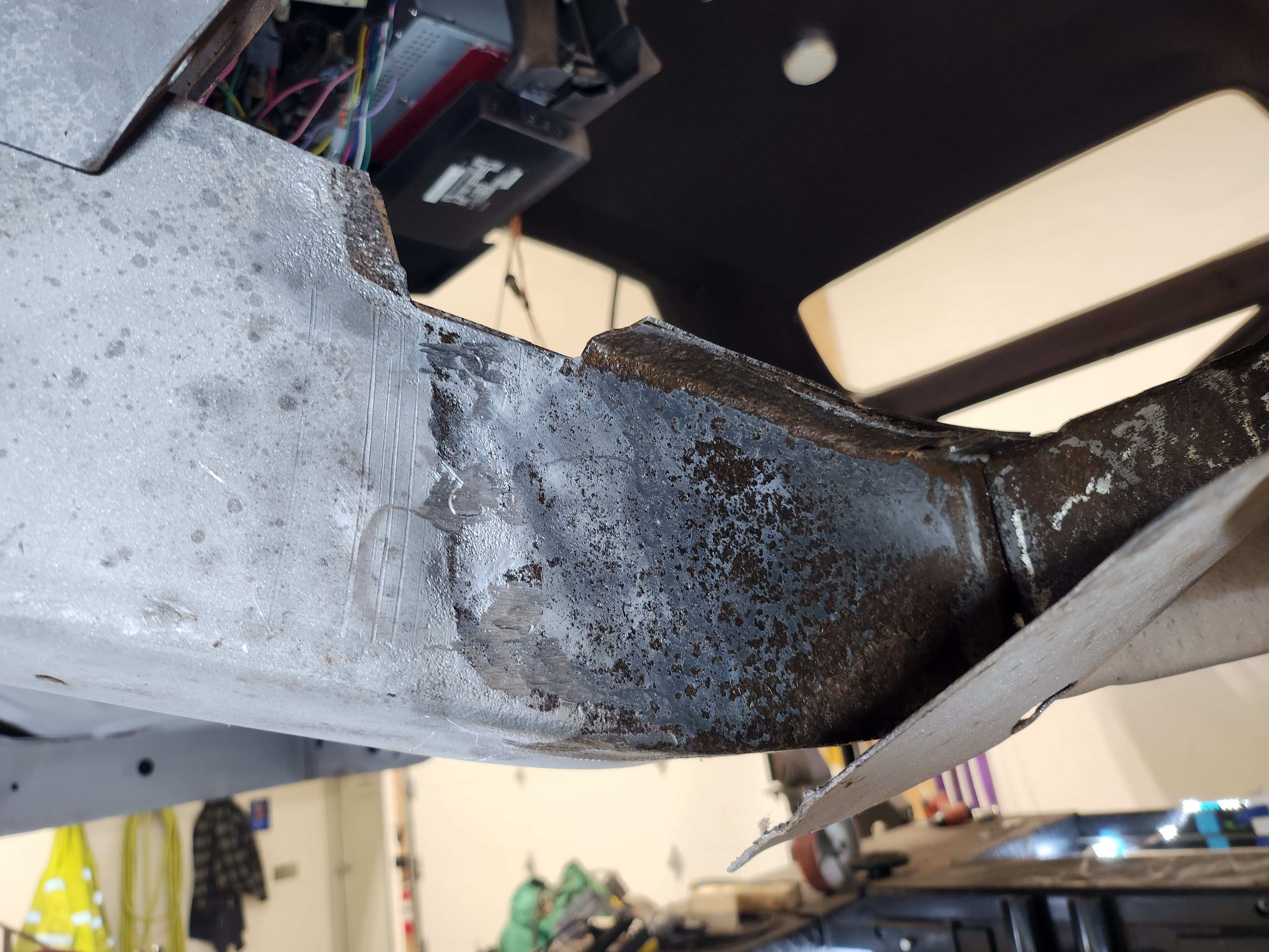

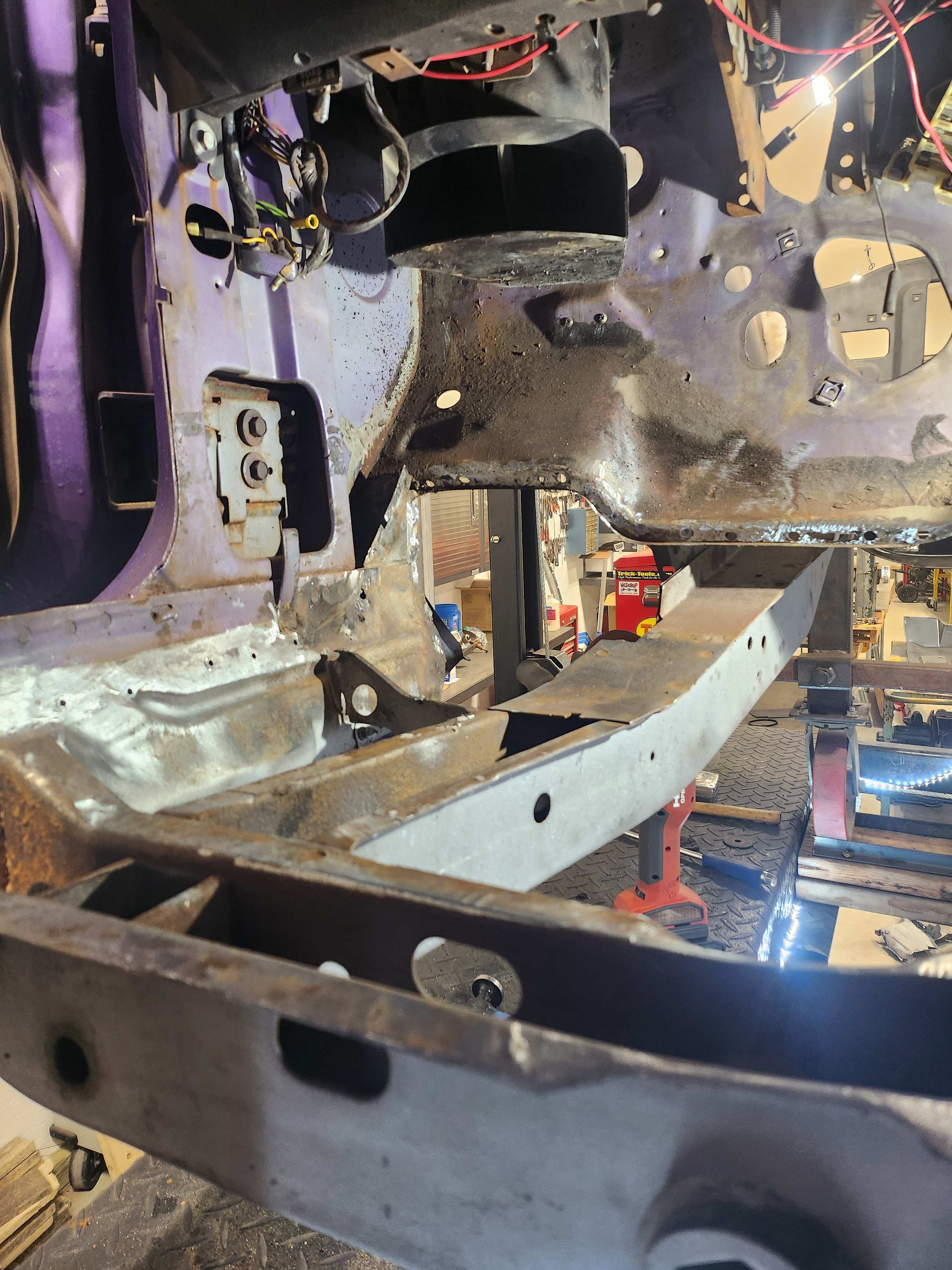

in reverse this morning again, removed the splash shield from the rocker to floor pan, ground and sanded the crust back to metal, will treat with afterblast (the acid and nickel phosphate). and wipe it down and wait for the new metal coming friday.

leaves a nickel film and stops flash rust before prime
don selleck
Dec 8, 2022
401
420
michigan usa
well up at 5am this morning, got my metal splash shield/ floorboard support yesterday. treated it with afterblast. went out this morning heated up area with heat gun to ensure it dried, turned the heat up in the shop and blasted some etching primer inside the exposed frame rails. only 17 degrees this morning with wind chills around 4 I believe, brr. I usually crack the front overhead door and turn the upper exhaust fan on to vent of the fumes, but too damn cold so evacuated the shop for an hour or so to let the stink settle. Going to prep the supports and floor pan and get ready for install. this is the last major weld left on the car, have a few small crusty spots in the engine compartment, and it should be ready for epoxy metal primer. can't wait!

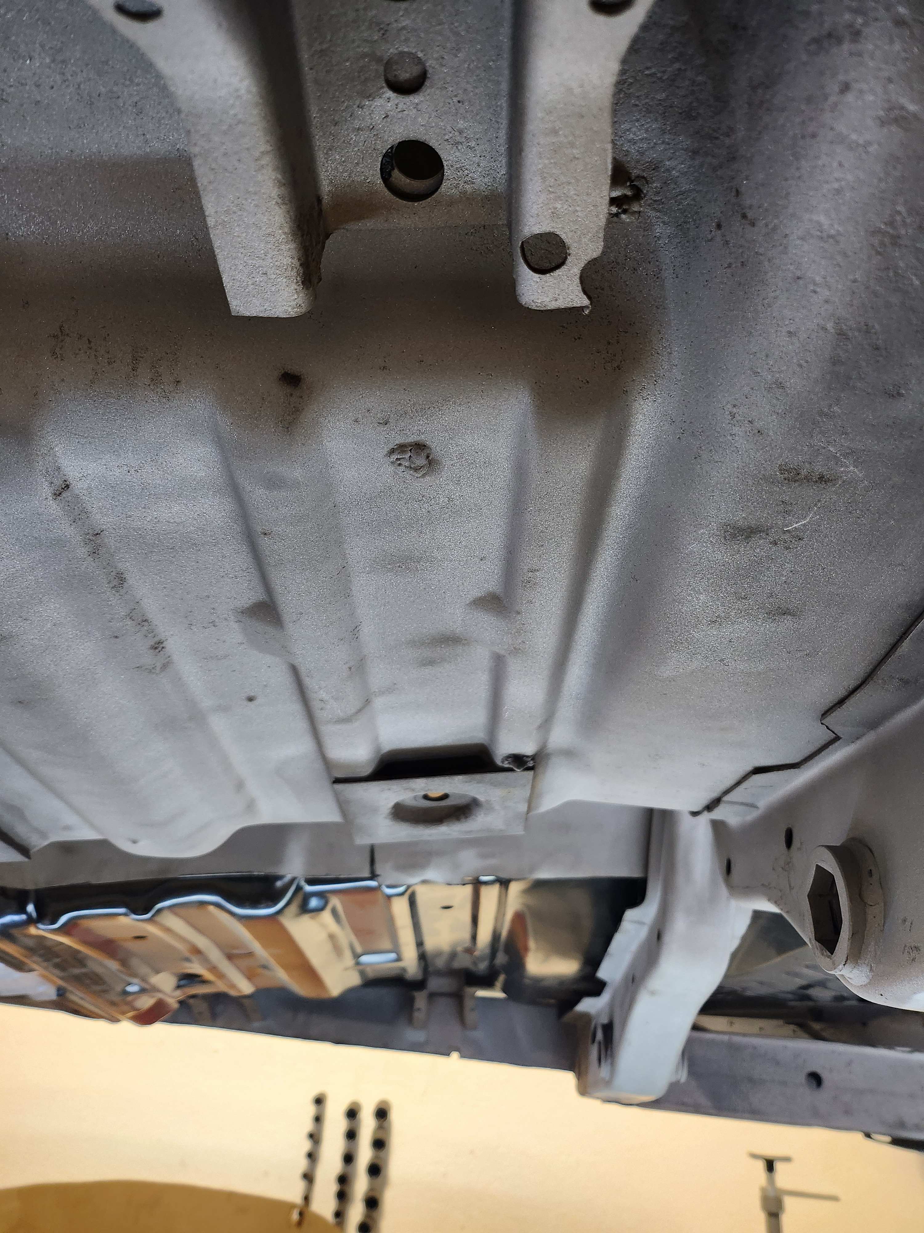

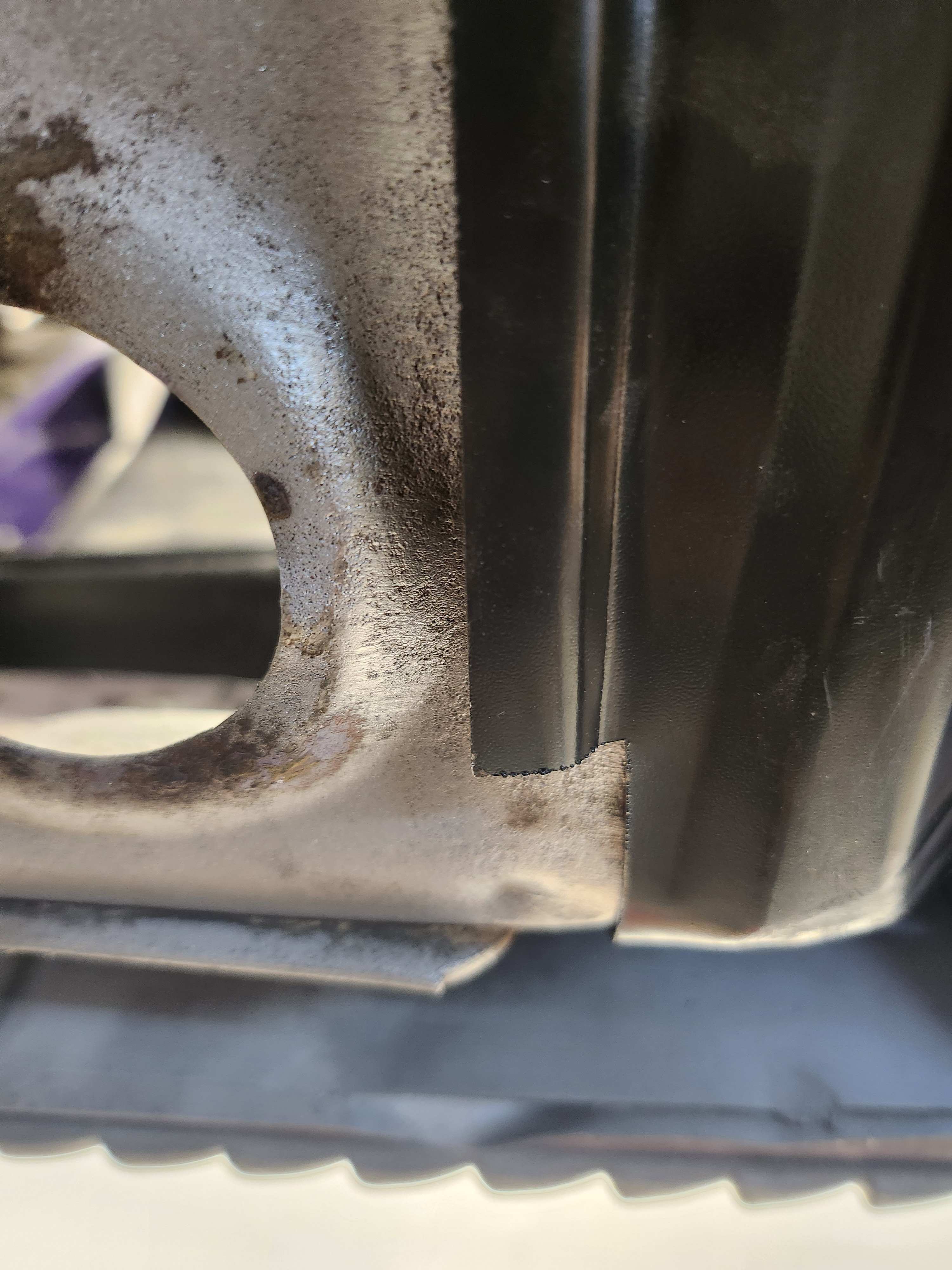

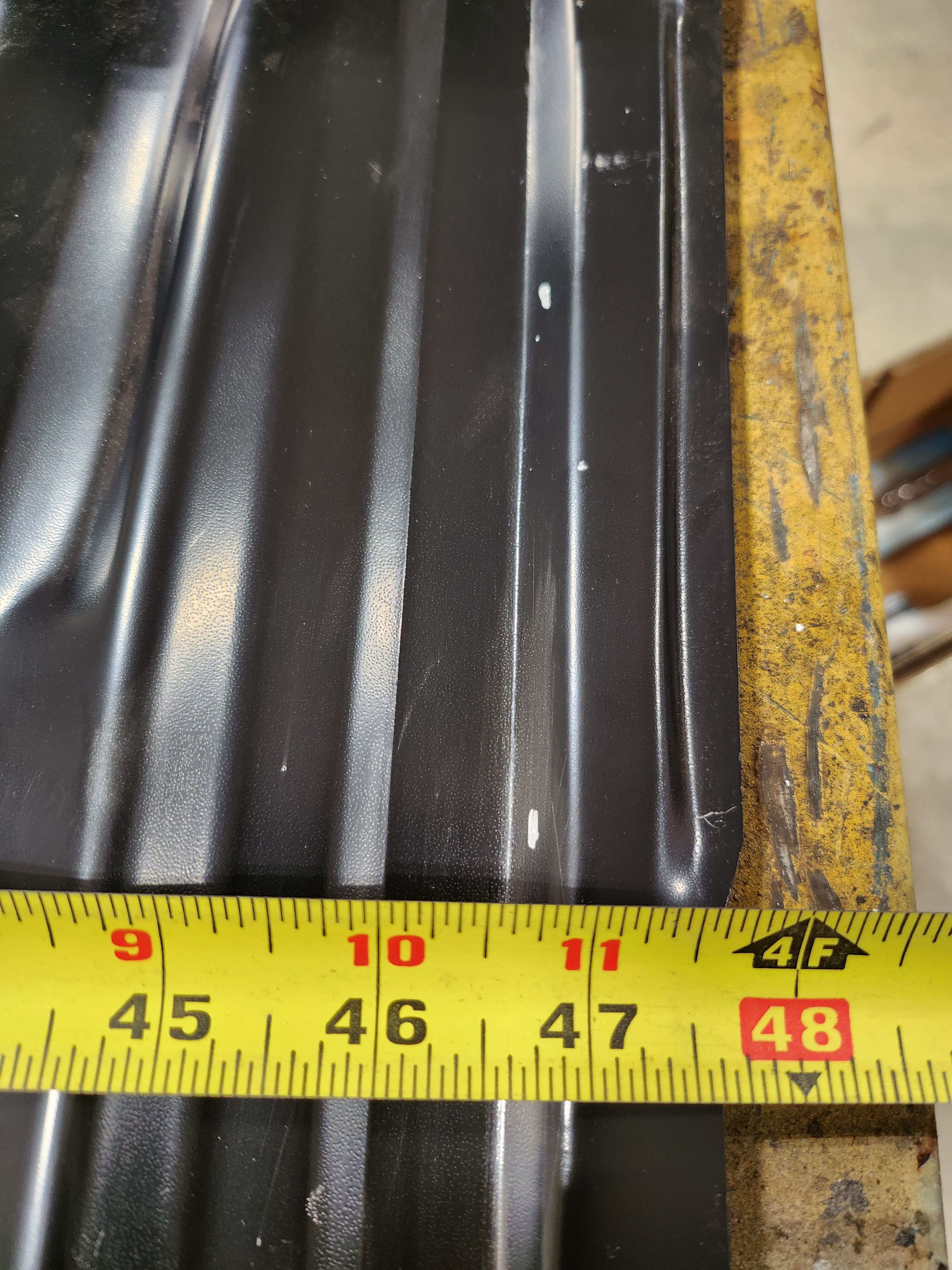

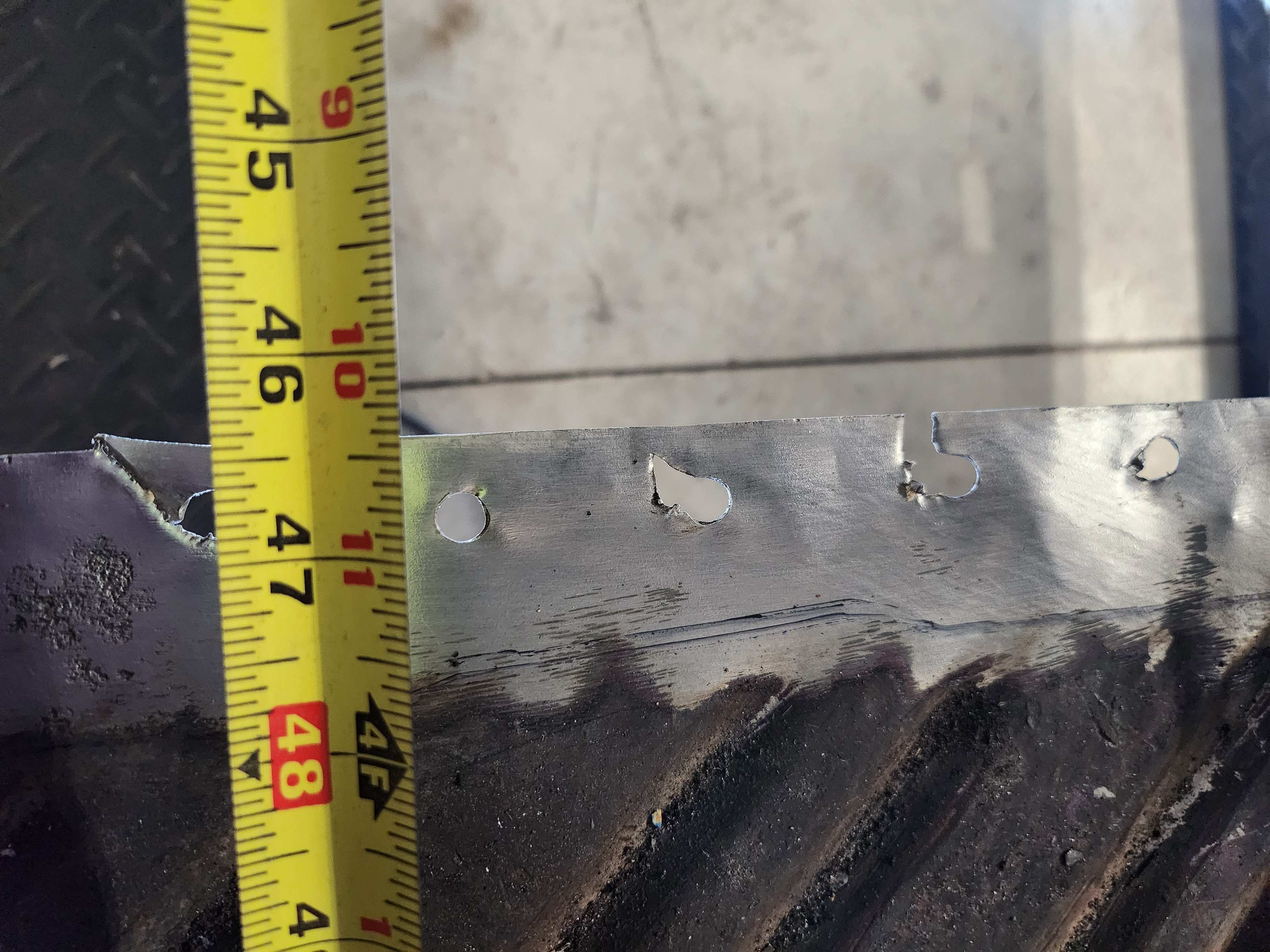

well started fitting the pan had to slide the back end under the rear pan, then over the trans tunnel and back up to the flange in the engine compartment, will cut the trans tunnel, since it is now overlapped with a 1/32" air cutting wheel after the front, rocker side, and frame rail are secured, as of now it looks like it is about 5/8" too long for it to line up with the ribbing on the other side, the silver dashes are where the panels will overlap, 48" is where it is but front wont clear the firewall flange to 48 5/8" the length of the new pan. as you can see the ribbing lines up now underneath but it is also not sitting flat on the frame rails either , so it needs to go down which will shorten the length. I'm going To cut reliefs in the edges of the pan over the torsion bar crossmember and push it down to see if the extra 5/8" disappears. I will be amazed if this loses all of the 5/8" and the front flange pops in. We will see tomorrrow. I'm done for the day actually about 4 hours ago. wanna go out and look harder at it later tonight to see if I can

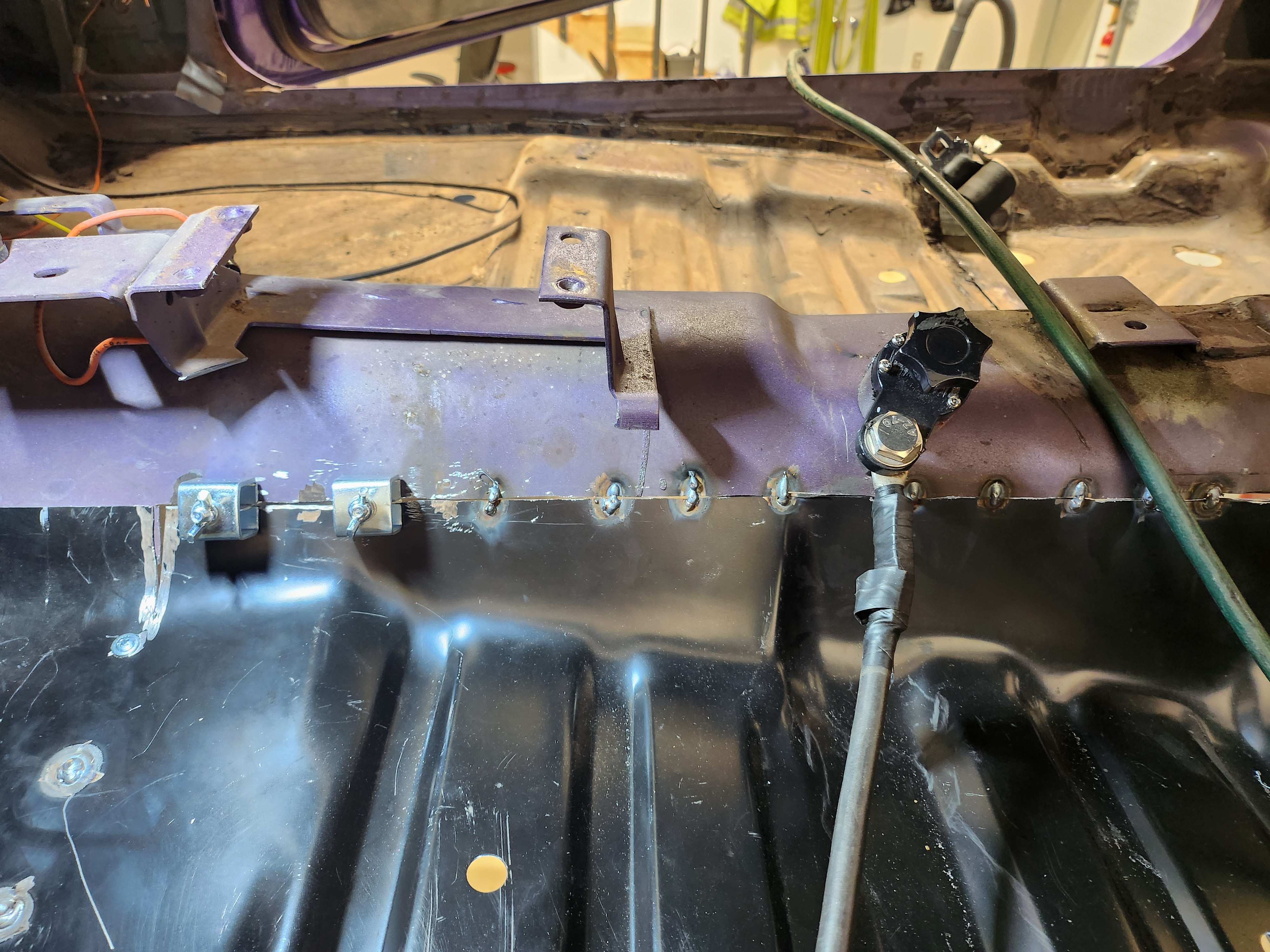

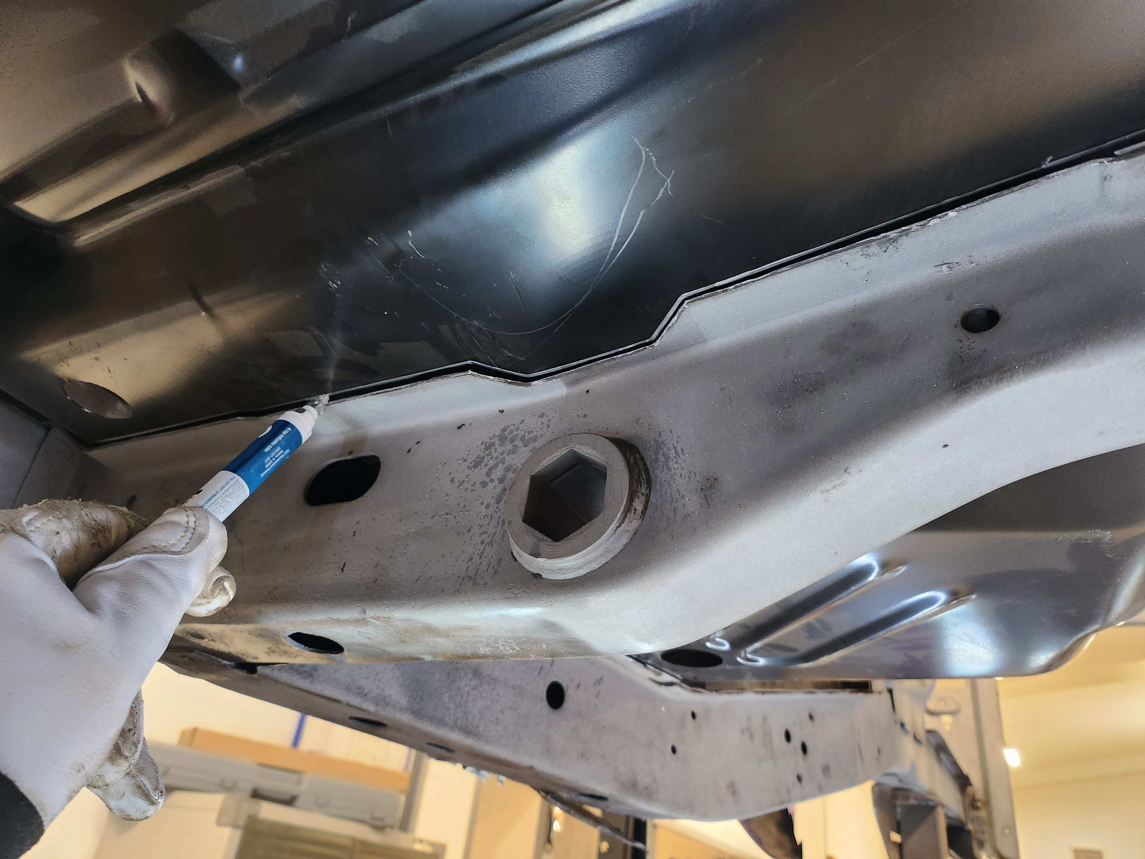

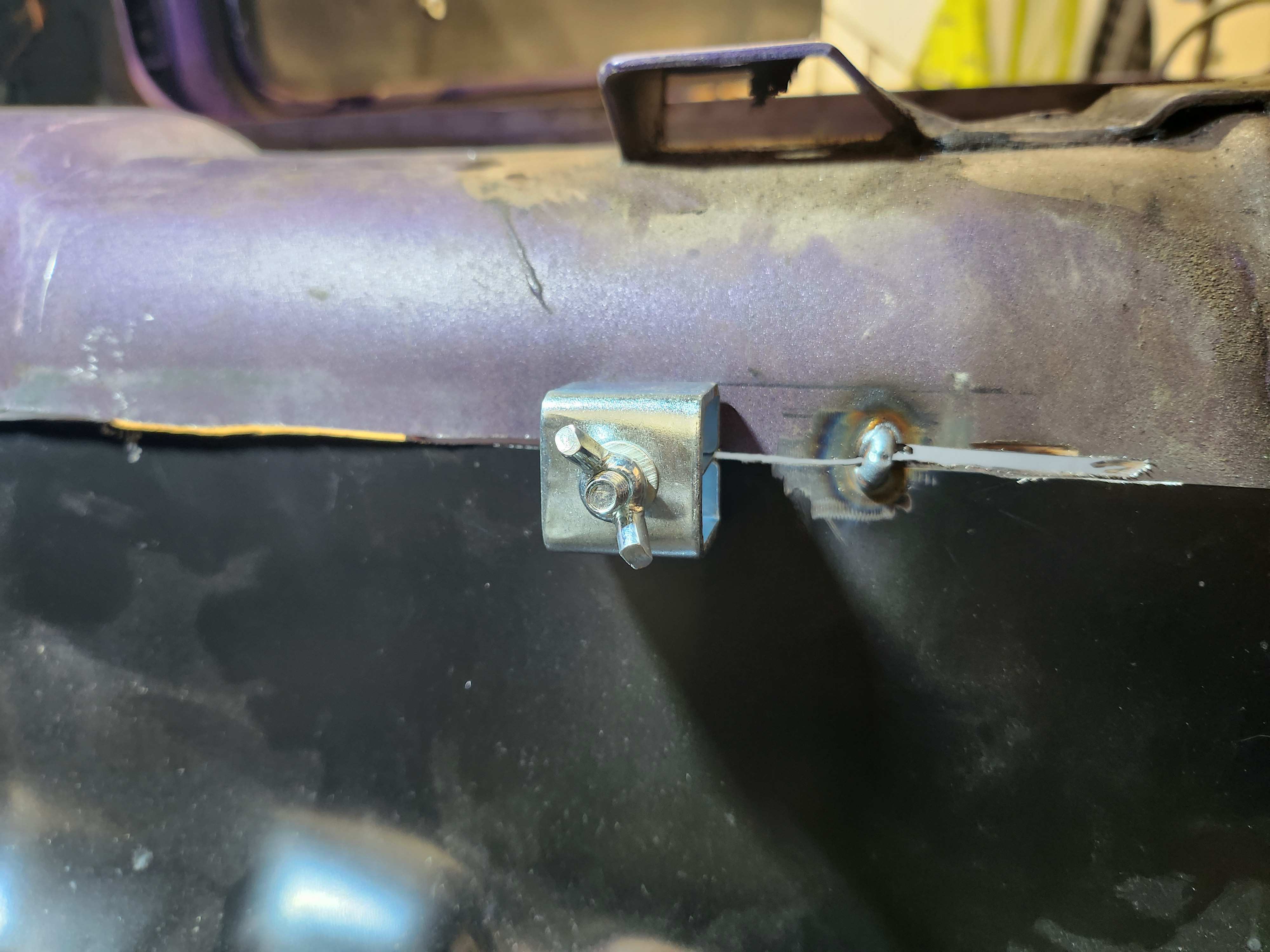

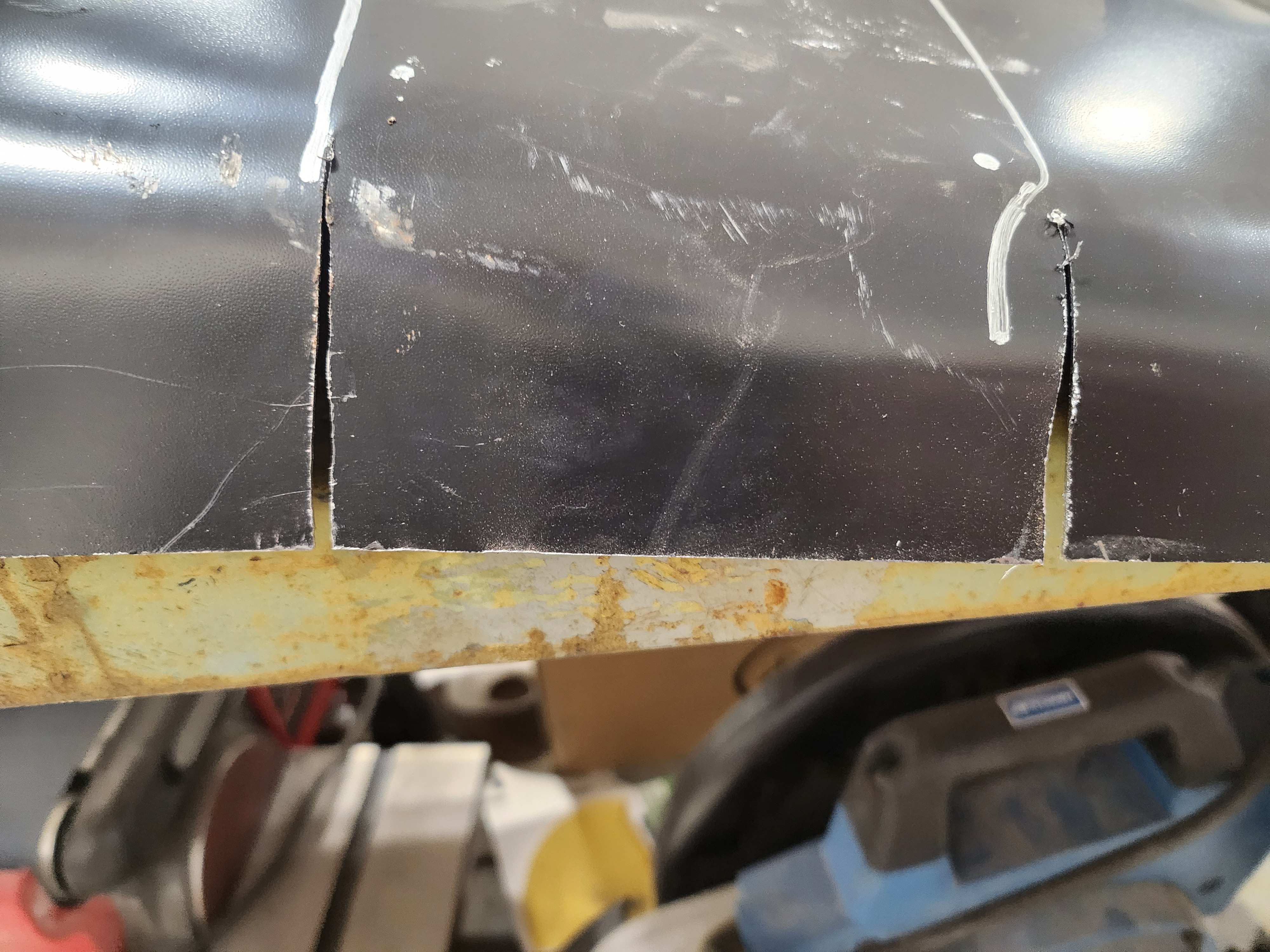

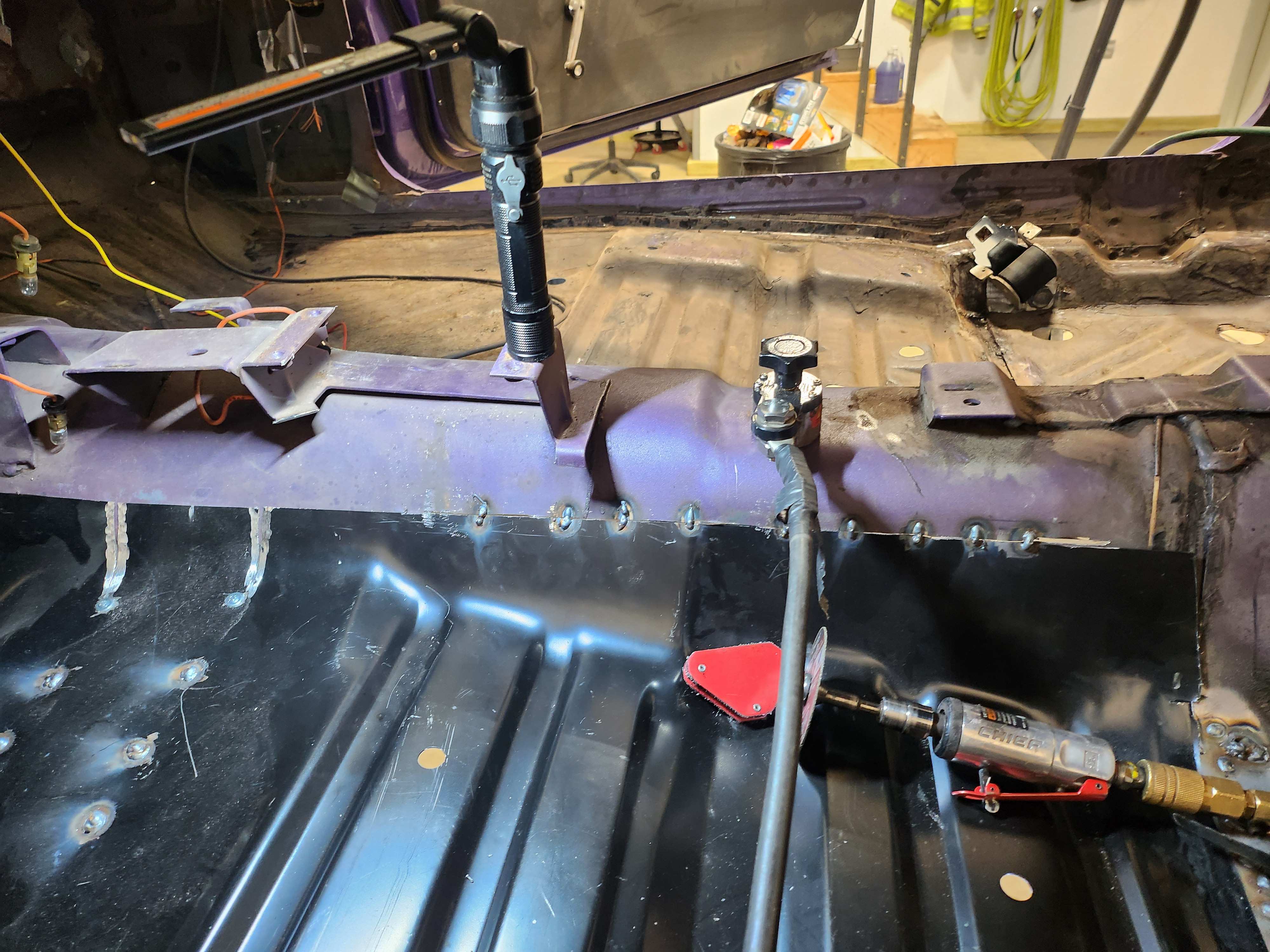

pin pointed out where the floor pan lands on the torsion bar crossmember, ended up cutting 2 relief cuts on the outside edge on each side of the pan letting the panel flex down without wrinkling the edge and
create a flat spot that flushes to the crossmember, the extra 5/8" length was completely swallowed up and the pan line up is nearly perfect. Hats off to AMD again. mapped out where the fastening point are with a white marker and proceeded to predrill the pan, screwed and clamped it down ready to weld the three sides. then will proceed to lap cut the tunnel with a 1/32" cutting wheel, and butt weld.

I'm learning too, I guess I just have good vision and enough experience to be able to see how the metal will lay down. the screwing and fastening order is very important to, I screwed the front flange together first the proceeded to the lowest part of the floor pan then worked my way out. I like to work on something like that then walk away from it for a bit, and come back and look at it close before I do anything permanent

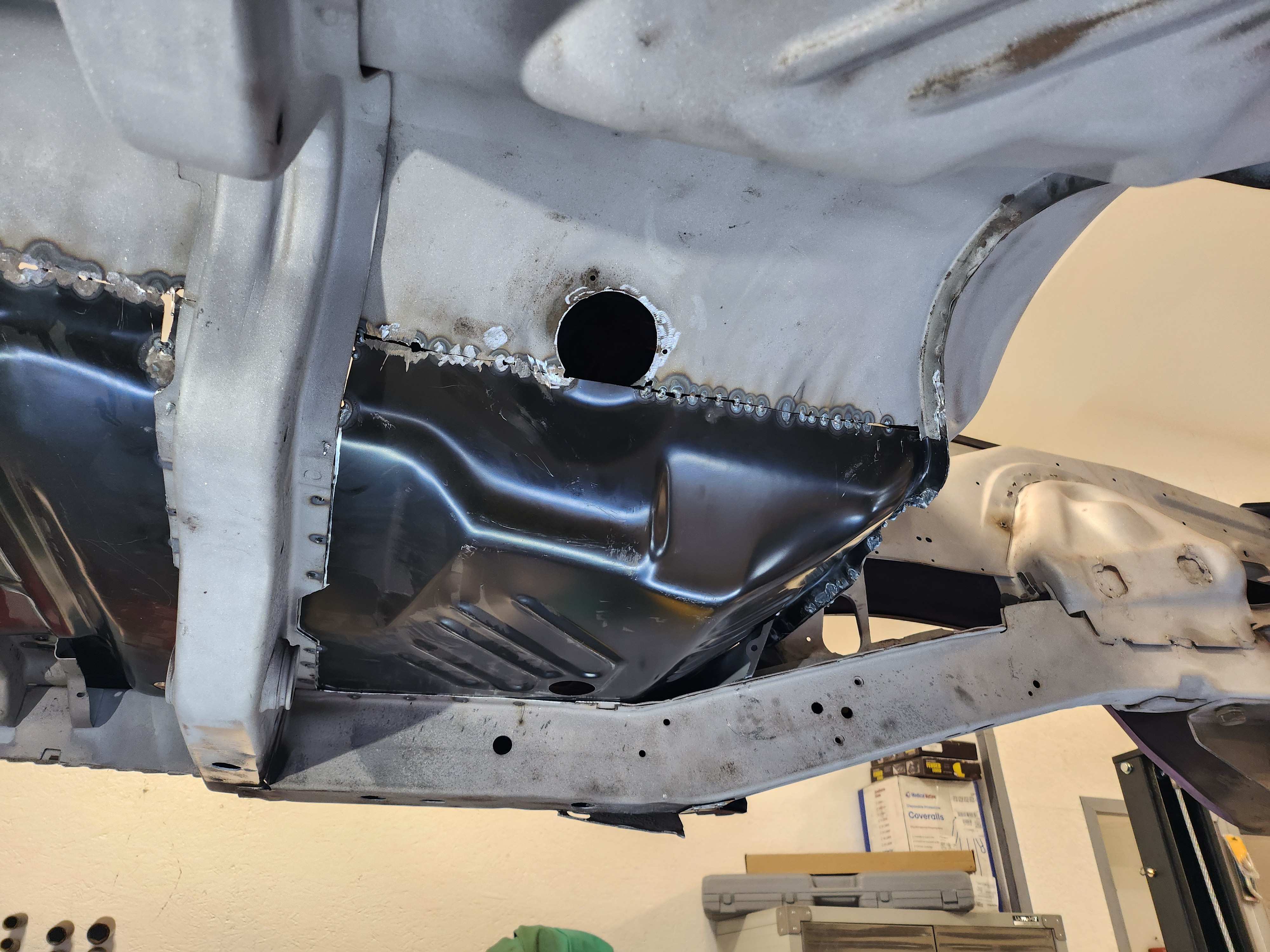

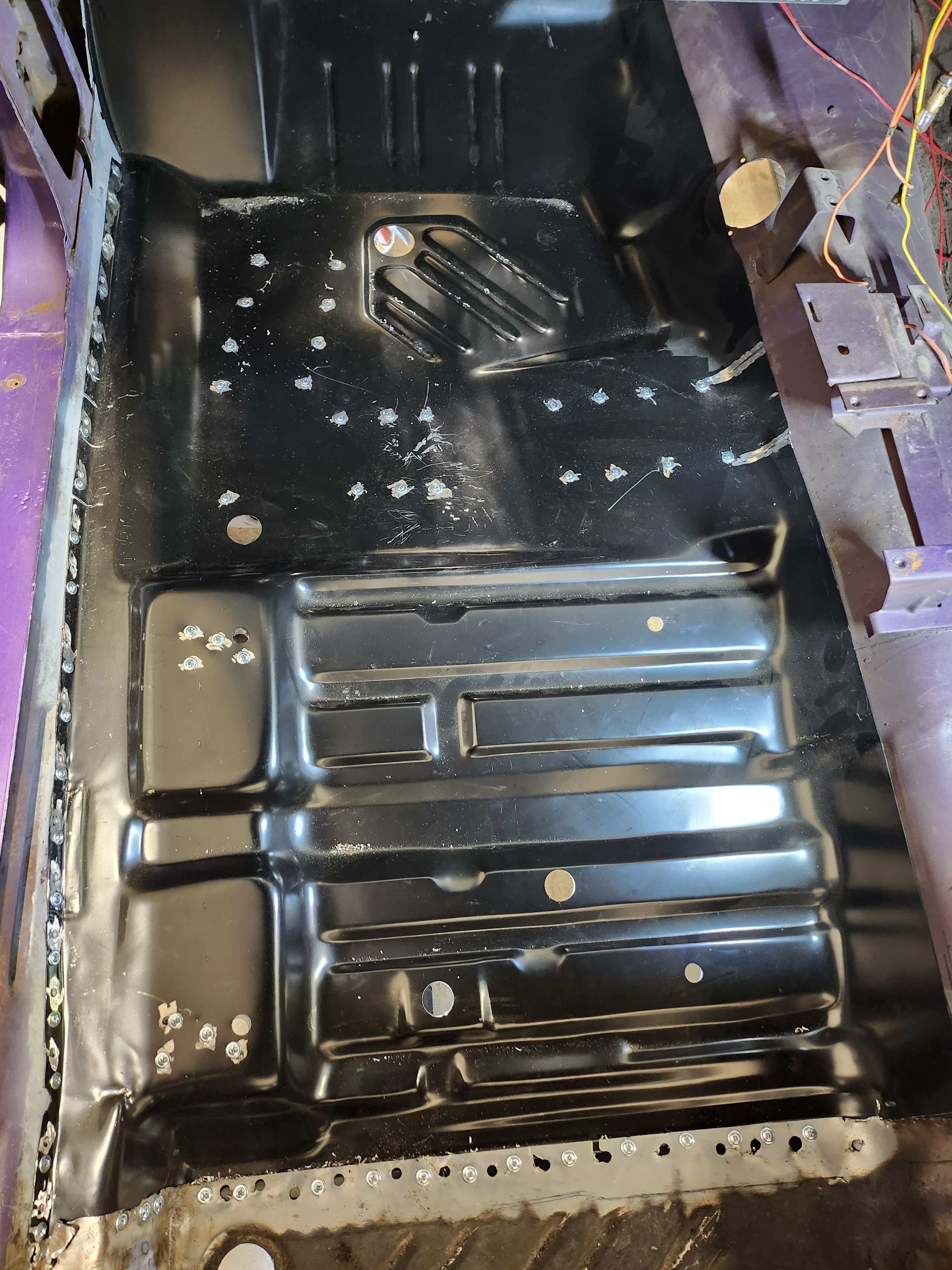

got it welded in today, well most of it. started with the screwed down areas then worked into the overlap on the trans tunnel. started with the cut off wheel then switch to an air saw, stayed in from the end a few inches to help keep the new pan from popping out
ward being that the pan was pressure fitted down to the frame rails, so cut about 8" and it stared flexing outward into the tunnel so level clamped it and proceeded to stich weld that area and cut morem weld, cut more etc.
