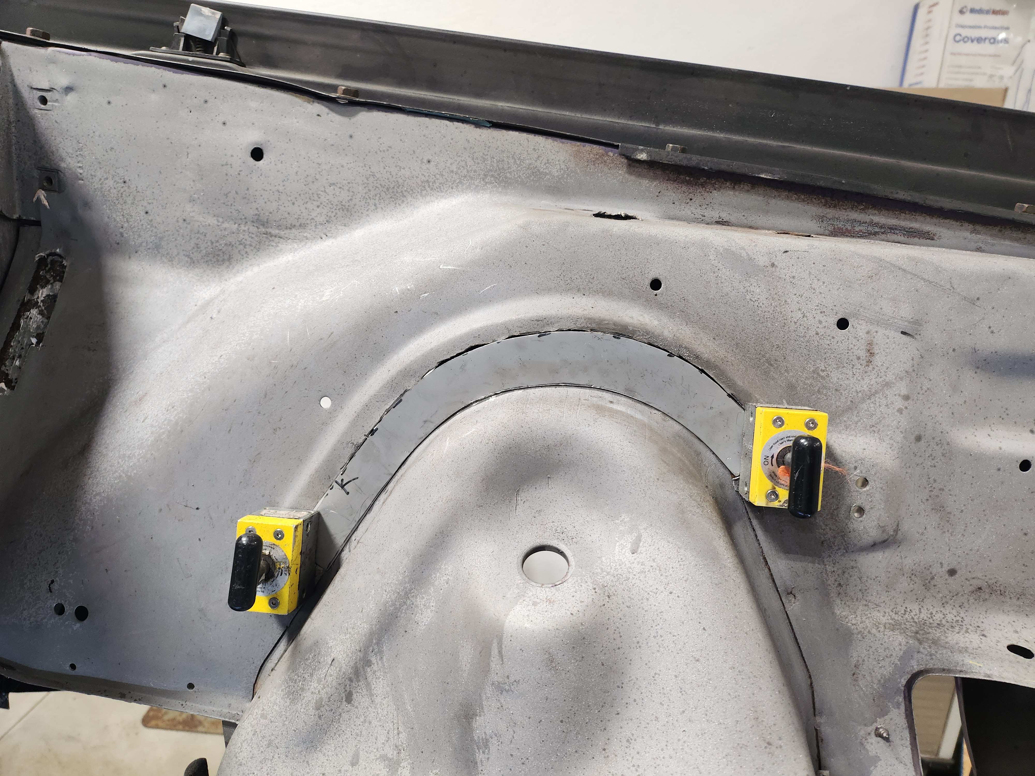

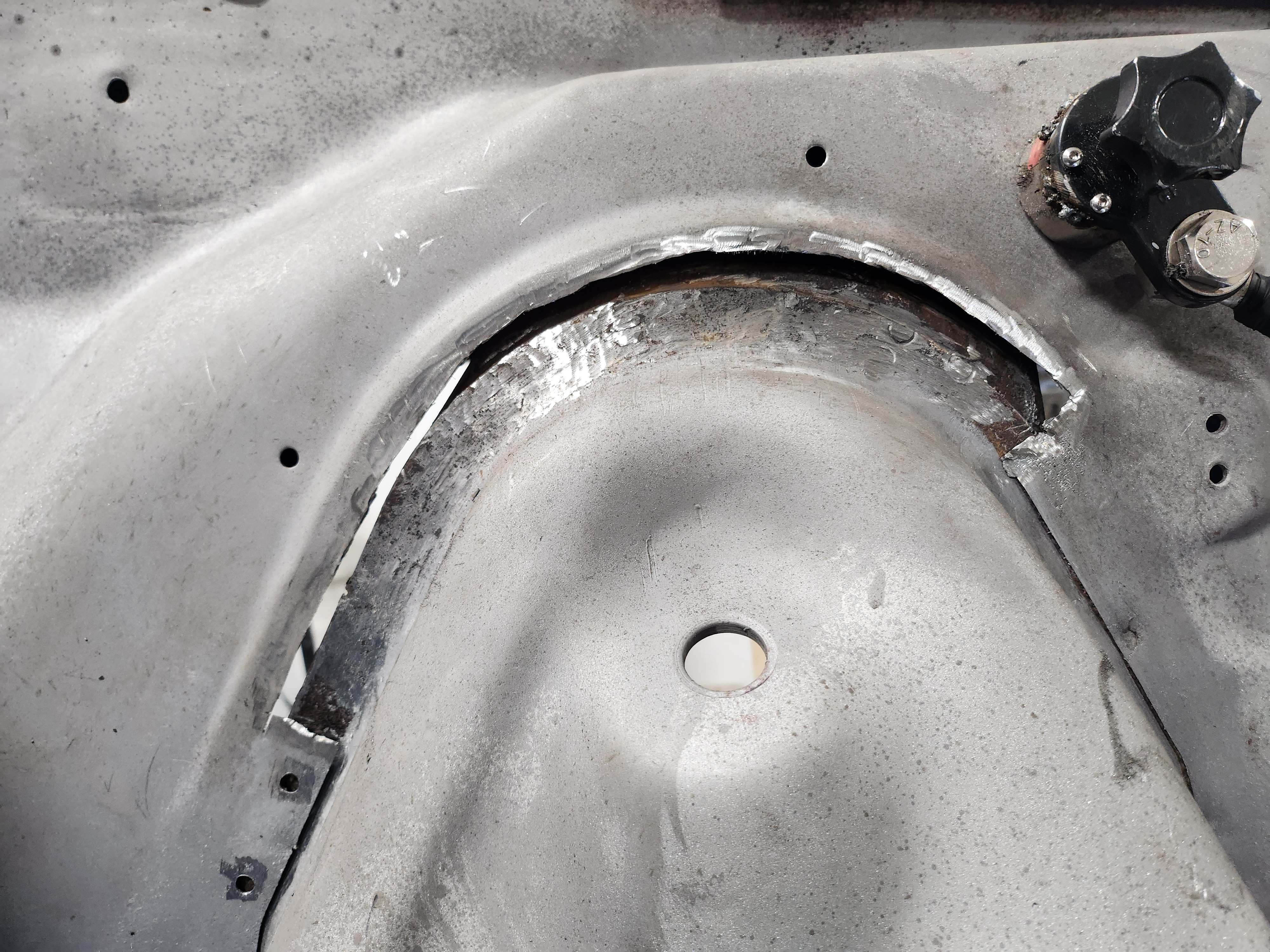

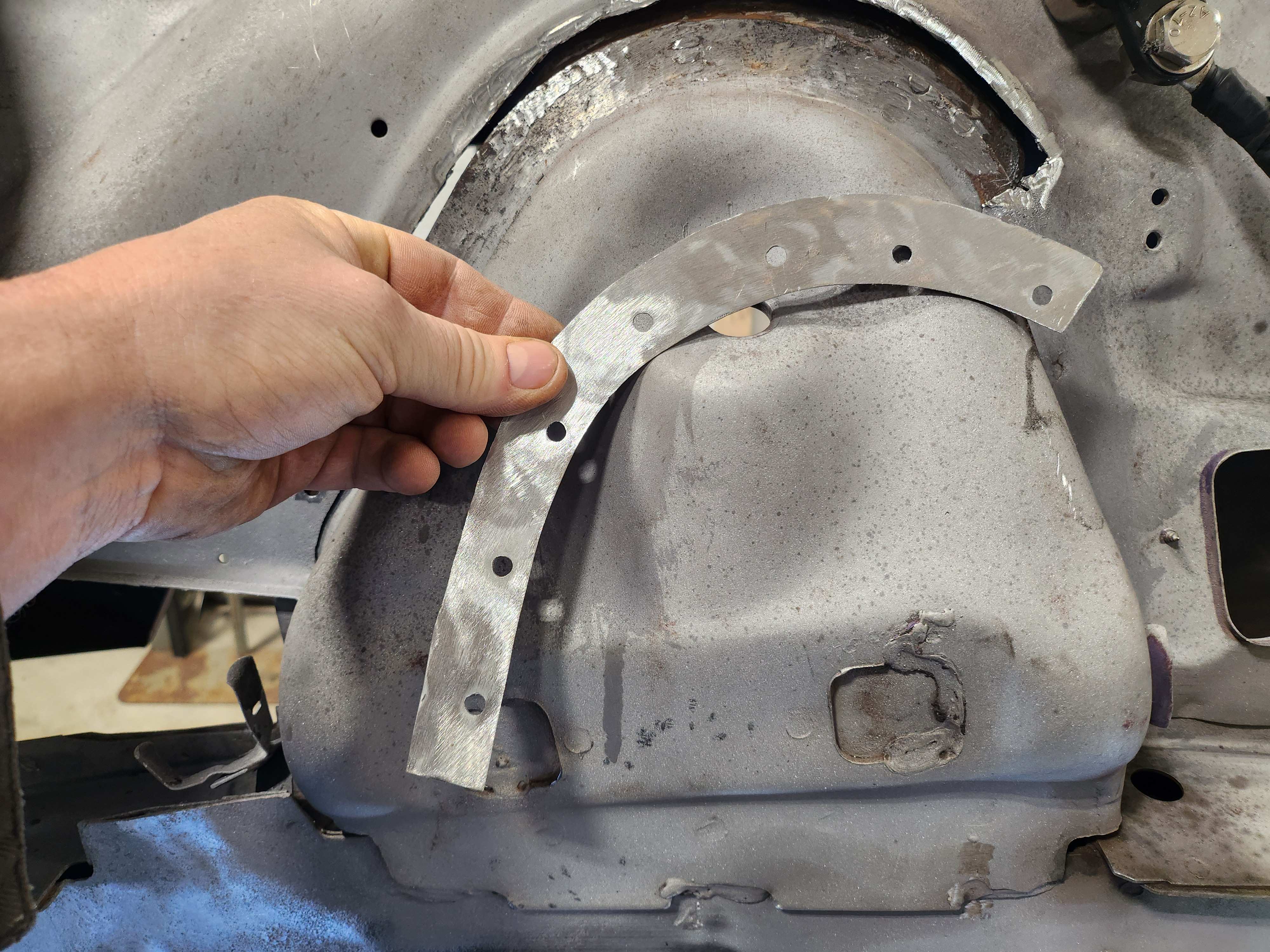

Well It wasn't too bad yesterday, got into the last crusty area the engine compartment, drivers side inner fender
r around the shock tower had some bubbling going on so, performed surgery and got the cancer out, planning on tack and stacking again to the inner fender first, to keep the patch flush, then clamp it to the shock tower and pin weld, will be glad when the welding is done, getting kinda old. Taking a painted part down to a painter friend who owns a collision shop to match the purple on the car so the underside blends hopefully,

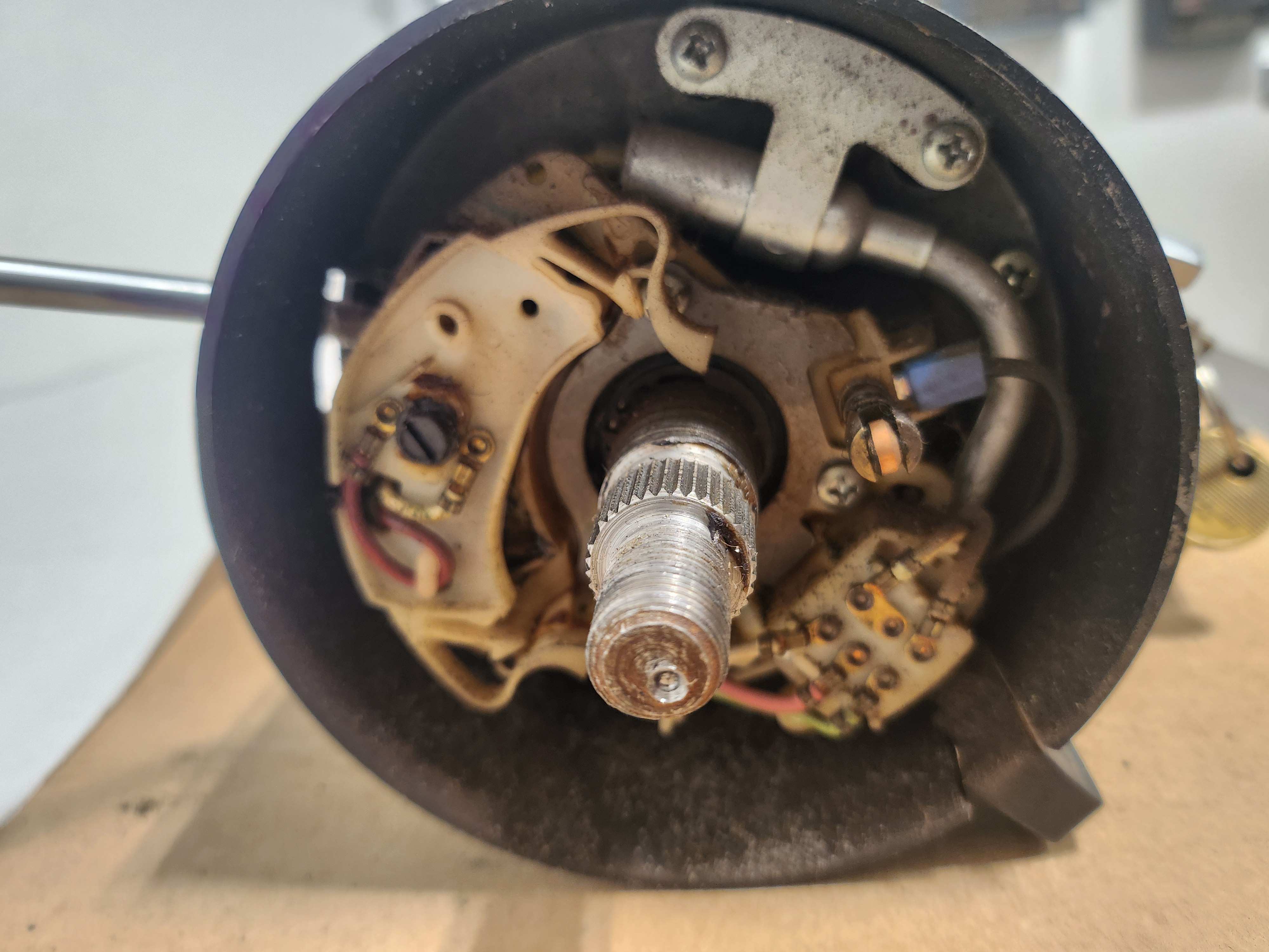

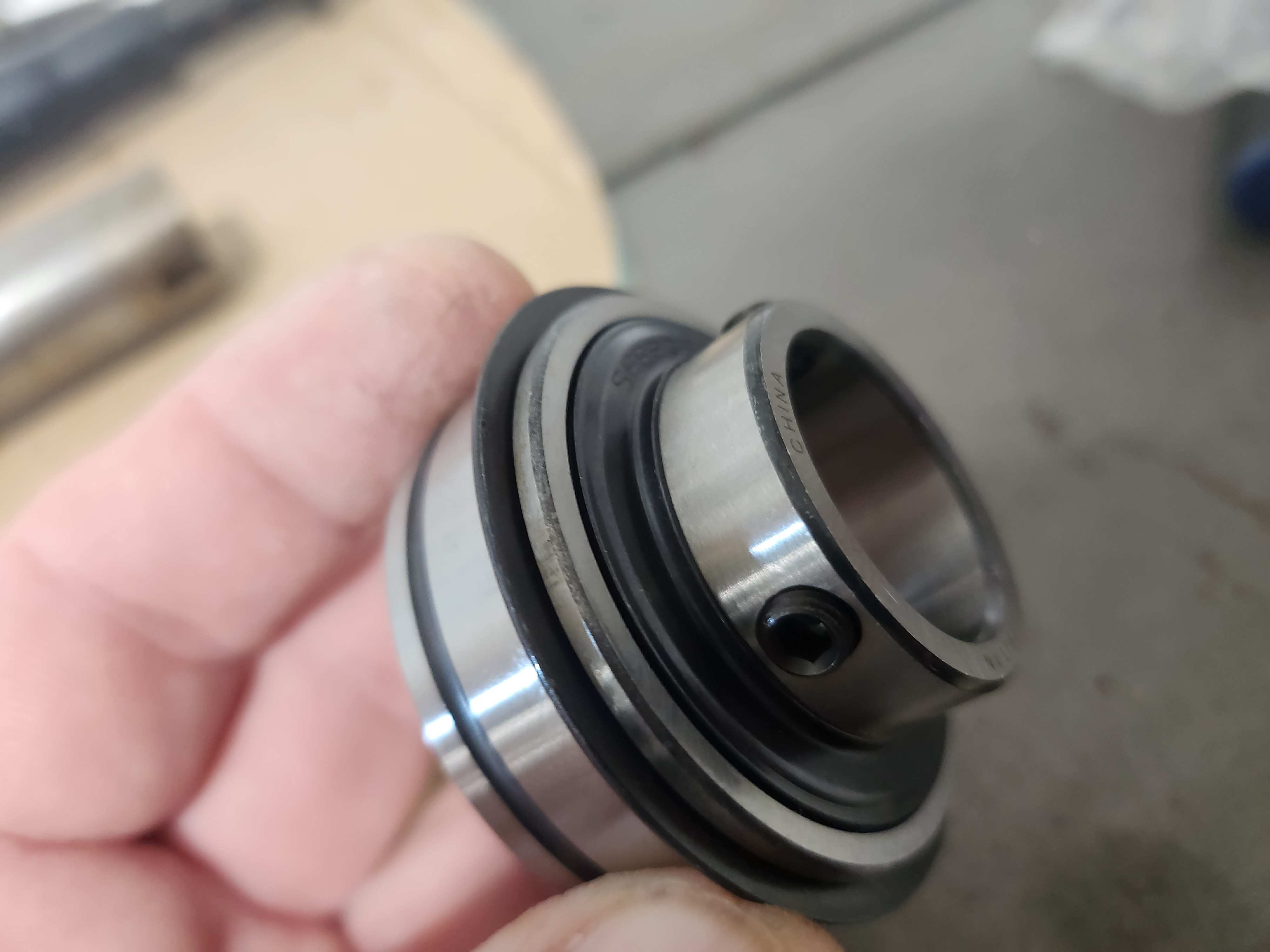

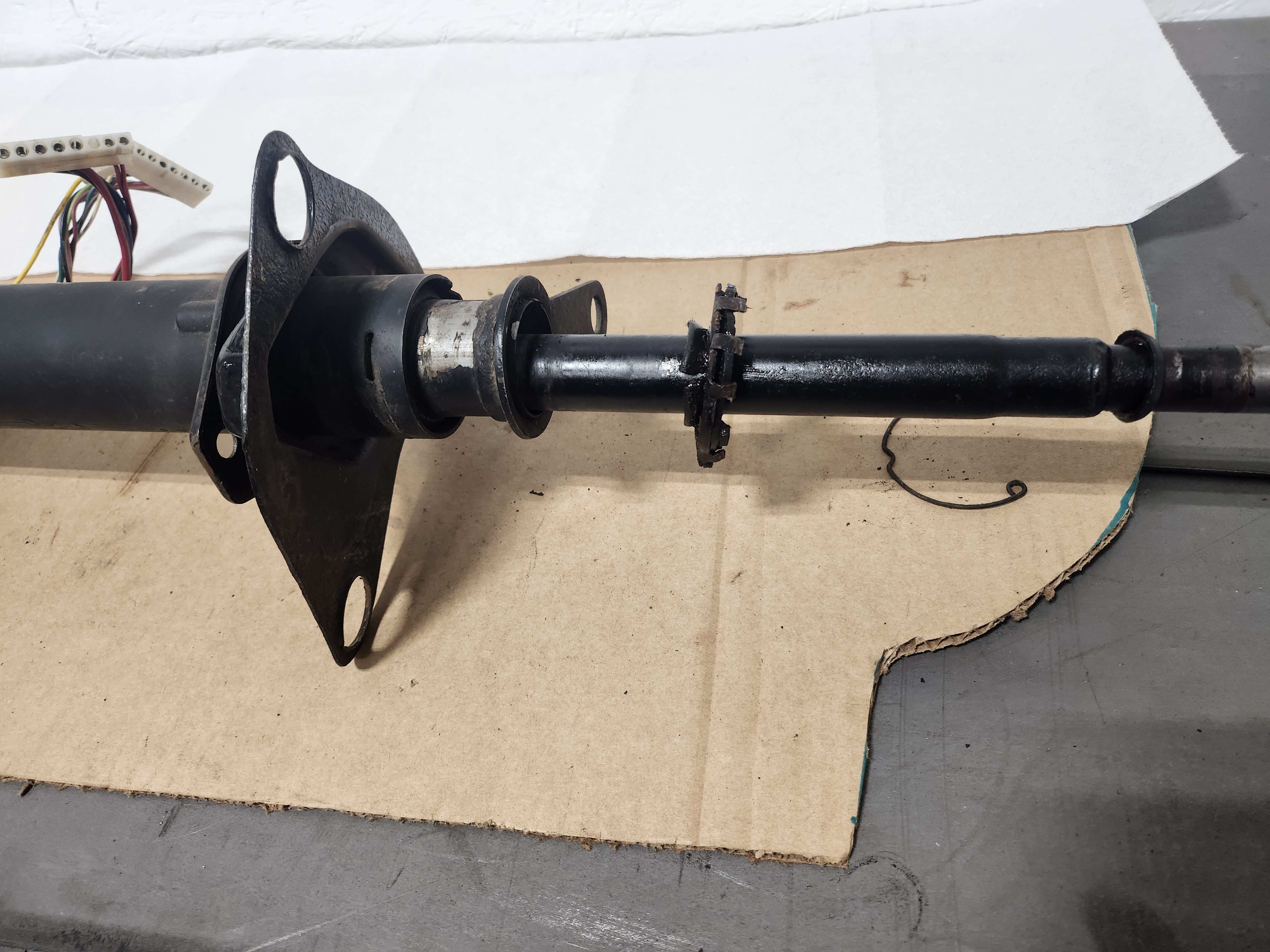

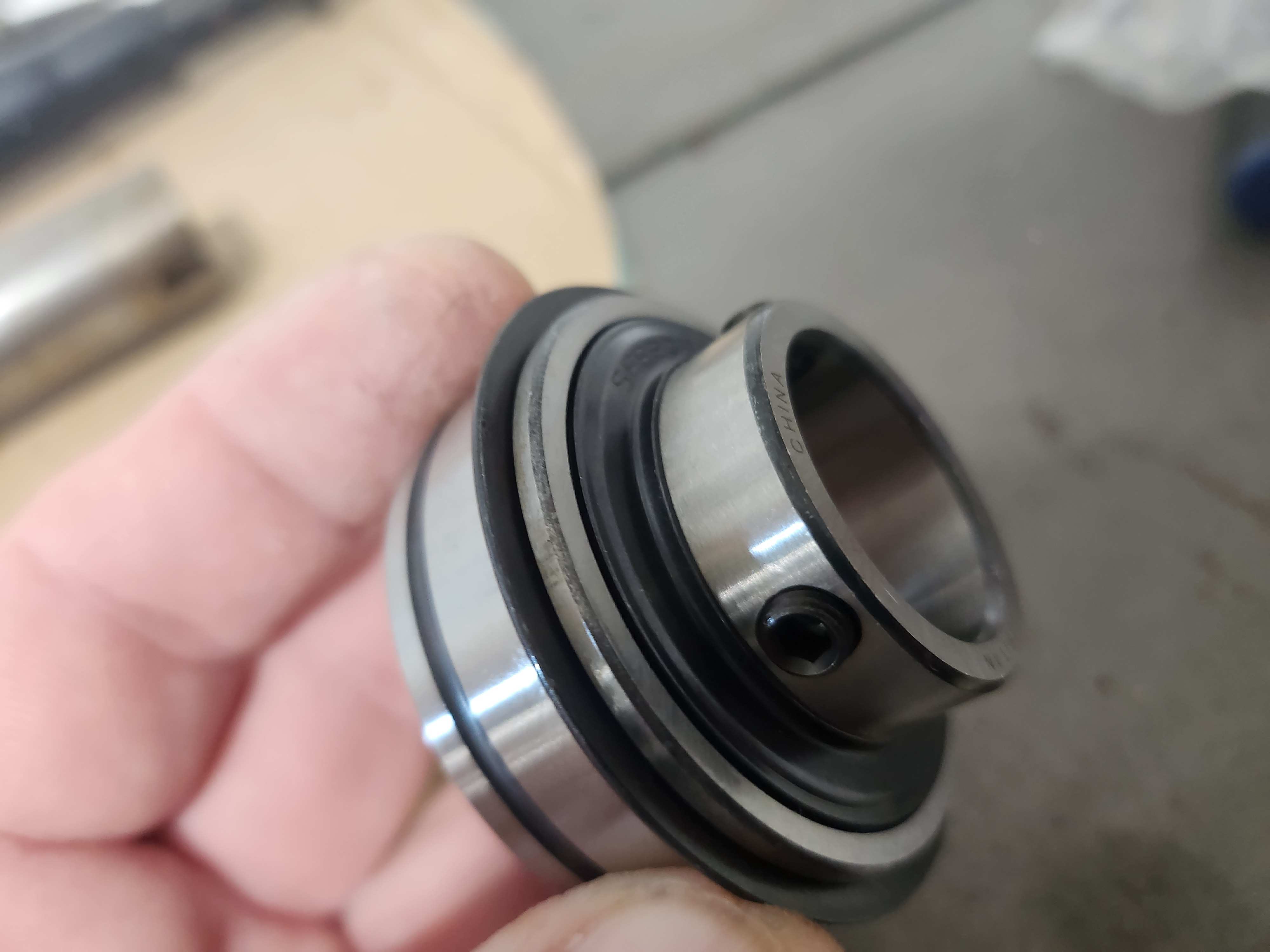

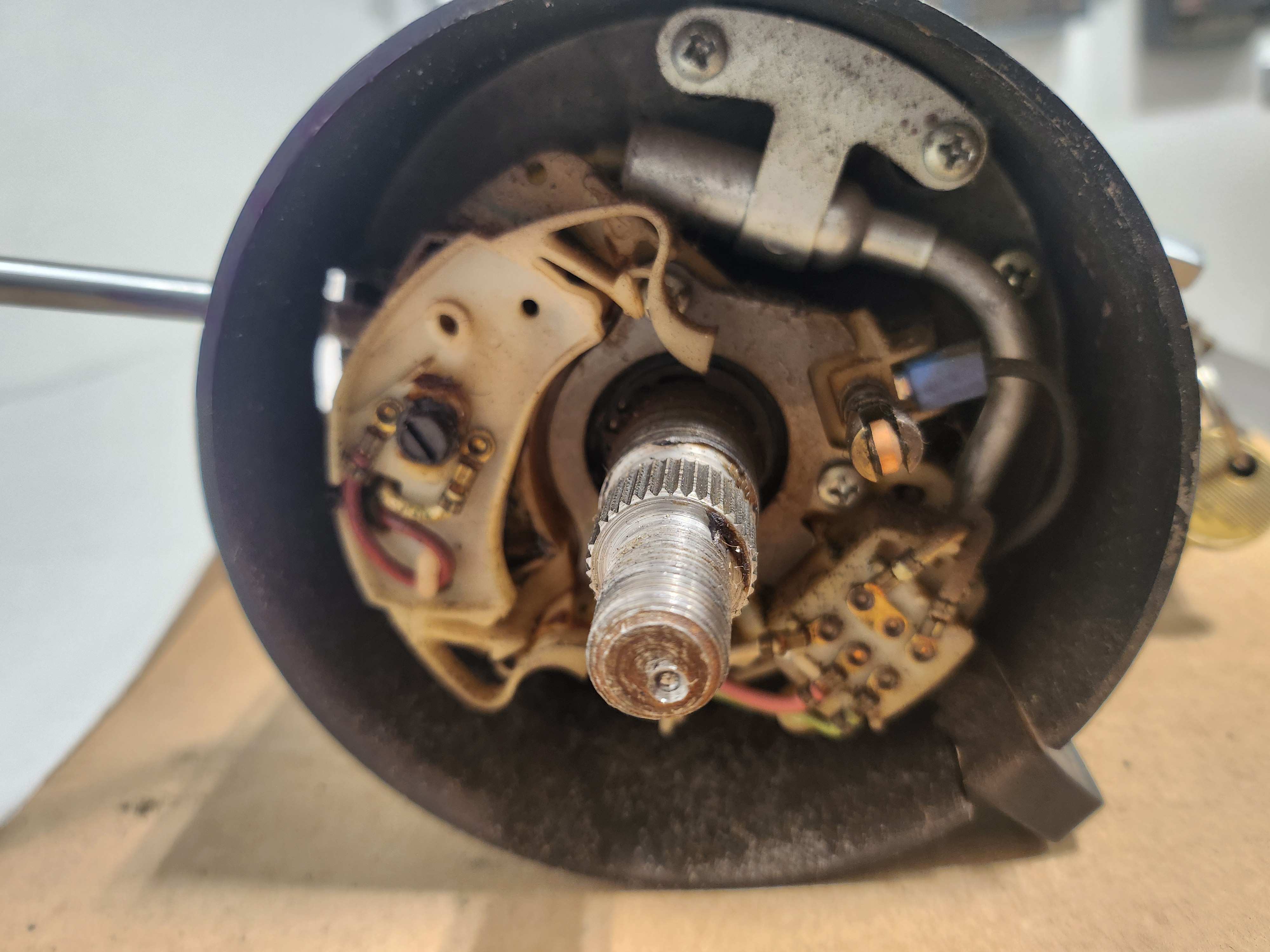

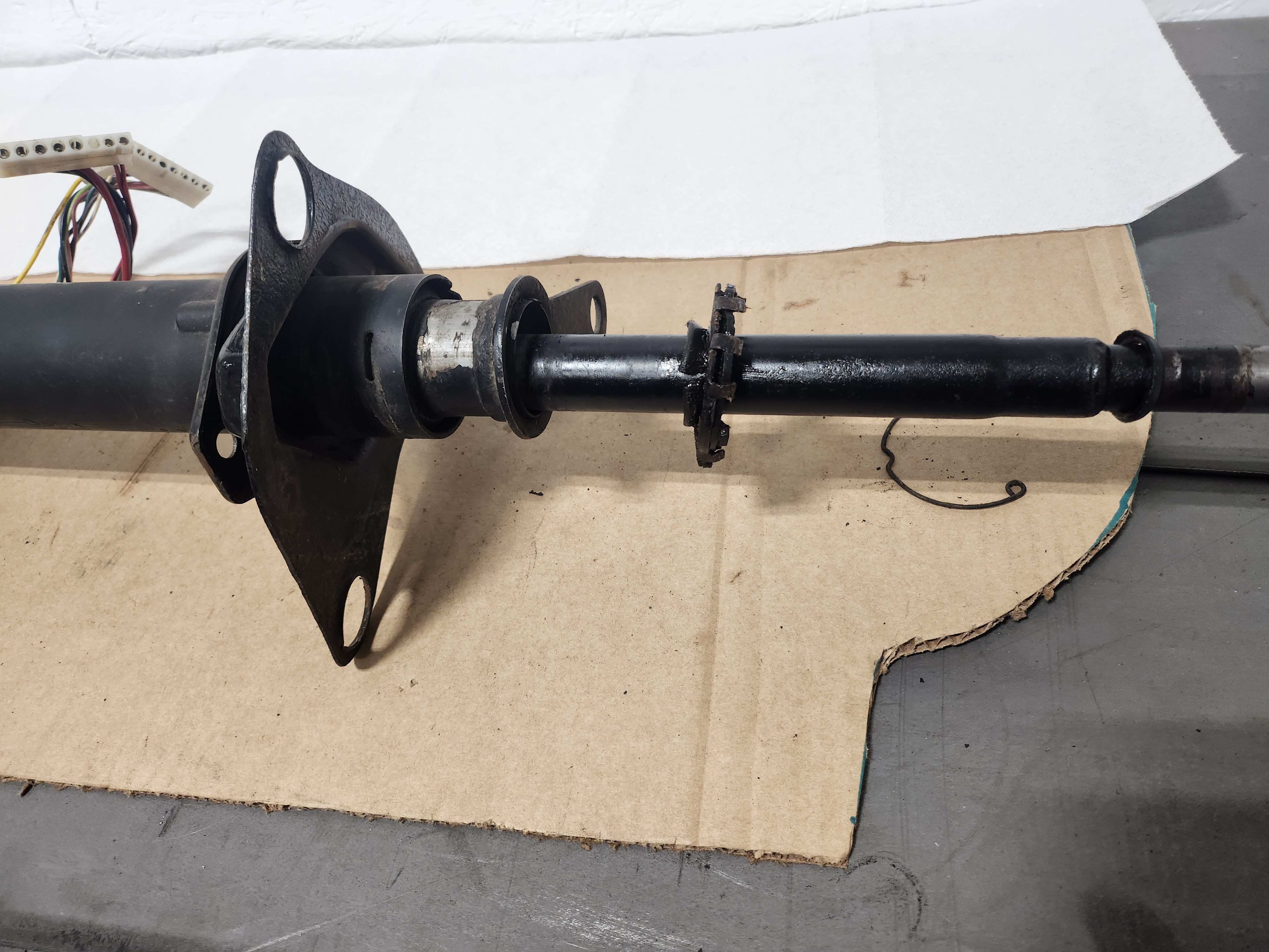

Have 1 day left on welding and grinding, thank God! Had a half day today, so didn't want to get super dirty, leaving for a graduation party for my step daughter, she
became a nurse last week, she's been busting her ass working 2 jobs, 2 kids, and nursing school for the past several years, very proud of her for pulling it off. she lived with me and her mother, when I first met her mom. back in 06, she was a spoiled little pretty ***** back then, jumped her **** and told her how life really was, long story short, she actually thanked me for it a few years ago. Amazing what can happen when your a dick to people that need it. She has 2 boys, that are raised with discipline and taught how to respect. Those boys will have a way easier life adjusting to the real world when they get thrown into it someday. Well tore apart my steering column to install the Peter Bergman lower column bearing that replaces the bushing that is gone from the factory, so figured might as well clean, blast, and paint the scratched up areas and regrease. Got into it and found a ton of sand in it, must have been from the 90's when the last guy painted the engine compartment, another glad I tore it apart moment. waiting on the flat black mix from my painters paint rep, should have it in a week or so.
