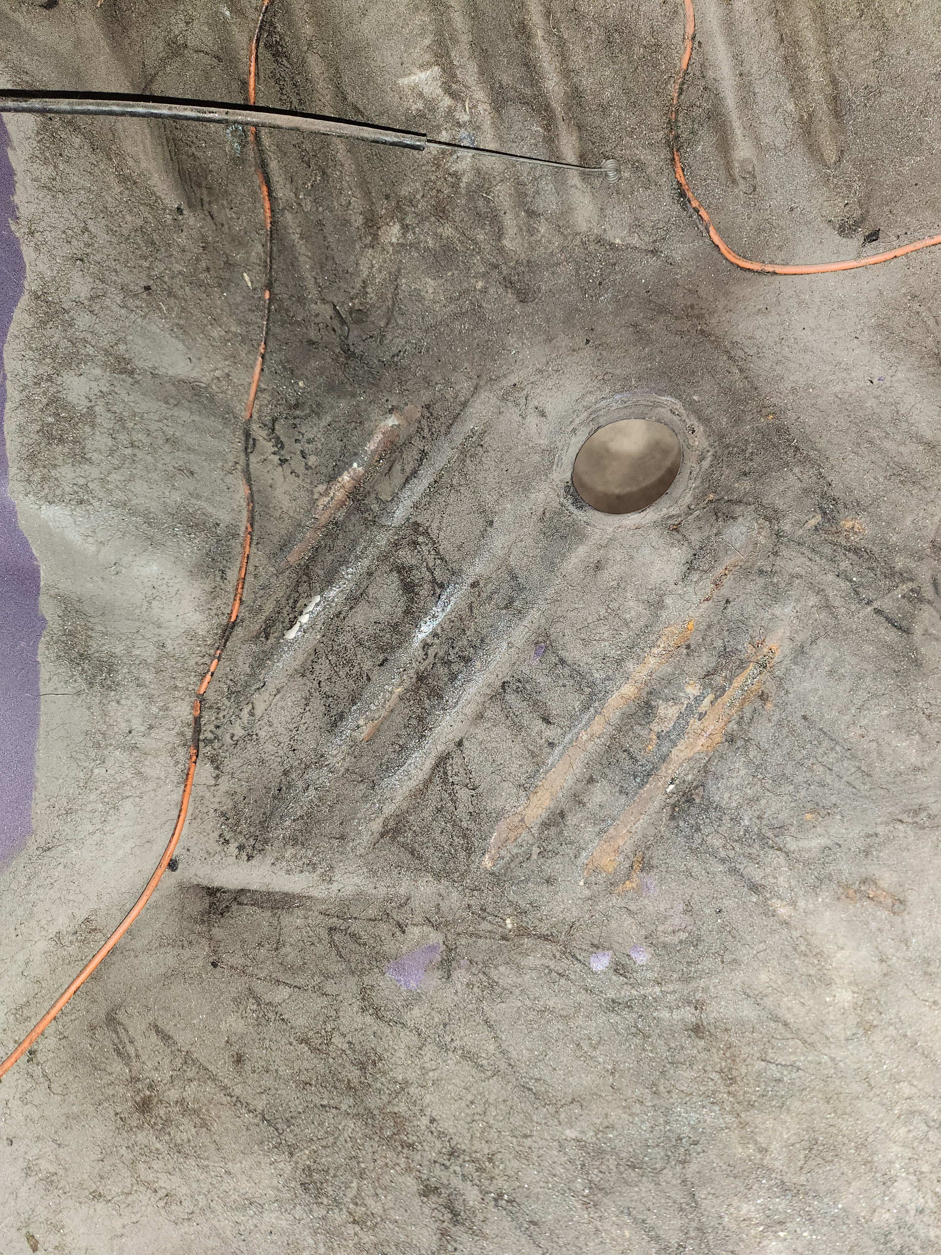

thank you, they are pretty damn close, I assume your talking these? there is a very slight kick forward on the drivers side, but alot of
hell to get that out

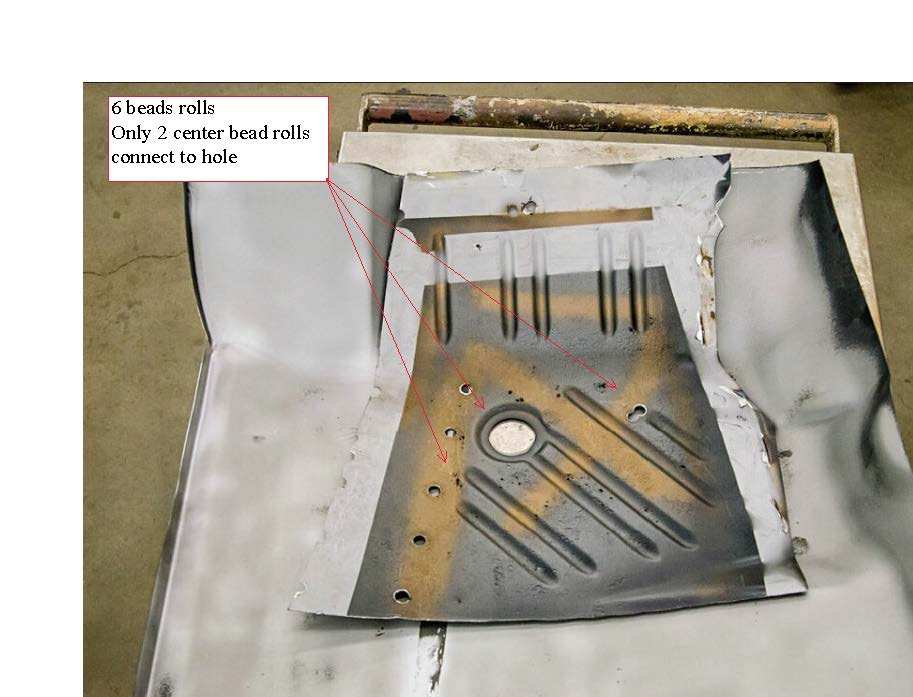

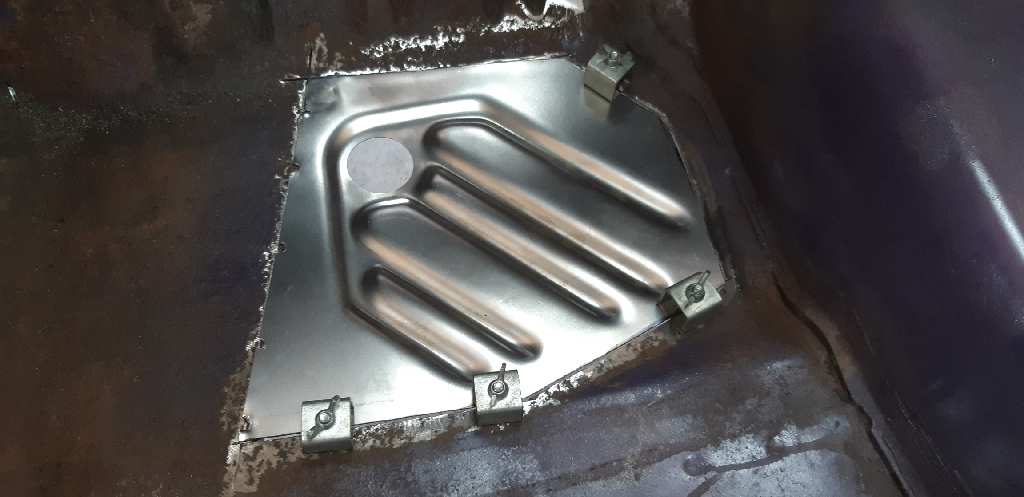

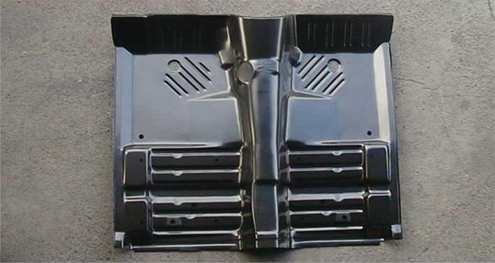

Here is what I was referring to in my AMD floor pan rant. First photo shows the stiffening ribs layout for a 1970 E-body. See how there are 6 ribs and only the center two are connected to the drain hole stamp? The second photo is the layout used for 71 and up cars, and is the layout used by AMD for their 1970-only E-body floor pans. Only 5 ribs and all five tie into the drain hole stamp.
Sherman, and I believe Dynacorn, sell a 1970 floor pan with the correct stiffening rib layout, but you have have to buy the full floor (last photo).
ah I didn't even have that left on my original didn't notice it :thumbsup:

I noticed the issue several years back when doing a driver's floor repair on my Cuda, and it ticked me off. But seems like something that most people don't notice, since just about everyone is still buying AMD floor pans for their 70s.

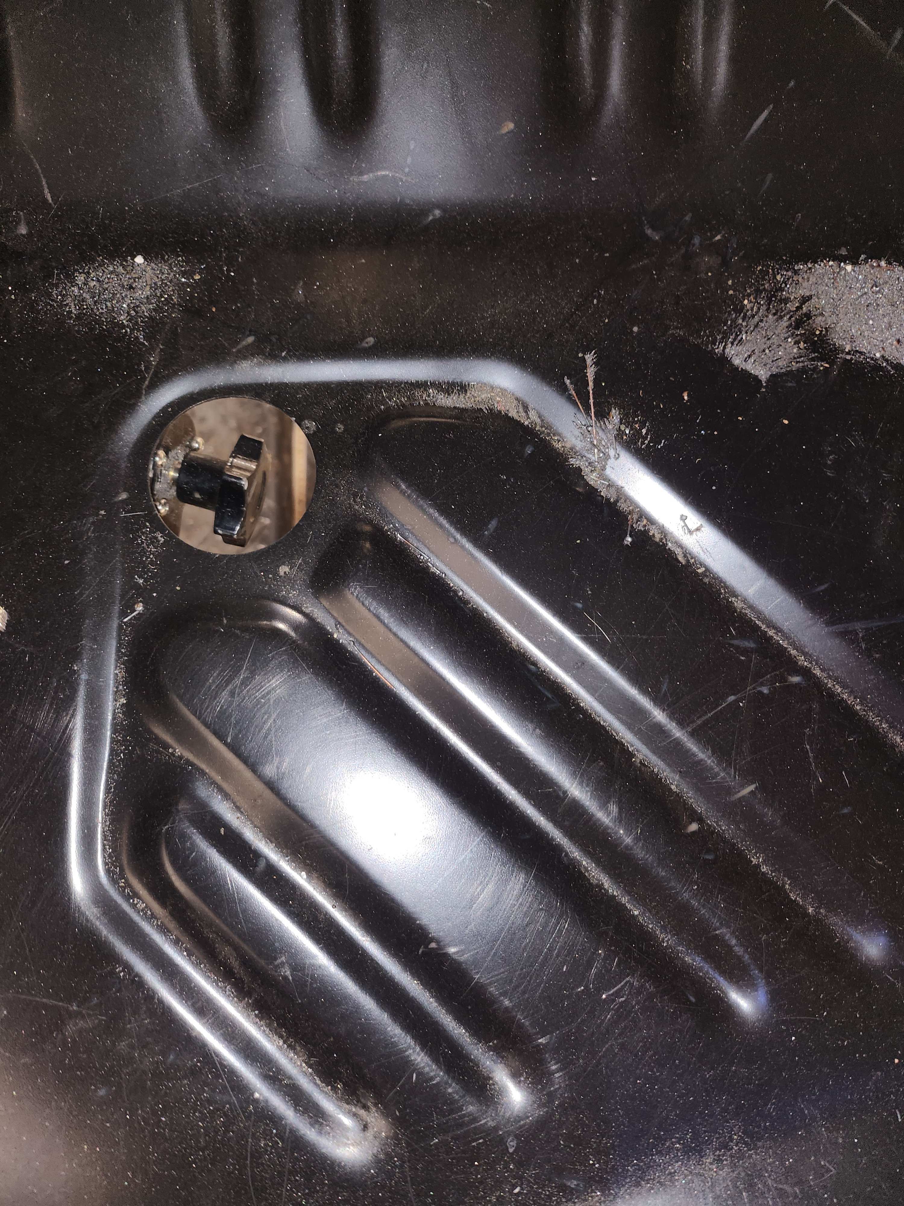

check this one out where did you buy that pan at I had issues with a AMD fender I got this direct from AMD it has only 5 ribs as you stated

check this one out where did you buy that pan at I had issues with a AMD fender I got this direct from AMD it has only 5 ribs as you stated View attachment 133762View attachment 133763
I also got my pan directly from AMD, but none of the pics in my earlier post are mine. I just pulled some good examples off the web.
Looks like your passenger side pan is original, like mine is. Back when I was doing my floor, I was so ticked off about the difference that I was tempted to order a full floor pan from Sherman or Dynacorn, but at $500+ to purchase and have it shipped I just couldn't justify it for my beater after buying the left side AMD floor pan. So, I welded it in, covered it up with new carpet, and have "mostly" forgotten about it. :icon_fU: Looking at the rest of my car, you'd never think I could be so anal about such a trivial detail, but we all have our neuroses I guess.

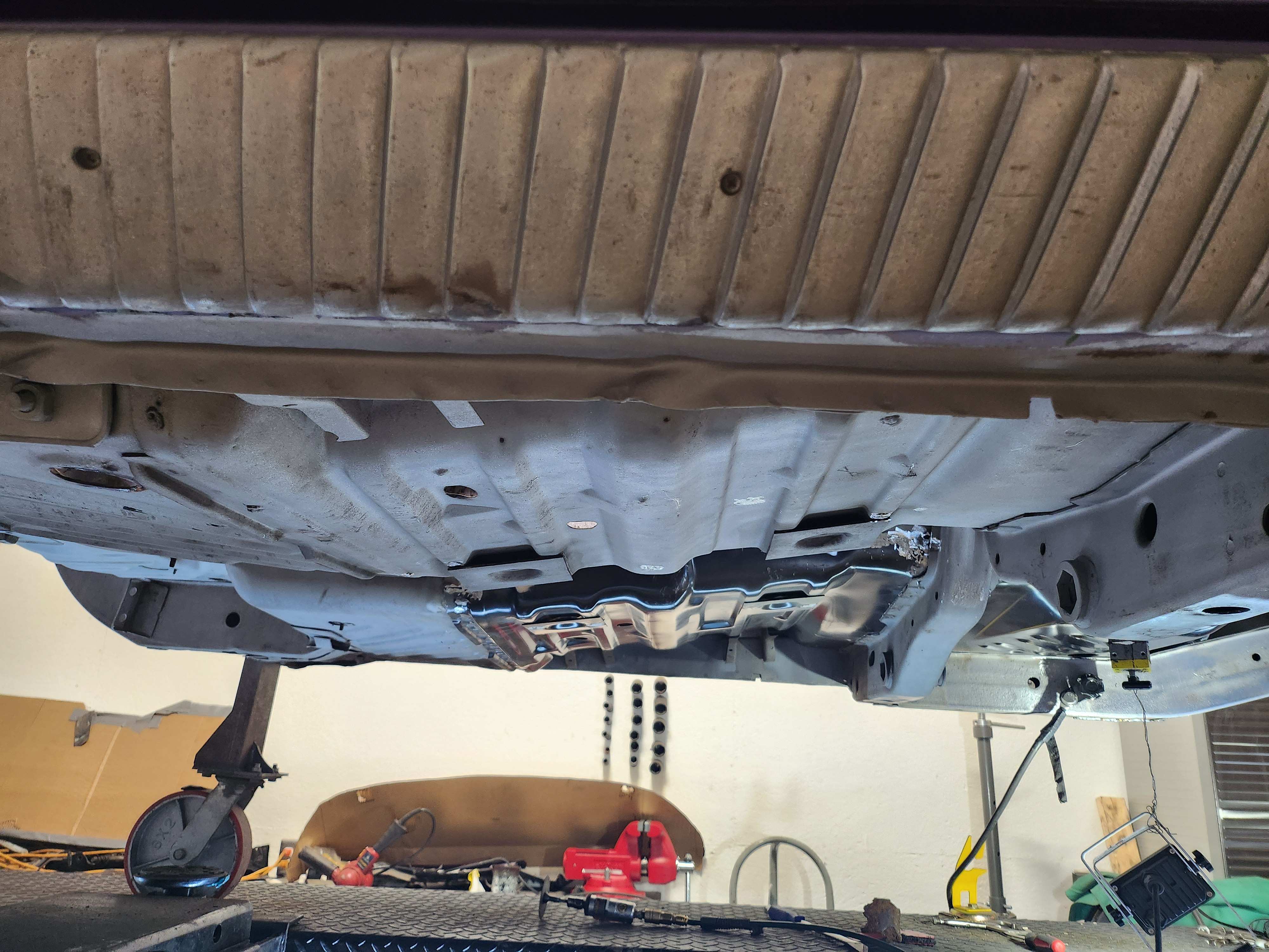

damn it you pointed it out, just kidding I just can't wait till that ***** is purple.underneath, going to wire wheel the rest of the floor pan paint it with some sem black rubberized under coating and install some dynamat, not cutting the holes out until its purple underneath gonna use it to seal the drain holes off from overspray.
