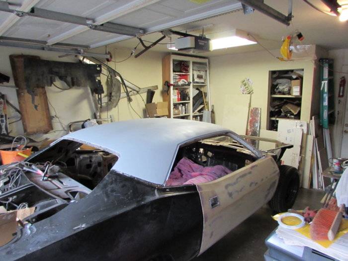

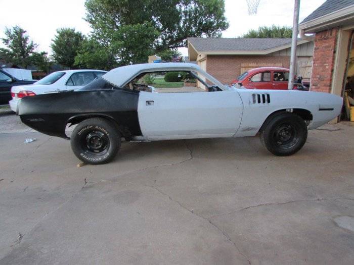

This is a good pic of my spot welds. I think the spot weld supervisor was walking by... 33 spot welds on this side, less than 20 on the driver’s side..

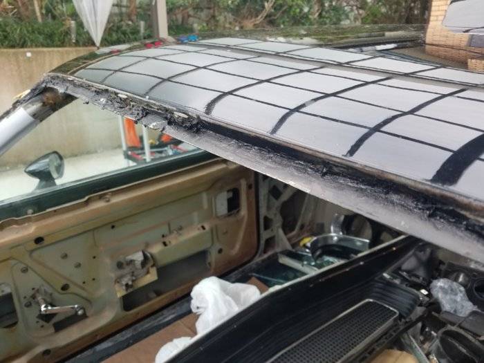

Thank you for very good photos! There is a seam under the putty. . It is difficult to remove many spot welds (ToT)
