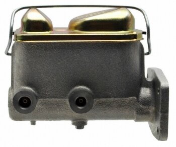

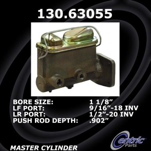

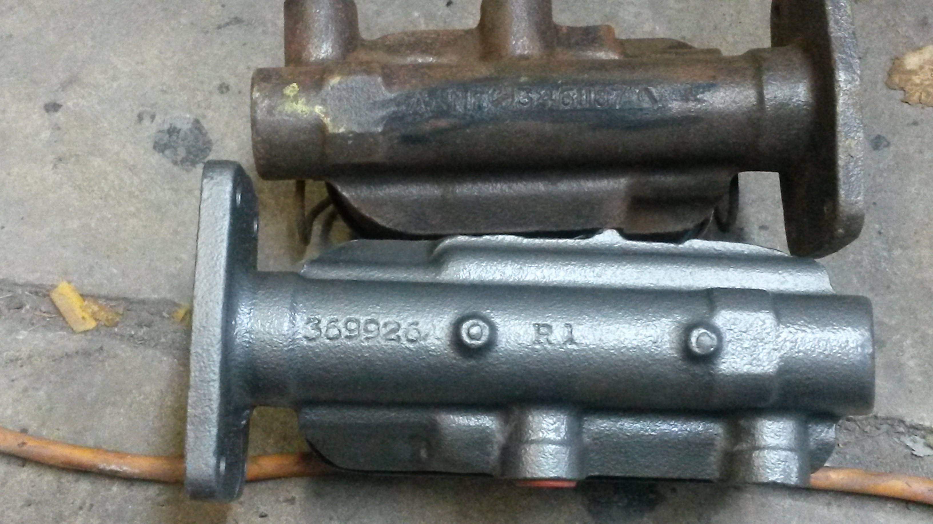

A couple of aftermarket master cylinders that 'kind of sort of' resemble the original 2229171 are
Raybestos MC36283 and Centric 130.63055. Paint them and the booster black as original and will look good unless you're out to win a judged show or something.
Also, for another option, Billl Rolik has some Bendix master cylinders that resemble the 71-74 unit.

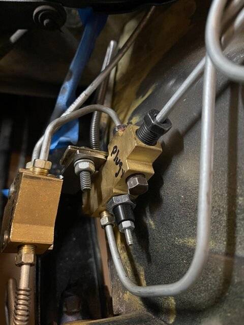

Have not had good luck with the reproduction disc proportioning valve / metering block setups (leaks). If you can track down an original, there are rebuild kits available for the valves here- (Kelsey Hayes for 1970).

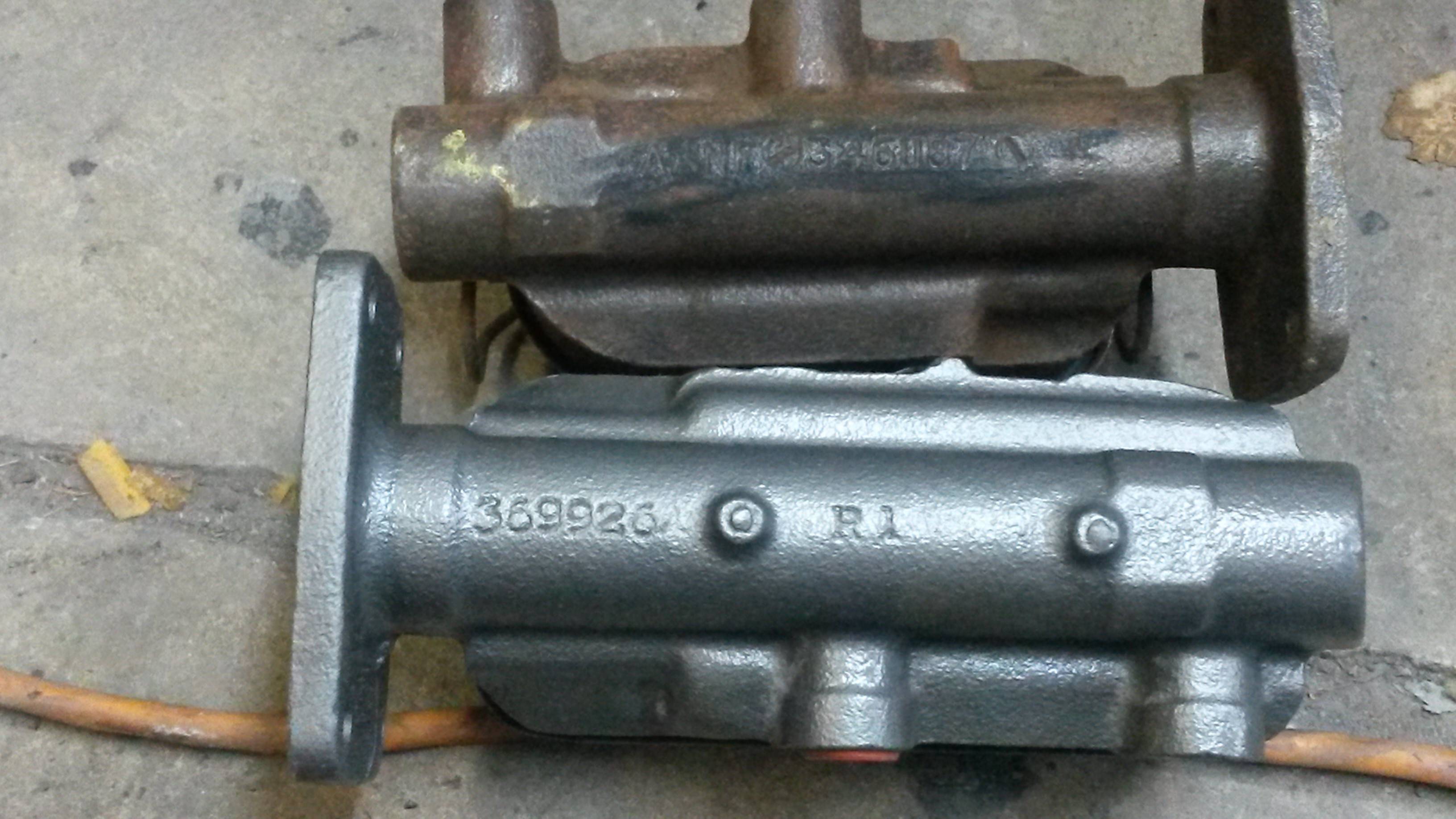

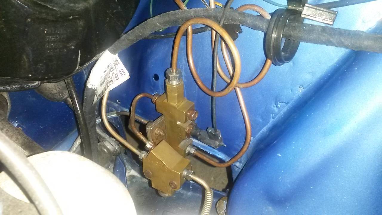

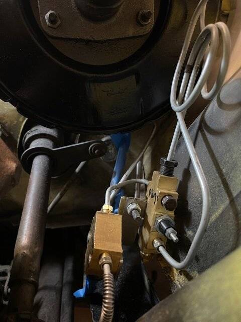

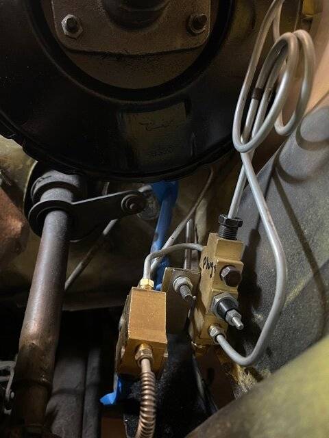

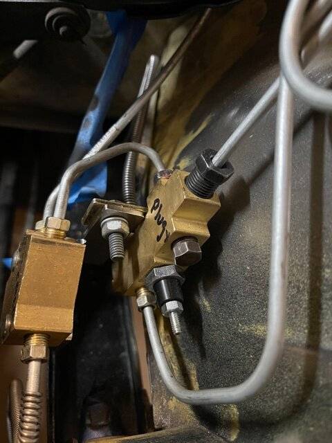

You are going to replace all you lines right? Just want to say that. use stainless steel or copper nickle.I prefer copper nickle. what year factory disc setup? top one is a a 11 70 build date original on 71. bottom is a re manufactured.If this is the setup you have. top line goes into back of master cylinder front line goes into front of master cylinder.the smaller block is for the front lines.Before you bleed system pull the reset out on the front block and hold. You might want to use DOT 5.1.

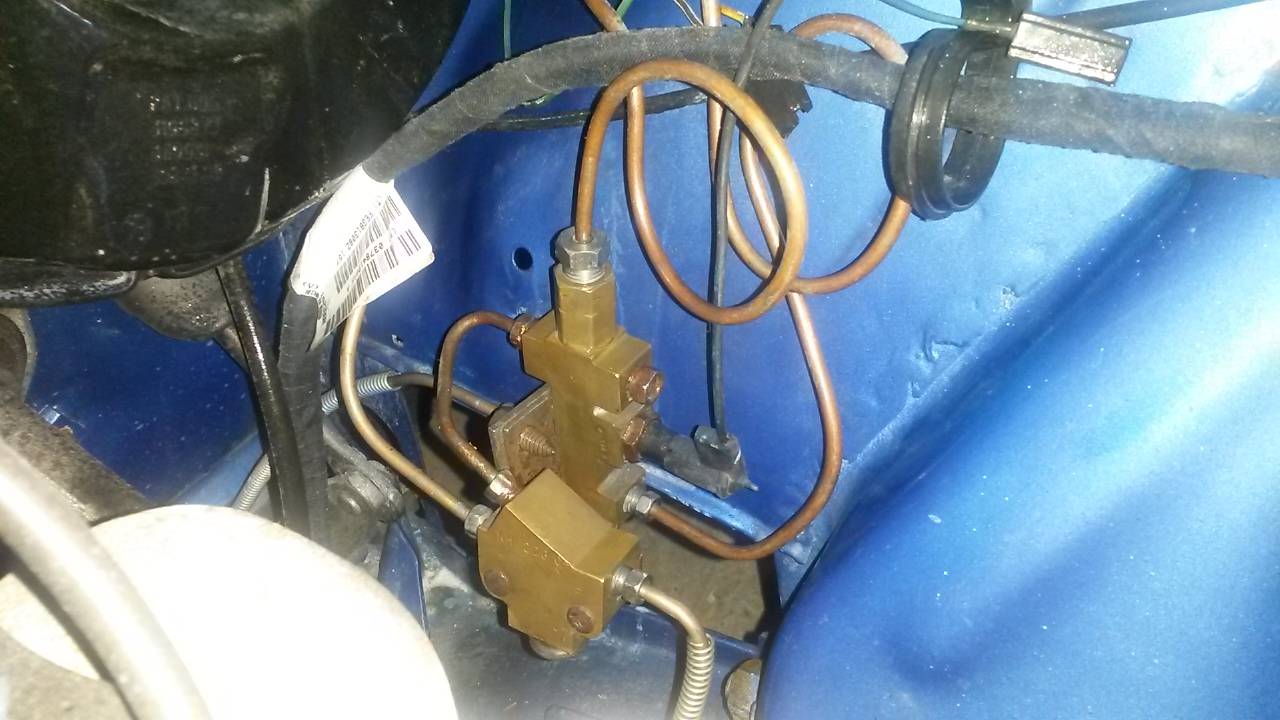

Something to be aware of!
There were two different sets of brake lines for the 70 Challenger
Early cars used a two piece brake line to the rear of the car with a proportioning valve under the driver's side frame (under the driver's seat)
As shown above, they eliminated the under the frame valve and incorporated it into the metering valves set up (second pic). This now required a one piece front to rear brake line.
As others have suggested; changed the brake lines for safety. Stainless steel is a pain to keep from leaking; I used the standard, 2 piece version after ordering the SS version.(Inline tube- nice fitting)
I also used the Centric Unit above and Centric rotors and maintained the original booster.
As shown above, they eliminated the under the frame valve an incorporated it into the metering valves set up (second pic). This now required a one piece front to rear brake line.
