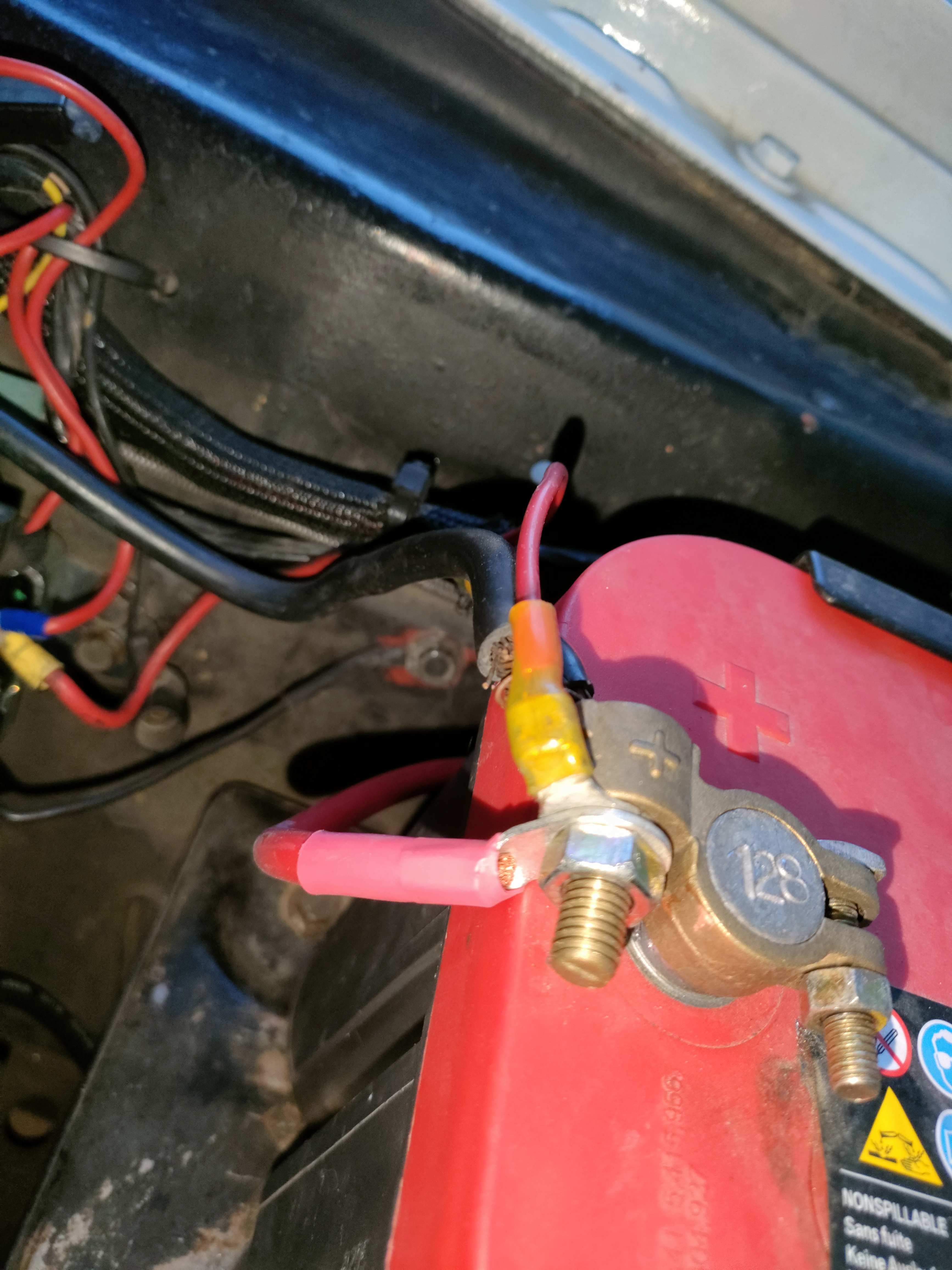

The ammerter is not connected to the alternator (read it can cause dammage with a more powerfull alternator), instead there is the chargewire, install directly to battery (next to the Sniper EFI).

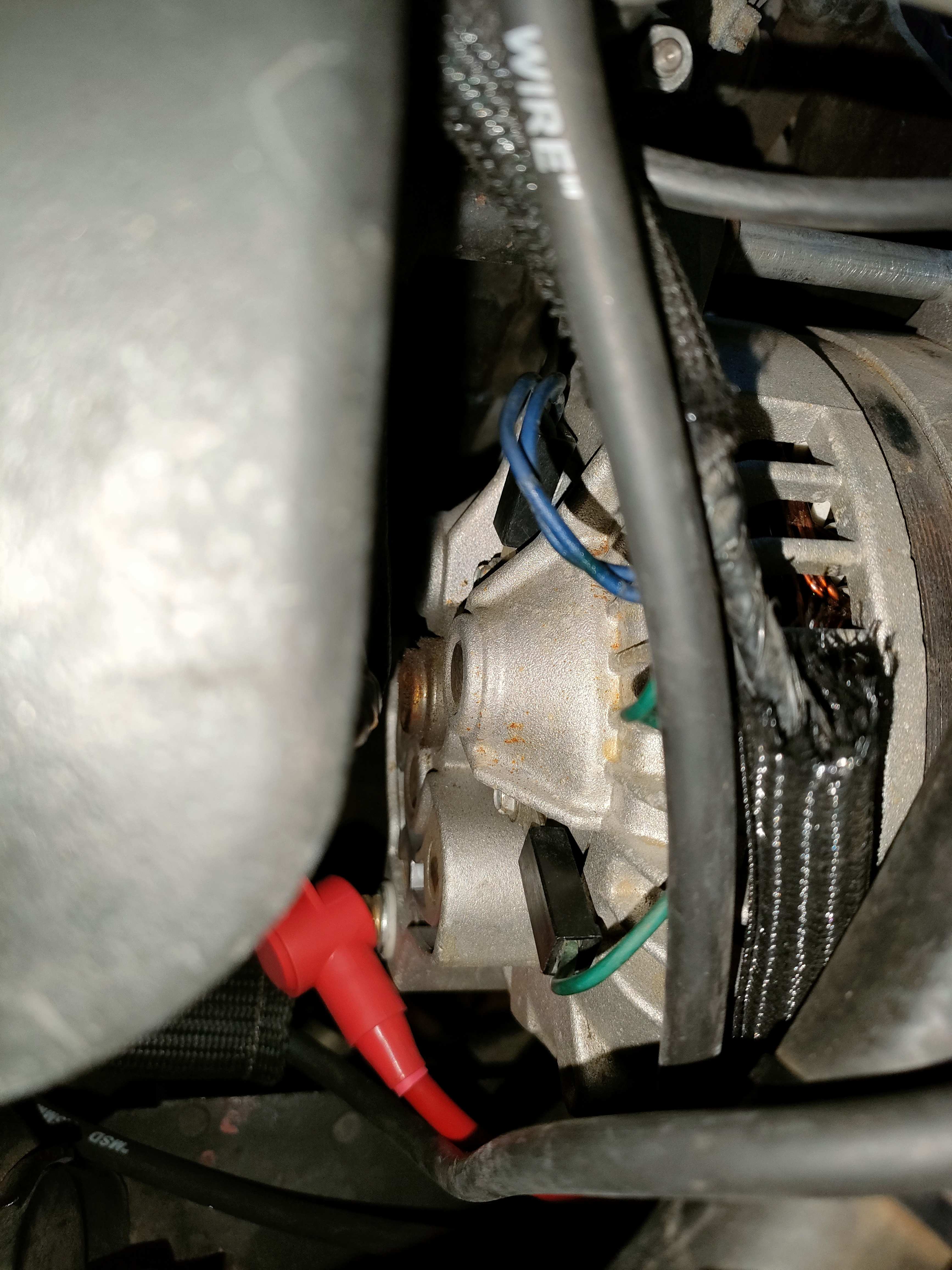

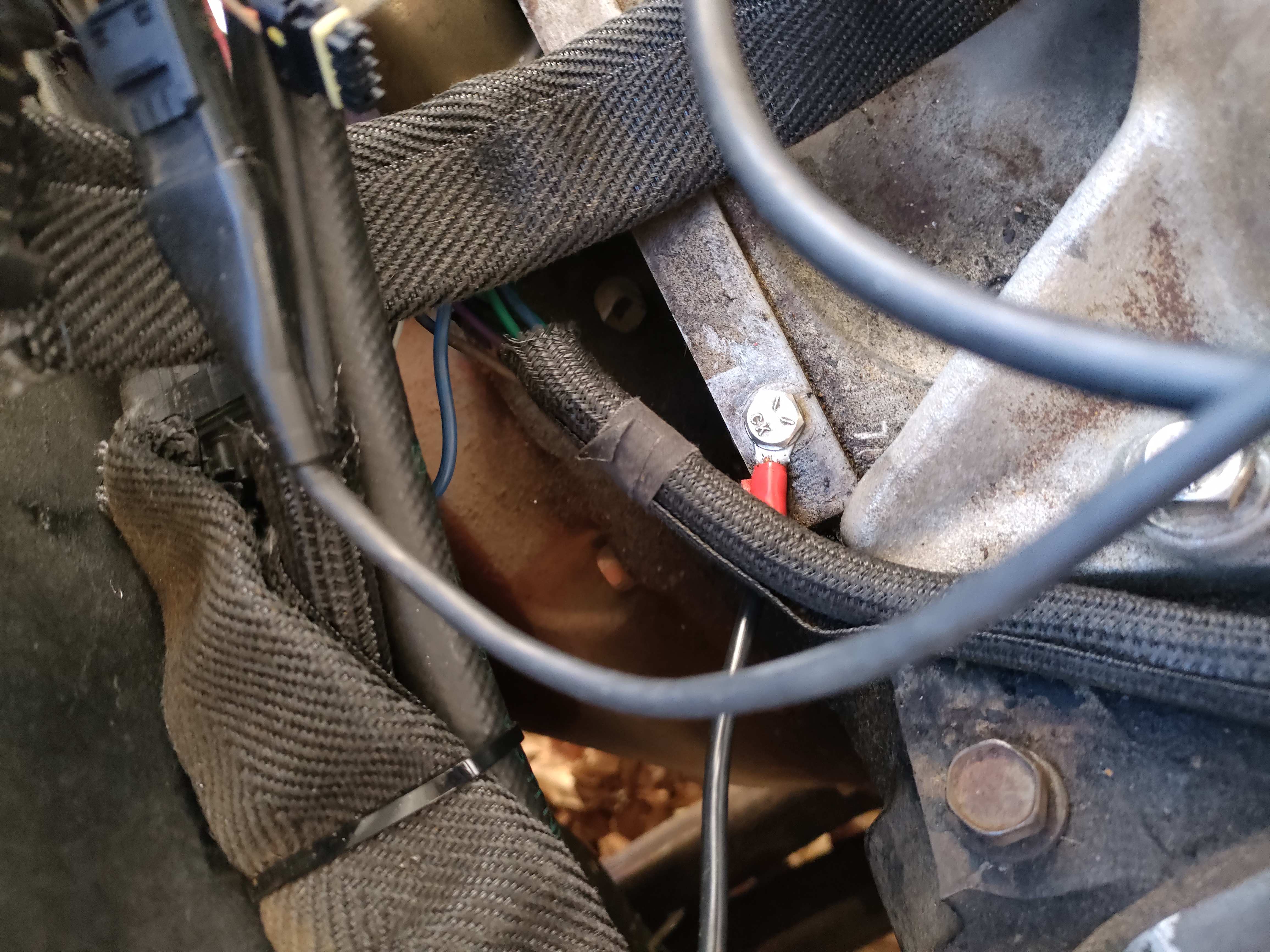

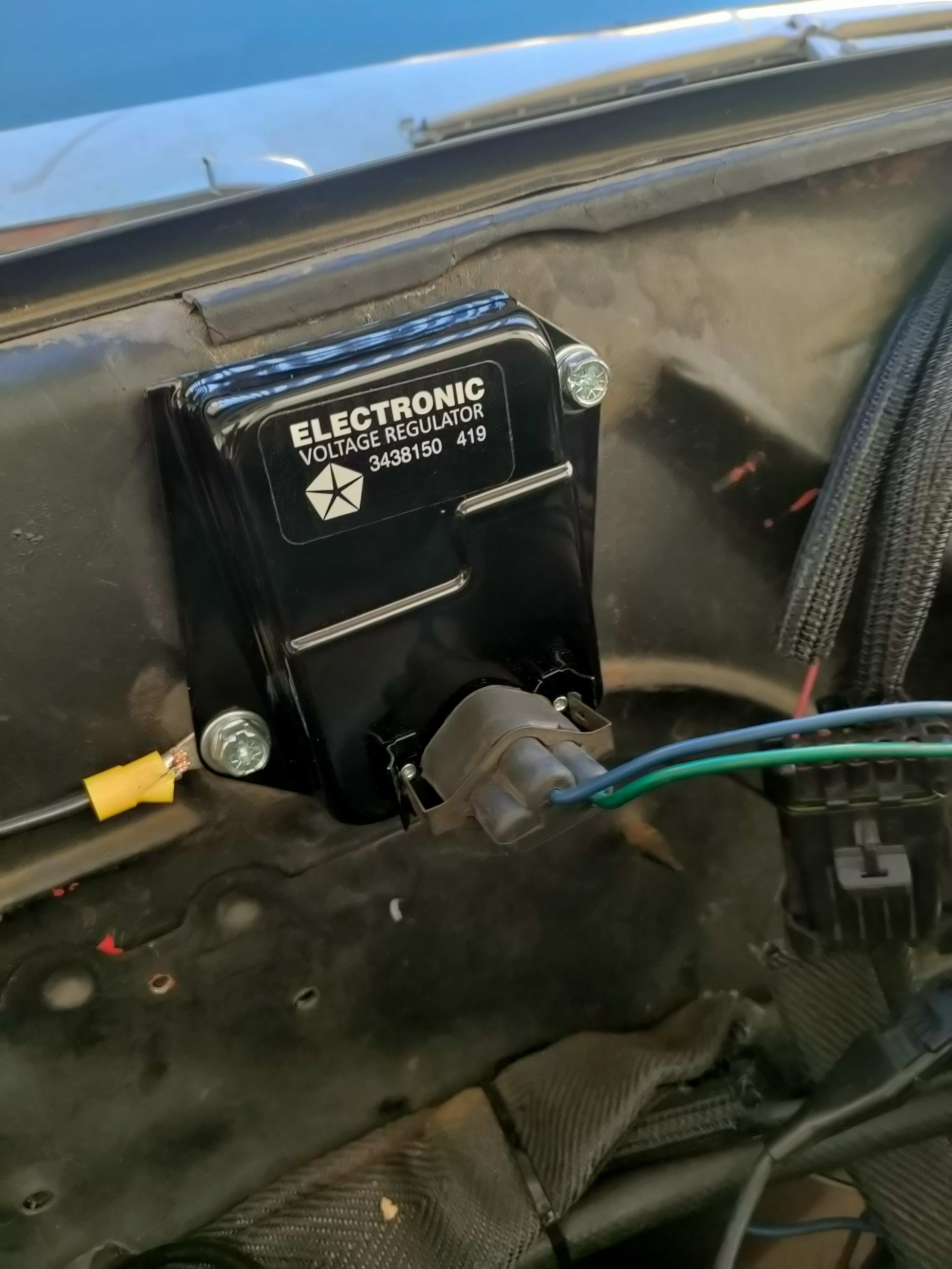

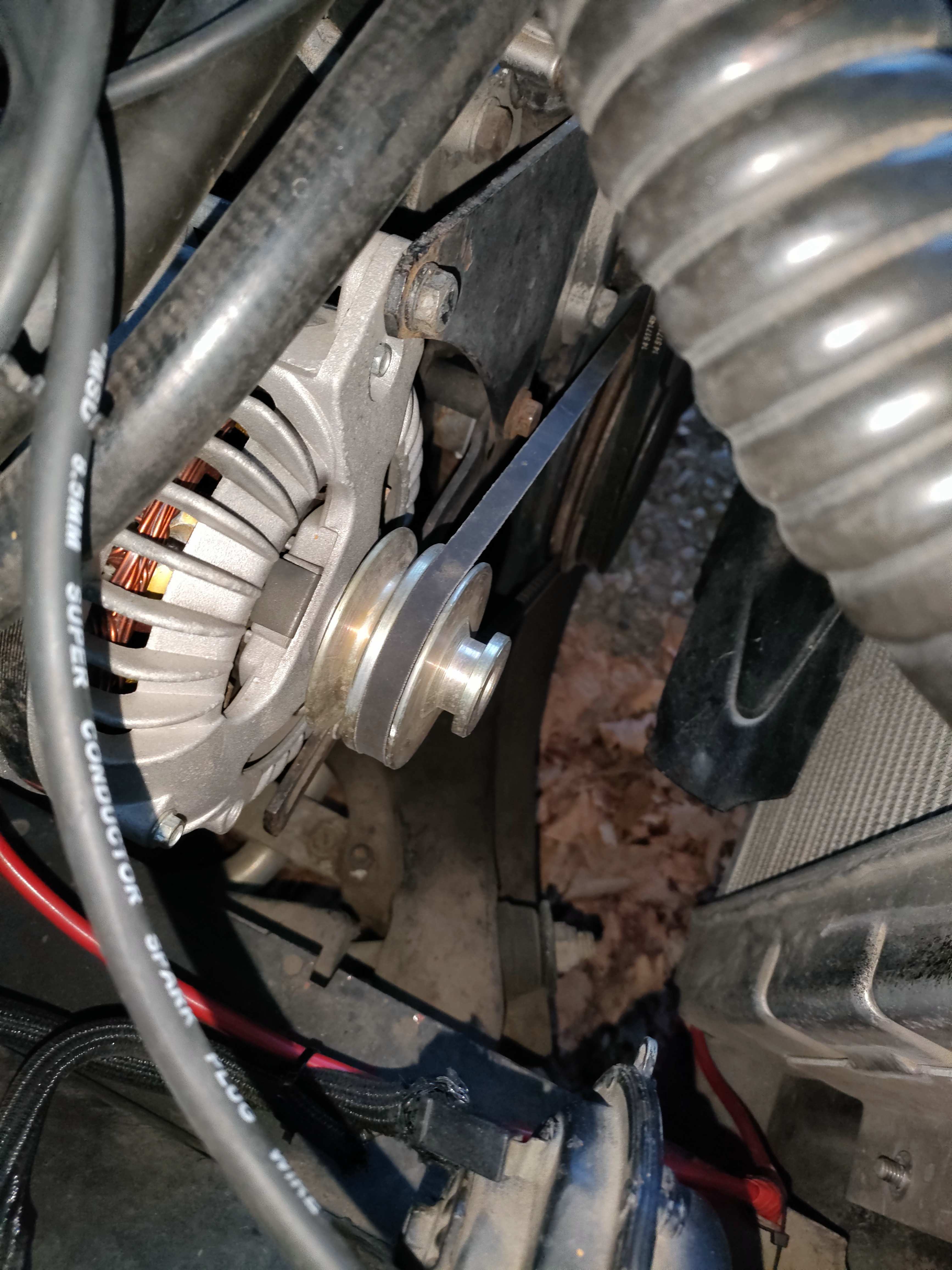

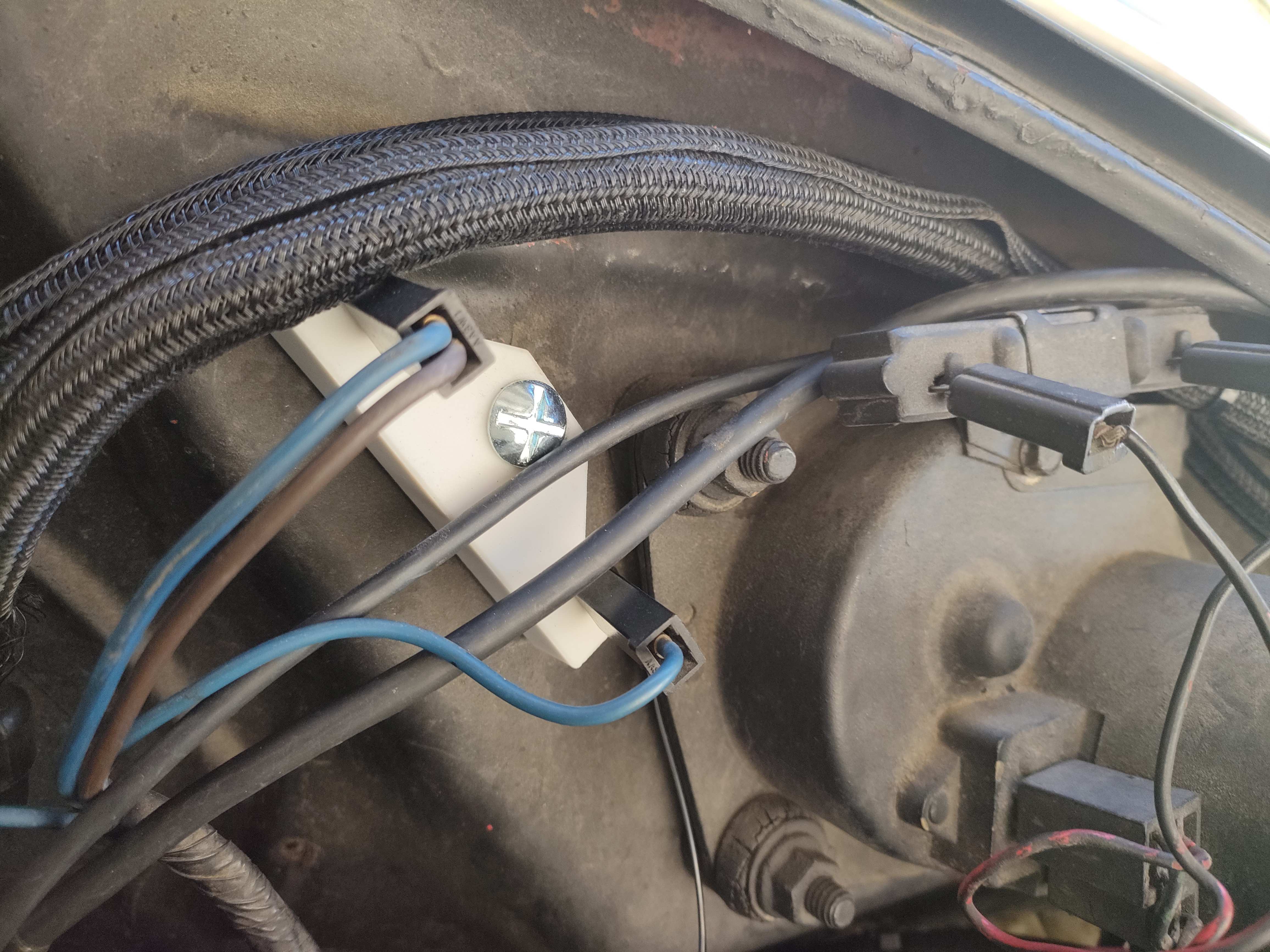

I show you picture of my install, maybe you can see if something is wrong.

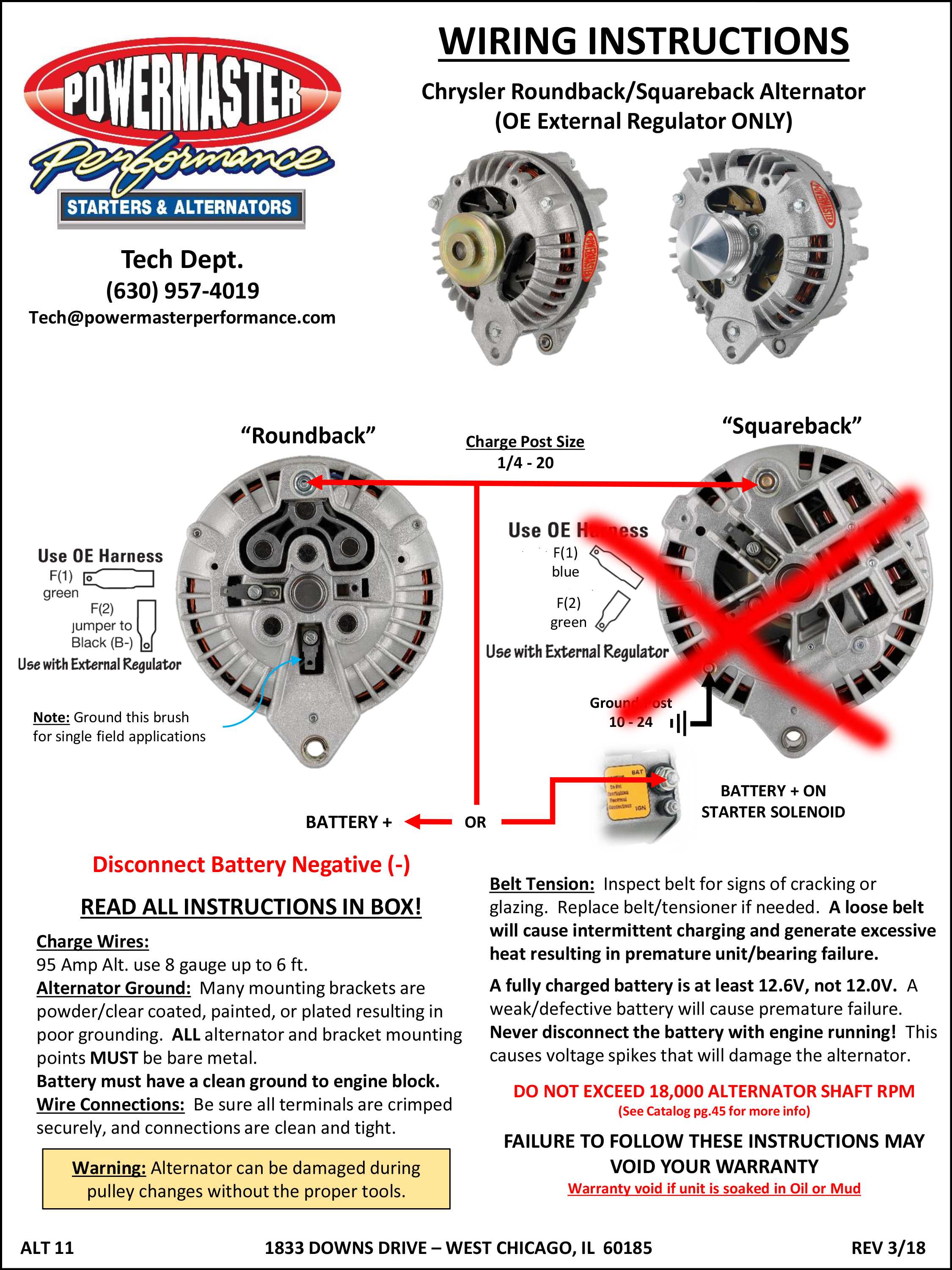

Here the instructions for the Powermaster alternator and for the charge wire :

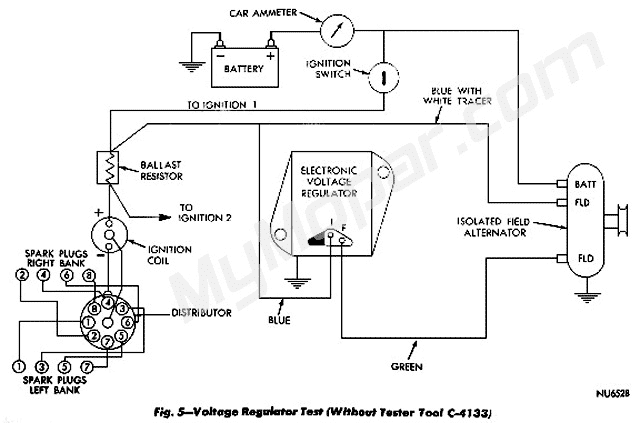

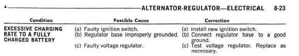

Focus on the voltage regulator, because that's it's job, to regulate the voltage. From the 1970 (for example) FSM
Looking over your images, I don't see anything obviously wrong. I see "wrap around" loom tape on your wiring harnesses. Someone took some time to make everything look neat. But this also means your wiring, and/or how things are connected, could be non-standard and may deviate from the factory wiring arrangement.
Most of us have experience with, and base our comments upon, the presumed wiring of YOUR engine. Can you give us an idea how YOUR system is currently wired? If you're unsure, and you cannot find the problem, I would make it high on my list to confirm how much your wiring adheres or deviates from the factory wiring diagram (found in the FSM)
Generally, the B(attery) output of the alternator (externally regulated by the voltage regulator) runs into the passenger compartment (bulkhead #18) and through the Ammeter gauge and back out to the engine compartment (bulkhead #16) through the fusible link (important !) and on to the battery positive.
It looks like in your case, you bypass the fusible link (not recommended) and ammeter.

Yes I bypass the Ammeter, I read more powerfull alternator can burn Ammeter.

- On the alternator field, like you can see on the picture, I have 2 blue wires on one field, but when I look the wiring diagram, I just see one blue wire, is that normal ?
And an other thing, the Ammeter is wired (before the bypass) in an other way than the wiring diagram : in the wiring diagram, black wire is on the left, red on the right, my Ammeter work with the red on the left (so on the C side of the gauge) and black wire on the right (D side of the gauge). On the back side of the cluster, the is RED write on the left (so C side of the gauge), that's why I thought I was good. It's not a 70' cluster, it's later, the button to reset the miles is on the right size of the speedometer, not in the center.

Okay, I did not try to connect the Ammeter because it's in the same place as the charge wire, I'm not an electrical expert, so I didn't want to wire together a black and a red (positif) wire on the same place, but do you think I can try ?
Because I see with your video, without the Ammeter connected, I bypass the ignition, and without the ignition ballast the voltage regulator could not work ?

I too suspect the regulator. I believe the alternator wants to put out around 17 volts constantly. The battery only want about 14 volts. The regulator's job is to do just that. Regulate. Some are adjustable some are not. If your connections are proper as it seems they are, I would try a different regulator to see if that makes a difference.

AI tried with 3 different regulator, with a tuff stuff (7545), with the regulator that was in the car when I bought it, and a Mopar Performance, I think I must have made a mistake with the connection.
It is normal, if it feeds power up to the carburetor. The factory 1970 440 HP, for example, had an idle speed solenoid at the carburetor, and a blue wire FROM the alternator feeds power to that when the engine/ignition is in run position.
Since you're using a reproduction of a factory harness, if it's for an engine-year that comes with a solenoid, it is likely that is where the wire is supposed to go. It usually terminates to a bullet connector.

If the voltage regulator were regulating, then you would not see 16V at the battery. If you believe one or more of your regulators are in proper working order, it seems the only thing left is a wiring issue.
