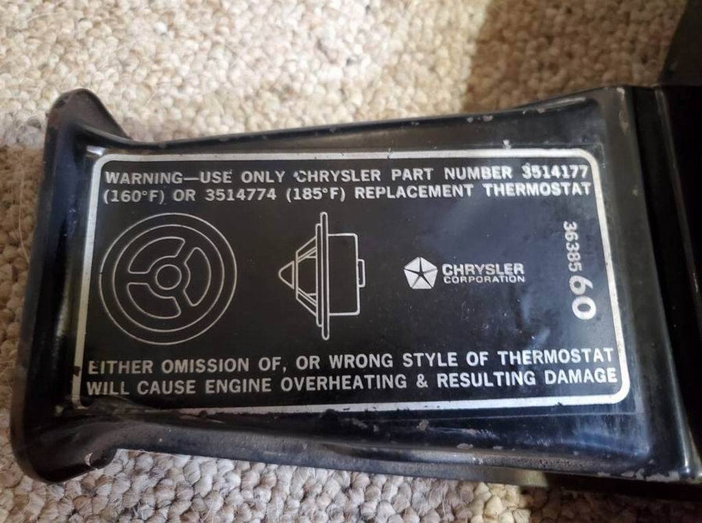

Decades ago, a magazine (I wish I could remember which, but I think it was Hot Rod or Car Craft) did extensive testing on radiators and their efficiencies. They used individual temperature probes in each row of various multi-row radiators. Much to their surprise and chagrin--being GM guys--they found that the water in the fourth row was actually being heated by the air that had passed over the first three rows.That radiator was less effective than its three-row equivalent. That's probably why Chrysler never made 4-row radiators.
That being said, those fellas were testing copper/brass radiators, which are far more effective at shedding heat than aluminum units. Aluminum is not better, it's just cheaper and uglier.
Because it was a basement-budget project, I bought a pure-Chinesium 3-row aluminum radiator with a molded top tank for my Valiant off eBay for $138 shipped a couple of years back. I painted it black to avoid the ghastly look of an aluminum unit. Most people don't even notice the radiator, much less the welds holding it together. It blends in like a stocker. The engine is a 10.5:1 W2 340 with a .587"-lift solid roller cam. With a factory 7-blade clutch fan, no shroud, and an NOS factory thermostat, the temp gauge stayed nailed to 180° during a week in the 90s this past summer, including a ton of idling time... in a cramped A-body engine bay with painted TTi step headers.

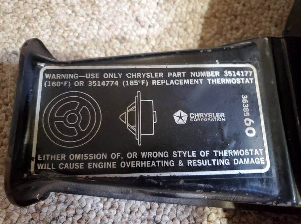

Make sure you use the right thermostat, meaning NOS Mopar for your application. Yes, it's going to be expensive, but the original design is an integral part of the cooling system's design. They're no longer available new, and nothing like them can be had at a parts store, the dealer, anywhere. It's important enough that Chrysler put this decal on motorhome air cleaners:
Notice the wording? "WILL CAUSE ENGINE OVERHEATING" rather than "MAY" or "COULD". If it doesn't look like the one on the decal, and is not made of solid brass with a copper slug, it's not the right thermostat. Mr. Gasket's copy will fail; it's the worst form of Asian trash. There were tons of complaints on the 'net about it awhile back.
OEM are the only ones I've used since the late '80s, and I've never had cooling issues. I daily-drove a '72 Charger with a modified 440 Six Pack for three summers in Atlanta, GA using the original 400's radiator. It never overheated, even on triple-digit days. I did, though, a few times. That car was flat black with a black interior and no AC... it was like driving Lucifer's oven.

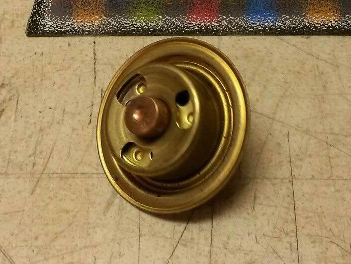

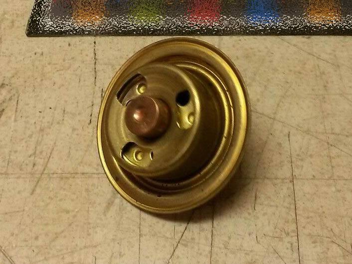

As I mentioned above, NOS is your only option these days--eBay, car shows, etc. I started hoarding 'em awhile back so I'd never be without. I've got a pretty good supply on hand, in both 180°/185° and 195° versions. I bought a box of ten 180s for $65 at a show in 2019, so not everyone thinks they're gold-plated. Some eBay vendors certainly do.
The original vendor was Robertshaw, who I believe left the automotive thermostat business sometime in the 1990s. Summit, Jeg's, etc. used to sell them as "Robertshaw high-flow" thermostats, but I haven't seen them listed in those catalogs in a couple of decades. Stewart Water Pumps sells them for Chevrolet applications; for Chryslers they bond a plastic spacer to the Chevy part. It's not the durability that concerns me, it's the smaller aperture. Mr. Gasket makes, or at least used to make, a copy of the Chrysler/Robertshaw that was sourced overseas and should be avoided at all costs.
The exact-same item used in pre-'78 Mopars was original equipment in Ford's 351 Cleveland engines. If you look, you'll find much discussion online about how important that style stat is to properly cooling the temperamental Cleveland, sometimes even listing the appropriate Mopar numbers that fit. The Cleveland water pump literally has a specific opening for that copper slug.
Another thing I forgot to mention, but it's in the service manual and everyone ignores it: Use only distilled water in your cooling system. The minerals and chemicals in your tap water do not have the cooling properties of water. Eventually the minerals deposit themselves on the metal, further hampering cooling. It's cheap, it's easy, and it's what Chrysler (and everyone else) used and recommended. Softened water is not distilled water. Much of the mineral content is reduced (not eliminated) but softening does nothing about whatever chemicals your municipality is dumping into the water supply these days: fluoride, DDT, LSD, battery acid... whatever it is that's causing this country to lose its damned mind. 😄
If it doesn't look exactly like this, it's not the right unit:

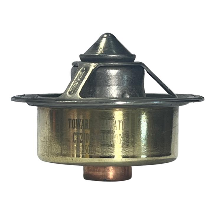

What about these Mr Gasket's...???
Read both of my posts again. Already covered, twice.
Robert shaw are still around also...
Read both of my posts again. Already covered. It bears mentioning that the FlowKooler Chevrolet stat you posted is considerably more expensive than any of my NOS ones were, even with shipping.
I bought a 160 for my boats 340...
Why does your 340 have a '78 or newer 318/360 EGR intake on it? That's all the one you posted will fit, since it's a small-block Chevrolet thermostat. Well, I guess it would also fit a standard Edelbrock Performer like the 2176. Of course, that intake performs worse than the OE EGR unit and is as worthless on a 340 as a screen door is on a submarine.
Maybe you'll eventually figure it out, but by then all the inexpensive NOS ones will be gone. Feel free to learn the hard way. Some have learned, some want to learn, and some want to argue. To each their own.
