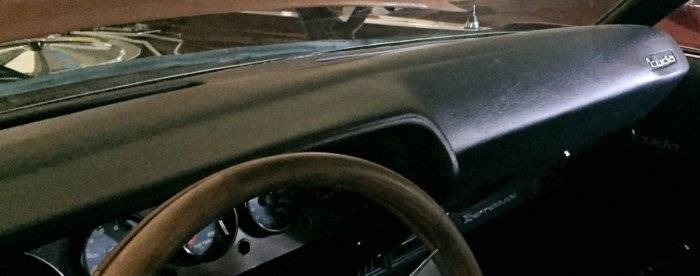

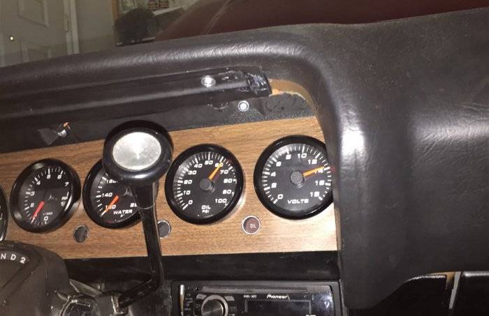

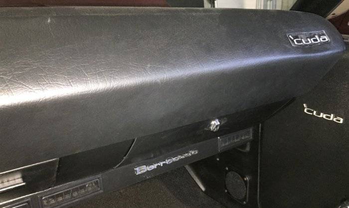

I have one from Classic Industries that cost me after discounts about $80.00 and I am happy with it.
To answer your first question it depends on how knowledgeable and detailed minded you are.
That is to say that to the normal person and regular Mopar people it looks just fine.

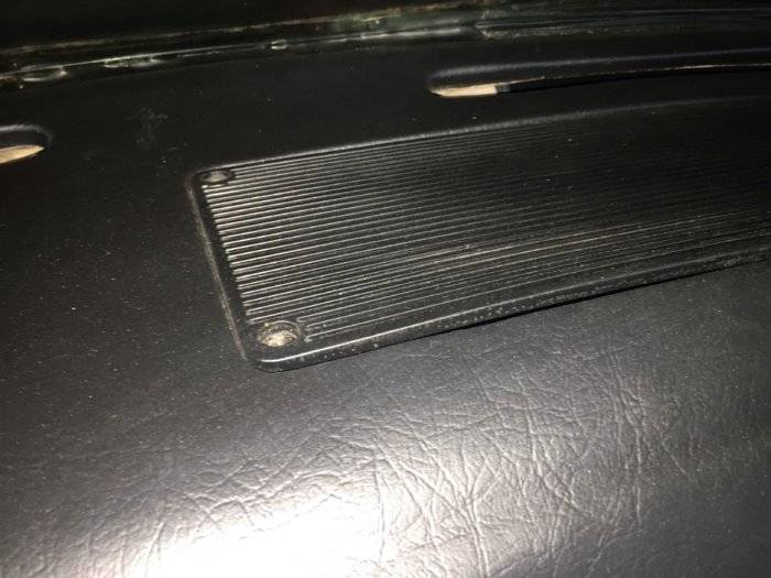

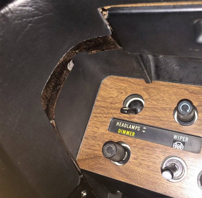

Now if your a Mopar "expert" or hobbyist then no it will not look "normal". One big giveaway is the square cutout on the driver side VIN number tag area.
The above answer would also apply to your second question as far as color and texture. And probably yes your old door panels etc will look faded compared to it as it is new.
Bottom line to me was money and being a driver and not show. If otherwise up to $2000.00 for a full dash compared to $100.00 for a cap.
I will post some pictures of mine, so you be the judge as to whether it is worth it to you.
BTW , at least for me, it did pop over the original cracked dash almost like a glove.

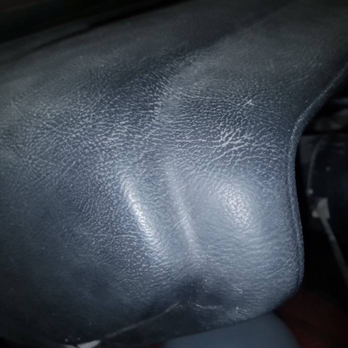

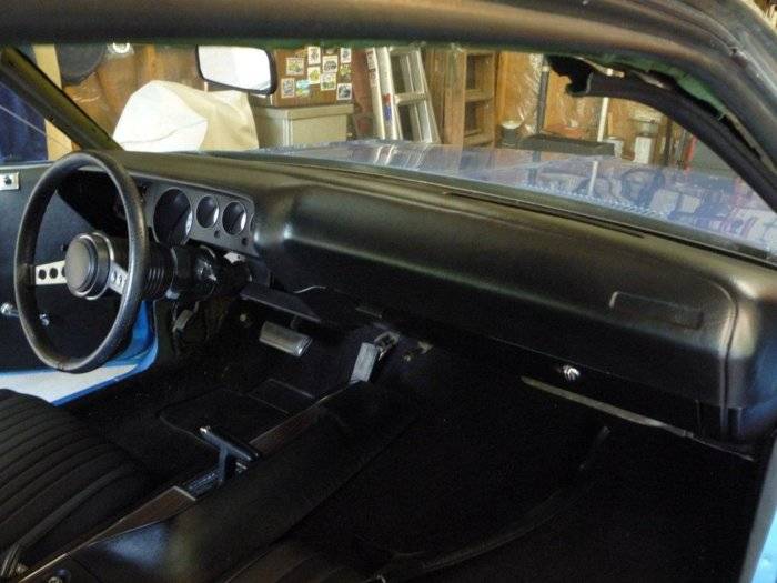

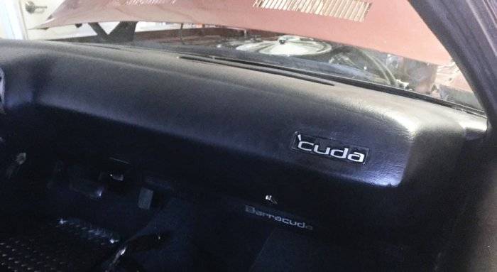

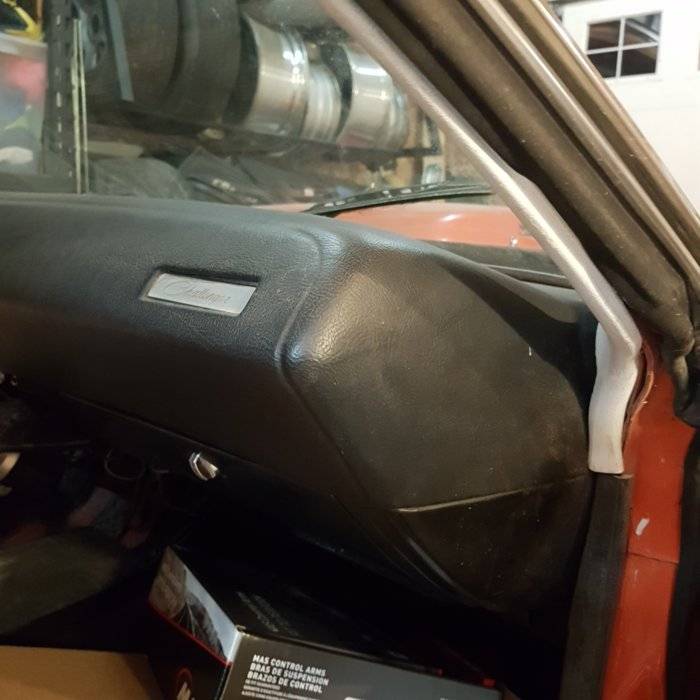

I have also used a dash cap on my '74 Chally. I cut off the high spots of my original dash as it was split open in a few spots and filled in the voids with bondo. My interior is white with only the dash and bottom kick panels being black so i haven't really noticed a difference in color/texture. The only 2 spots which make it look like a cap is by the vin and driverside front corner which i think is more my fault then anything else (install spots to keep a eye on). But I am still happy with it. I didn't have a windshield in so this made it easier to clamp/tie down the cap (i also used weights). A lot cheaper then a new dash and having to remove/install your vin (you can't mail it with the dash if your sending it somewhere to get redone). If i don't forget i'll take some pictures after work

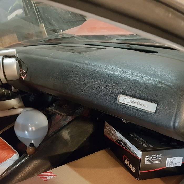

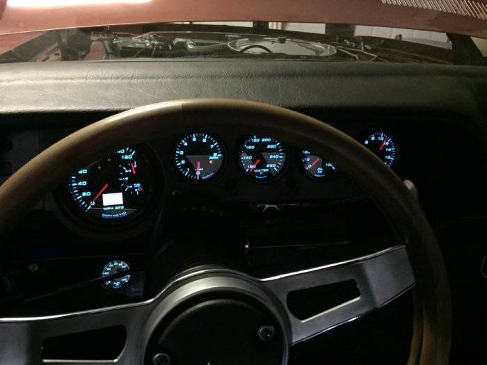

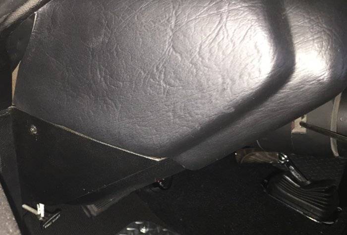

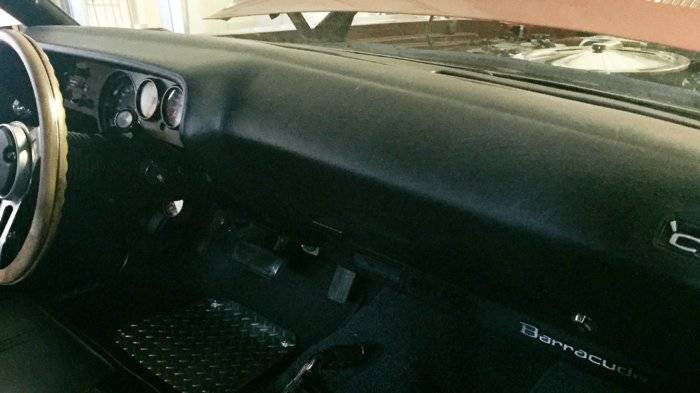

Here are some quick pics---sorry for both the bad pics and dusty pad but I hope you get the idea.

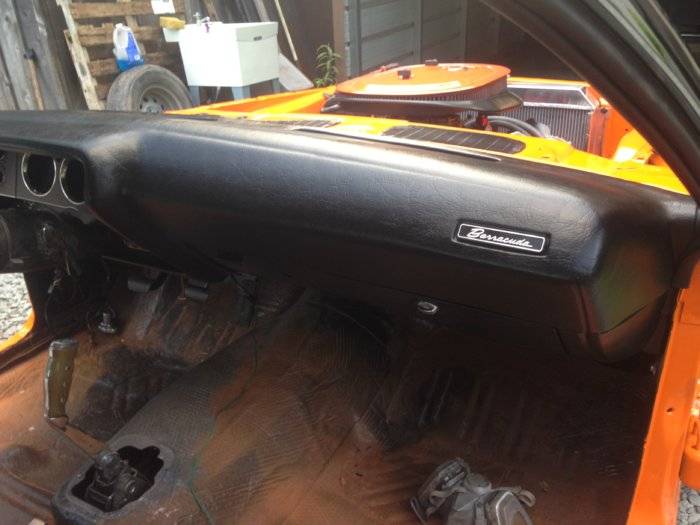

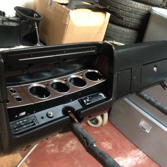

I put a dash cap on my 73 cuda. I had the complete dash out and apart. I glued the cap in a few different sittings as I was able to really pull and work it around. For under 100 vs 800 for a repo dash cover I think its very nice.

Thanks for the pics!! Honestly, that looks fine to me. I'm not looking to build a "show car". It's going to be a "driver" as far as driving around every now and again in the summer months, participating in parades, and a number of local car shows. I've had the car about a month now, and man it's already a head turner!! lol

For me it was fairly straight forward.
I just had one big crack in the middle and simply filed it down flat without adding anything between the crack. (Probably better if I had but the dash pad is pretty sturdy enough for that not to effect or show through. (At least in mine, your number of cracks, warp maybe way different)
Then finally just "snapped" it over and on the old dash and after I screwed in the middle speaker grill didn't even have to use the silicone glue that came with it. (Your "mileage" may differ)
That was all to it for me and still on tight from October 2016 to now.

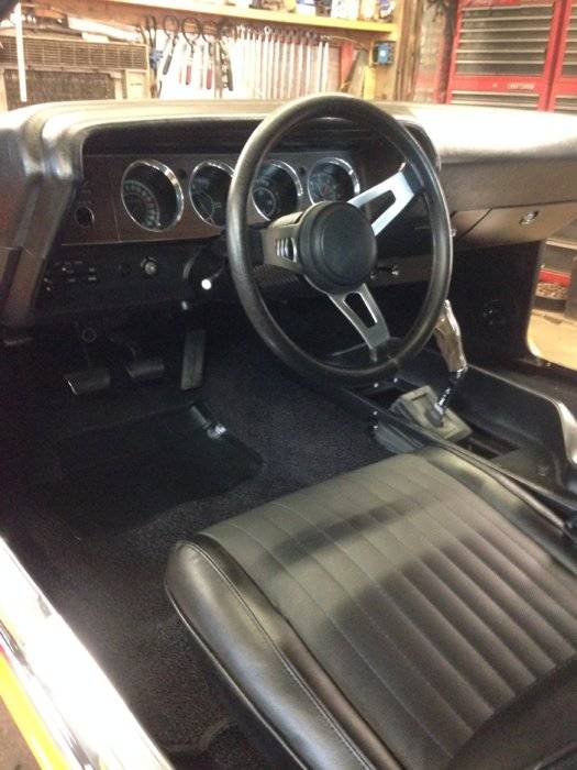

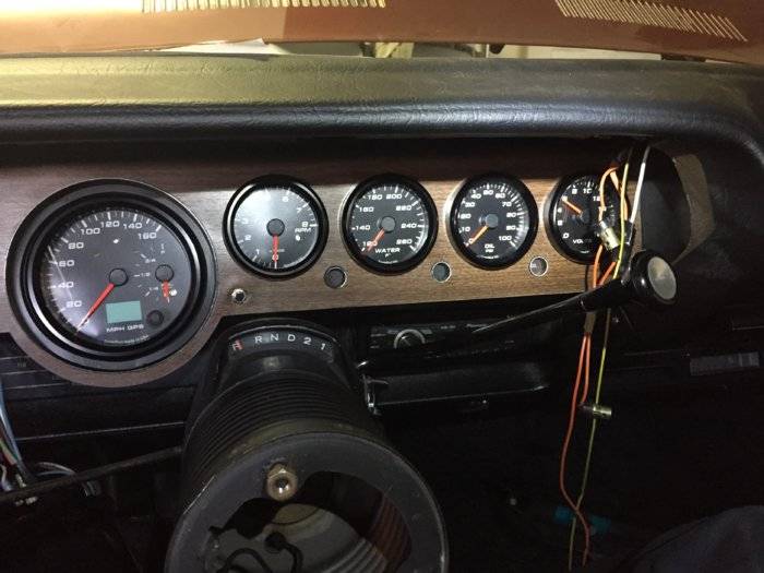

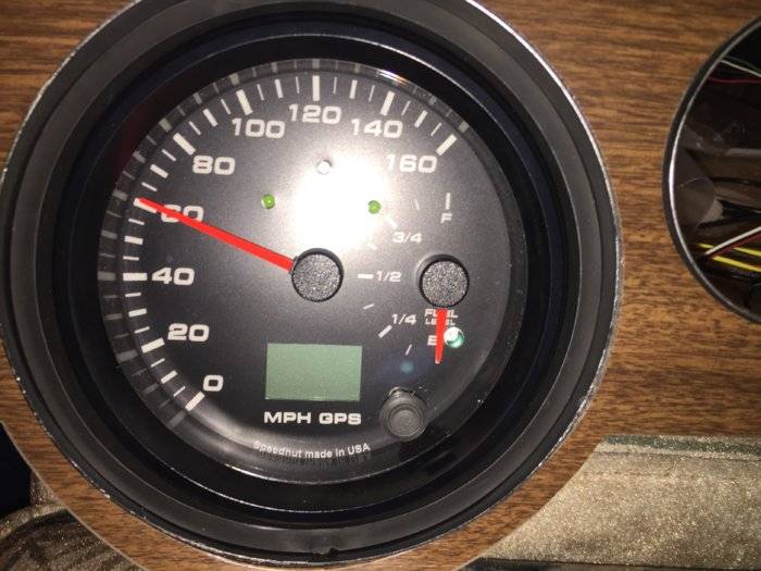

Just out of curiosity, is that instrument cluster an after-market deal? It looks like there is a digital gauge on the speedometer?
MoparcudaRay
Sep 19, 2016
120
14
Riverside, CA
Yes, it is sort of, customized by me.
I took out the old OEM gauges put a wood overlay decal on the bezel and then installed a set of Speedhut gauges in their place.
The speedometer is GPS and also has a digital display for different information plus an integrated fuel gauge .

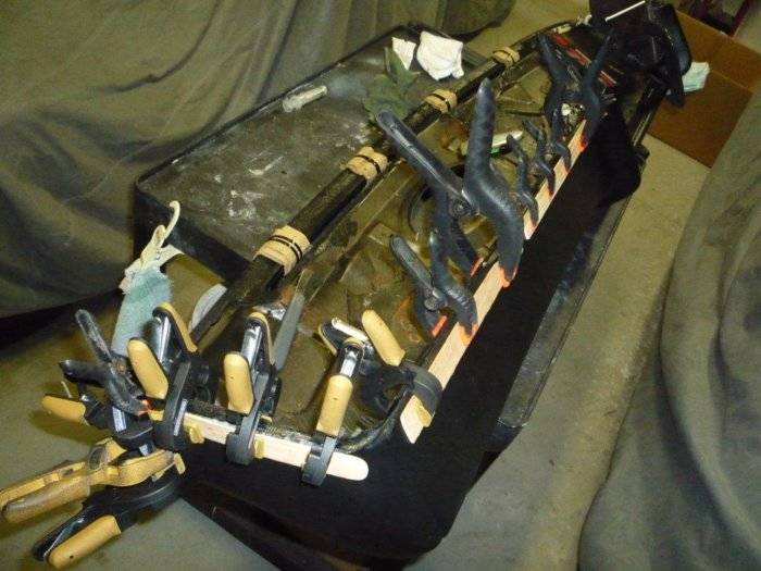

I did my dash cap way back in late 1990's so i forget all details of the install. I've done alot of painting so I'm sure I treated it similiar......as in sanding/roughing up the surface, wiping it down with a wax/grease remover, I'm sure i glued down (no silicone) then placed weights & straps on/over it to hold it down/inplace. I recall leaving it for a day or 2.

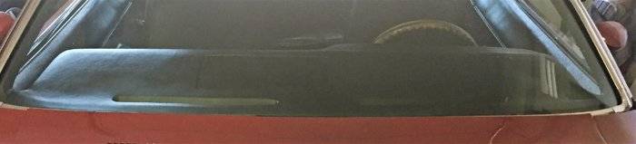

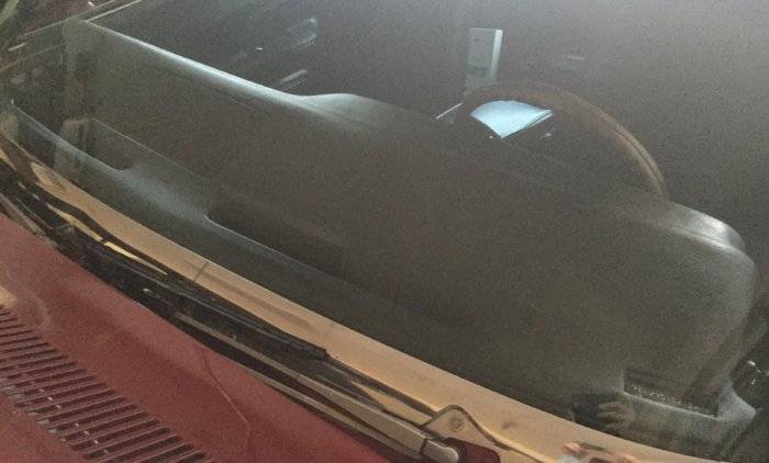

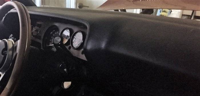

Sorry Not the best pictures but too much stuff to move outta the way. Don't have any real plans for the car over the winter (garage isn't heated yet) so its surrounded by "junk" so i have room to park the wifes jeep.
My cap was either from Year One or The Paddock (miss these guys)

Thanks for those pictures! I think yours looks just fine too. You guys have definitely alleviated my fears about it being a "bad toupee". lol

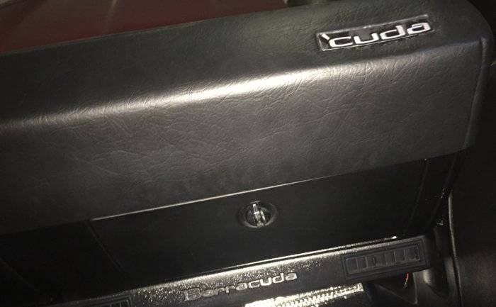

robert power
Feb 15, 2016
90
34

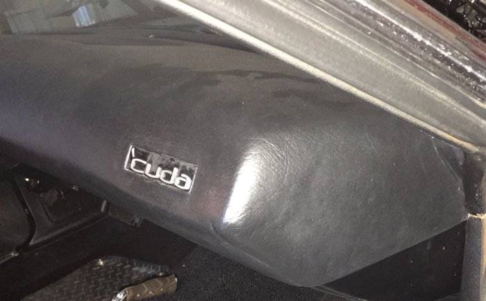

those caps look good except for around the vin.what did you do with that
racerkilla
Sep 12, 2010
89
37
I just left it.. not the best look but 95 compared to 800 plus.. I just did my 71 roadrunner cap and it looks factory fit but way smaller cap

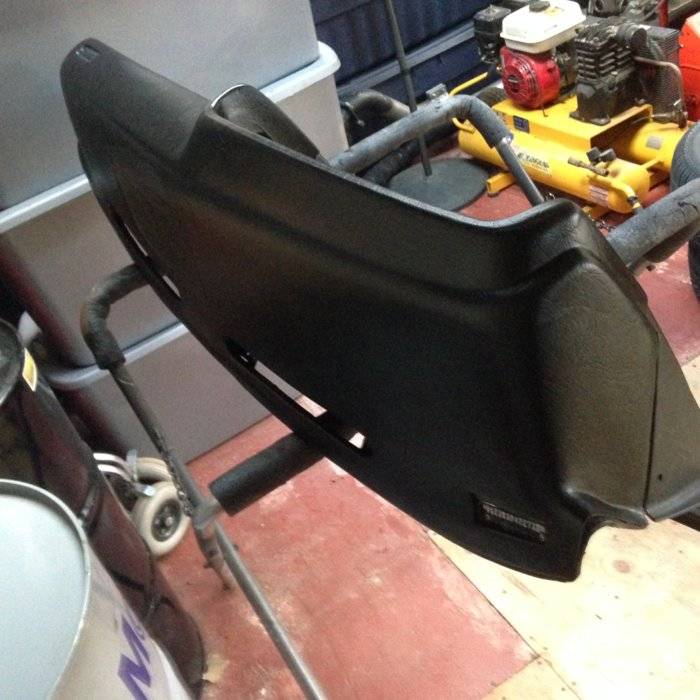

The original poster may have already done the job so this is just a "for what it's worth post" : I put a cap on my Challenger and the original dash was VERY bad, so it took a lot of work. I had spent $1000 on my other Mopar crashpad so I thought I would try the cap this time and save some $. The dash was out which made it much easier. But the results are almost fantastic and only a keen person would see it on. I had to use a small block of wood and some expanding foam (building cavity foam) to fill in the hollows and that was a very good decision.
My advice though would be to not use the supplied glue/adhesive/silicone or whatever they give you because the kit is made to a price and these will not be a great quality as they are trying to keep costs down. Best to use a good quality industrial polyurethane which will not be cheap but well worth it for a professional result. I used Marine Sikaflex 291 which is about $27 a tube for me and it is great for holding down all the edges and sealing the visible edges to reduce the notice-ability of the cap. And it will still be there doing its job after 10 years.
