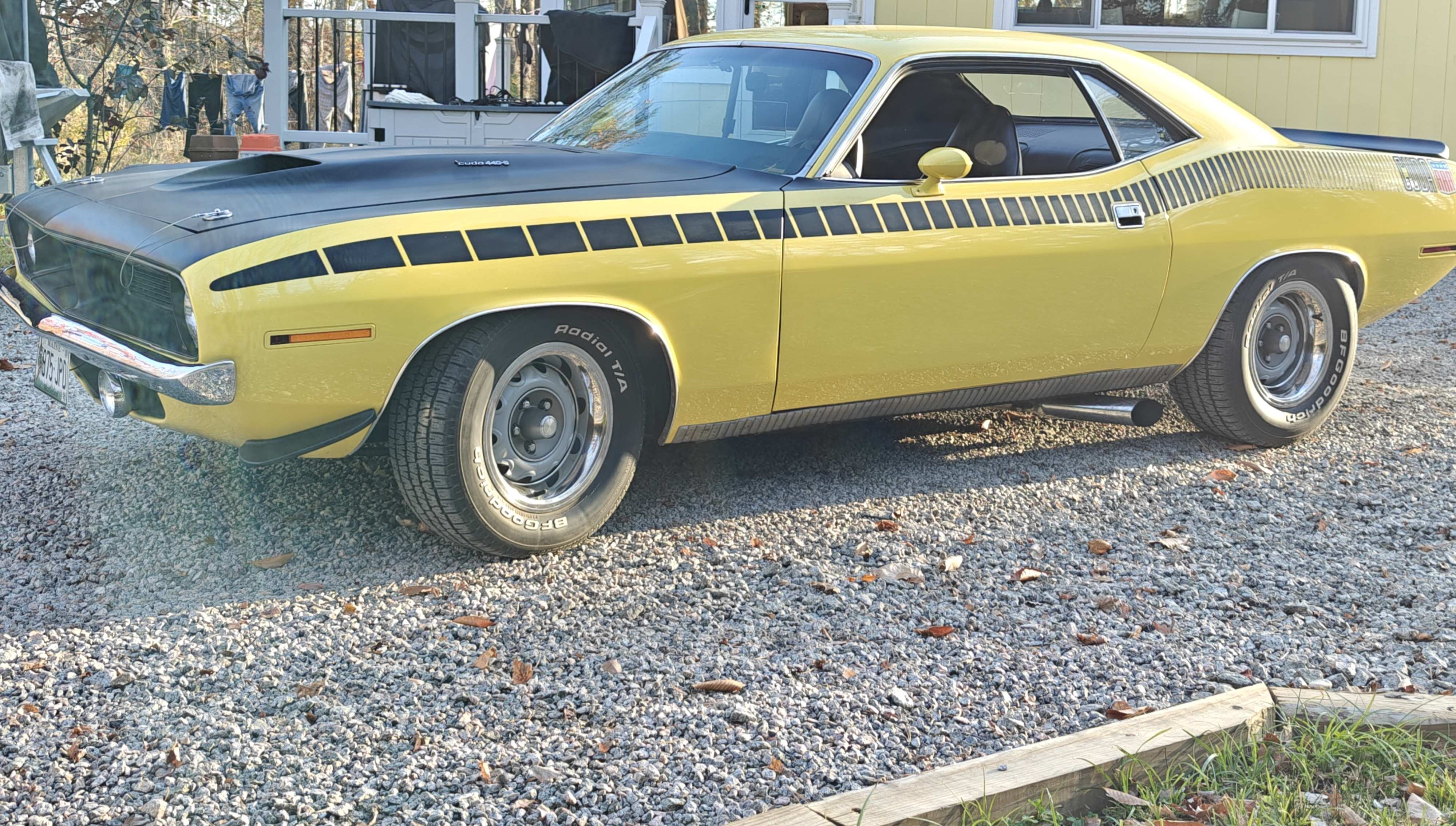

I don't have cragars, I have aftermarket factory style 15x8 with 275/60/15 on the back. They fit and i haven't had any rubbing, but I would say it's a tight fit. I believe the backspacing is either 4.25 or 4.5 I can't remember

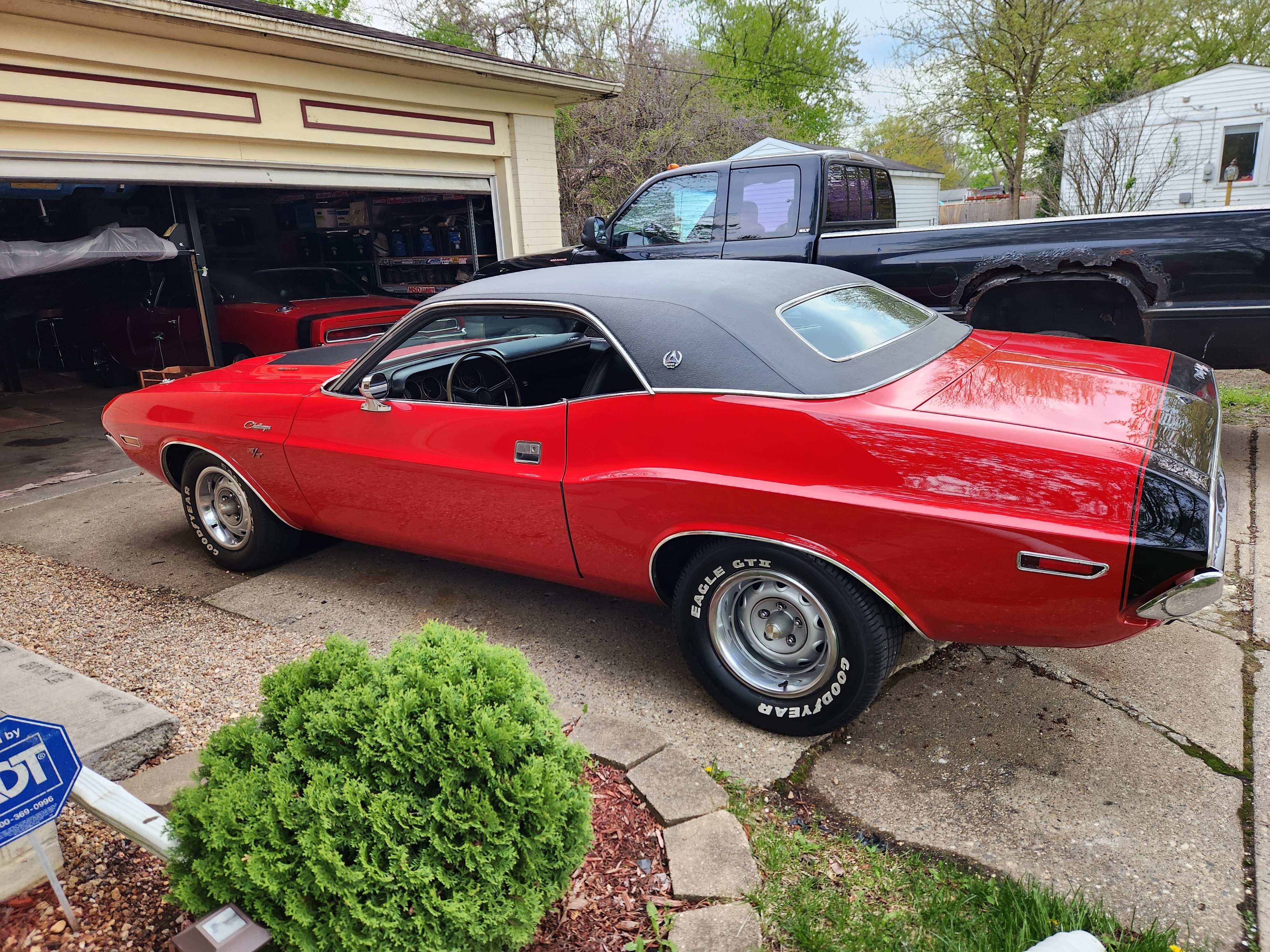

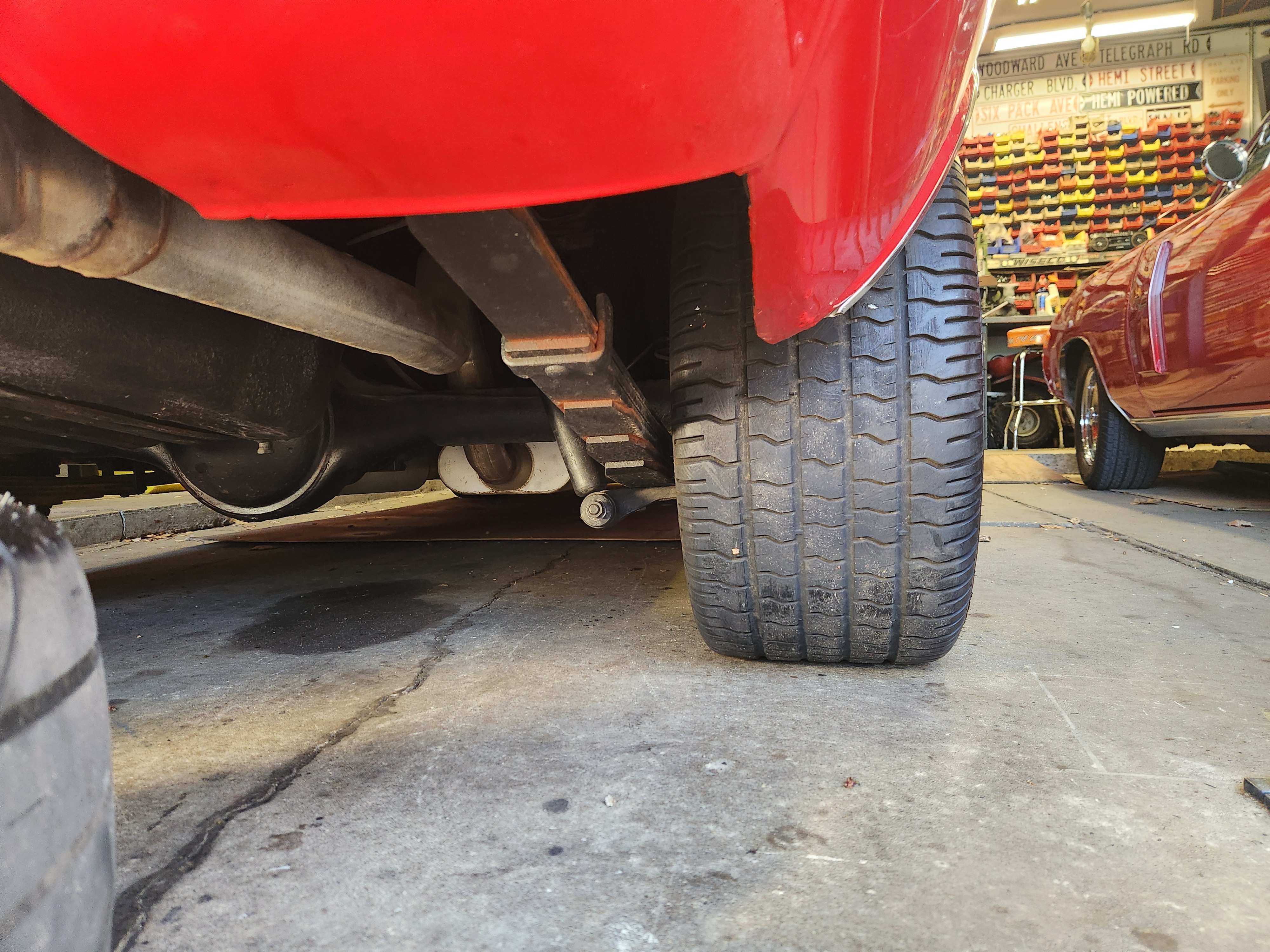

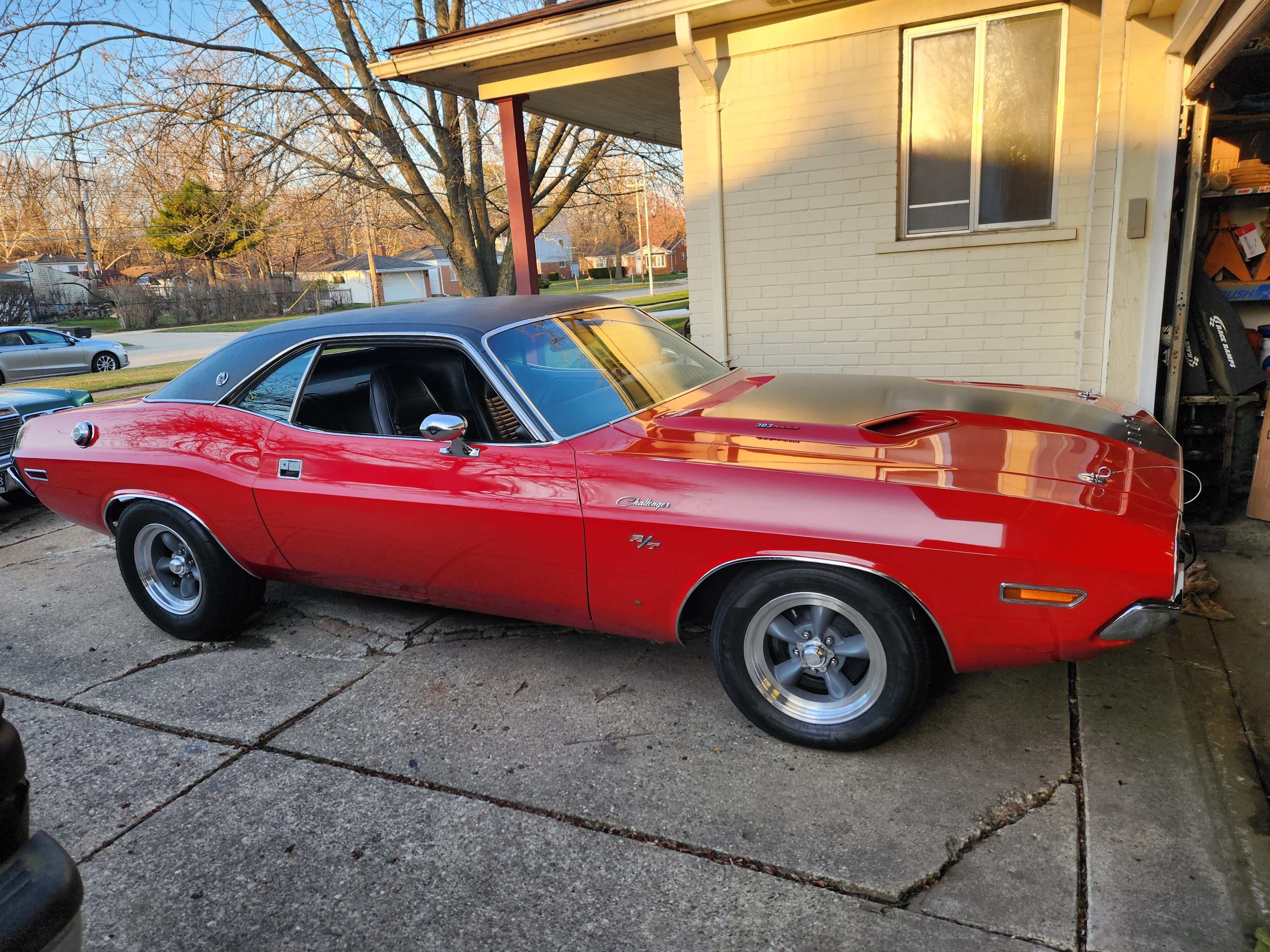

I have in the past. I run even wider 295's on my cars now on 5 different sets of 15x8 wheels with no issues.
What back spacing are you using ? The fit looks a little tight what are you using for shocks ? Any rubbing inside the wheel wells ? Understand I live in Pa where pot holes can be massive Smooth roads are RARE around here. Penndot sucks!!!
All stock type suspension and shocks. No mods anywhere on any of the cars, no rubbing issues any where, and no air shocks.
