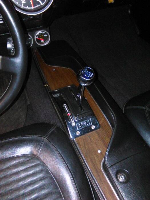

Hello again, have another question:
Bought a B&M Quicksilver shifter. I have a 71 Challenger and would like to mount this directly in the OEM Console. Has anyone been successful in doing this? Don't mind making any modifications to do this, just want to know if it worked or not. If so, pictures please.

No reason why this cannot be done , just have position the shifter to fit through the hole in the console & You may have to raise the sifter a bit so the travel works

Thanks, that was my plan, just wanted to know if anyone has done it already. Frustrating that they don't make one to fit for E-Bodies like they do for Chevy and Ford's.

It might take a little work but can be done!

Hey there, Happy New Year to you. So I started to install this and I'm still cutting away most of the original shifter mounting. How far did you have to go? Just don't want to take too much away and have to weld a ton of metal back on. Did you use any of the old mount or did you take it all the way down to the floor pan and mount it there?
