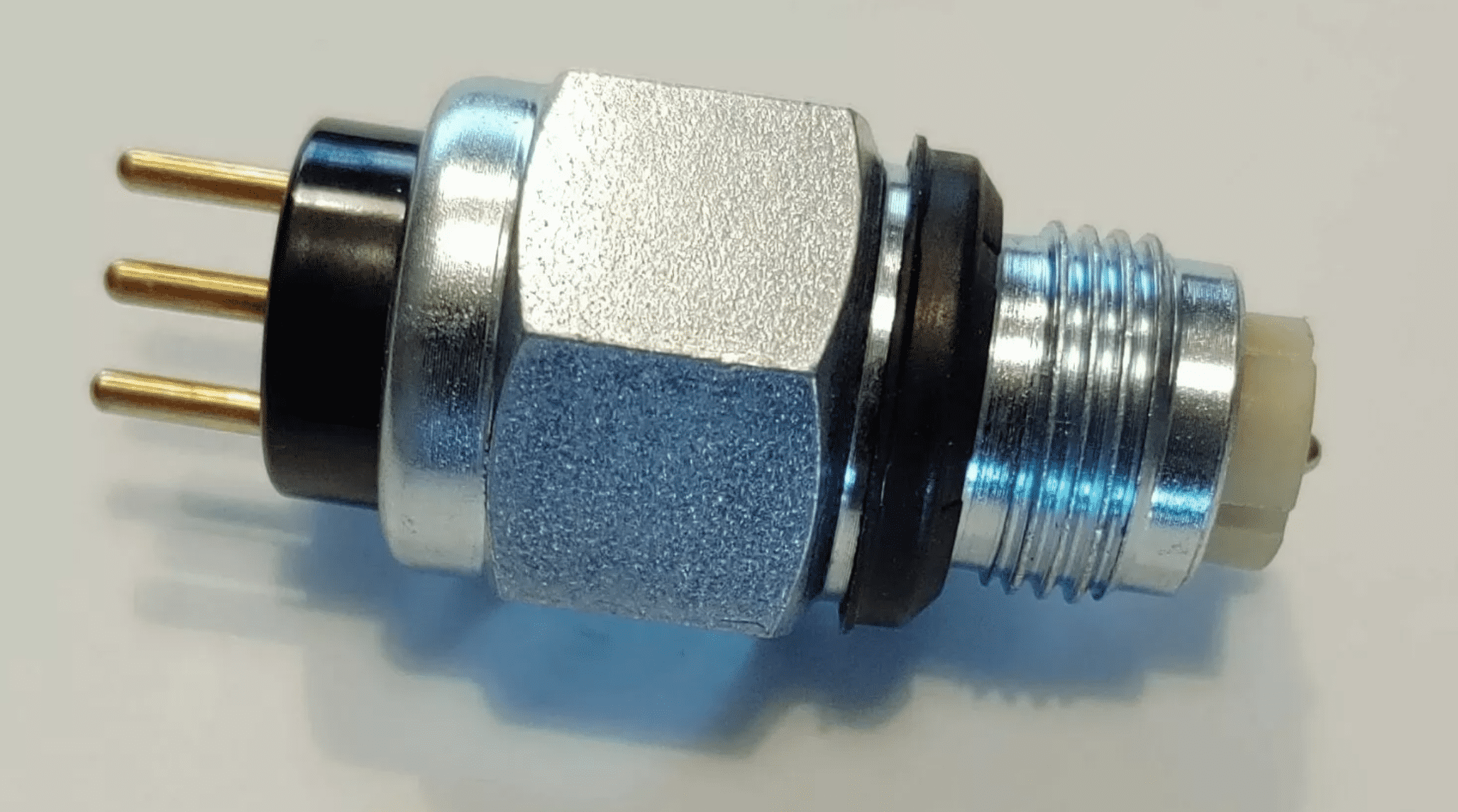

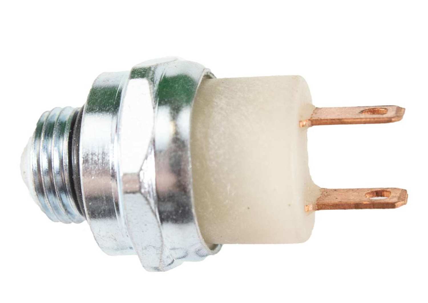

Can anyone post a picture of the correct back up light switch for a 1970 Cuda with a 340 engine I think its a two wire switch just wanna make sure

The 1970 Cuda reverse lamp switch is combined with the neutral safety switch in automatic transmission applications. The following image shows the switch:
The outer pins are the reverse light switch connections.
For manual transmission applications in 1970, both 3-speed 4 speed, the two terminal reverse light switch as shown in the following image was used:
