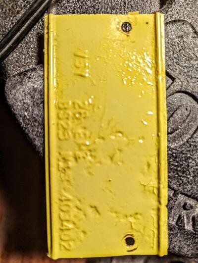

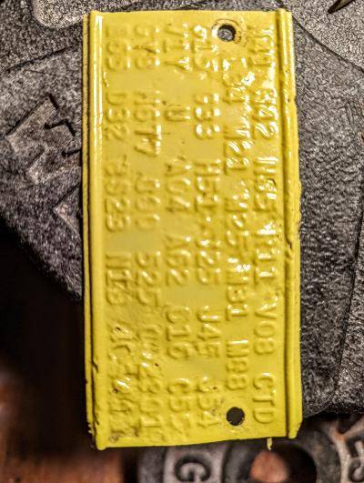

the fender tags are hard to read they were rusty when i sand blasted them and the paint crinkled a little It;s come a long way from where i started thanks for your help

i see the m88 code so it's top of doors and quarrters only ? found some clips for a 71 one place said they work with the repro moulding only ...I found moulding clip for a 70 cuda which requiries drilling holes is that what I need to fit the original mouldings.. thanks for all that replied
