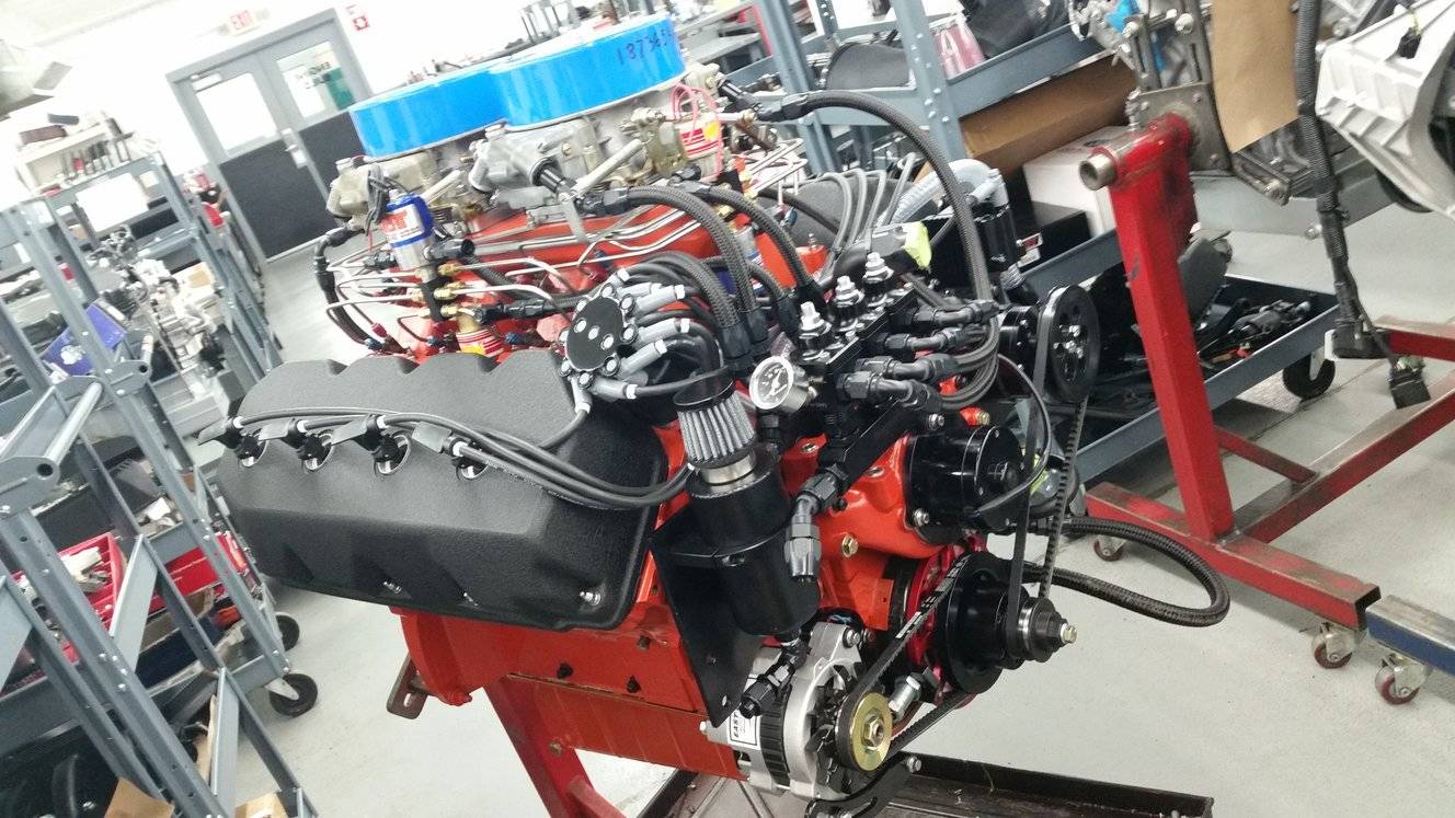

My 528" Hemi has Mopar Performance (Edelbrock) castings. Pump gas street car and strip. It makes alot more than 700 on motor alone without the use of both kits. Nothing wrong with Stage V heads either.

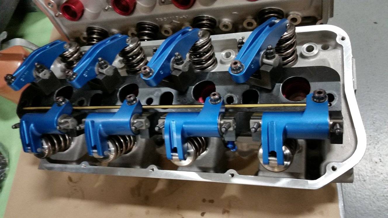

I was hoping you'd respond! So what kind of rocker setup is that? I'm coming from a 340 so the Hemi gives me a new adventure to learn about. Man I wish I was closer as I'd love to look at your car and pick your brain as you've traveled this road already!
The Rockers are Ray Barton's rocker system. My car was originally an A66 340 car also. I am not a numbers matching guru, so I built it my way.
That engine is a work of mechanical art! I like the way you have the alternator down and out of the way. Is that a kit or something you fab'ed up? Also I can't see but what do you use for a balancer? I'm putting together a whole new rotating assembly since my engine has stock guts. Would you mind sharing your rotating assembly combo with me? Maybe pm if you want to keep it off the board? I'm looking for a good solid starting point as my motor is going to my long time motor builder in 1-2 weeks. He's the engine builder/tuner on a local top fuel car that does the local NHRA nationals when they come to town. Both him and the driver have been doing this stuff since the 60s and he's getting ready to retire so this might be the last motor he does for me and I want it to be special as he machined and built my first 340 in 1985 among a few others over the years. I'm going to actually build it with him overseeing me at his shop so I am super pumped at the whole thing. He's very good buddies with Jerry Ruth so when they get together the stories get awful entertaining. I can't wait to get started.

Thank you. My rotating assembly is a Molnar 8 bolt 4.150 with 2.200 BBC journals and Molnar 7.100 rods. It is an ATI damper with a six bolt Chrysler hub. Looking back on it not, I should have gone it with a Big Block Chevy bolt pattern hub. I fabbed up most of all of my front dress since not alot is made for Mopar. The BBC bolt pattern hub would have made it easier for BBC drive mandrels and pulley kits much easier.

Thanks for the info. You have some nice stuff in there. Something to be said about hind sight. Thanks for sharing!

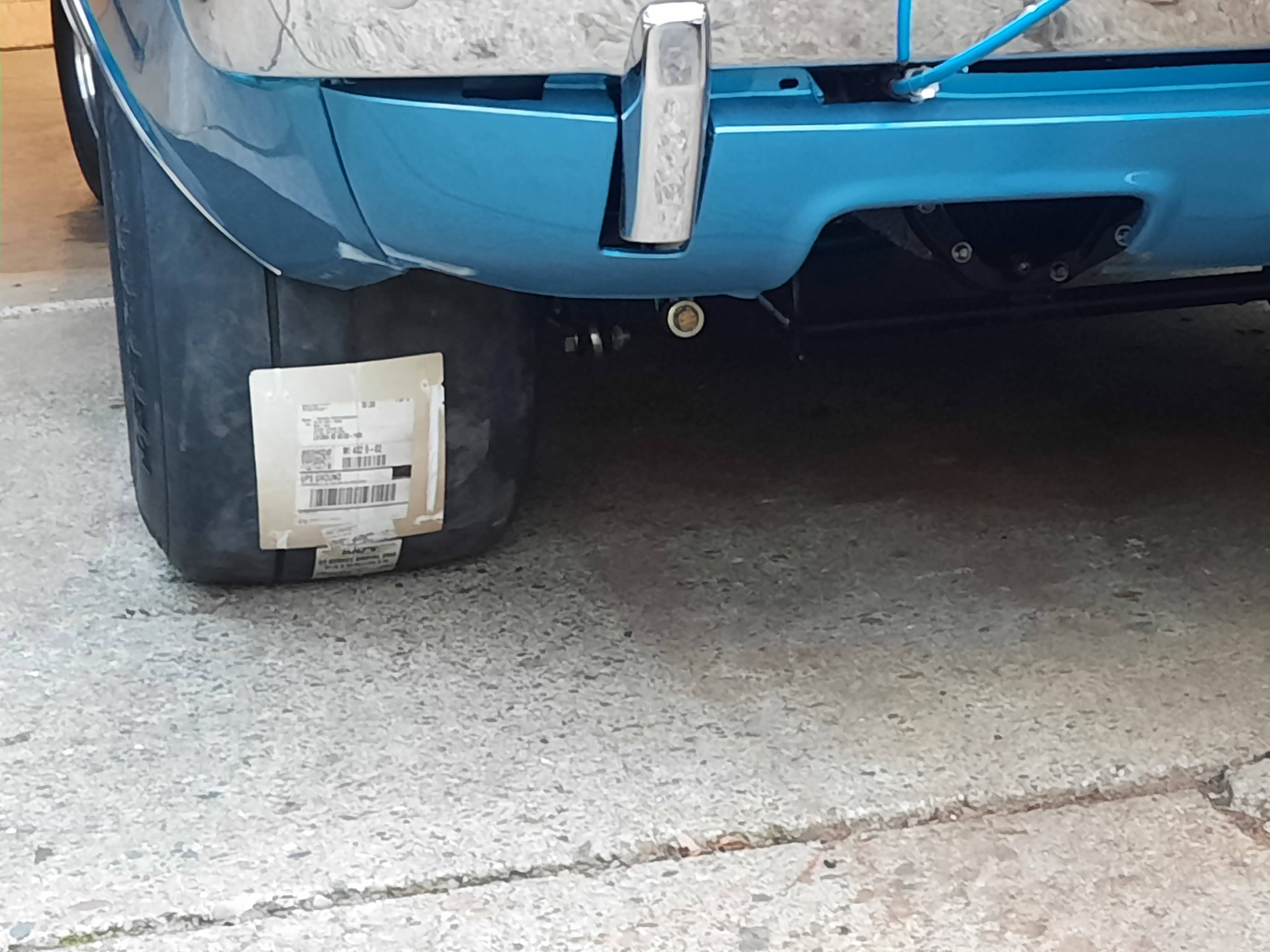

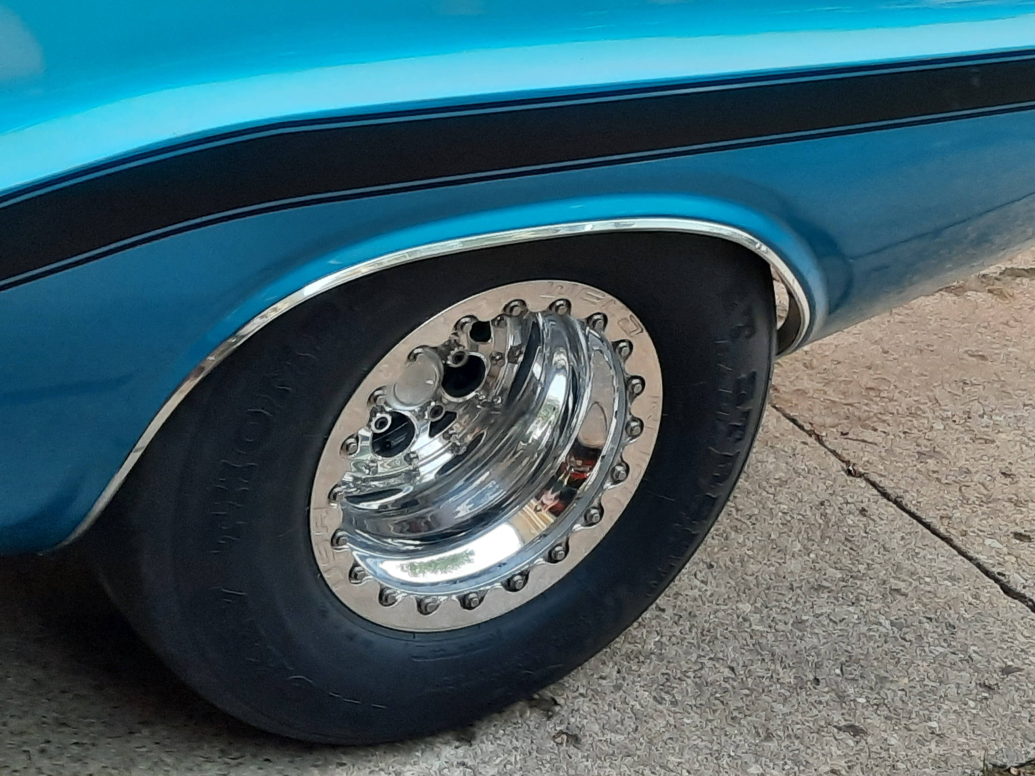

You're mini tubbed, correct? If so did you use a kit? How wide did your rear end up being? I have a USCT mini tub kit and still need to narrow my rear end. Body shop called yeaterday and they are supposed to put my quarter skins back on so I should be starting next week on the mini tub part of my chassis work. Been cleaning out my shop trying to make room for my project. It's amazing how much crap I accumulated over the years so off to the swap meet in a couple of months with everything. Again thanks for your input!
Yes, mini tubbed. That's kind of personal how wide my rear is..... I don't remember now how wide it was. It's been many years since done.
Ha ha that is kinda a personal thing. I have MT 315/60/15 ET SR and curious about clearance. I have a pro guy that will be narrowing the rear end for me so we will be able to get it right. How close is your tire on clearance?
It's a tight fit. About a 3/8" width on the inside. 1/4-3/16" on the outside wheel lips.

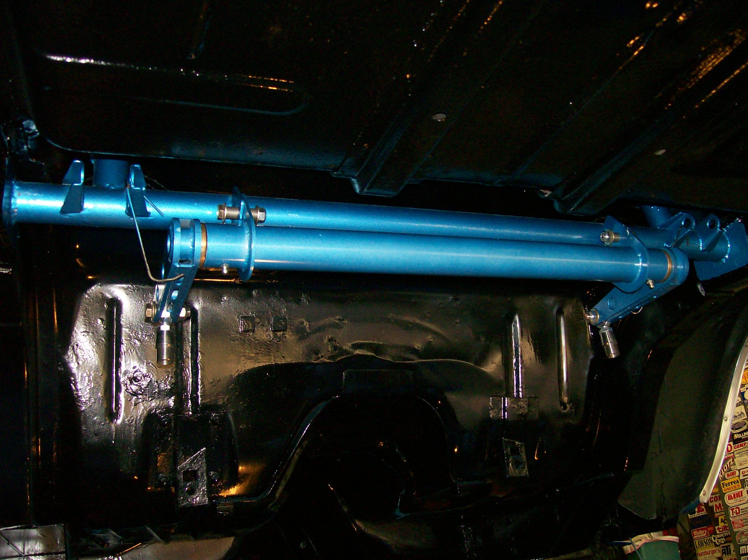

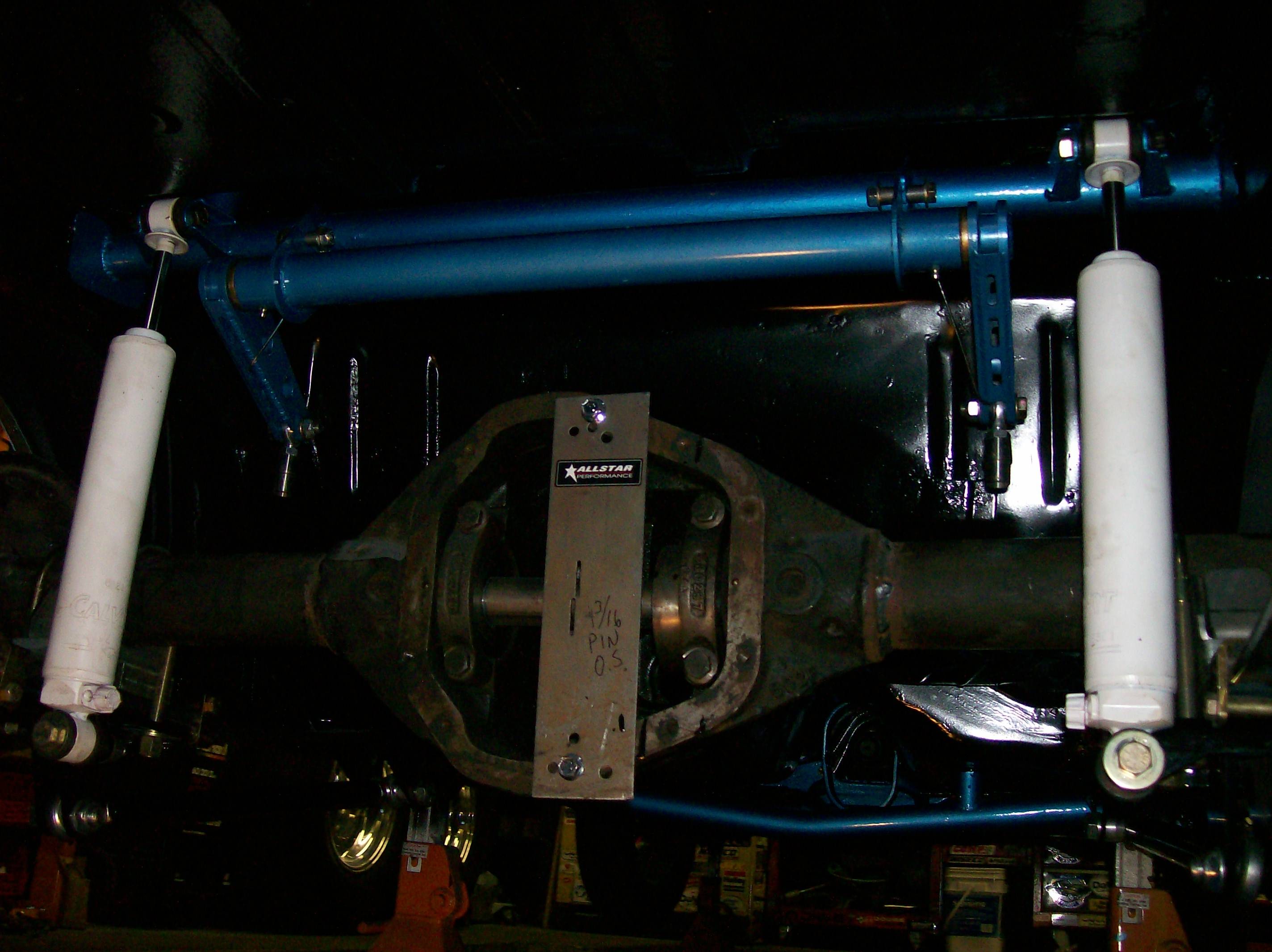

Hello, I have a quick question for you. Is your shock crossmember a homemade job or is it something I can buy ready to weld in? Thanks again. This project is dragging along but it is still moving (a lot slower than I wished). Take care.

It's a home made piece. It serves 3 purposes. 1) It is an upper shock mount. 2) My rear speaker tray down bars tie into it from the cage. 3) The Anti-roll bar ties into it.

Right on and thanks once again for the info. Do you use the roll bar much and if so where at mostly? I'm trying to figure that part of my equation out and I don't know if it's something that I'll need. I come with a circle track background and everything had bars so I'm trying to figure a rear bar's place/function on a 1/4 mile car.
