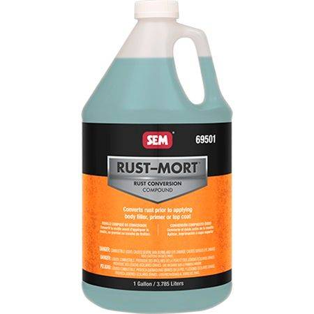

Stripping car down to bare metal.2nd step metal prep. strip it prep it that day. Don't wait. I like SEM Rust mort. Buy a gallon you will need it. more expensive quart at a time.

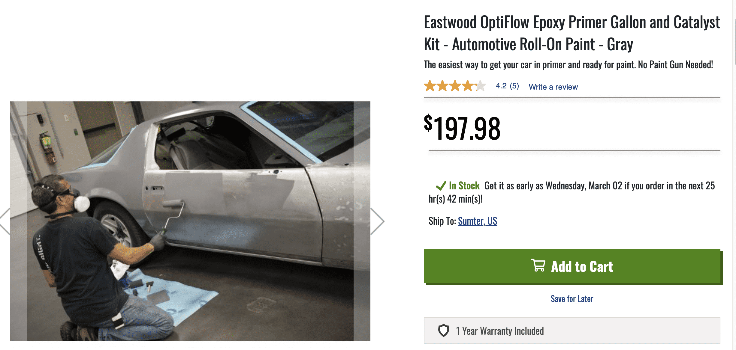

Don't apply it with a paint roller.
I have considered rolling it as that would work better for my work area situation but interested in why you say I shouldn't.
It’s more of a personal choice for me. If ya spray it, the thickness/mil is consistent. If ya roll it on…who knows???
