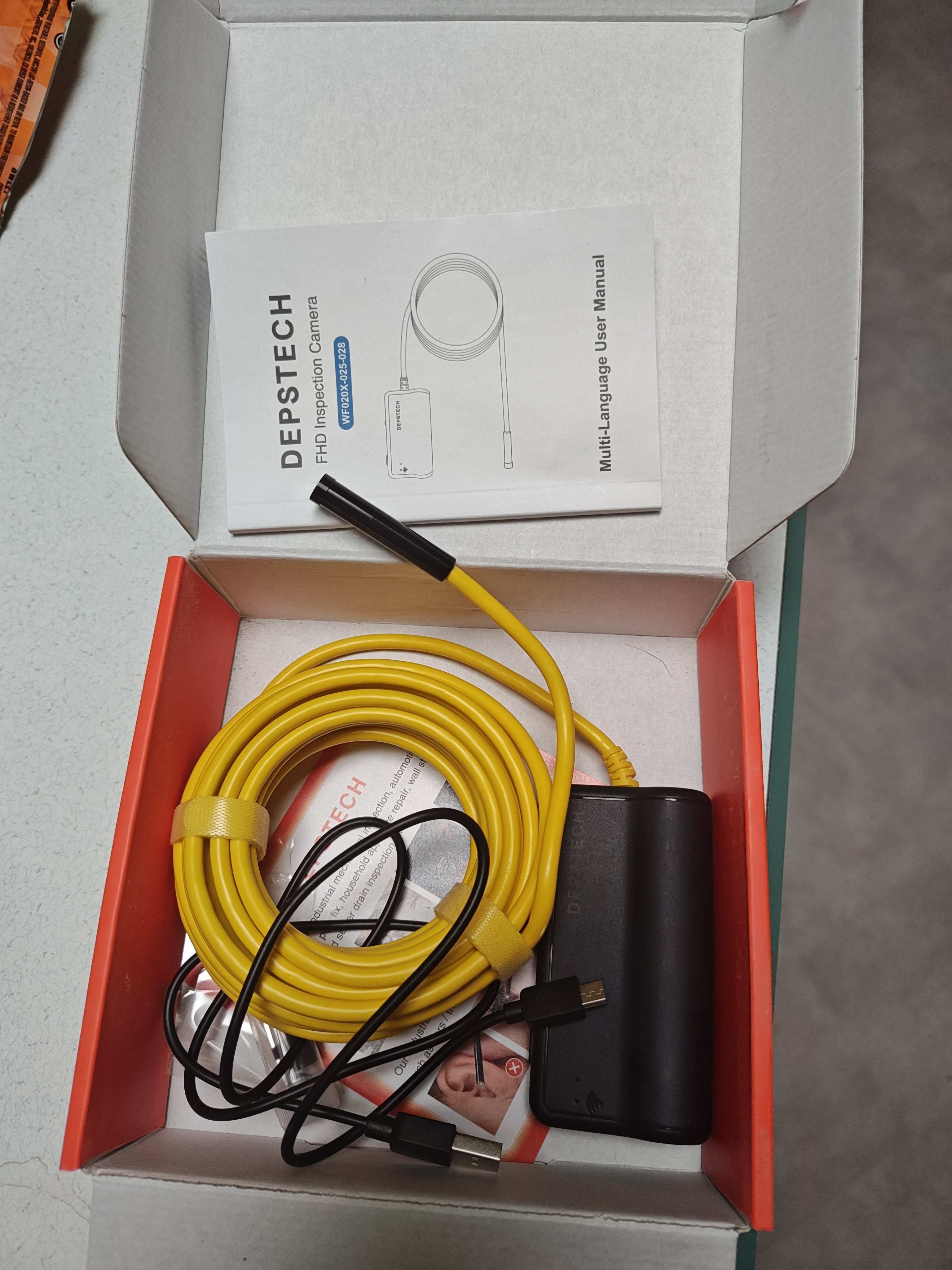

I'd pull the valve cover (easy to do - especially if you use the fancy reusable ones) and check tightness of everything and look down the pushrod holes at the cam and lifters. You can check pushrods and rocker arms for looseness by checking each cylinder at top dead center (removing spark plugs helps turn over the engine easier). If a rocker arm is loose most of its travel, you've narrowed down you internal problem. By the way, exhaust manifold leaks are usually loader at idle.
One of the best tools you can invest in is a bore scope that Bluetooth's to your cellphone. You can get into tight spaces and look around. The one pictured below is what I use. Even has a 90* lens. $44 on Amazon.
Ordered one, it was on sale for $39.99 ! Thanks
