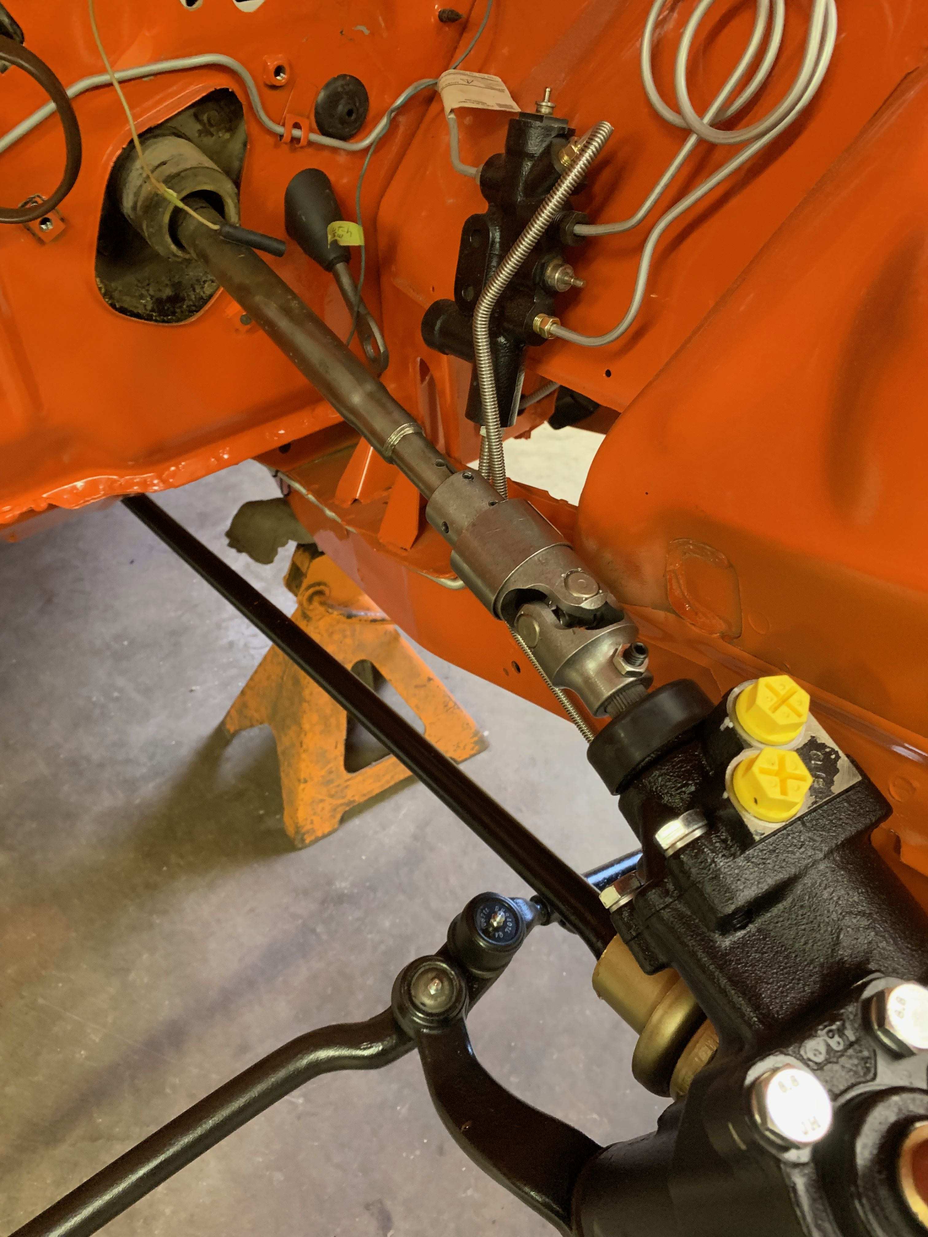

I used the joint that Borgeson offers part number: #036425 - $143.33 from Borgeson. You can also buy them on eBay for around $129.
Absolutely the best way to go!

I used the coupler supplied by Borgeso, part number #036425, and it worked perfect. I had to measure the shaft length and cut it off. The coupler slid right over the shaft and secures with the set screws, no problem.

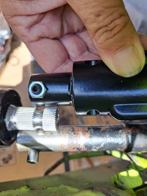

I think this is the best way to go. Peter Bergman makes the special adapter that goes to the Borgeson steering box and the stock mopar steering shaft. No cutting or welding. Total bolt in and doesn't mess up the factory collapsing column.

Yes, wasted over $100 on it....I told him it didn't work and he told me to hammer the shaft in...... Am I missing something here?????? I wish it would work.

So you bought the adapter from Peter Bergman and it didn't fit the Borgeson splines? I just got the complete setup I supplied the link to above and everything fit perfectly. I suppose with tolerances, some could be tighter than others.

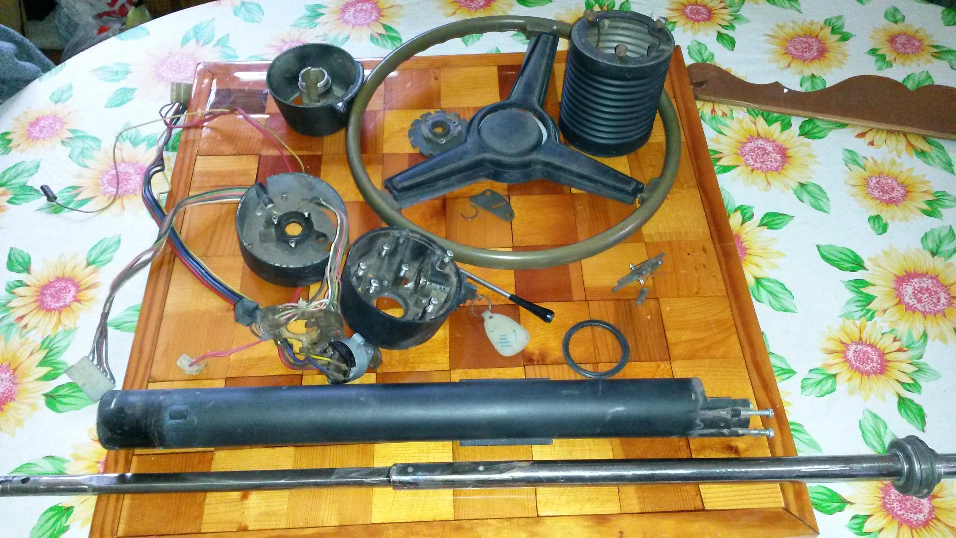

Pins were to keep the lower shaft from falling out during assembly at factory.
Once assembled the shaft has no where to go but up, if the car was hit hard enough to push the front end in.
Think of a straw slipped inside another straw, it can't be pulled out, only pushed further together.

Here is the column broke down. The manual and power steering splines are of different sizes. Not that matters here just want to mention it. Whit federal mandates seat belt, head rest, collapsible column and others were implemented .

Thanks to all for the help. The pictures of the shaft were what really made it clear and help me see how knocking the shaft in would not cause a problem.
