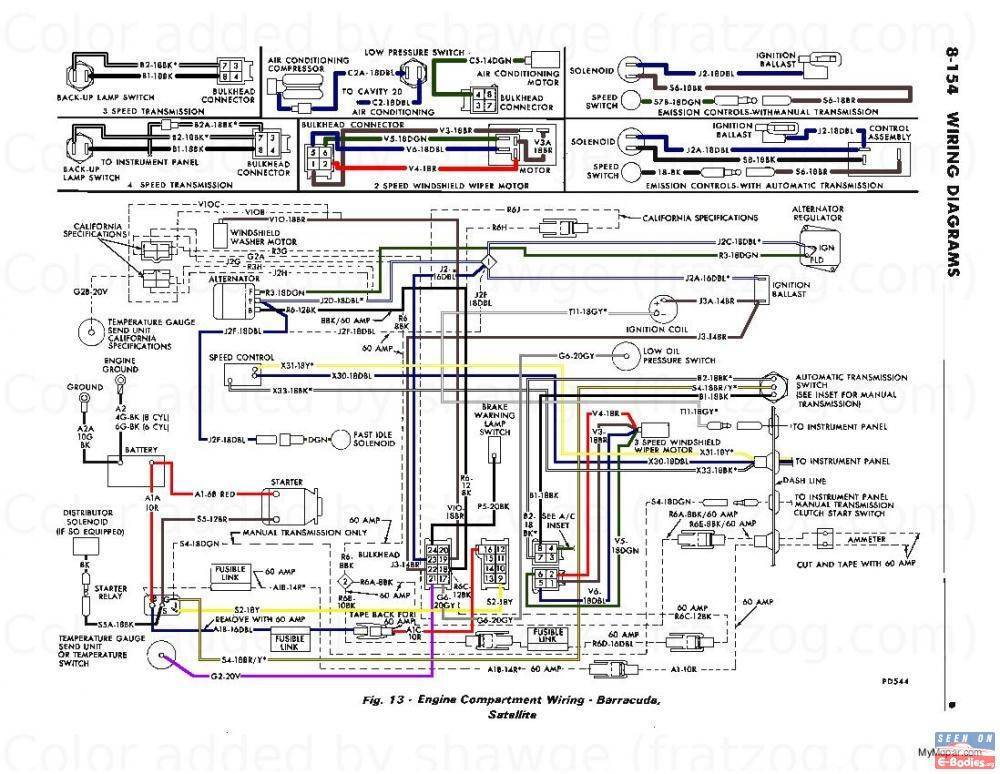

Unclip the fuse box and look at the back see if there are wires crossed and shorted.
1:RED wire 16 Battery power yellow dot to splice one feeds fuse block, 2:charge wire 18 black wire blue dots to splice one through amp meter to red wire blue dot 16 to battery, 3:ACC feed from splice 1 Red wire Q3_12R yellow dot to steering column. Black wire 12BK red dot to ACC side of fuse box.
