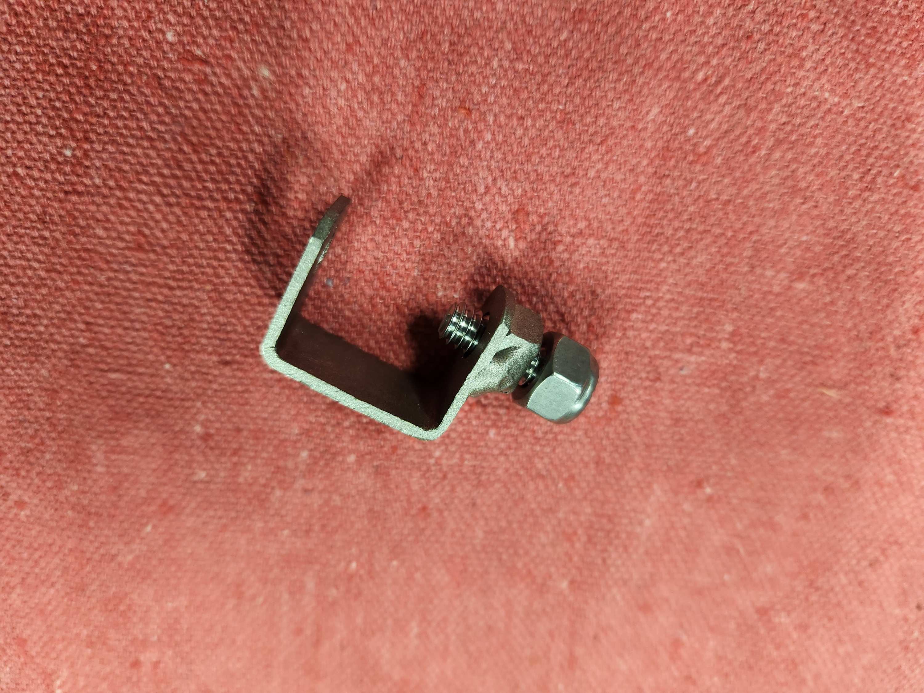

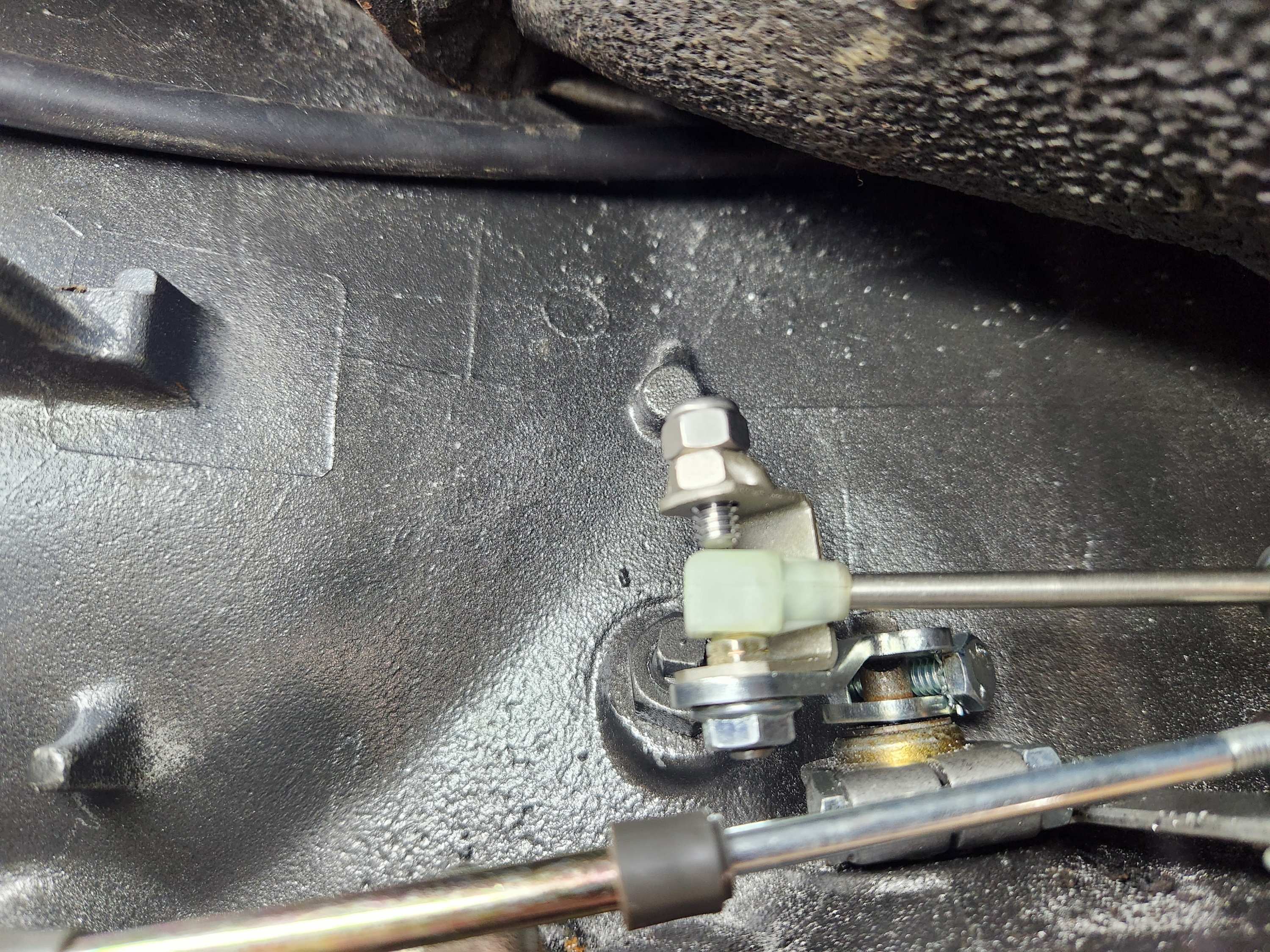

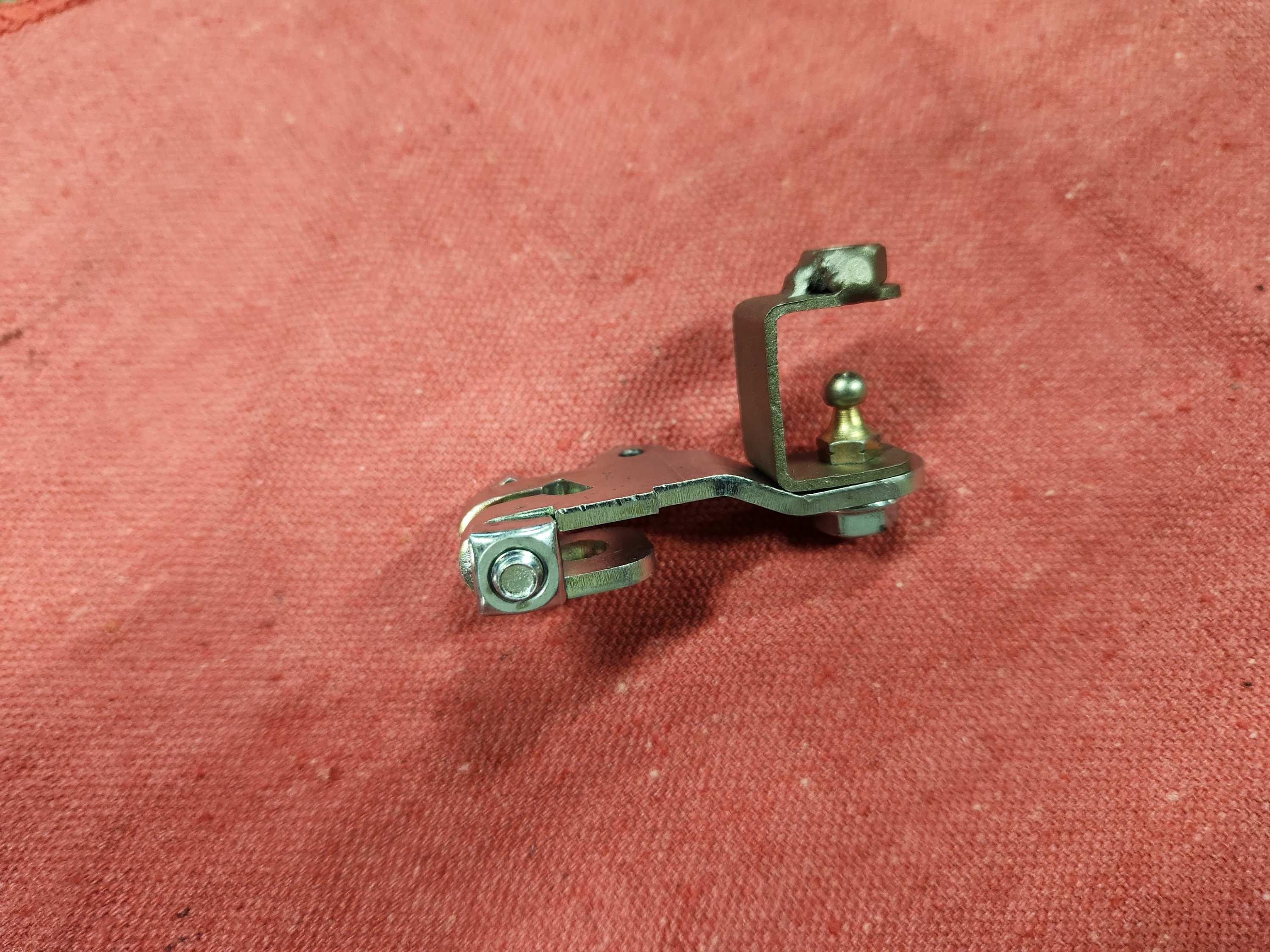

As I was adjusting and fitting the components, I was concerned with the plastic cable end popping of the ball stud a few times as I moved things around. Once the TTI headers go on, there is virtually no way to get to the cable end if it were to pop off at some point.
I came up with a fairly simple "insurance policy" to prevent the plastic cable end from popping off. I thought some members who will or have installed this kit would be interested in my simple solution.
I took some measurements and checked the material inventory and came up with a piece of one inch thin-wall square tube that was perfect. After cutting one side of the square tube off and drilling a couple holes, I tack welded a nut on the top for the set screw. The set screw is adjusted so there is about a 1/16 inch gap between plastic cable end and the set screw. Check out the pictures below. They are pretty self explanatory.

AFTERTHOUGTH: If I were to make this again, I would have used a 1/4-20 nutsert instead of tacking a nut to it. That would look more professional.

Agreed the rivnut would be easier to fab and not have to weld.
