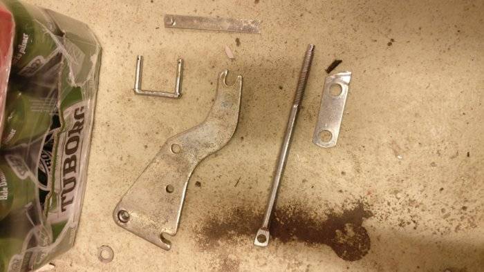

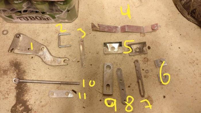

Hey guys.
Its now 3 years since I disassembled my challenger and there are a few things I need help to locate. See pictures attached.
I believe number 1 is for power steering and 10 for battery holder?
Br Cato

4 is the rear radio support bracket
10 is the hold down bolt for the spare wheel in the trunk.

6 go on the 2 transmission mounting bolts into the alloy housing
I think 5 goes in the trunk hold down bolts

#1 does not look like any part of a power steering bracket..
#5 are rear bumperette brackets, there are two more that go with them.
Classic Industries sells them under MM1790 if you want to see them.

To consolidate and include other responses.
1. Power steering pump
2. Transmission kick down linkage. Attaches to 7
which attaches to carb.
3. Possibly the strap that holds heater box to the
cowl. Looks broken.
4. Rear radio strap.
5. Rear bumperette mounts.
6. Transmission mounting washers.
7. Transmission kick down linkage at the carb.
8. Aftermarket bracket.
9. 4 speed linkage.
10. Spare tire hold down.
11. Maybe an aftermarket part.
