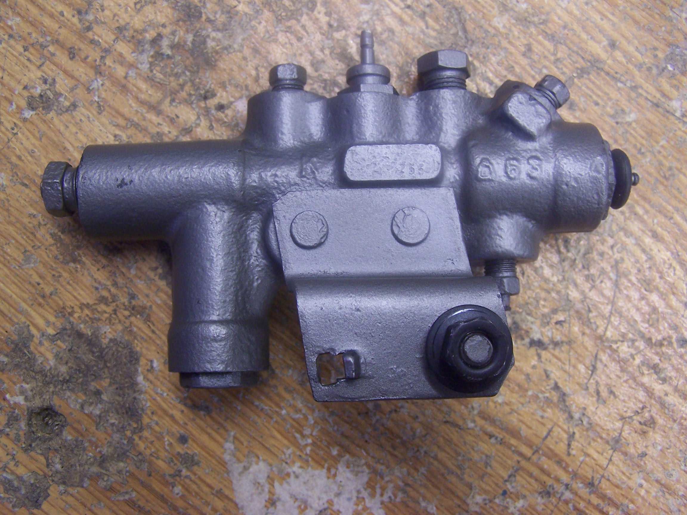

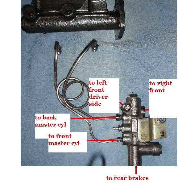

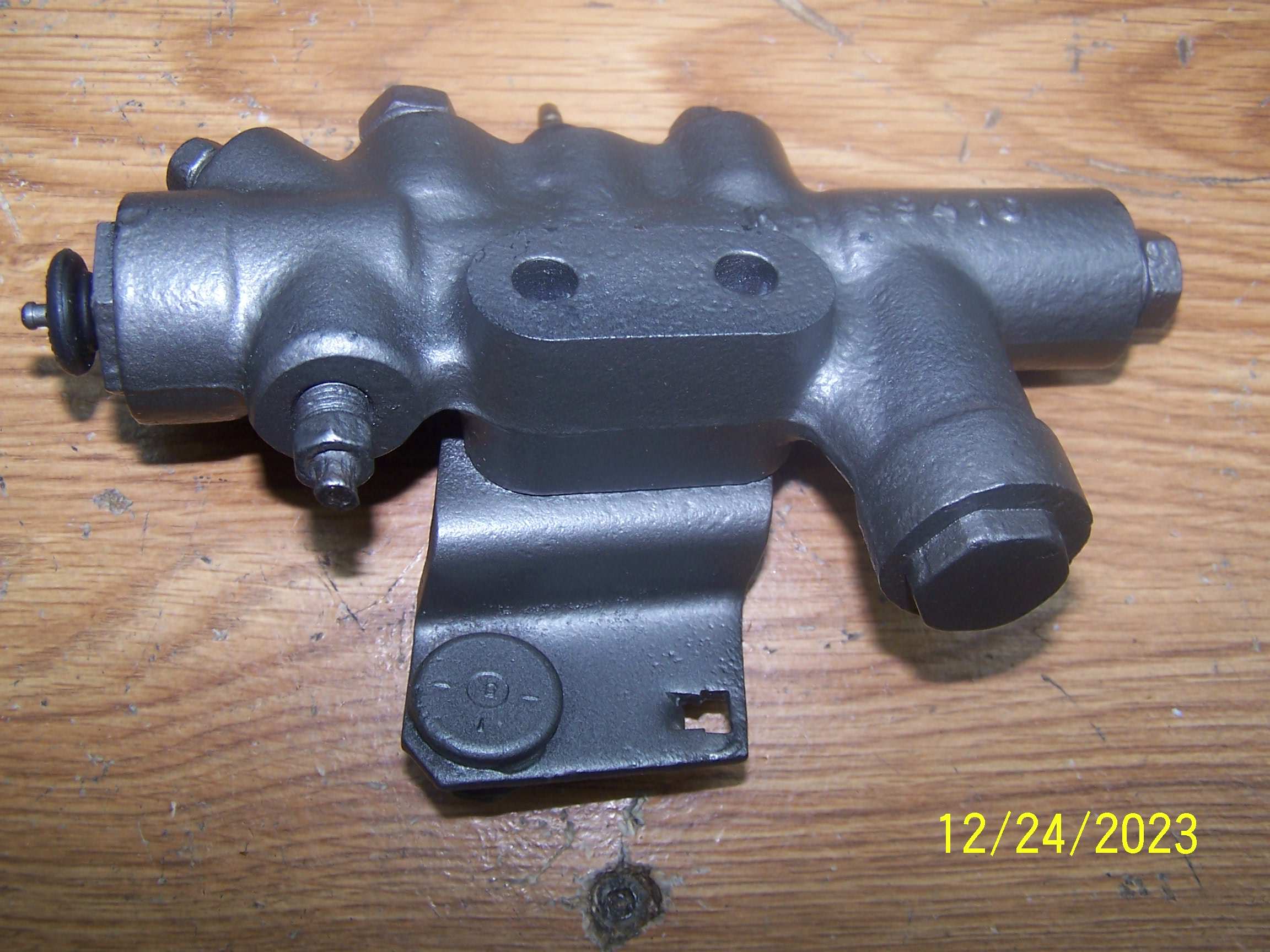

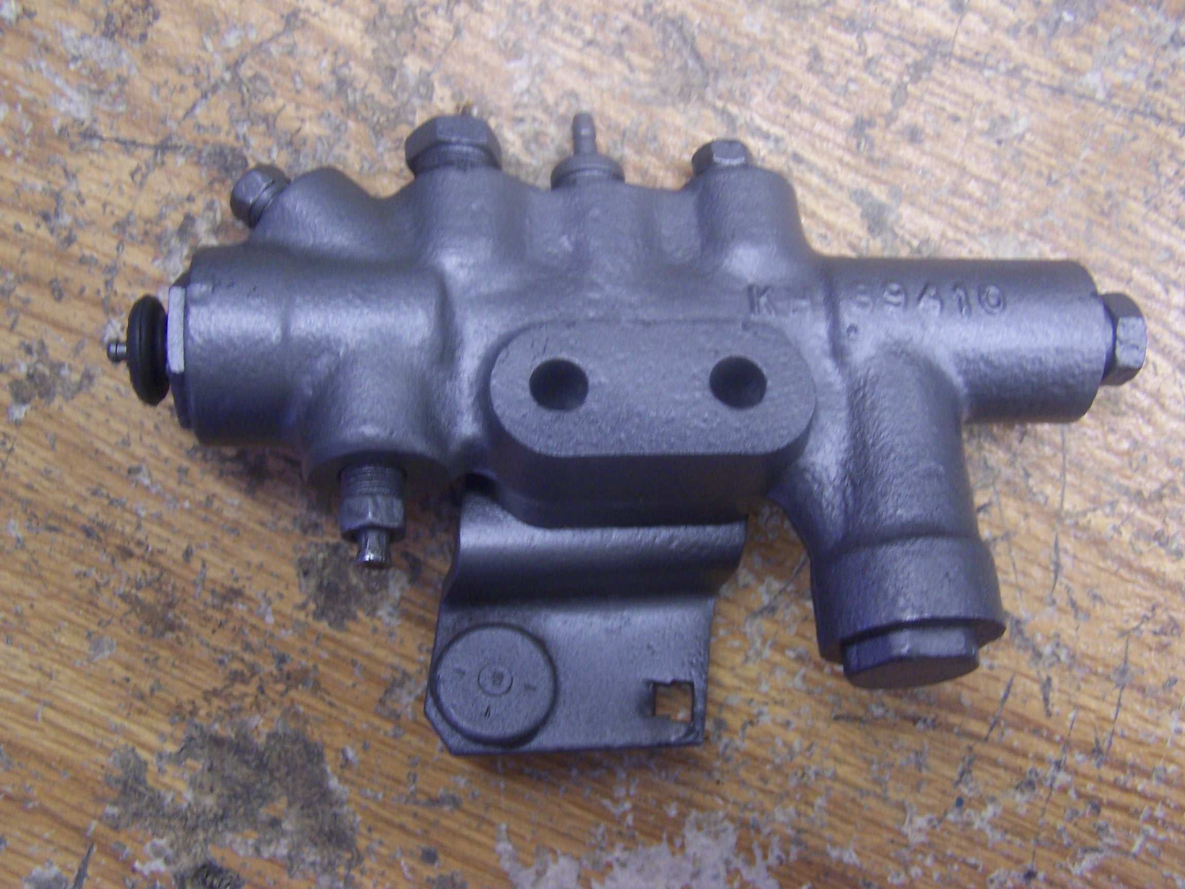

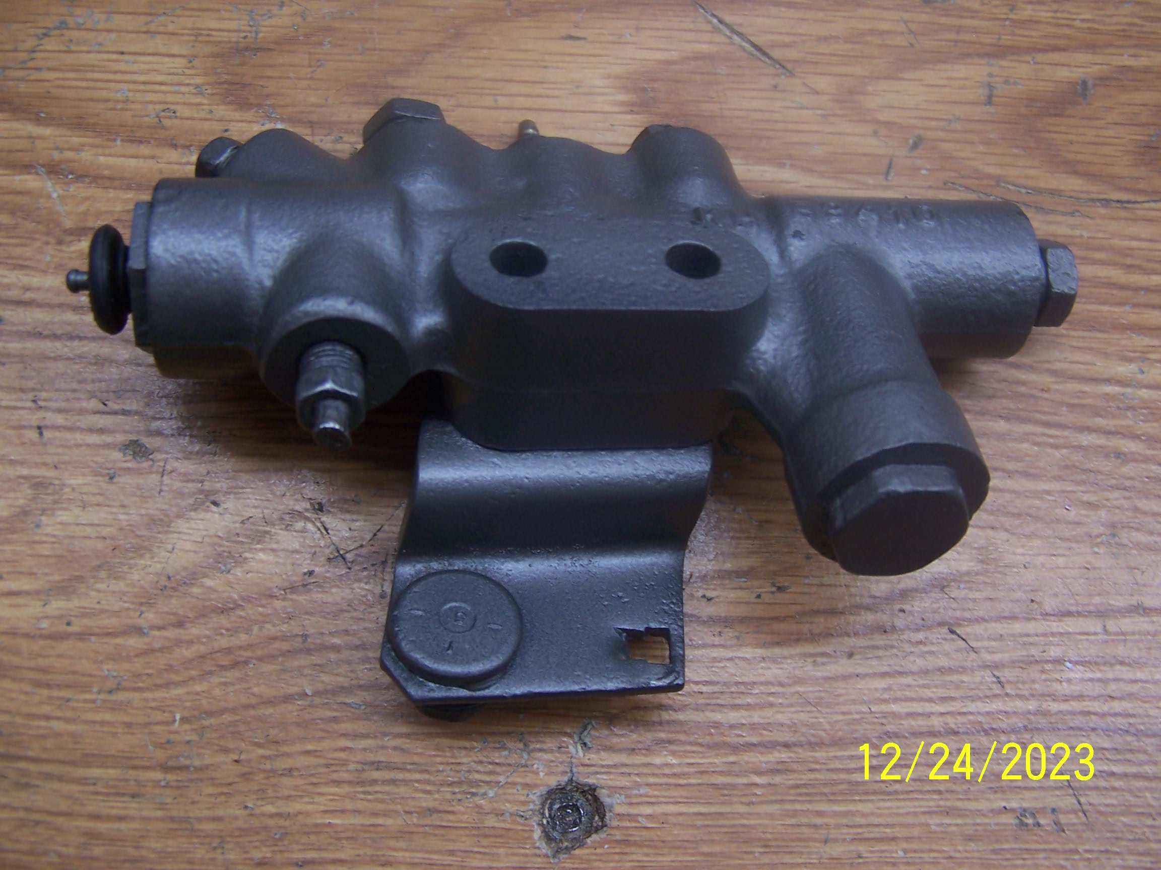

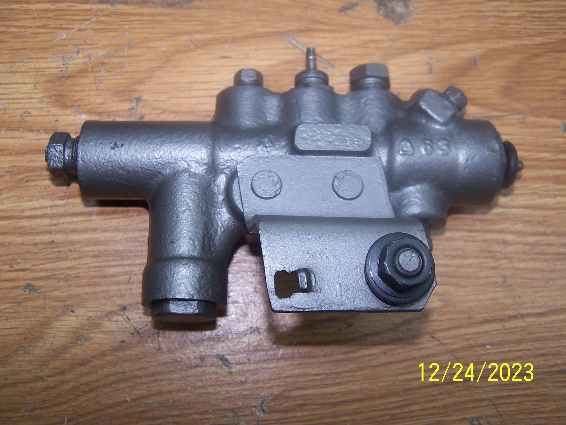

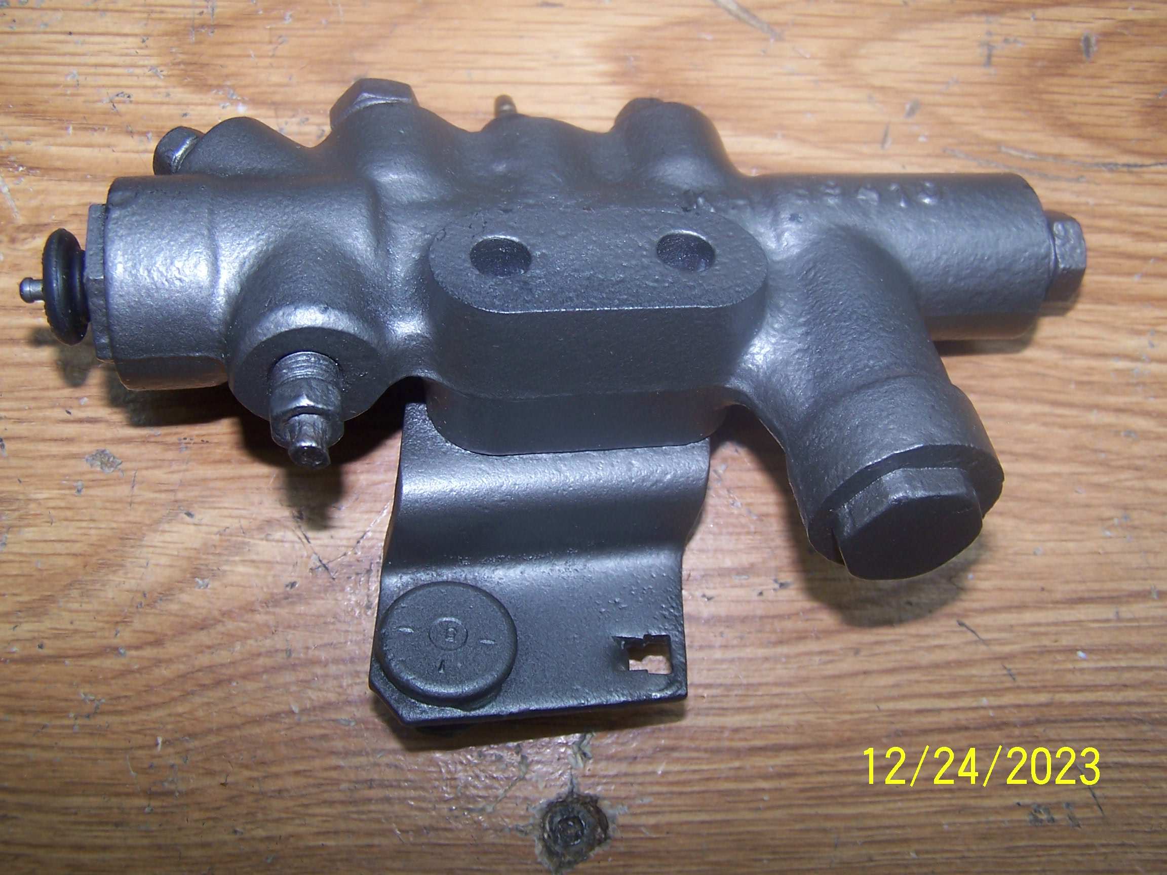

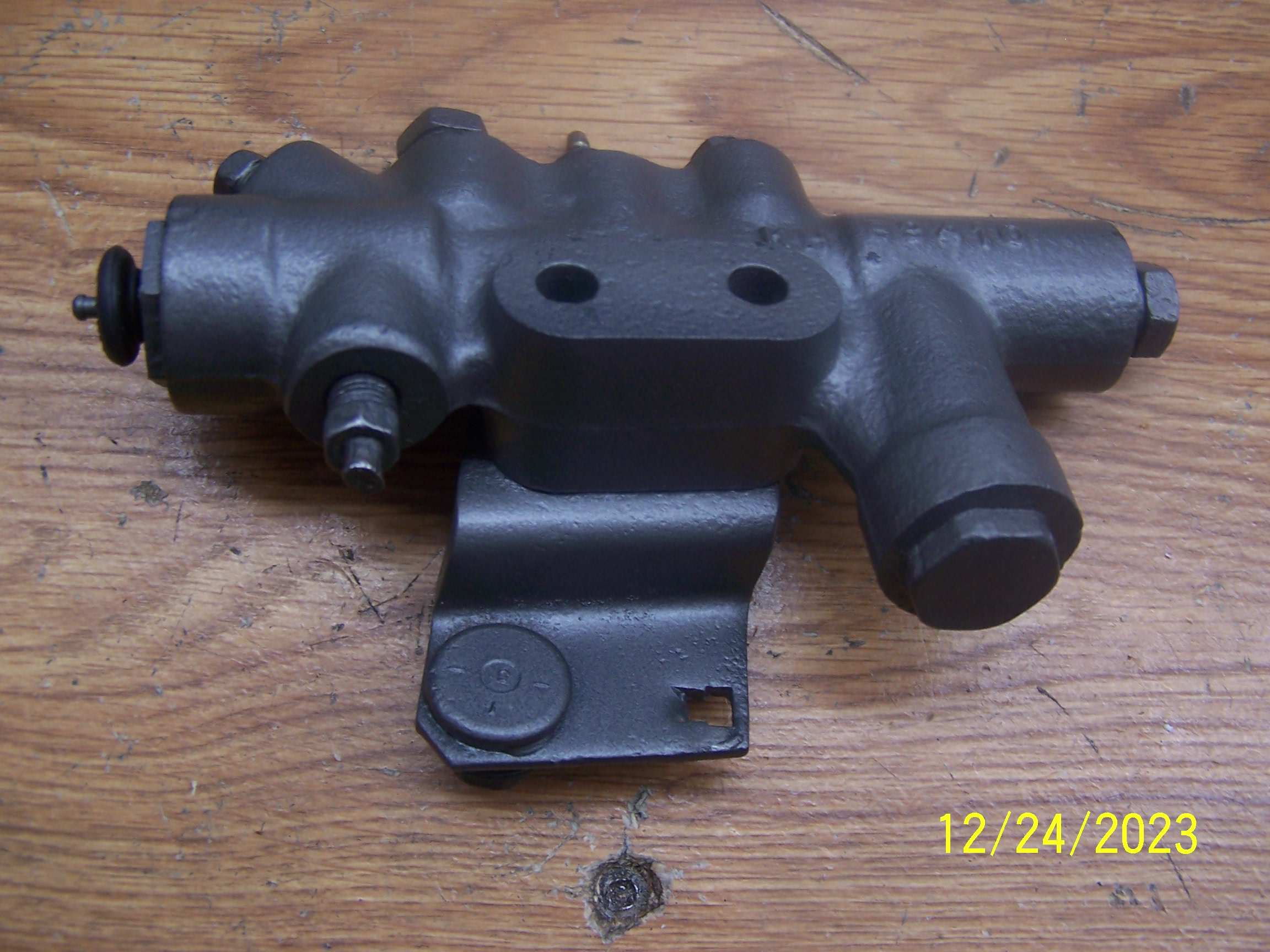

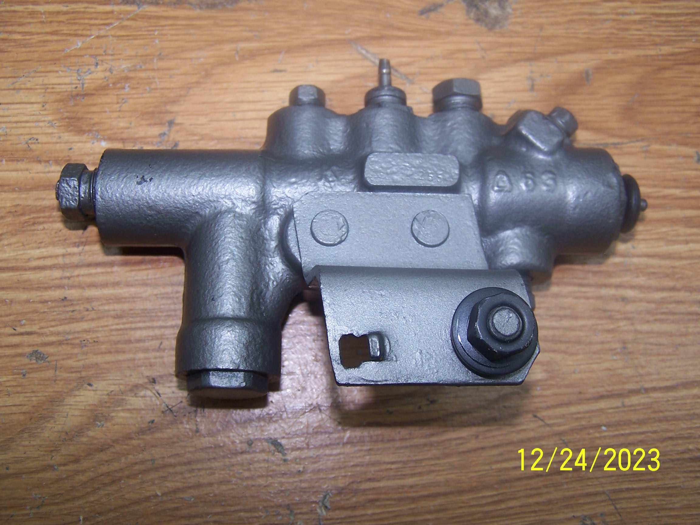

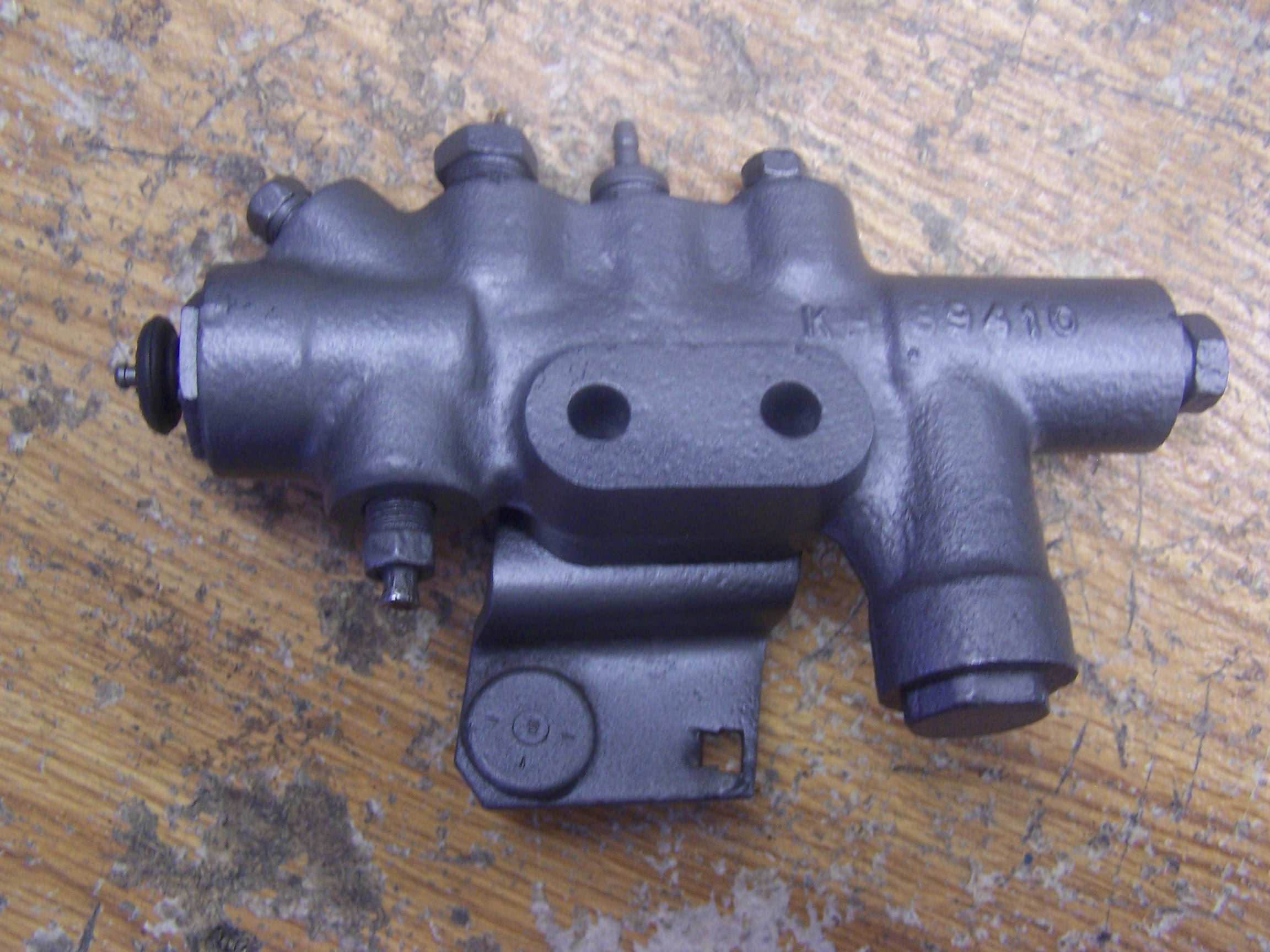

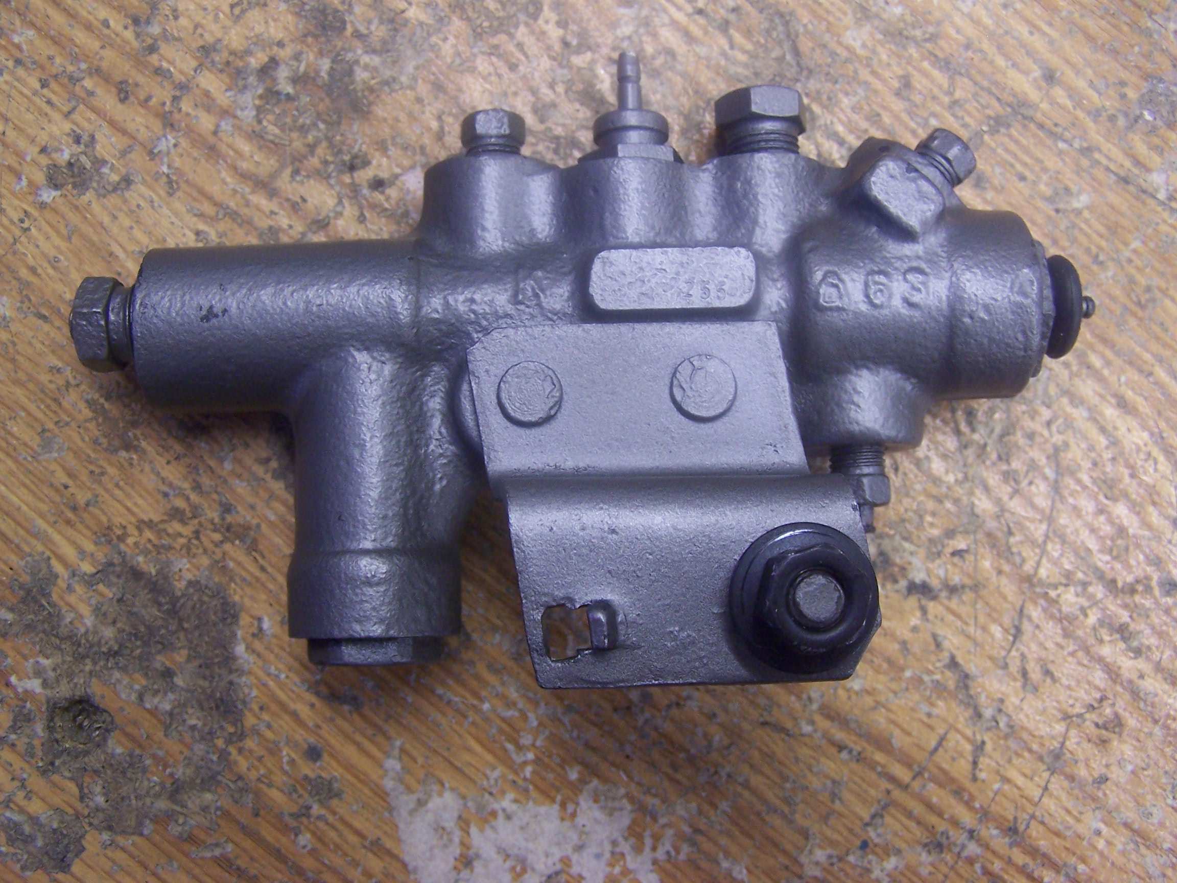

The cast iron proportioning valve uses a different switch. I have a cast iron valve from a 7 Challenger that had the front discs. I have not tested it but it was working when I parted the car out about 10 years ago. Here are some pics of it.
