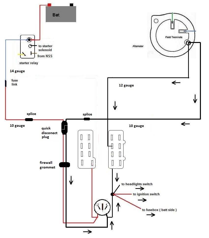

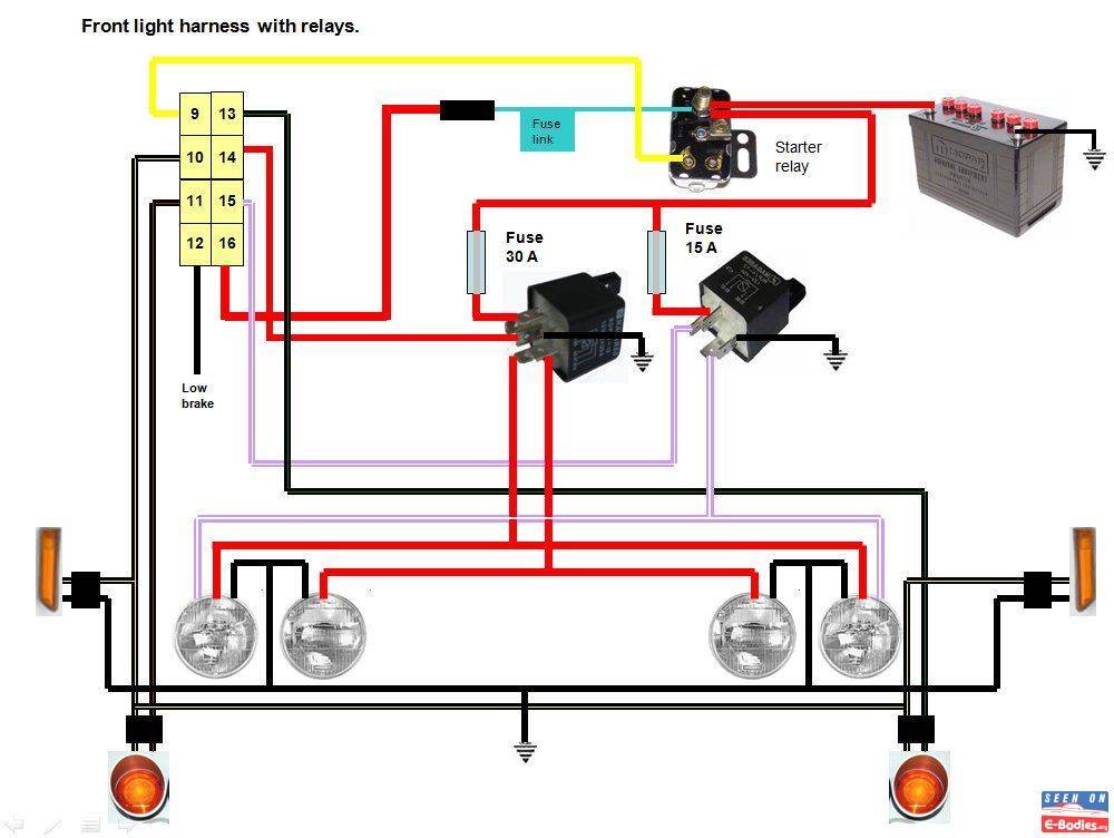

Follow the dots.understand how it's wired first. Blue charge circuit,yellow battery supply,red ACC circuit. Headlight sw is feed from splice one under dash.
One word explains the wiring and connections. Inadequate! Read Description and follow the dots. The wiring is not heavy enough and the connection were not designed to carry that much amperage 1:RED wire 16 Battery power yellow dot to splice one feeds fuse block, 2:charge wire 18 black wire blue dots to splice one through amp meter to red wire blue dot 16 to battery, 3:ACC feed from splice 1 Red wire Q3_12R yellow dot to steering column. Black wire 12BK red dot to ACC side of fuse box.ch load. The round back alt has an output of 37 to 45 amps max and the wiring is designed for that.

FWIW I like using the ammeter and used Chrysler’s fleet bypass. I ran a 10 ga wire from alternator through the clutch plug (auto trans) to the ammeter, then a 10 ga wire from ammeter back through the clutch plug to the starter relay with a flusible link bypassing the bulkhead connector. Also use headlight relays powered at the Bat terminal on the alternator.

Not sure if I'm jumping but I tried this when upgraded to a 100A alt. since the battery feed side of the bulkhead was starting to burn. Theory was that more amps would charge faster lessening heat issues with a slow charge. The opposite has happened. Takes longer to charge and when I turn the headlights on the thing starts charging like crazy and that's with the headlight bypass relays...???
I'm ready to undo it and run straight to the starter relay but would like to keep the ammeter
functioning...

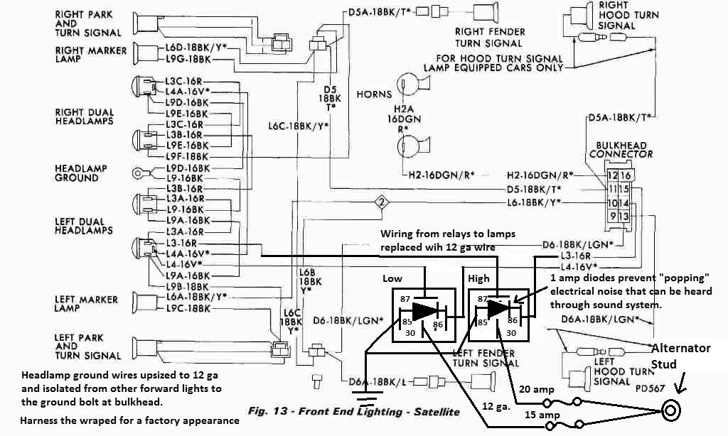

A higher capacity alternator is not going “charge faster”, the battery charge rate is determined by the current battery state of charge. If the alternator can’t keep up with the vehicle loads and whatever the battery wants, then the charge rate will be reduced. The battery charging rate is not what causes heat, current and resistance causes heat. Bypassing the bulkhead, as somewhat correctly diagramed, removes the resistance of the Packard terminals in the bulkhead, the weakest link in this charging system by far, has been since these cars were new. The primary benefit from running a higher capacity alternator is more available current at idle over stock rated alternators.
Headlight relay modification? Ammeter shows additional charging with the lights on? Sounds like you have the power to the relay secondaries connected directly to the battery/starter relay (as incorrectly diagramed above for a vehicle running an ammeter). This will cause a false charging indication on the ammeter as the headlamp current is drawn through the ammeter from the alternator while in operation. The battery charge rate is not changing. Connect the relay power to the alternator stud or another location on the “alternator side of the ammeter” as are all other factory loads.
Again, "if you want to retain the correct functionality of the ammeter, only the battery should be on the battery side of the ammeter, all loads and the alternator should be on the alternator side of the ammeter. The ammeter is designed to monitor the battery charge/discharge rate only. On a heathy system, should be little to no current flow registered while in operation, centered. Any loads placed on the battery side will register as false charging current."

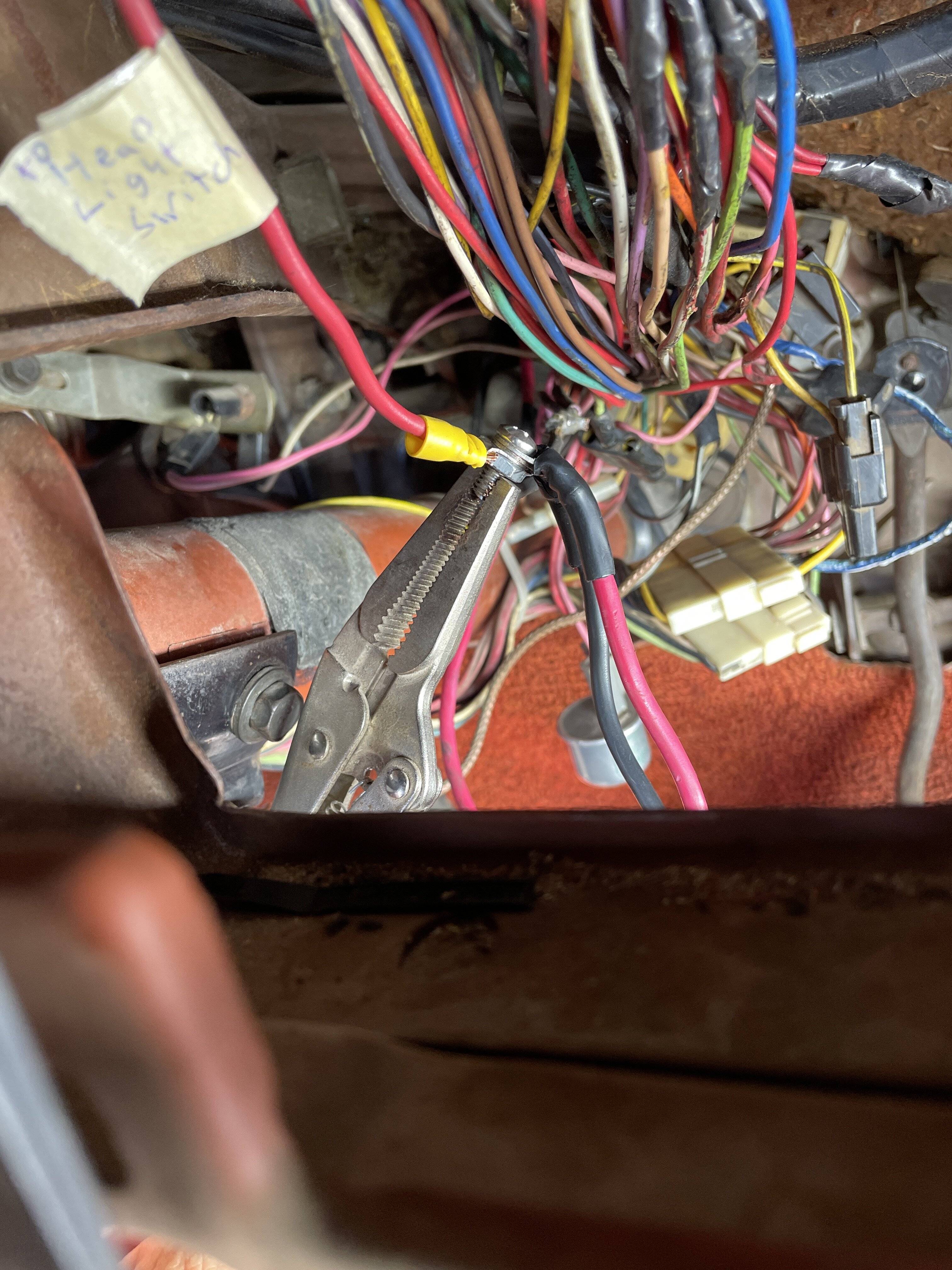

I see bare wires, poor/dangerous electrical connections and workmanship that needs refinement. It appears no one is an electronics technician or engineer. I see a car fire coming soon at this point
The alternator bypass 12 or 10 gauge wire should have heat soldered wrapped terminals and connections for the fusible link at the stater relay end. Using the bypass cuts the current flow thru the ammeter in 1/2. The ammeter is an indicator gauge as it does not show the current in amps so it is still reading correctly. Do not use quick disconnect connectors unless it is designed to carry a current load. Terminal strips come in many forms as do power posts
The large black and red wires that feed thru the bulkhead connector need to be removed from both side of the bulkhead and hard wired together properly thru the firewall.

The pictured vise-grip clamped to the ammeter leads screw & nut, appearing to touch the steering column support bolt head startled me a bit, assuming the battery was/is not connected.
