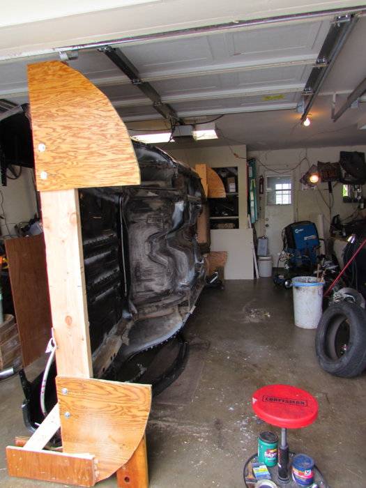

Other than jack stands, I had no support structure underneath. My frame rails and rockers were rock solid. Honestly, I threw a level on the floor and it was level. I did take measurements prior to disassembly including the height from the floor to the rear crossmember just to verify it went back together the same as it came apart. I also took measurements of the trunk opening and the distance from the roof to the tail panel. Here is a picture of my redneck rotisserie. Rod

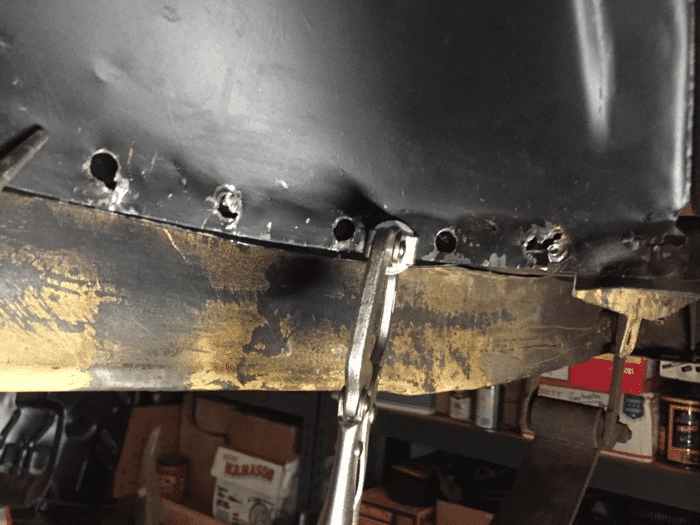

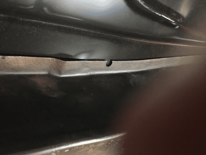

Here is a pic of the first trial fit of the trunk floor when it was still up on stands, showing the fit against the frame rail and a 2nd pic where the new floor matched up against the wheel well;
Thanks. Think I might need to do a bit of reinforcing. My rear frame rails are thin and were gone under the sway bar mounts. I patched them but I plan on pushing this thing well above 120mph on road courses and the thin frame rails don't give me a warm and fuzzy. I think I'm going to do the Dynacorn one piece for the trunk, frame, and seat pan. It needs the pan and the rest won't hurt. That's going to be a big hole so I think I'm going to have to box it first and maybe build a sub-frame underneath. I think the trunk, hood and passenger door are the only sheet metal I won't be replacing on this poor thing. Rotisserie may be in the future once I get it stiff enough. I'm not afraid to go redneck.
