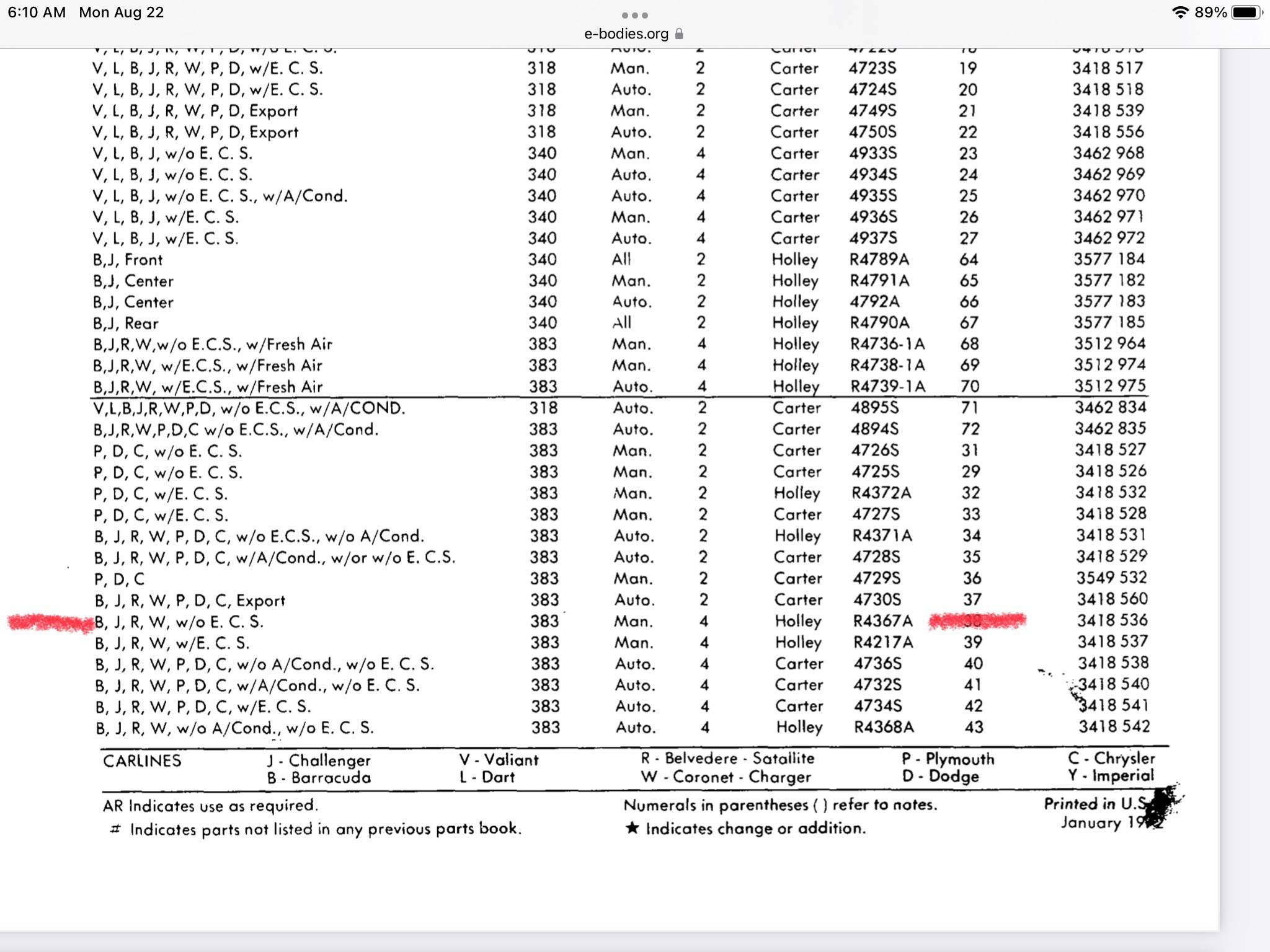

It appears it could have come with a Holley 4367 A, Or a 4217a.
What it the most likely carb? Or do I even have the correct information?

Since its a California car, does it have the N95 evap emission control package? I suspect it does, and if so the 4217 seems to be the likely culprit.

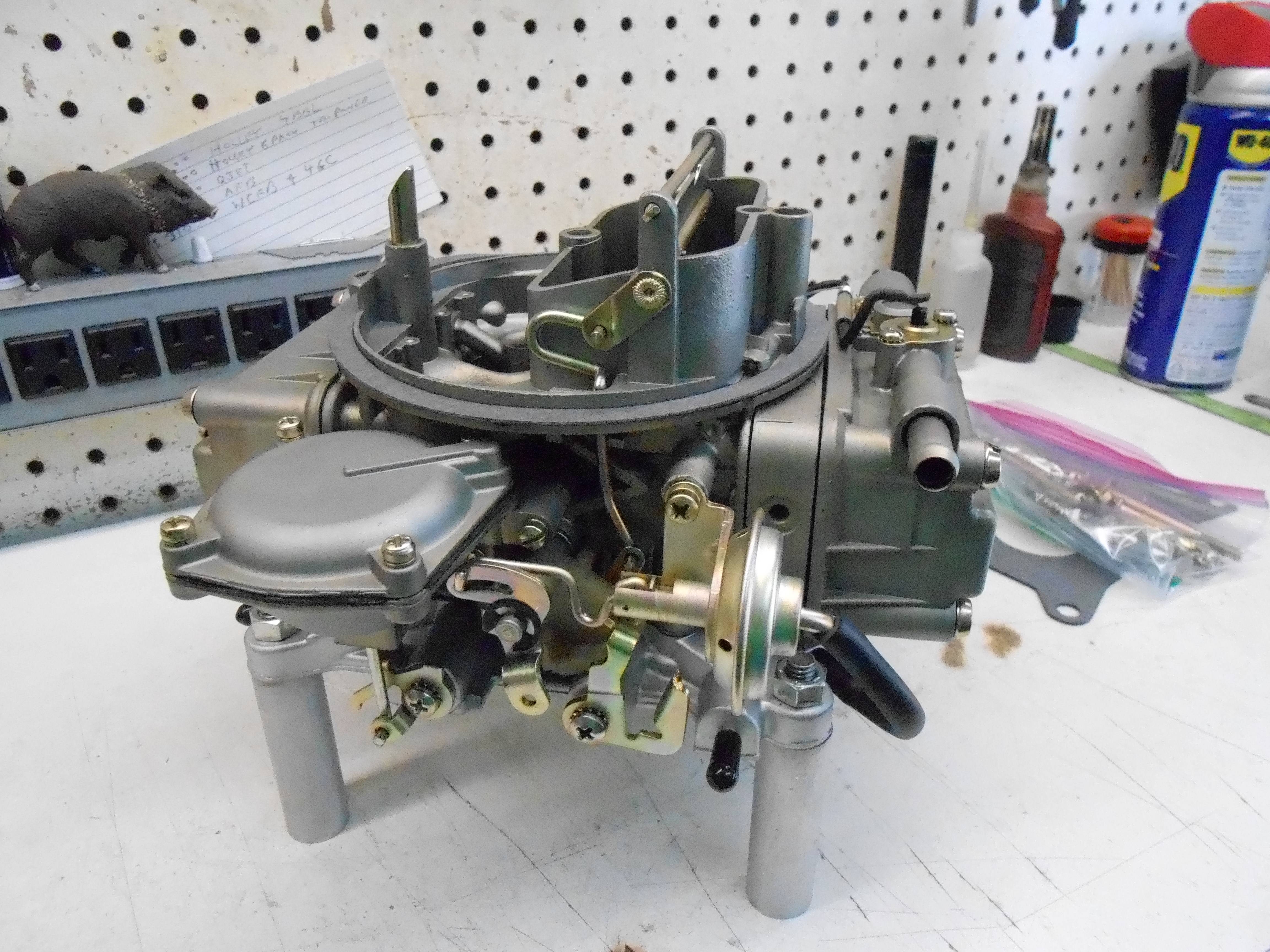

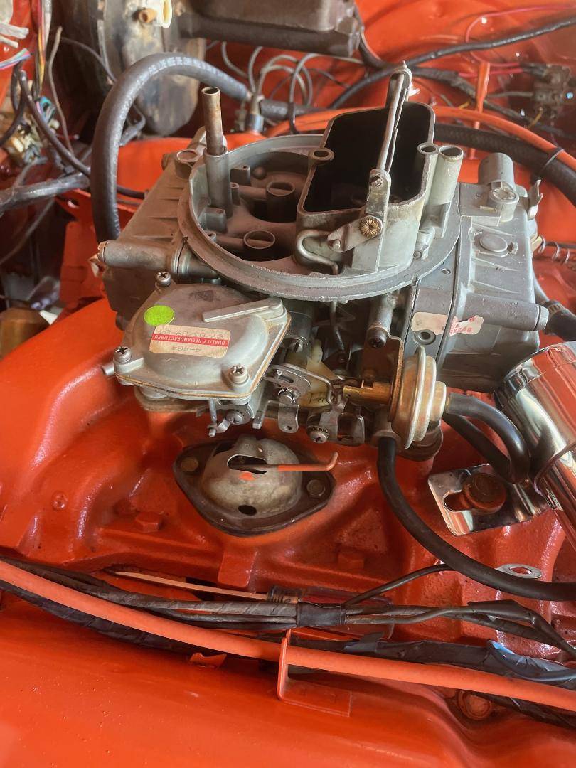

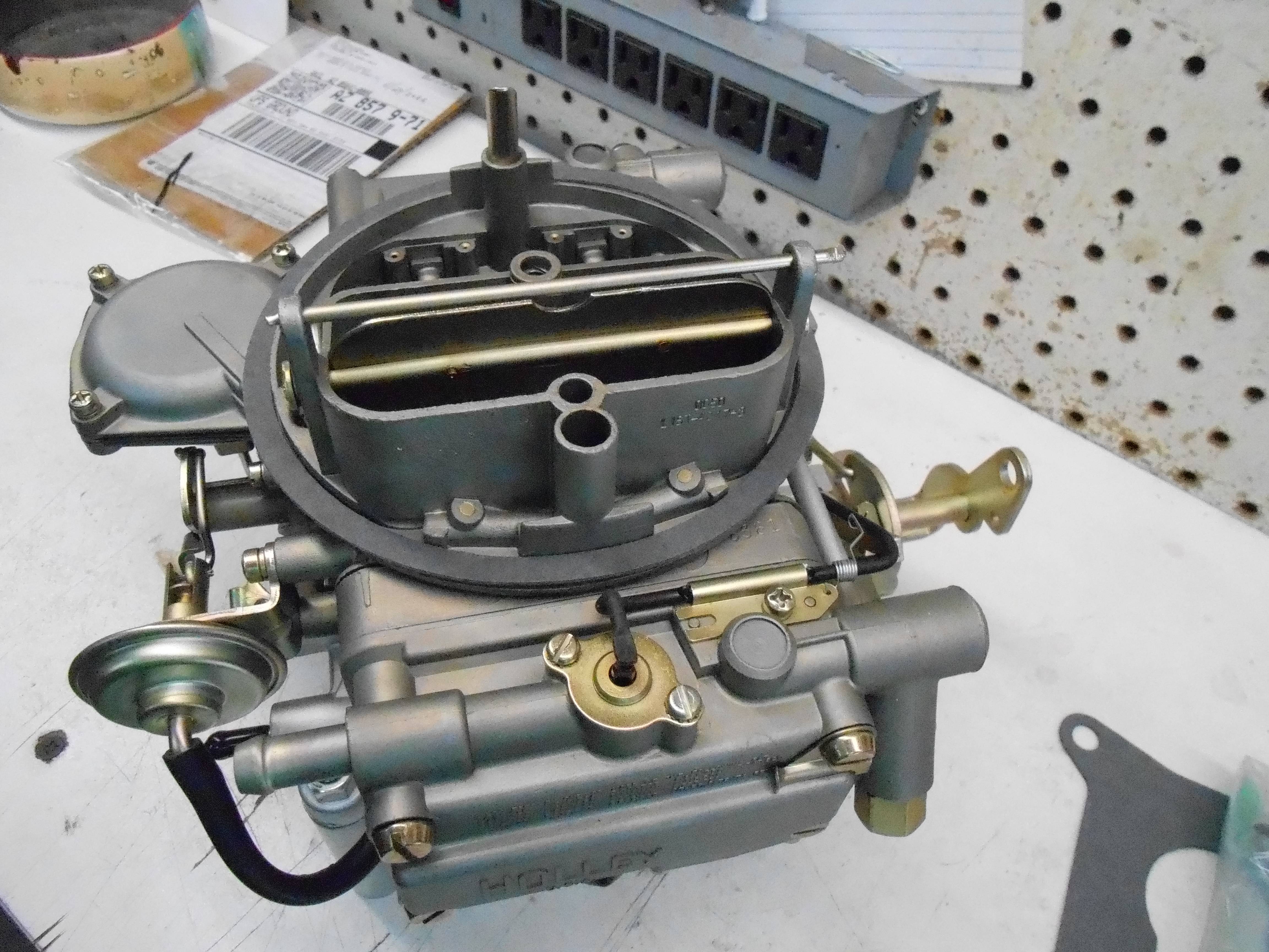

FYI, If it is a 4217 your looking for, attached is some reference photos. I just had mine restored for my car. 4217 is for California, 383, 4spd cars.

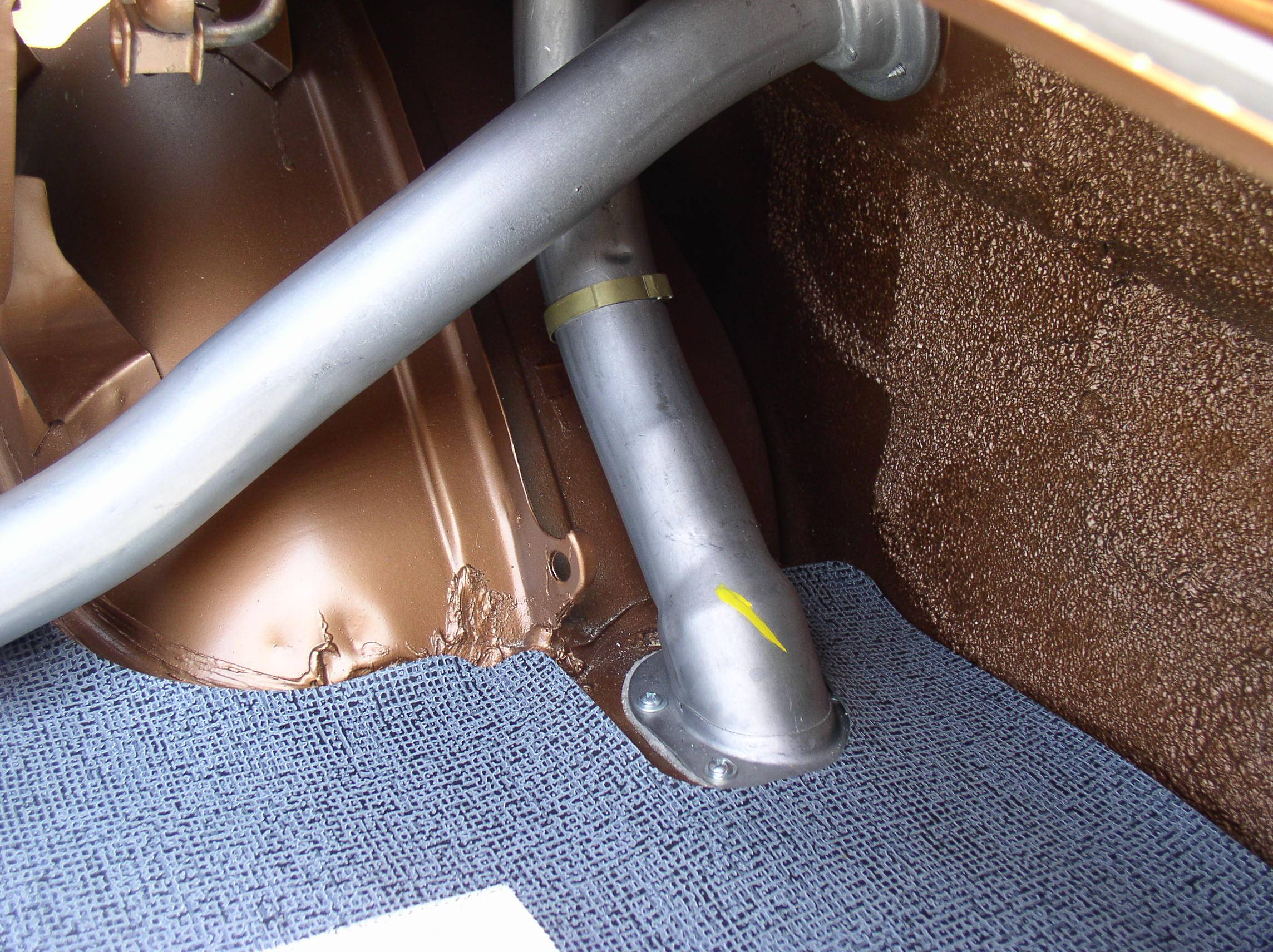

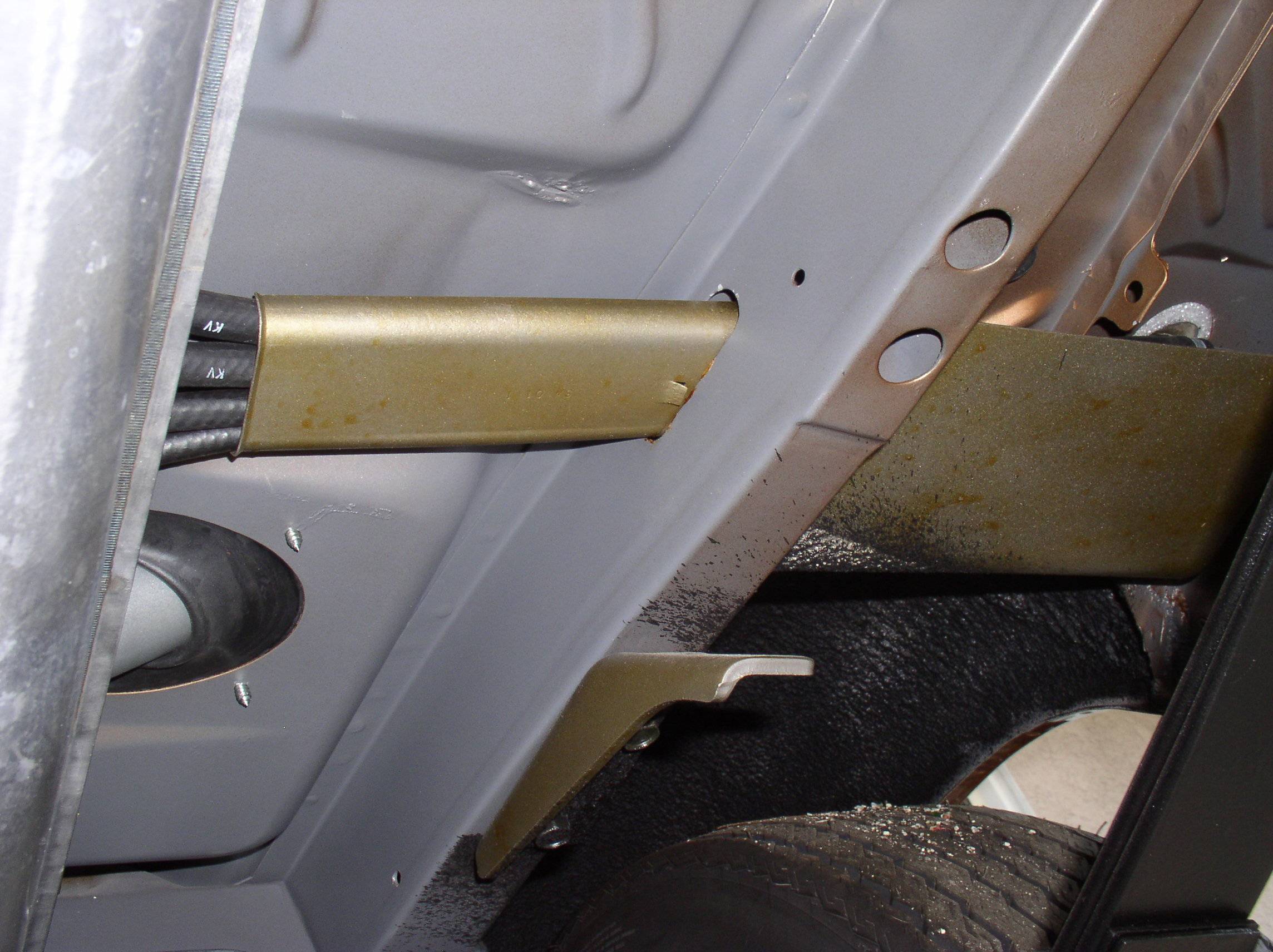

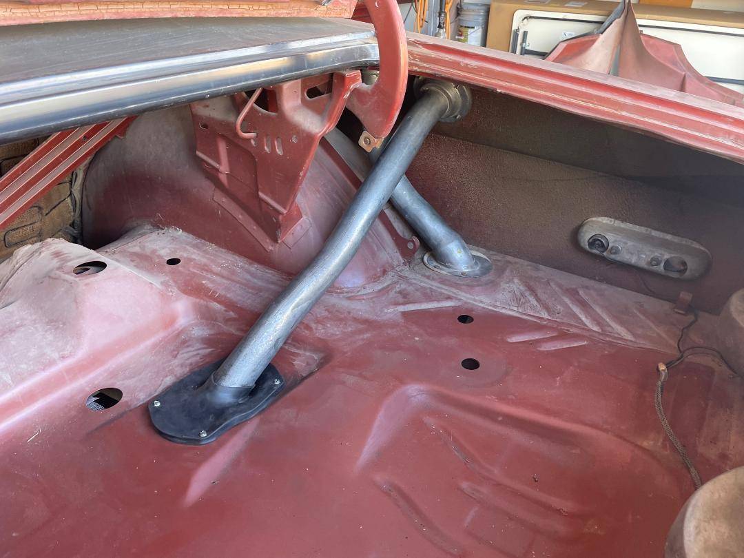

Check for an N95 code (Evaporation Control System) 1970 California emissions, like Mopar & Missiles suggested. That will tell you if you have the 5 tube Vapor- Liquid Separator. You will have either what’s in the first picture (with ECS) or the second picture (without ECS). Last picture is from underneath right rear wheel well with shields on covering hoses.

Okay, so you don’t have ECS, then you’ll need a Holley #R4367A.

Why don’t you post a picture of your fender tag. That will confirm what the correct carb. is. Also, there is no such thing as A/C delete. You either order the car with it, or you didn’t.
FYI, just because you car was built in the L.A. plant doesn’t mean it comes with N95 emissions. It is the destination of where the car was sent to that determines the N95 code. It would only be on your car IF the cars destination was somewhere in California.
Yes i have the first picture like a second filler tube with the 5 smaller tubes
wantonebadebody
Apr 29, 2009
124
36
So my car has ECS and i forgot to add sleeve over hoses Geez.

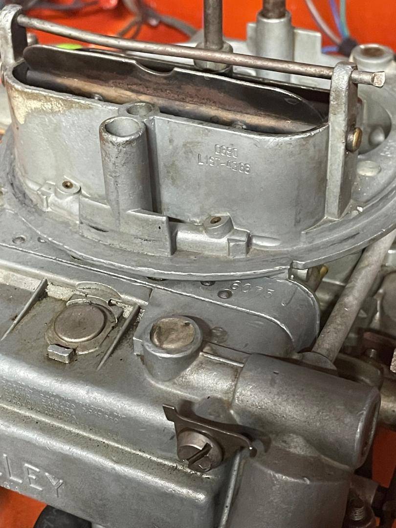

Also my carb looks like a 4217a but i think is a rebuitt exchange? list# 4366 for an Auto? i have a manual
