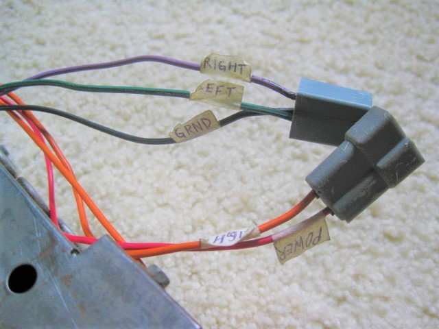

Good idea. I'll try that next. Still making headway. Just figured out after you insert the cassette you have to push down on the face on the cassette player to engage tape to play. Duh... I'm leaning towards the switchover box in the speaker harness has to be in place. The "box" changes the ohms or amps to allow sound to the speakers.
Anyone whoever hooked one of these up would be awesome to hear from.
Thanks
EW1BH27
Dec 31, 2021
731
420
Canada
The crossover box merges the left & right audio signal and feeds that to the center speaker. It doesn't "change" the signal. For test purposes you can eliminate the box and connect speakers directly to the units plug. If the radio plays fine (sound from all 3 speakers) it's not the box or harness. Here's a couple threads talking about that box.
