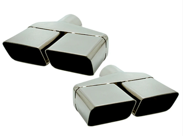

how far should a challenger exhaust tip be sticking out? The photo shows where they would be without cutting the tailpipe

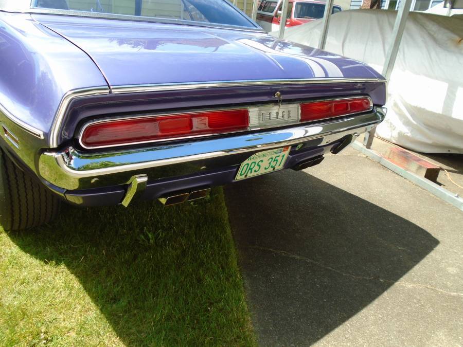

As far as I can tell there was not a factory spec, there was a big thread on this subject on another forum and the general consensus was that they should be 1 - 1.5" out. If they are flush the valance gets sooted up pretty quickly and if more than 1.5" out they look like crap.

I never had a brand new E body but I did have a few relatively new ones 5 -8 yrs old that still had the original exhaust and from what I "remember" the tips did stick out relatively far BUT IMO they look odd that far out which is why I said what I did. On my 70 Challenger RT I have them about 1.5" out, I had them closer for a little while and it would get really dirty very quickly.

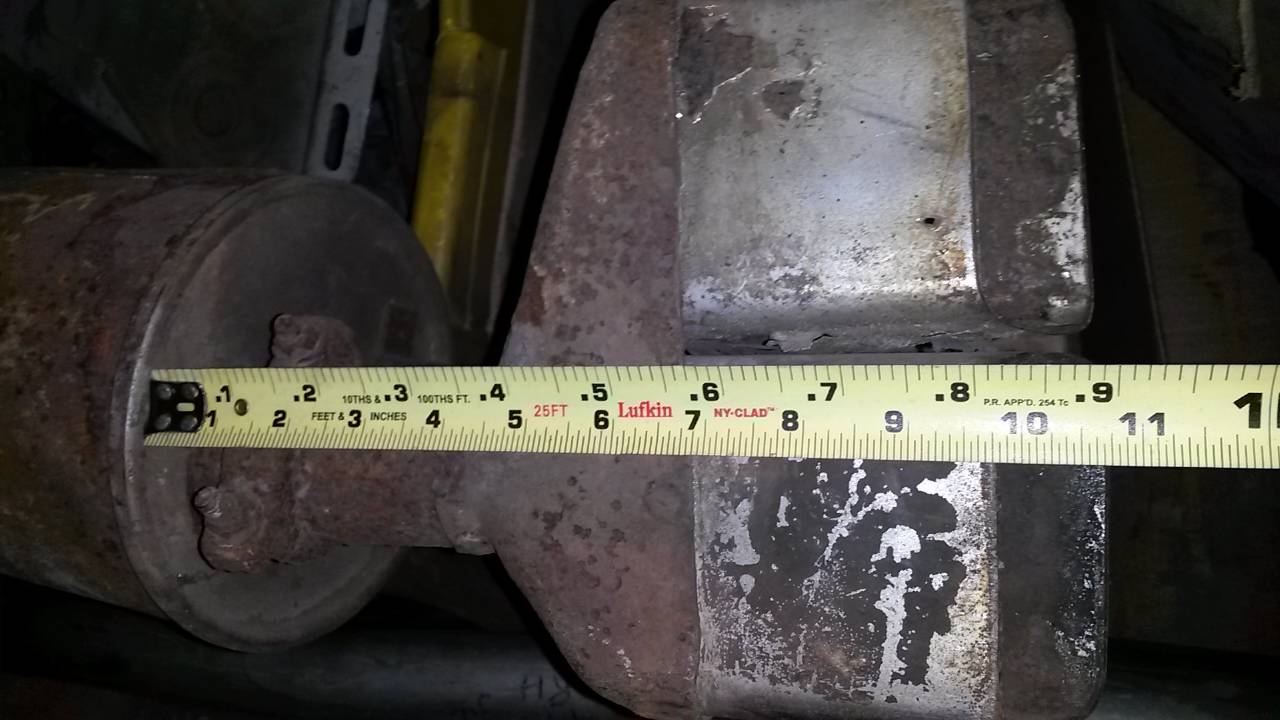

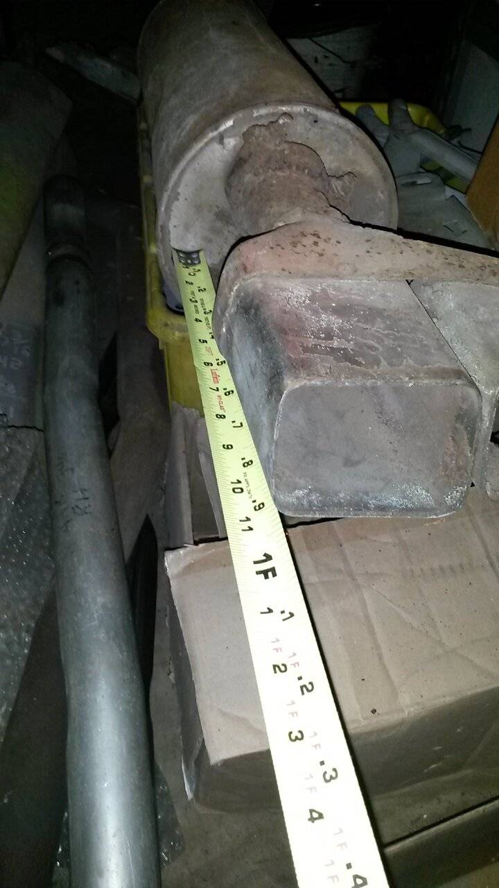

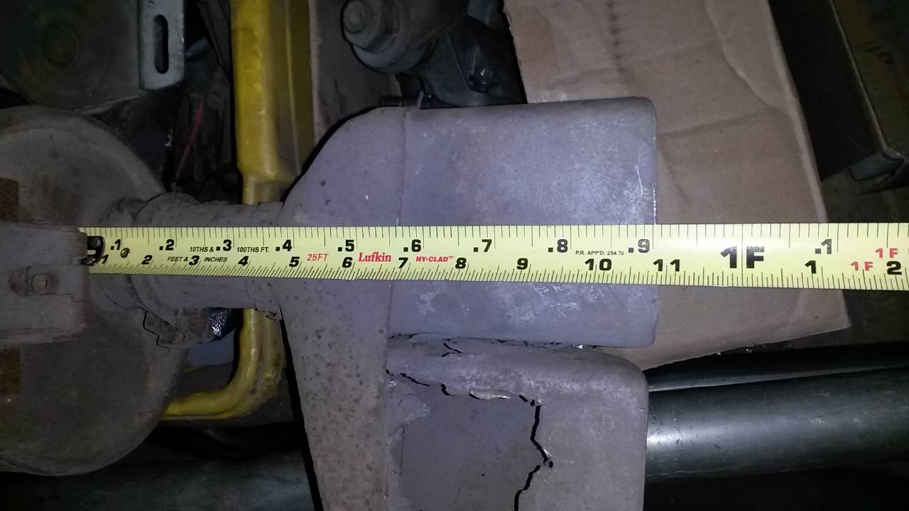

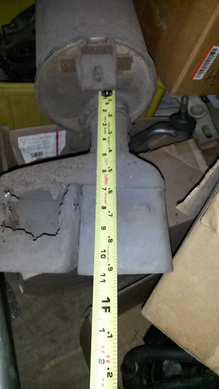

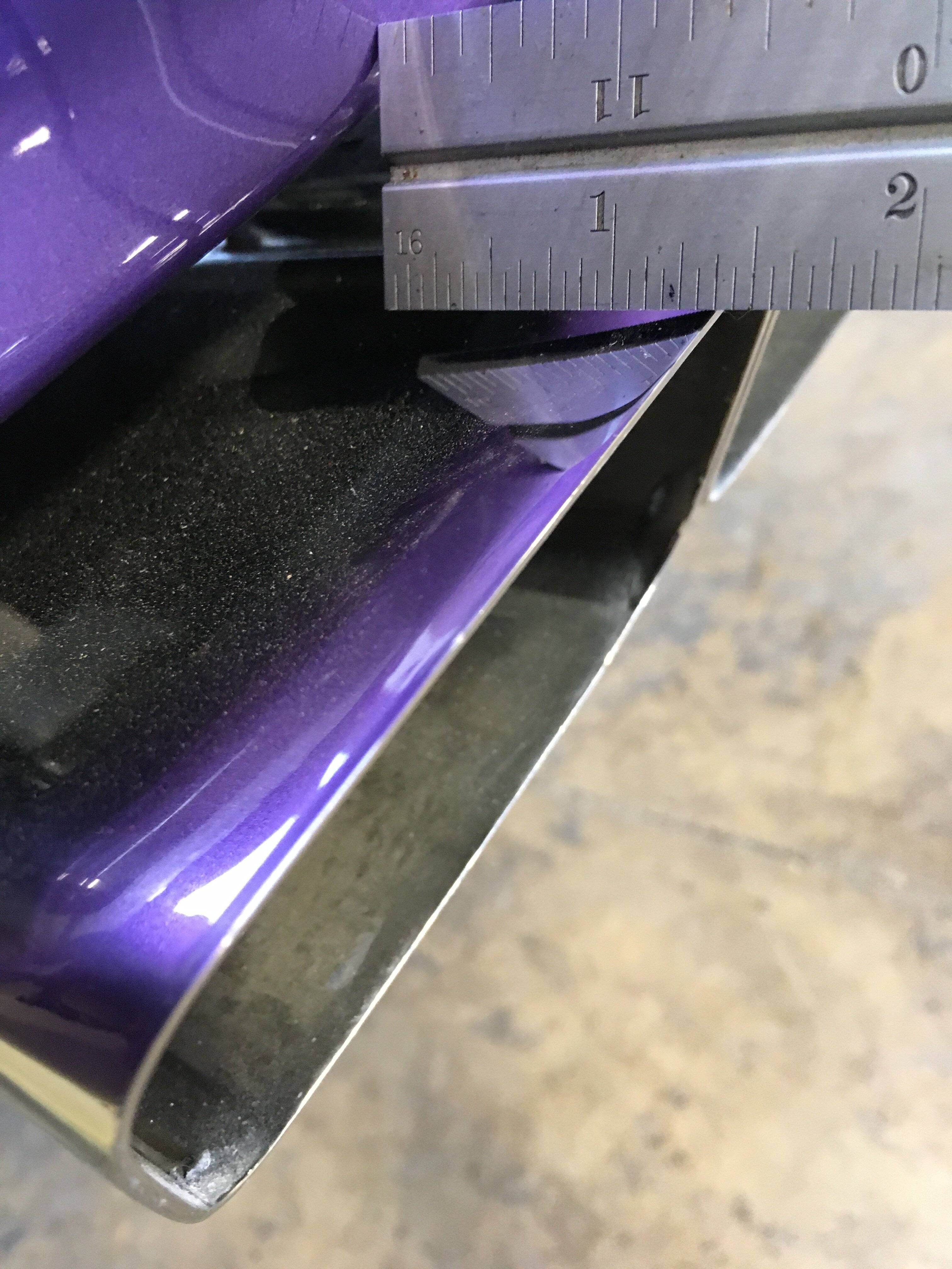

Here's a different approach.Got the car of original owner.3 years old I remember he said he had the mufflers and resonators burned out. The tips stuck about an inch not much more.
