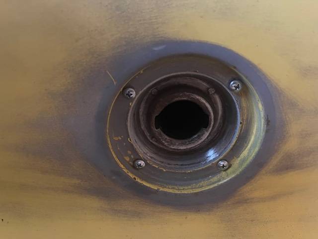

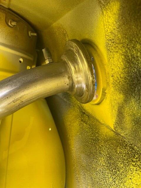

Pic of my newly installed gas filler tube showing the screws to attach the flip cap!

So basically, just take off the old cap, take out the screws, put on the trim ring and new assembly, and get a new gas cap?

That's it :thumbsup:
Just be careful with choosing a inside gas cap; has to be a correct unit to fit the filler tube slots and under the flip cap correctly!
