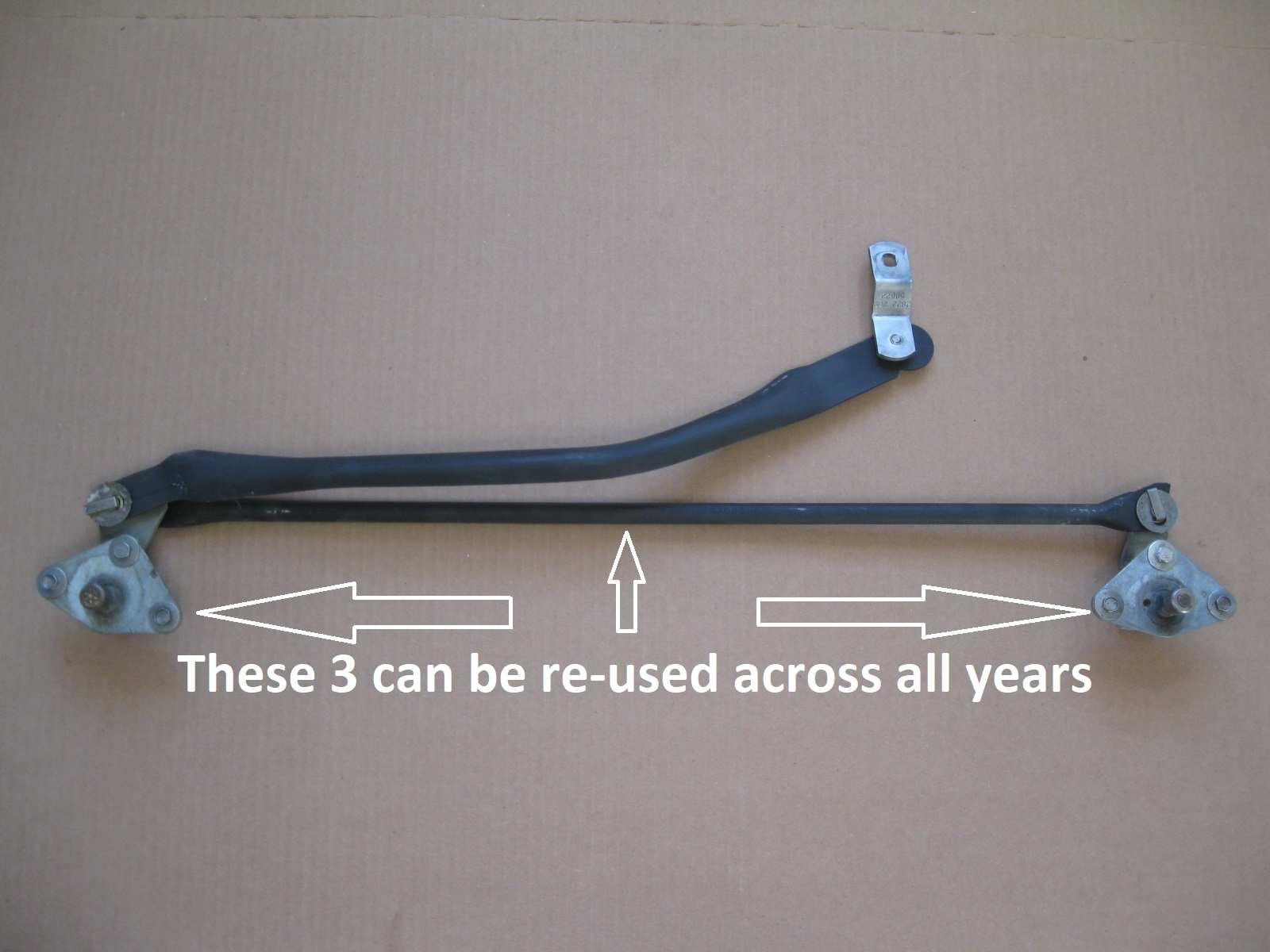

Is there a difference between years 70-74 for challengers wiper assemblies? I have a 70 Challenger which needs a variable speed motor but can I use the linkage under the cowl from a 72 challenger? Are they the same or is it a 70-71 and 72-74 like for the front fenders.

yes 70 is unique from other years , 2 speed & 3 speed are different from each other in all years .

For added info....

The 72 - 74 wiper motor crank arm is also different.
It is smaller were it bolts to the motor and the pin length for the linkage arm is also slightly longer than 70-71.
