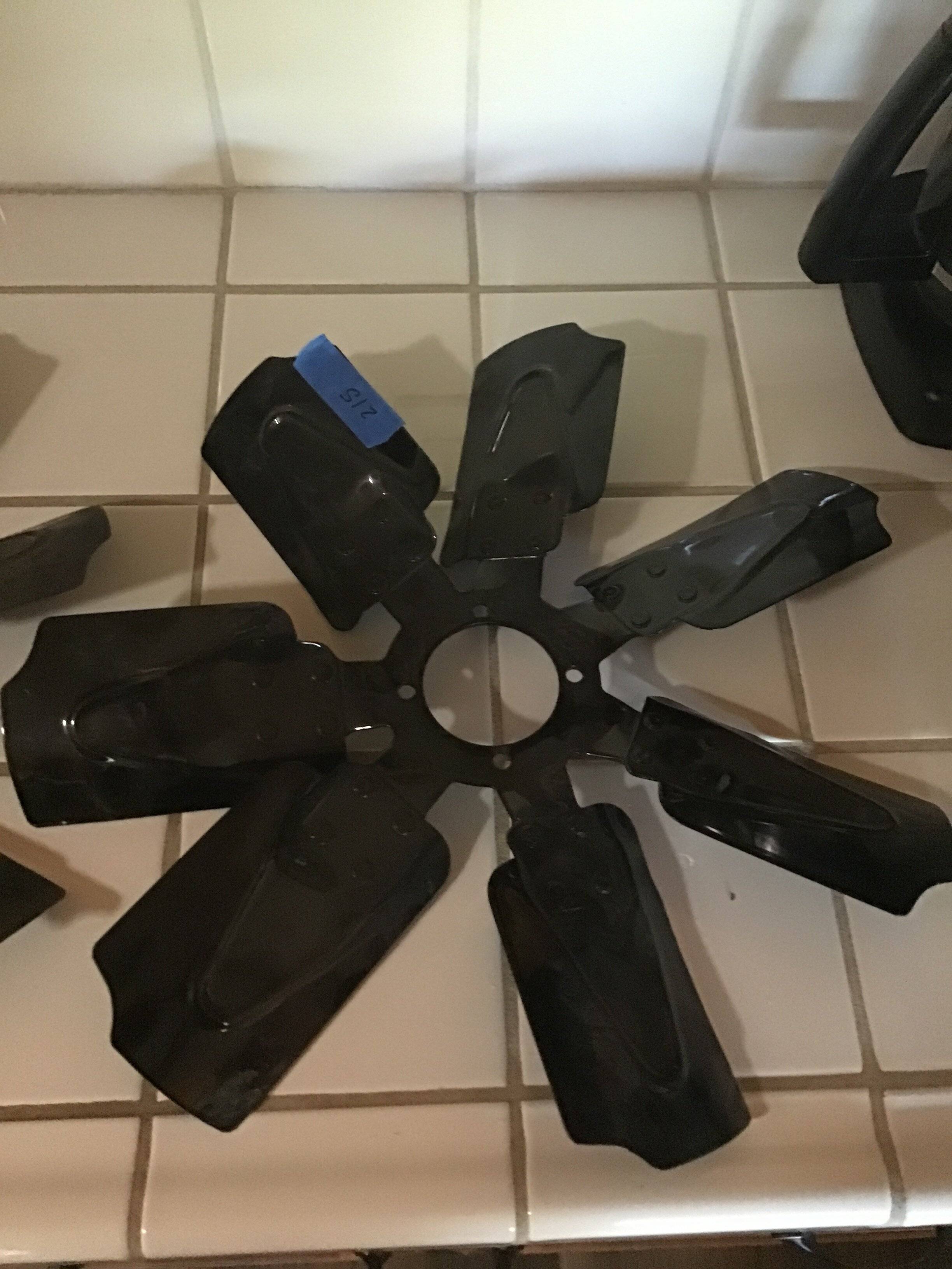

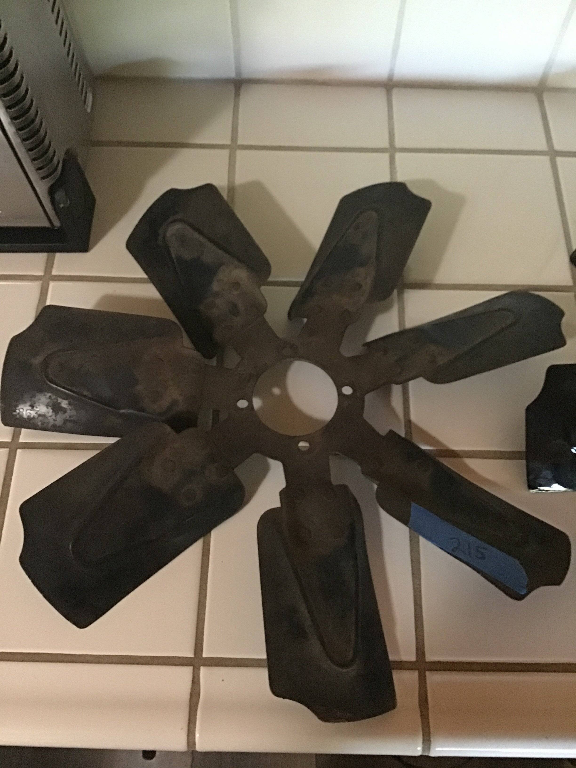

I had two 215 fan. I believe it’s half an inch shorter.
one is $50.00 and the other one is $80.00
