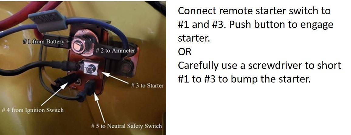

It sounds like that you have your driver's side valve cover off already so I would just get the valves closed on the front #1 cylinder as you mentioned by shorting the starter relay with a simple starter button attached to a couple of wiring leads. This eliminates the need for a second person (very handy to have). The relay is located on the inner fender by the battery, as I'm sure you already know. :) Be sure the timing marks are aligned at TDC. This will be your compression stroke and #1 firing position for your distributor.

Details on how to "bump" the starter or use a remote starter switch for our E-Body starter relay.
CAUTION: Maker sure an automatic transmission is in Park or a manual transmission is in Neutral.
