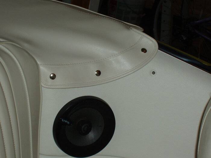

Recently purchased and install White Convertible Boot cover from Legendary.
Snaps were not installed and for good reason. The Snap kit supplied was disappointing.

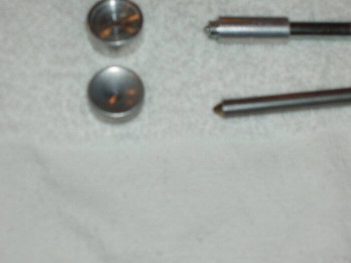

I bench tested the Punch and Cap cup they supplied- not happy with the test results..
Picked up an $8. kit from Depot. The punch had a centering shoulder and the cap was recessed so the Button wouldn't slide around.. Much better results.
