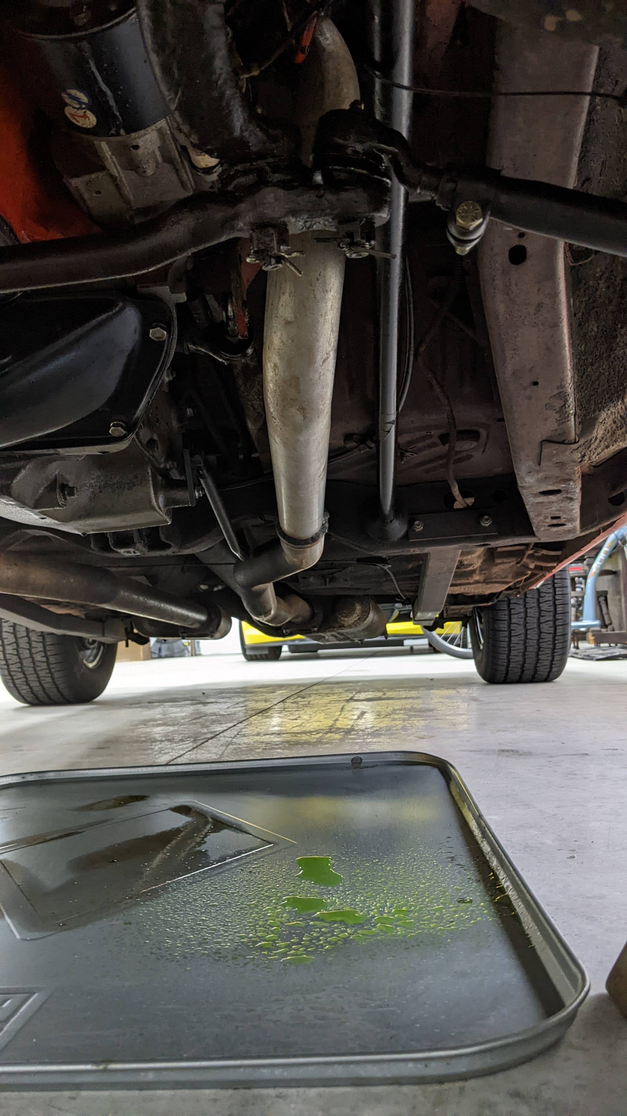

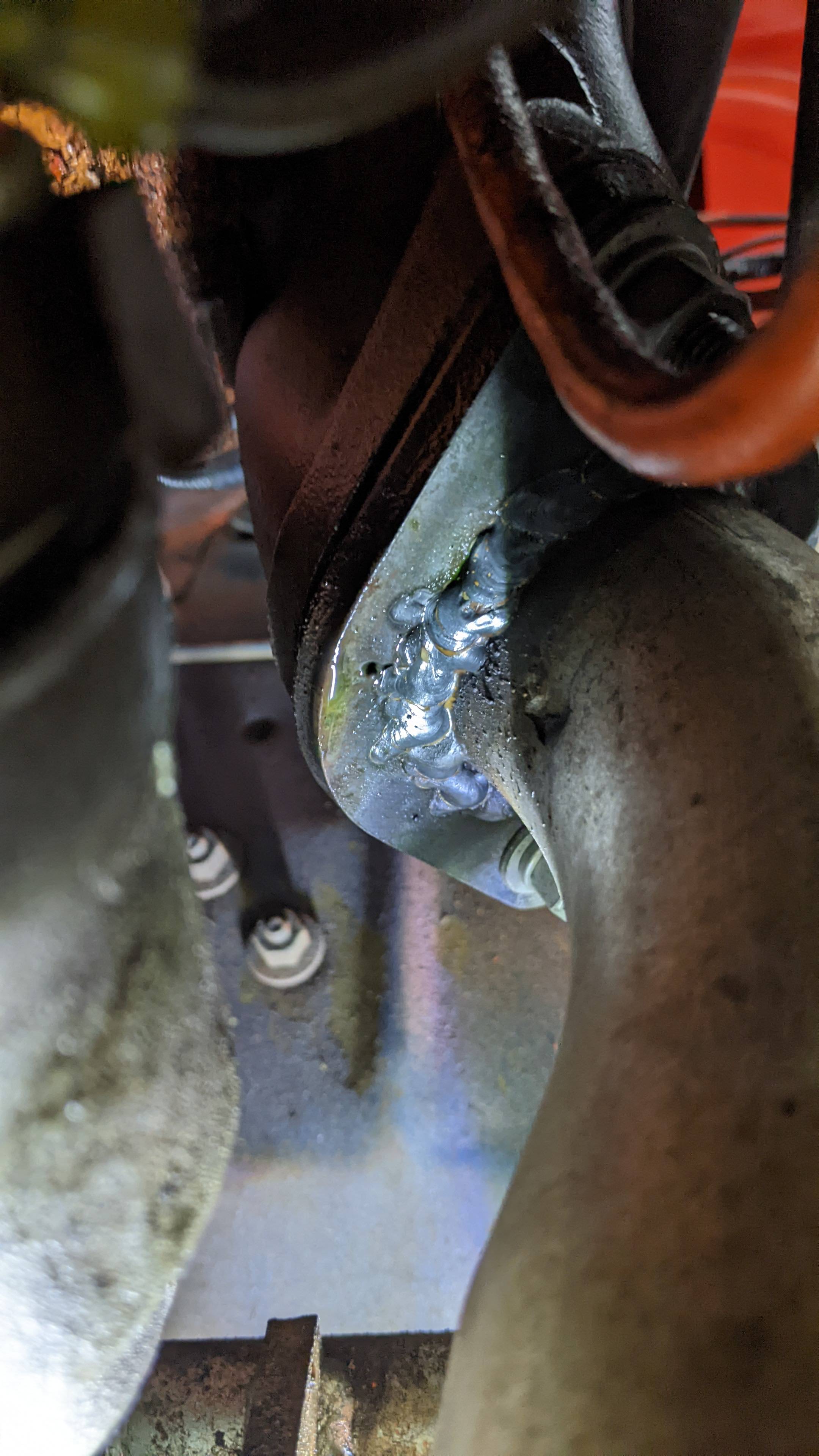

I have a 440 Magnum in my 72 Challenger. Stored for the winter I noticed coolant in the floor tray I had under it. Tracing it up, I see coolant on the manifold to exhaust connection (driver's side). The side of the engine is dry, soft plugs are dray. I am perplexed ... ideas welcome before I start to take things apart ...

In the iron 440 heads the exhaust manifold bolts actually screw into the water jackets (poor design).
If you install the exhaust manifolds without putting sealant on the ends of the studs they will almost always start to leak coolant.

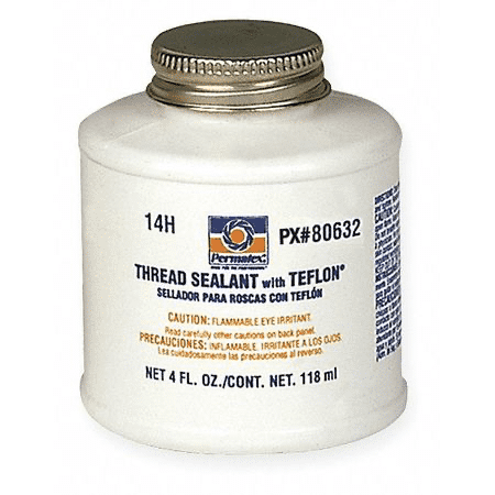

I have experienced the same issue with 340 engines. The outer studs on the front and rear of the heads penetrate the water jacket and will certainly leak without sealer applied. I use liquid teflon on everything coolant related. No further issues!

Thanks. Do you have a brand you like? High Temp?
What I found was "Permatex 59214 High Temperature Thread Sealant"

This is what I have used for many years. $8.99 at the Zone.
