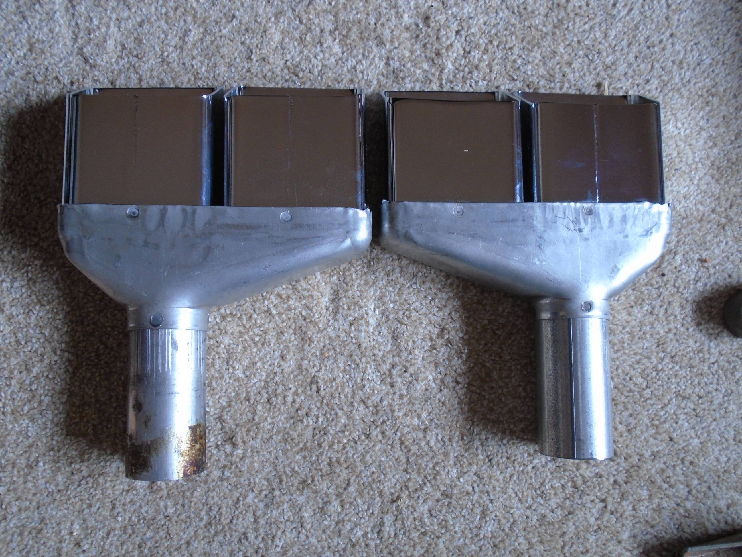

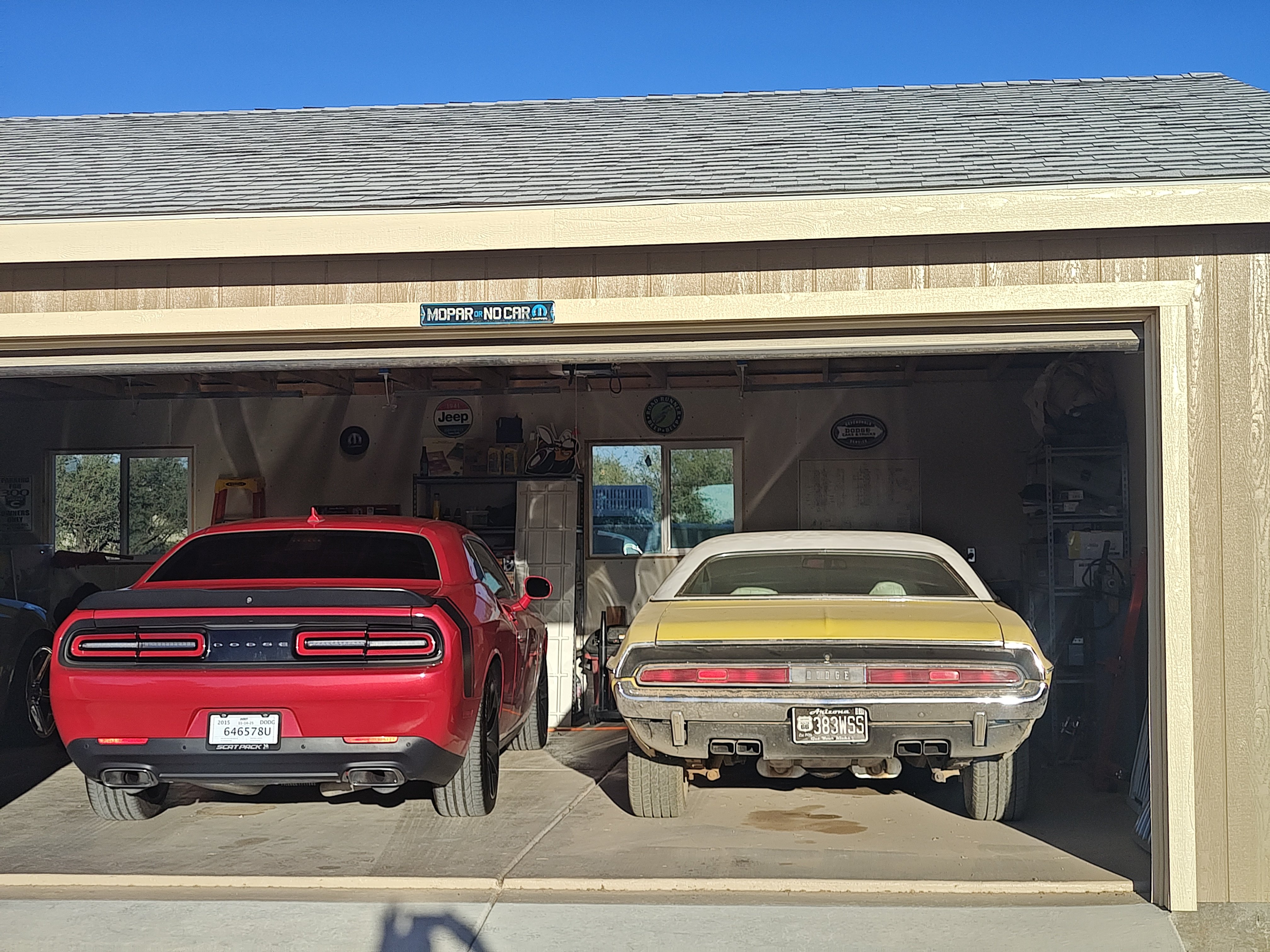

I have a good pair on my 70 Challenger and a rusty pair in a box in my barn that are factory original. Zoom in for the right configuration.
Thanks. Yes rectangles. Your car is a painted top one? Cool. I had a 71 Shaker 340 R/T in that color, but vinyl top. I just to find some 2 inch ones.
It's suppose to be white vinyl (which I have), but when I bought the car decades ago, the vinyl was missing and I painted it white. And it kinda grew on me.

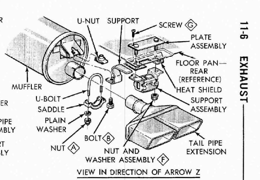

Two inch tips where factory, yes!

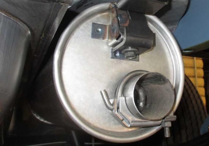

The Service Manual diagram shows the tips installed with clamps.

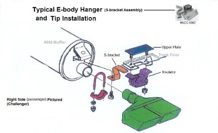

Even Accurate LTD's diagram (colorized) uses the service manual diagram for reference.

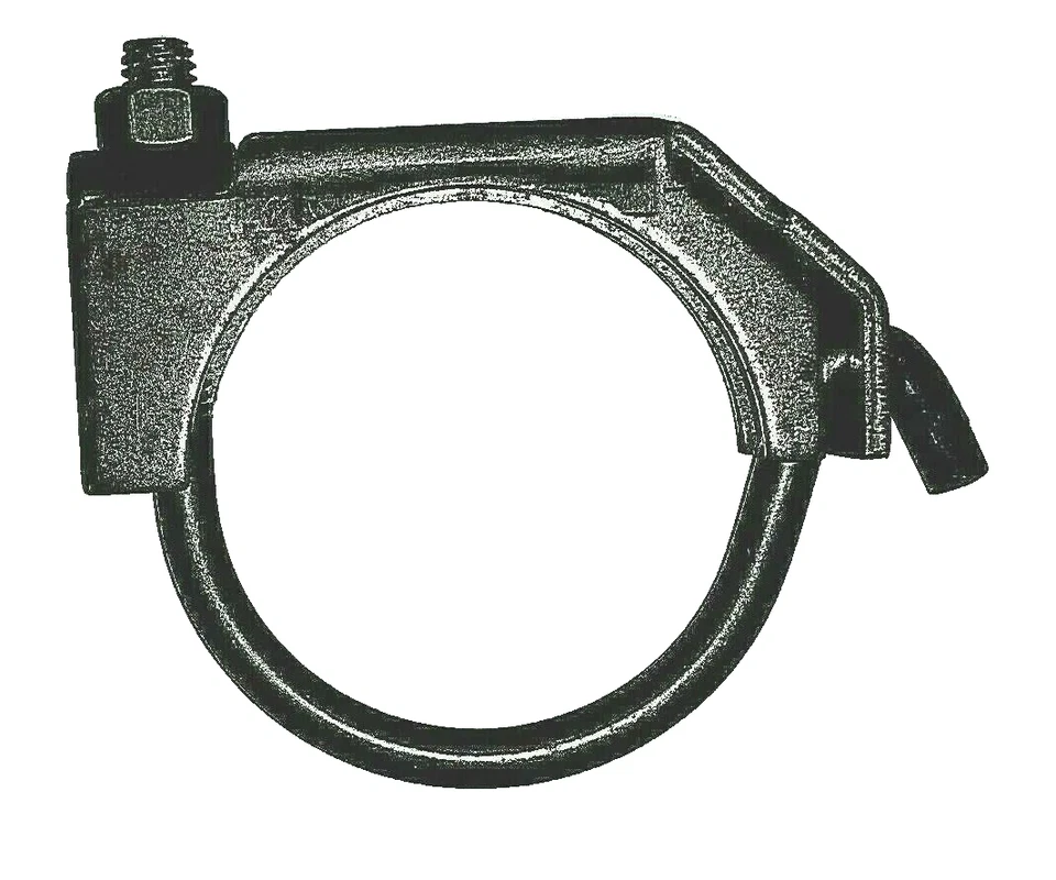

The Q-Clamps do not look like the diagram but Q-clamps are correct.

Perfect. Thank you for that. I have the system sitting around waiting for parts dealing with trans, etc. I'm expecting it to look like that. I just need nice 2 inch tips. Like I say, even Accurate's look like square stock welded up. Maybe it's just the picture is not good on their site. But it seems to me they should be rectangle, not square shapes. I need to find factory dimensions on the tips I think. Or, I'm making too much of it. But there is a big disparity in pricing out there and after having plunked down more than I thought an exhaust system would cost and the fact that it is nice, I want to make sure the tips match it in quality and correct look.
