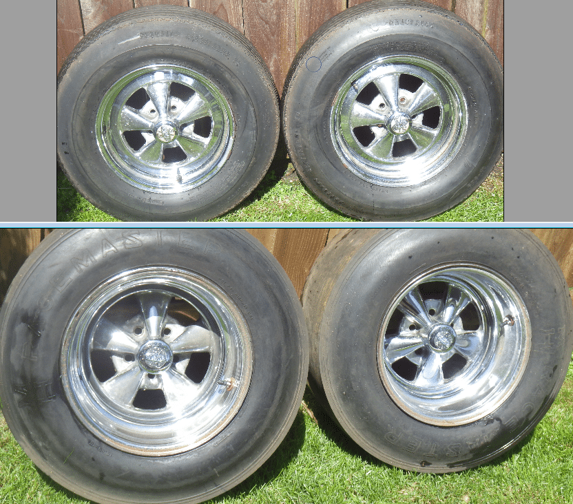

I'll see if I can find a picture. ThanksI think the slotted rims are for multiple bolt patterns.
I have some slotted keystones and some slotted turbine's.
Not surprised there are cragers with slots instead of standard holes.

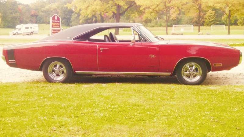

Thanks.The standard Cragar SS rims are uni-lug and will fit three bolt patterns 5x5 5x4.5 and 5x4.75 I swap them from my 70 challenger to my 69 chevelle. They do make direct bolt on pattern as well.

Depends. The newer wheels do. The older wheels are much better quality. I bought mine when I was like 15 years old in the 80's used at a flea market just because I thought they were cool. Been on my cars since. These wheels are dated 1982 and still look good today.I have found the chrome on the SS mags peels off easily .
