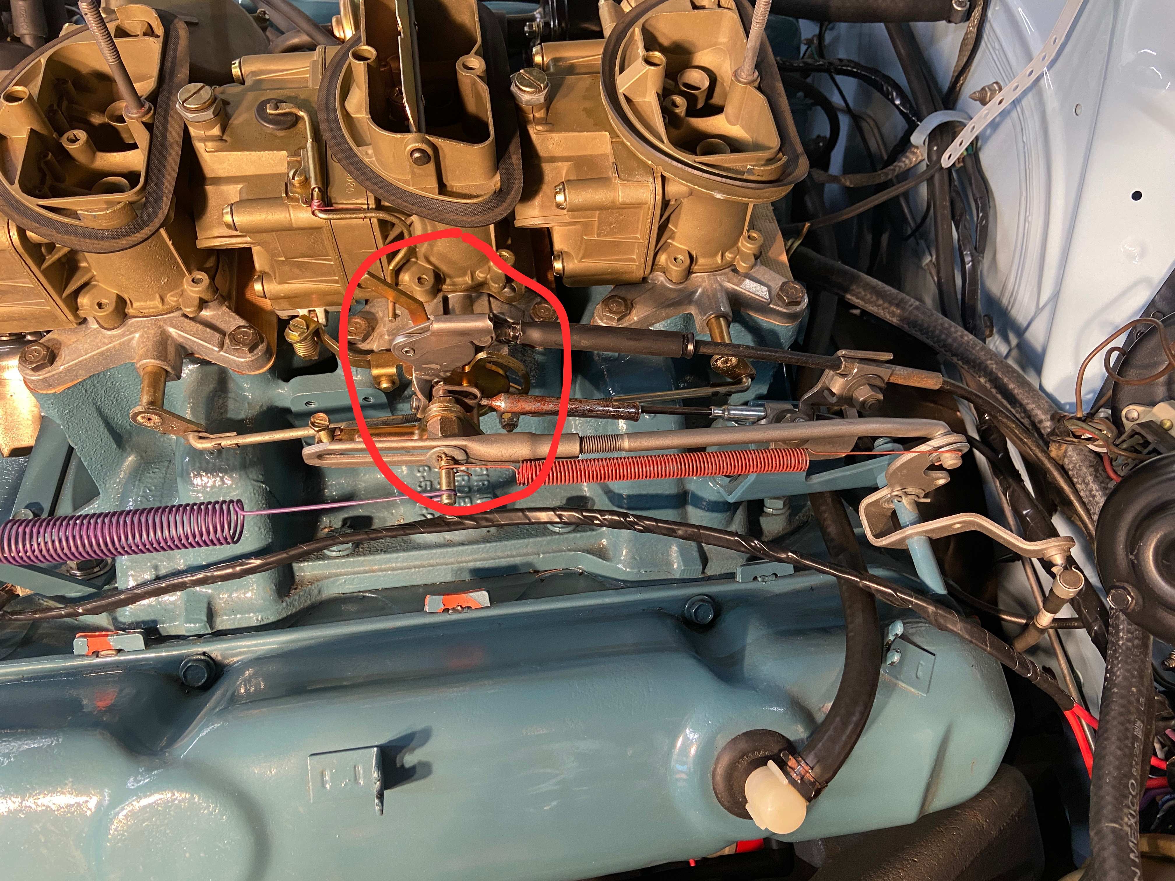

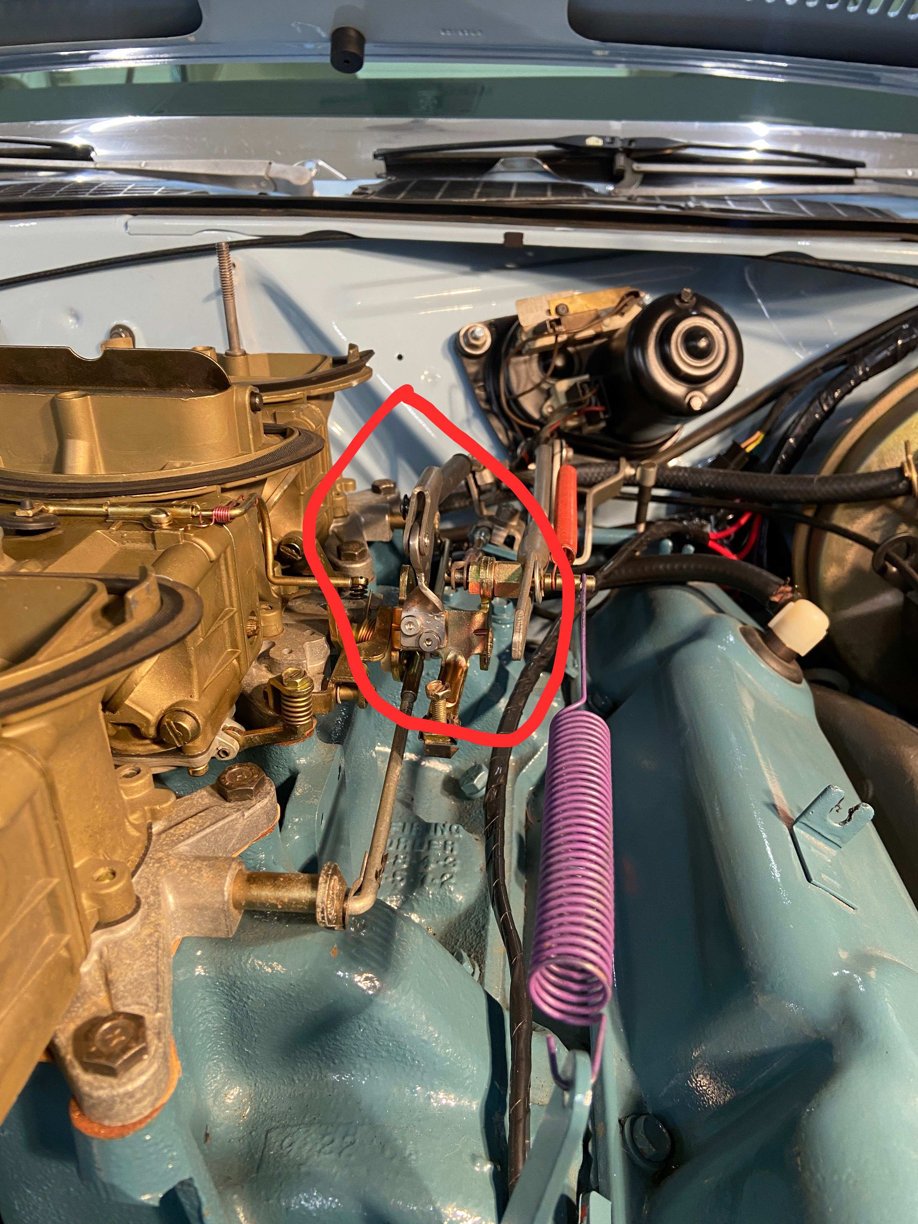

I am in the process of troubleshooting my cruise unit also. I am retrofitting mine onto my 6 barrel setup. Where did you get a new diaphragm?

cruise works on a six pak only if you install a lost motion link at the carb - I have only ever seen one ctr 6 pk carb with the hole for the lost motion link. I have seen cruise on a six pak where the hole for the lost motion link was added - carefully.
As for the OP those servos are pretty reliable - they typically work or they don't. You can check the integrity of the servo diaphragm using a vacuum pump.

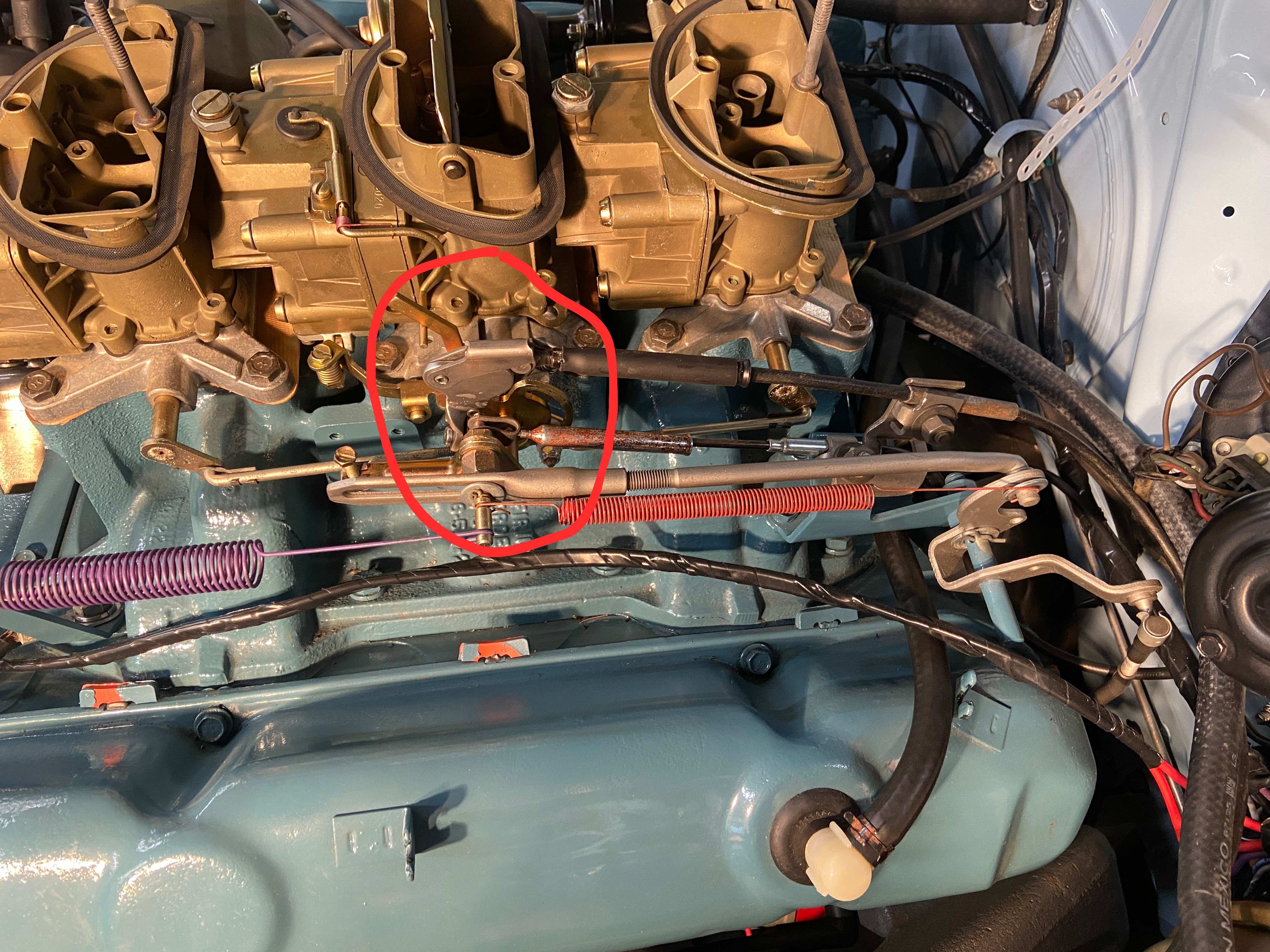

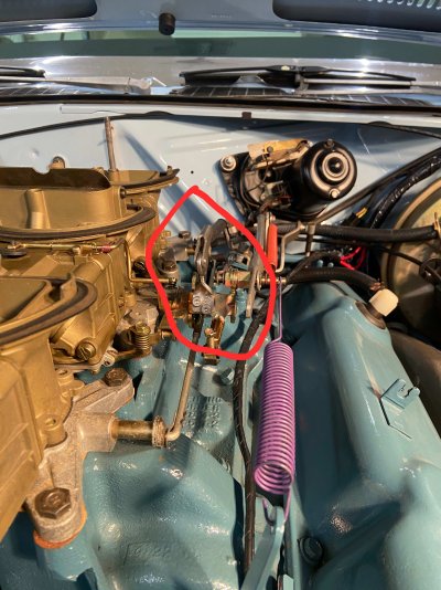

Hello Old Mopar. My car was originally a 318 2 barrel w/cruise. I saved the carburetor with all linkage from the manifold and I do have the lost motion link. I made a bracket to connect the cruise cable to the throttle linkage. I'll post a picture of it on the carburetor tomorrow.
Old Mopar
Sep 4, 2020
56
21
That is an interesting adaptation of the lost motion link.
Does the cruise control "control" the speed properly?
