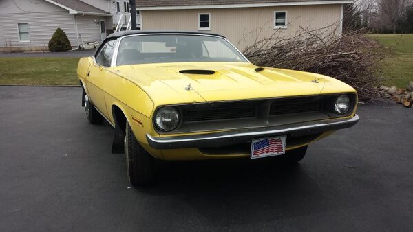

Hi, I'm Doc. Here is a pic of my 70 cuda convertible. My father in law got it in '78 with 55 k miles and currently has 64 ish right now. It needs restored, but I'm keeping it rolling and driving it as much as I can.
Specs:
70 cuda convertible built Sept 69
383 big block
727 auto trans
Not sure on gear yet
Lemon twist yellow
black interior w buckets and floor shift console
Road lights (missing)
elastomeric front bumper (currently has chrome)
factory am 1 speaker radio
Factory hood pins option
4 wheel manual drums
Power steering
It's also supposed to have the hockey stripes.
So at this time I'm trying to keep it running and driving till I decide to to the restoration.
Hope the pics show up..
