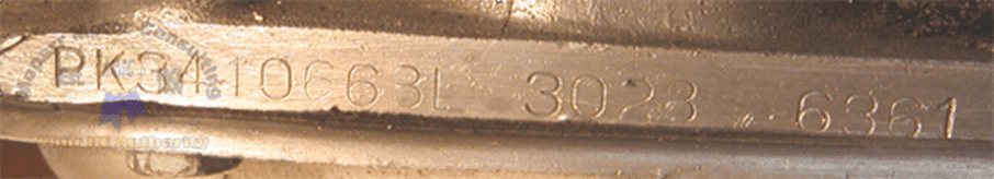

Here is a sample on how to decode your transmission;
Transmission Part Nnumber
PK 3410668 L 3028 6361
PK = Kokomo transmission plant
3410668 = Part number = 1970 Year model A727 for a 383 CID V8 HP
3028 = Build date = November 11, 1969
6361 = Sequential serial number = 6,361st transmission built that day
