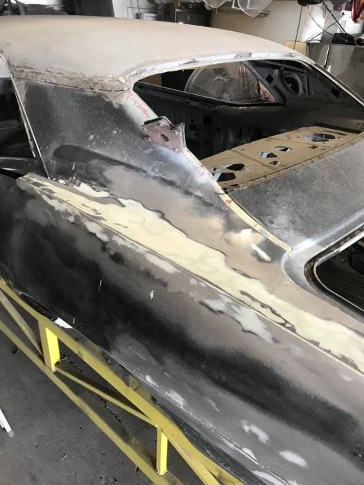

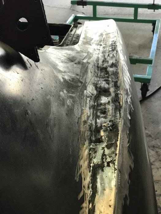

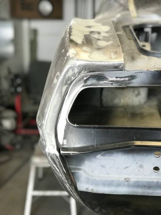

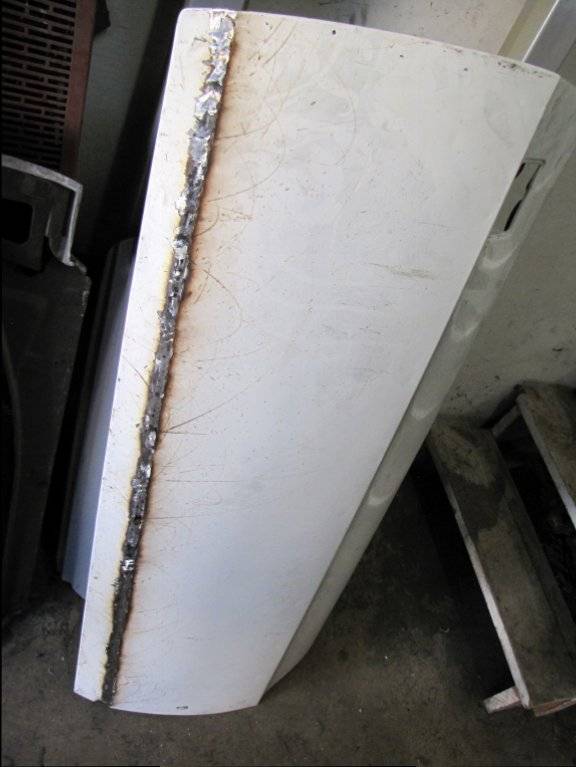

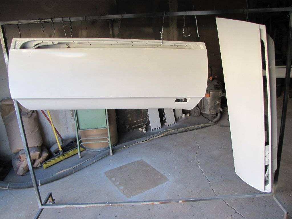

Rarely do I ever spread body filler, but, today I pulled my Doors back out of storage to apply filler to the lower sections over the repairs rendered. Reason was I'm doing another 69 Camaro and I finished up widening the drivers side qtr panel IAW owners wishes. BTW there is not much 'room' for this widening operation on this car, but, I think it came out pretty good, all in all, almost 2 inched wider on each side and has a graceful arc along the radius of the beltline on the car. The filler was not really needed in my lane but I want to make a template for the other side based of this side and figured a nice smooth surface is best to render this.

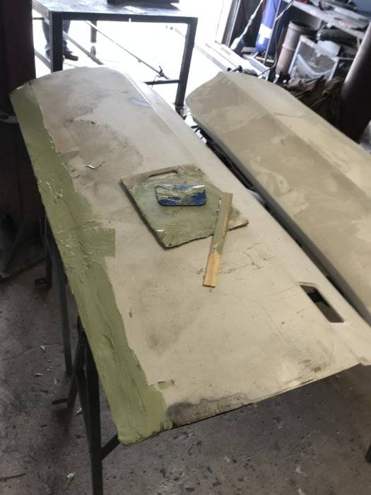

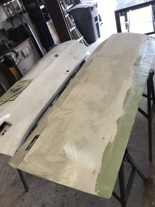

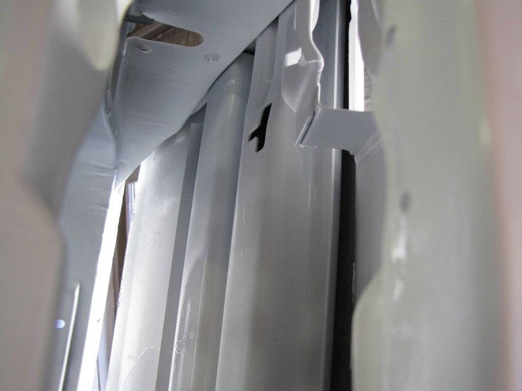

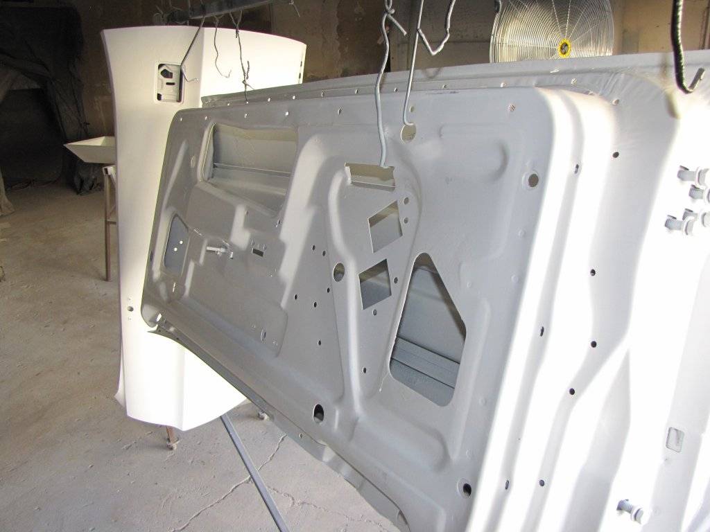

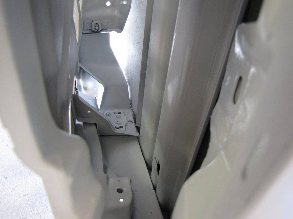

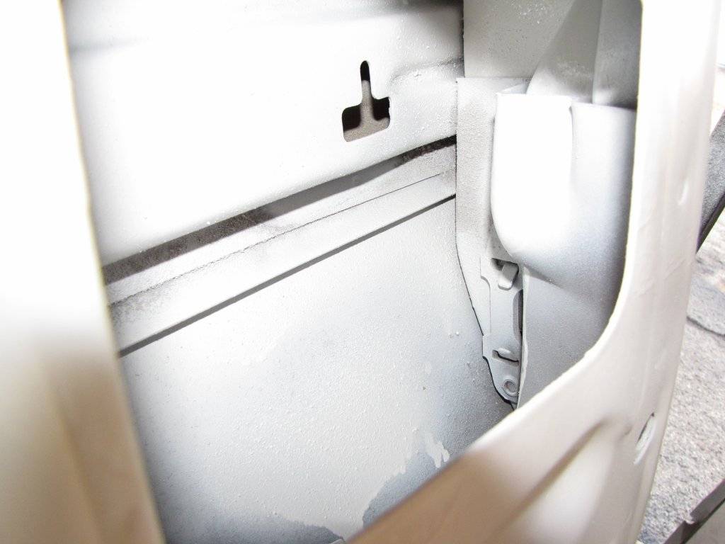

Here's the Doors...Blasted, Epoxy primed, lower skin removed, re-blasted that lower inside area, re-epoxied inside areas, rust holes fixed, lower skin fixed, reskinned back on. Need to DA the areas again, and then re-epoxy where needed. This is the most complete way, love doing stuff this way!
That’s the right way to do it. Like it!
