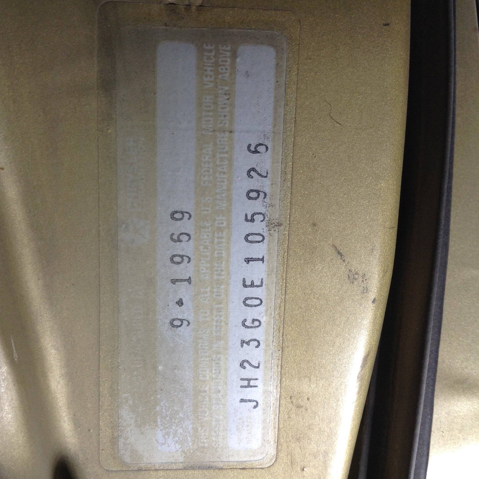

My door jamb sticker was obliterated during restoration and I didn't have the forethought to get a photo of it but I do have the fender tag and VIN label for dash. This is a 1972 318-2bbl car. Does the door jamb sticker only have the date of manufacture and VIN or is there more info? I have seen these available online and I want to make sure I get the right one. Can anyone provide a recomendation for a source and either a sample or description of what information is on it? Photo of correct location would be nice too. Thanks!

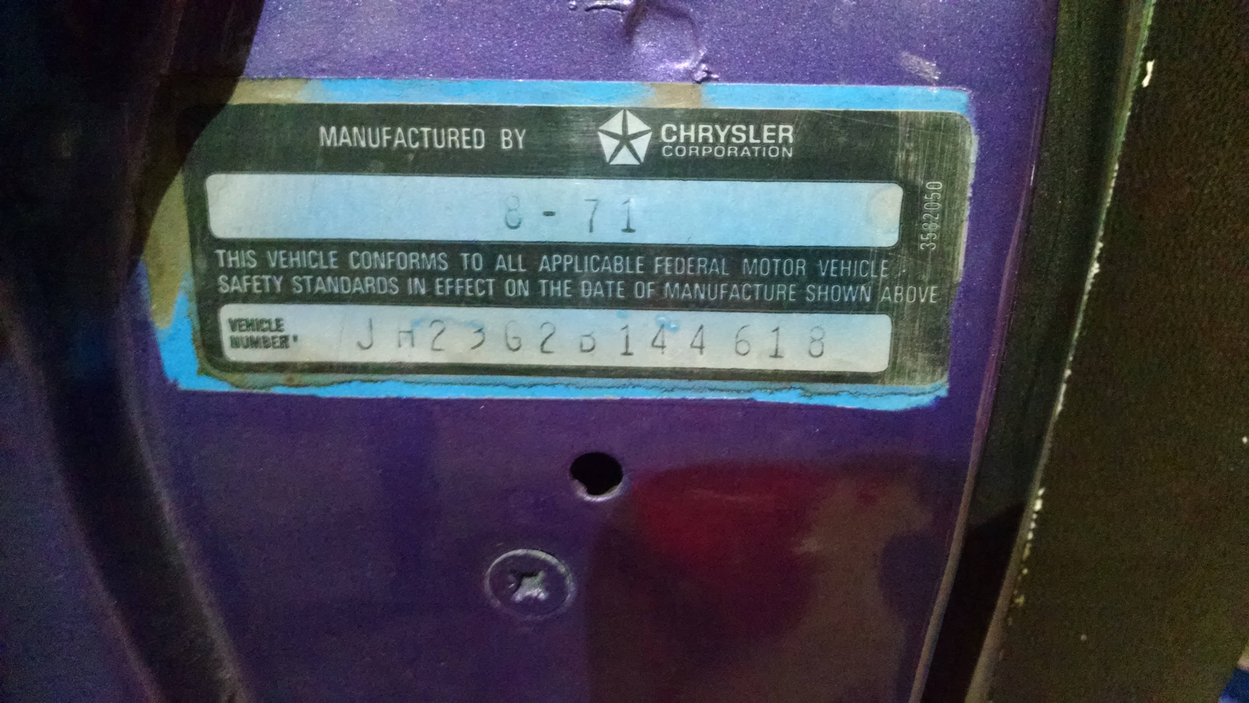

From my 72 Challenger its got VIN and date, but its an early build...Aug 71. Reference holes and bolts for location . Repainted B5 blue car so label is original.
Looks like builds actually begun in Jan 1 1972 had to have the weight info added. See the later examples by ECS in the attached post.
Looks like they can get you the replacement if you can get the data.
